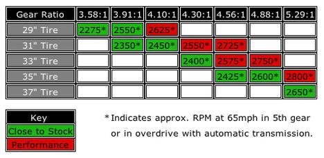

    Did you change gear ratio? or still staying stock gearing?

    No I already have 4.30 gears. With 33s 4.30 is just right for me. My speedometer is even correct.

    That's good to know....I was thinking to go 4.56 but if 4.30 is just right I may reconsider.

    Depends on what you are using it for, if it is for mostly off-road go 4.56 or even 4.88s. Mine is my daily driver so 4.30 works for me.

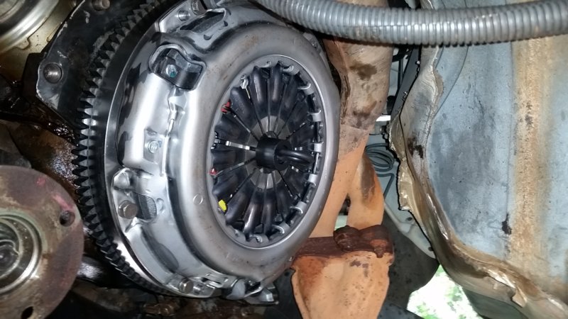

    Had to replace my clutch
    2002Tacoma4x4 and 04yota like this.

    Did you resurfaced the flywheel as well?
    Did you go with oem stuff?
  16. Jun 3, 2017 at 9:16 PM
    #196
    JBTacoma
    JBTacoma [OP] Well-Known Member
    Feb 16, 2015
    #148844
    11,098
    Jeff
    Cullman Alabama
    2000 SR5, 2003 Double Cab and a Suzuki Samurai
    New flywheel and always oem.

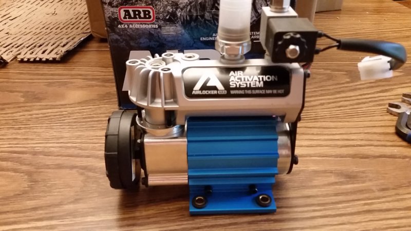

    Got my front ARB locker and compressor today :yay:
    2002Tacoma4x4, A.priori and LogCabins like this.

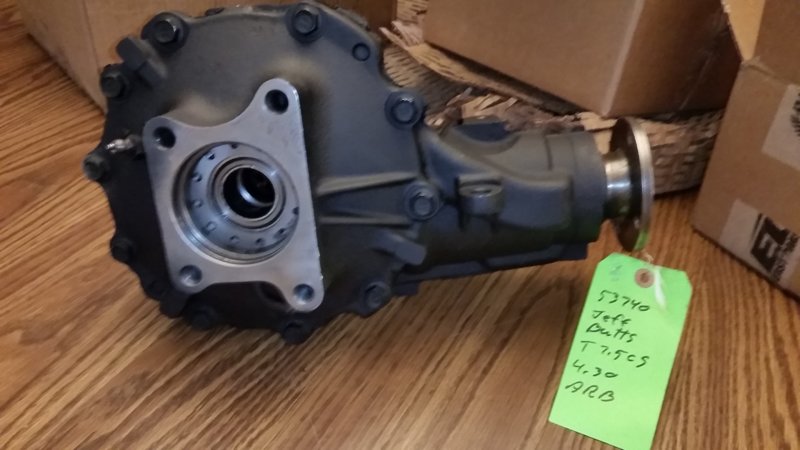

    Got the front diff and locker installed today
    Had to pull the skid plates
    Could not believe the mud from the last trip that was still in the skids
    Next had to remove the hub lockers
    Pulled the snap ring off the CV shaft
    Next had to remove the 4 lower ball joint bolts
    Then swing the knuckle around to pull the CV out
    Pull the plug to drain the Diff
    Next, took a pry bar to snap the CVs out of the Diff
    Pulled both CVs out
    Next take out the nut circled in red, it holds the back of the diff to the cross member
    Next the 2 bolts that hold the front of the diff
    Drop the Diff out,
    Had to use the diff tube and the brackets from the old diff on the new one
    Remove the old seals
    Install new seals
    New diff with ARB locker installed
    Put the tube and the brackets on the new diff
    Install new diff in reverse order of taking it out
    How was that @stronghammer
    I will be installing the ARB compressor tomorrow

    Nice little write up. It made things a little clearer for when I do the same thing. :thumbsup:
