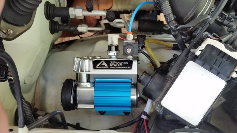

    ARB compressor installed

    ARB front locker, ARB Compressor and Clamshell from ECGS
    Just click the underlined item and it will take you to the site.
    I list everything on the 1st page of my build thread, they all have hyperlinks, just click the item on the 1st page and it will take you to where I got it from.

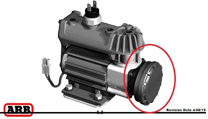

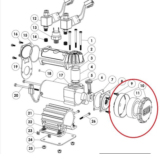

    Jeff, you think it matters if that black exhaust cap is on there? Apparently it's super weak plastic because mine snapped itself off, so the neck is threaded in but the cap broke off. It's just exhaust so I feel like it doesn't matter...idk how to get the piece that's threaded in back out..

    This is the filter not the exhaust, Click the link below
    It will have to have it, if dust gets in it, it will trash the compressor
    Should be able to wedge a flathead screwdriver in the hole and carefully twist it out
    https://www.justdifferentials.com/ARB-300501-p/arb300501.htm
    ARB-CKSA12 parts list.pdf
    ARB-CKSA12.pdf

    Well crap, ok I'll figure it out. Thank you sir. The directions suck btw haha. Pictures would help.

    Yes I did. Thank you. Im gonna have to buy it.

    woohoo! I got the piece out, now to order a new one. It's ok, because I don't have all the tools I need anyways.

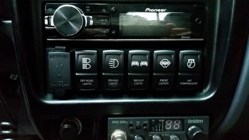

    Cullman Alabama
    2000 SR5, 2003 Double Cab and a Suzuki Samurai

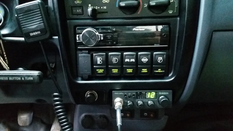

    Finally got my switches installed
