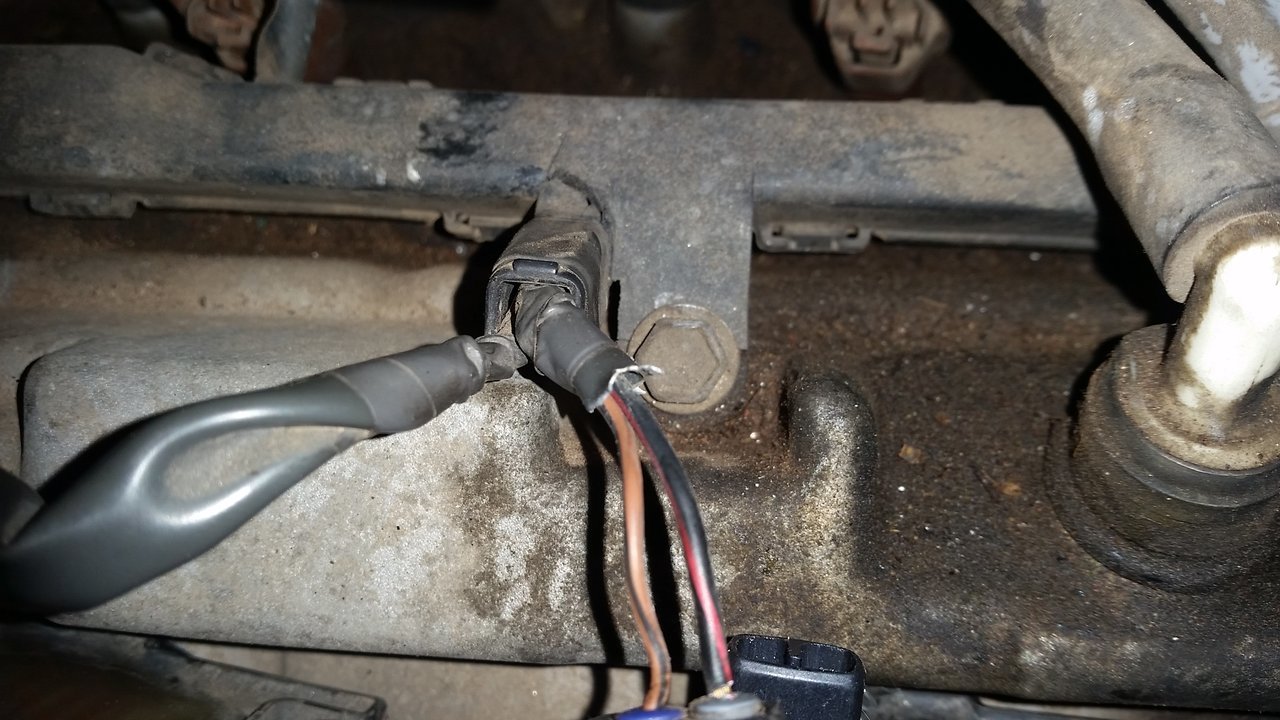

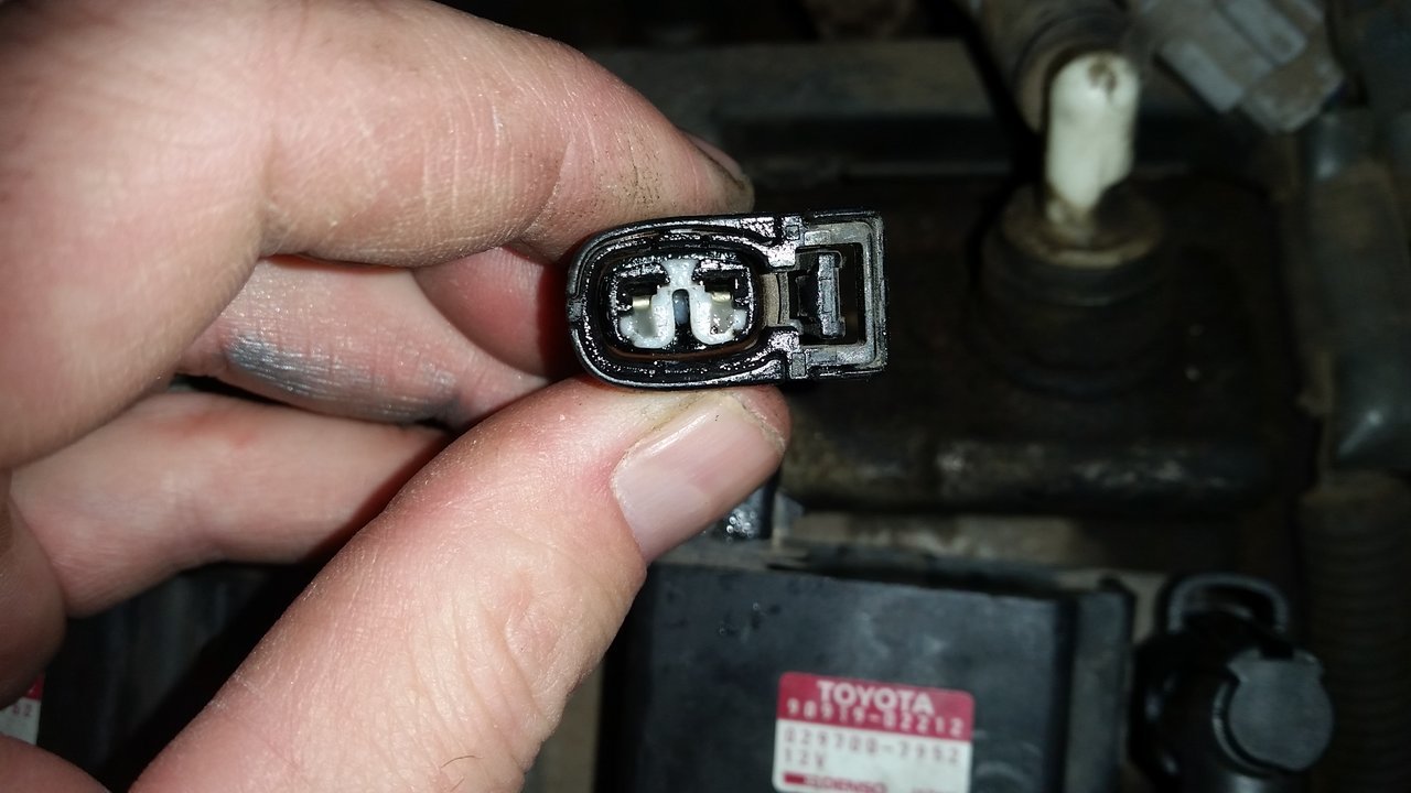

    Bishop, I did swap the coil packs and still no spark from #1, I also tried it with one of the old wires to make sure the new wire was not bad, I also took a close look at the pig tail connector and it looked good too20180211_183022.jpg 20180211_185827.jpg

    James, thank you for clarifying I apologize for not explaining it clearly. So I basically disconnected the wire from cylinder 4 and was testing it that way for spark. I figured that if #4 was not getting spark the coil pack on #1 was not getting spark either. I went through checked the wires and connections to the coils ect,

    Yes from what I could tell #1 and #4 no spark , 3&6 and 5&2 are getting spark and i swapped the coils and wires so its not the coil or wire. i guess the next step is to check if I am getting any power to the wire that connects to the coil eh? I was going to replace the pig tail connector and I took it apart and it looked ok. So not sure, it seems like if a relay or fuse was bad none of the coils would be getting spark.
