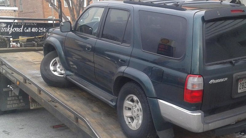

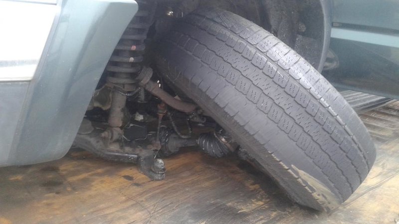

    I've been following your thread because it was similiar to my truck project. So what's the verdict, keeping it or flipping it? I have 2 4runners and my taco and i might be buying a 3rd 4runner, a 2001, that was just towed into my work with a failed lbj. Owner isn't sure if he wants to dump any $$$ into it because it has 222k miles. I buy'em and fix'em but find it hard to sell some of them. I've been called a hoarder, lol.
  9. Jan 25, 2015 at 3:22 PM
    #29
    unixadm
    unixadm [OP] Well-Known Member
    Oct 5, 2014
    #139715
    1,032
    Super White 2015 DCSB 4x4 Off Road
    Ouch! What's the estimate to fix that?
    I'm not sure if I'm going to keep it or flip it. I bought it to flip it, but with my 95.5 now selling, who knows. My buddies want to go to Moab, so maybe I'll use the truck for that trip and see how it goes.
