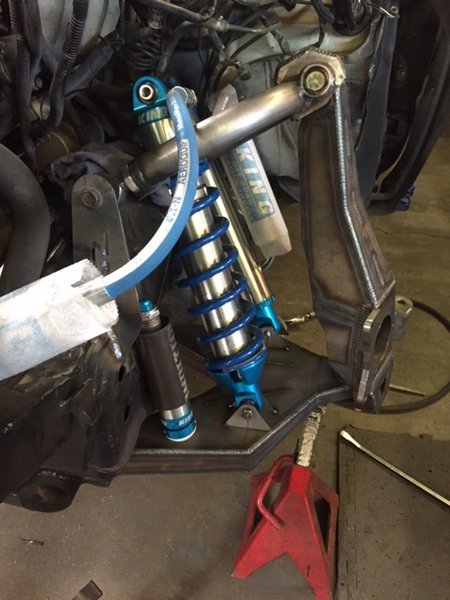

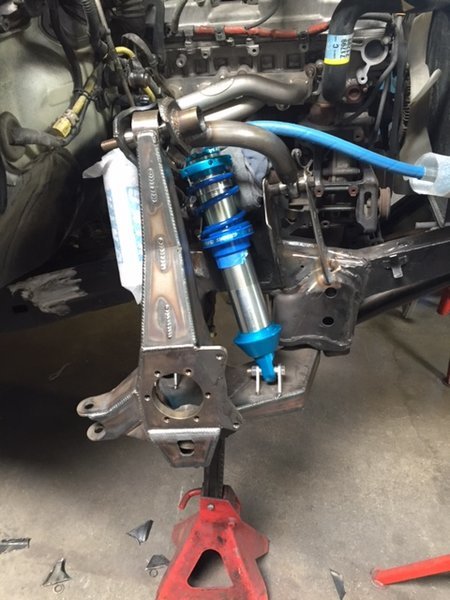

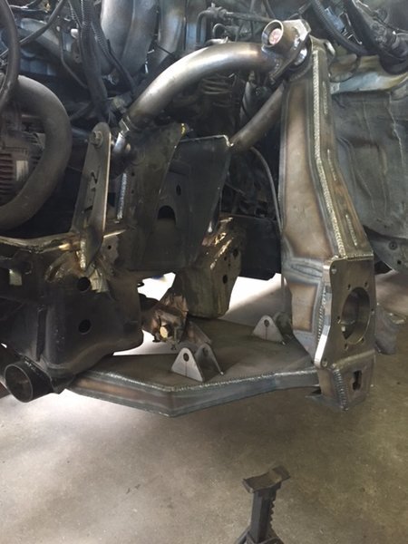

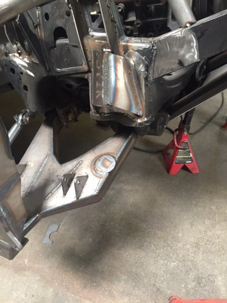

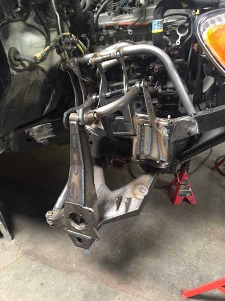

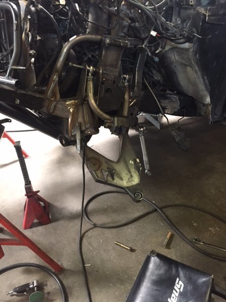

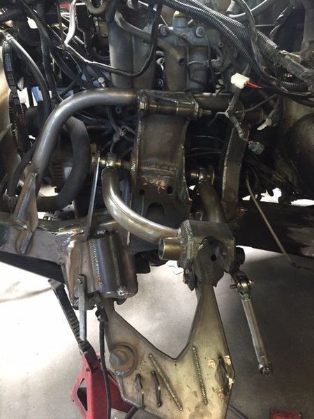

    These are some early pictures of the Solo XLT kit coming along.
    IMG_9713.jpg IMG_9714.jpg IMG_9716.jpg IMG_9722.jpg IMG_9723.jpg IMG_9724.jpg

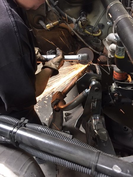

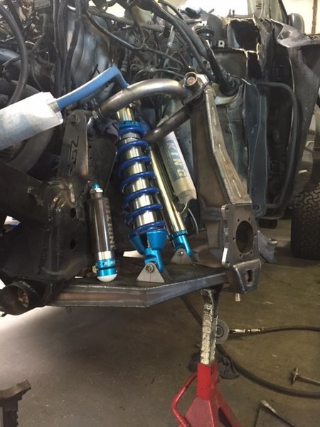

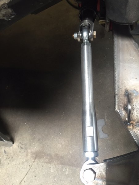

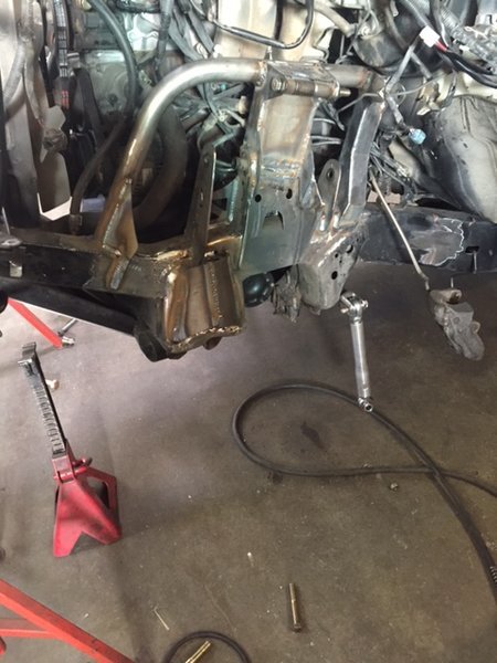

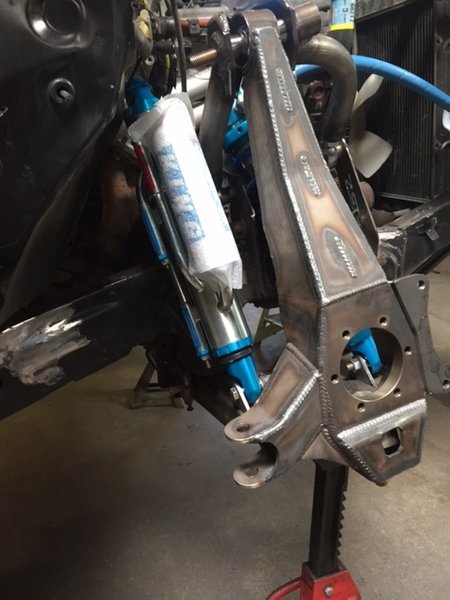

    As the kit was cycled, Solo had to pull the bypass lower rod end and tig weld a heim to get the most uptravel possible out of the kit. It is looking to be around 17.5" bumped and strapped with working 4wd.
    The kit was pulled off yesterday and sent to powdercoat. Just waiting on that and the axles to come back from Currie.
    IMG_0182.jpg IMG_0183.jpg IMG_0184.jpg IMG_0185.jpg IMG_0187.jpg IMG_0196.jpg

    5.5 over? looking good man, nice to see they are going good on it. cant wait to see it all finished up!

    Thanks man. The kit is 4.5" over. @FlapJack935
