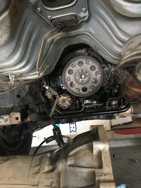

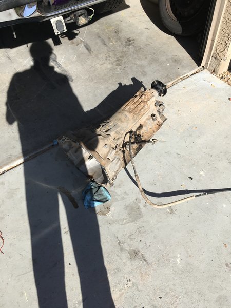

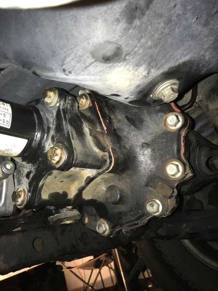

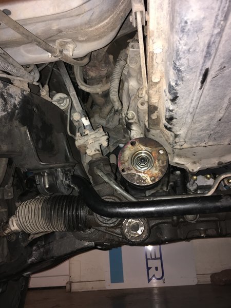

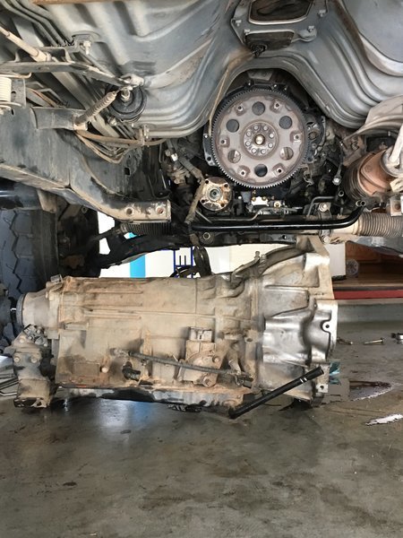

    Today we dropped the tranny and got it all ready to bolt back up. I had some help from a more experience mechanic and it wasn't too bad at all to get done. Going to snag up the front drive parts I'm missing, check out if the carrier bearing is going to be replaceable in a timely manner and swap the speed cable since the one on the tranny I bought was damaged... it's a pain to swap that cable haha
    Pics of the diff carrier installed
    2wd tranny is out now

    I am doing this swap literally as I go, I did read up a bunch about the conversion as well as gather all the large parts needed. There is a few specific things I did on my truck I'll point out when I'm done but as for now I'm off to get a new steering rack, carrier bearing and the front driveterrain (cvs, spindles,hubs) my go to part out vehicles were 4 runners btw. Interior parts need to come from your model though.
