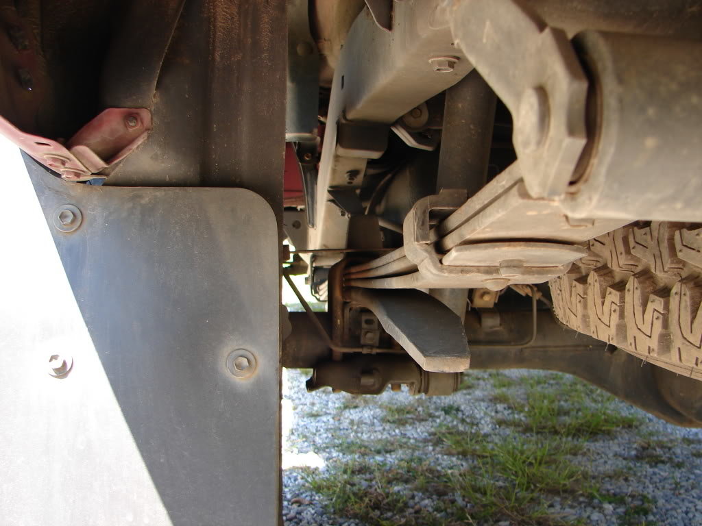

    Hi, I have a 2000 Tacoma SR5 Xtra-Cab 4WD that is sagging in the rear. The leaf packs look nearly straight, definitely not that desired "happy face". The truck has 258,000 miles on it and has had a camper shell on it for quite some time. I don't do any "heavy" off-roading but I take it to the mountains and desert and use the truck for what its good for. Will a AAL do the trick to lift the rear end up again or do I have to replace the entire thing? Thanks

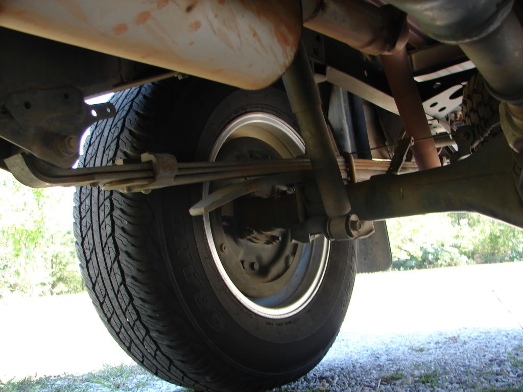

    with that many miles, I recomend getting a whole new leaf pack. I have the wheelers 5 leaf pack and love it. They are made by alcan for wheelers and lift the rear about 1.5".
    Here's a pic of my old leafs:
    and new:

    Welcome to TW , I'm in San Diego , well actually Lakeside, you have the same prob. I've got dude & unfortunantly I think we're looking at new leaf packs, the AAL may help for a bit, but it seems that once the stock springs start sagging the opposite direction theres no bringing them back, I really think that Toyota dropped the ball in regards to their material of choice for the leaf springs (type of steel & thickness of leafs)

    Mine looked worse than steve o's and the only route to go was to replace them. An AAL isn't going to do much to solve the problem if they are flat and/or negative arc.

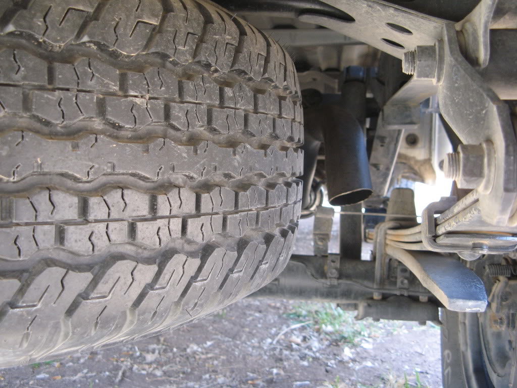

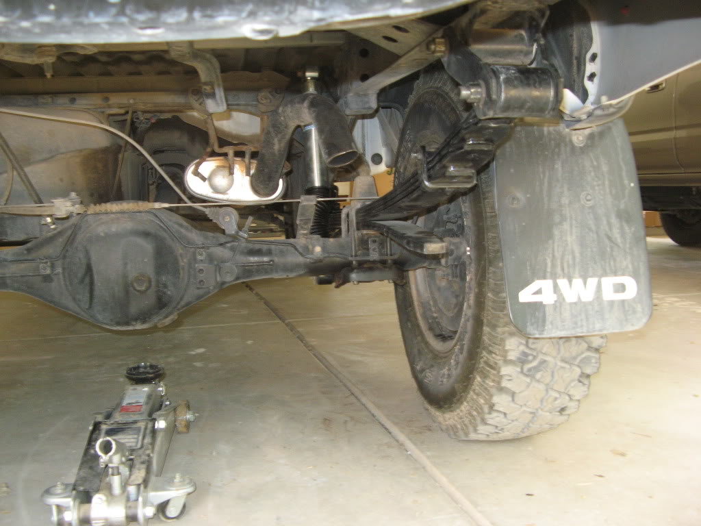

    You should check your leaf height based on the Factory Service Manual. You can find instructions and such in the following post. Dont go by looks alone as the angles involved cause an optical illusion making them look like they have negative arc.
    http://www.tacomaworld.com/forum/1st-gen-tacomas/110855-leaf-packs.html#post2121292
    You'll have to find the measurements for your year, as that FSM linked only goes from 2001 to 2004.
    As for AAL, it will not fix your problem if they're worn out, at least not for any permanent duration. The AAL is not meant to hold the weight of the whole bed, but only work with the other leafs.

    Ok I 'd say if your not going to offroad it & don't overload the bed , & how small is this trailer ? , Single axle or tandem ? Boxed or open ? Length ?
    You could probably get by with an AAL for awhile,but first park your truck on a hard level surface unloaded & really look at your leafs & pay particular attention to the last foot or so on each end of the leaf spring where it mounts in front ,to the shackles in the rear for neg. arc, if this section is neg. arc , your springs are done.
    Now its pretty normal for these stock springs to warp & flatten out when on uneven surfaces but when parked level, they return to thier level or slightly positive arc.........:cool:
    &^ as mentioned take some OEM specs & compare notes

    Mine really weren't that bad but I wanted to lift the truck anyways so I just went ahead and did it right with the new leafs. Don't worry though, the old leafs went to good use, I made a trailer using them.
    That was also with 159,000 miles and no camper shell.

    Well I measured the specs as best as I could and I got about 15 7/16in at the center of the front leaf hanger and about 14in at the center of the axle. But even though that kinda checks within specs they still look pretty bad to me. Here are some pics I just took.
    What do yall think???
