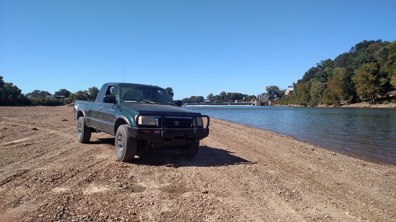

    Drove taco to the White River today and realised I definitely need new shoes will 285's fit on 15x7's
  9. Sep 27, 2016 at 3:06 PM
    #29
    TacoDell
    TacoDell Truck ~n~ Tow
    Jun 20, 2008
    #7448
    1,381
    SoCal
    '00 Tacoma SR5 4X
    Donahoe CO's, Deaver leaf paks, Lockright Locker, All Pro body armor ( sliders, front and rear bumpers ), All Pro under belly skids, Warn M8K w/Masterpull synthetic line, Dual Optima battery system, 4 ea LightForce Striker 170 offroad lights, 8 ea wired rock lights, and plenty more I'm sure
    285's are metric and fit 16" wheels.
    You have 15 X 7 wheels
    so should be looking for non-metric tires.
    ie: 32/10.50/15
    Plus you shouldn't squeeze a wider tire
    on a narrower 7" wheel.
    As that can create odd tread wear issues.
    'cuz the tread will not be flat to the road surface.
    And setting the air pressure right... will be the challenge.
    I'd think something around 10.5" in tire width would be best
    on a 7" wheel width.
    Back spacing on the stock tacoma wheel is 4.50" I believe.
    For a metric 285... the wheels backspacing would need
    be nearer to 4.0" (16 X 8)
