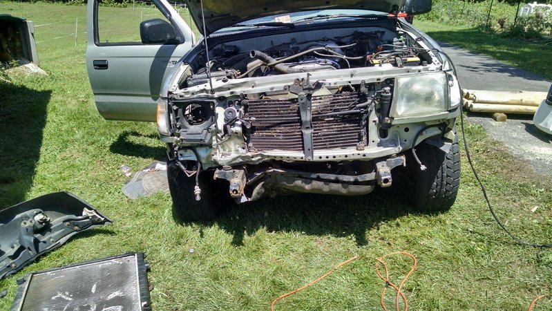

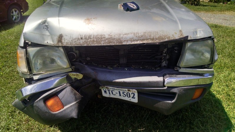

    Here is a pic

    Ok so no Burton to push just pull out and reinstall?

    That looks like the passenger side took the hit.
    The wires to your mass air flow sensor could be cut as well. Check wires that go to the MAF sensor and throttle body.
