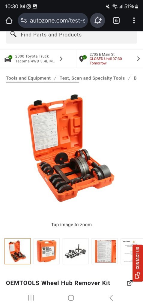

    I own a 2000 toyota tacoma both front wheel bearings are bad I have never changed press in wheel bearings can this be done with the front wheel bearing tool u can rent or buy from harbor freight..or due you need big 21 ton press? Been looking for help dont have the funds to take to a auto shop i usually do my own repairs any way any tips or advice will help

    BIG press; like you mentioned, 20 ton.

    I have seen videos of ppl using the front wheel bearing tool so I wasn't sure

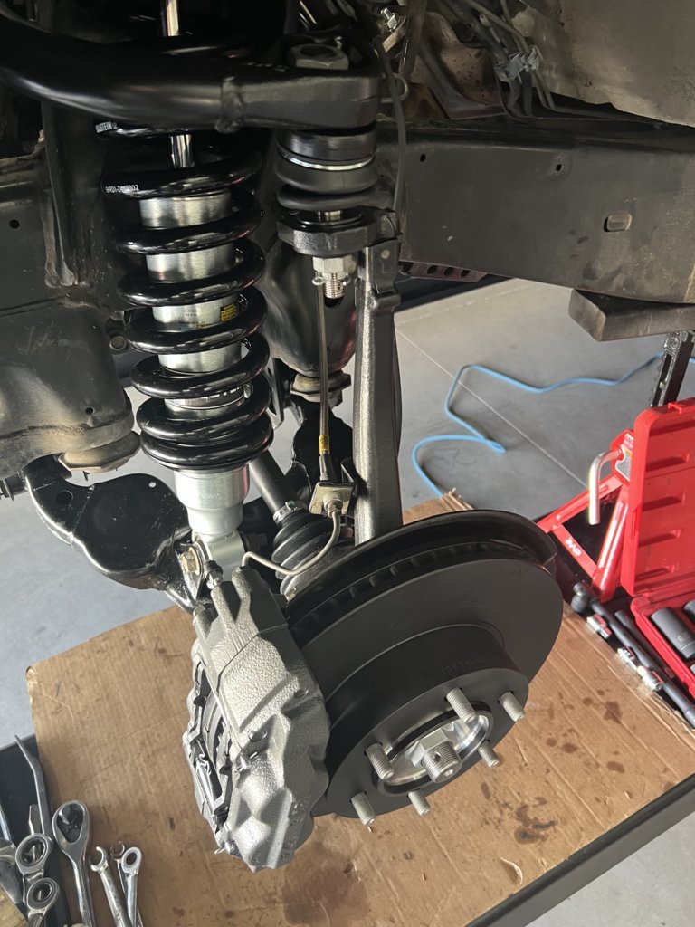

    4wd and the tool i seen in the videos was hub and wheel bearing replacement set uploaded pic of it looks like I should be able to

    It’s a big job buddy, if not a shop press you will need the special tools and ingenuity. It may be easier to replace the knuckle as a whole with pressed in fresh bearings

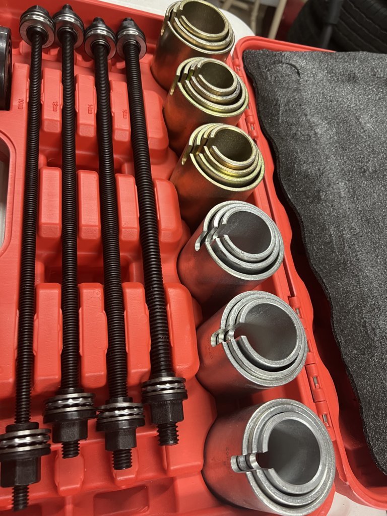

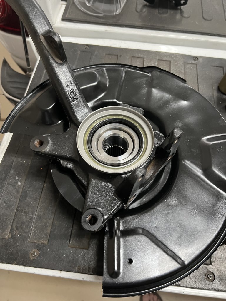

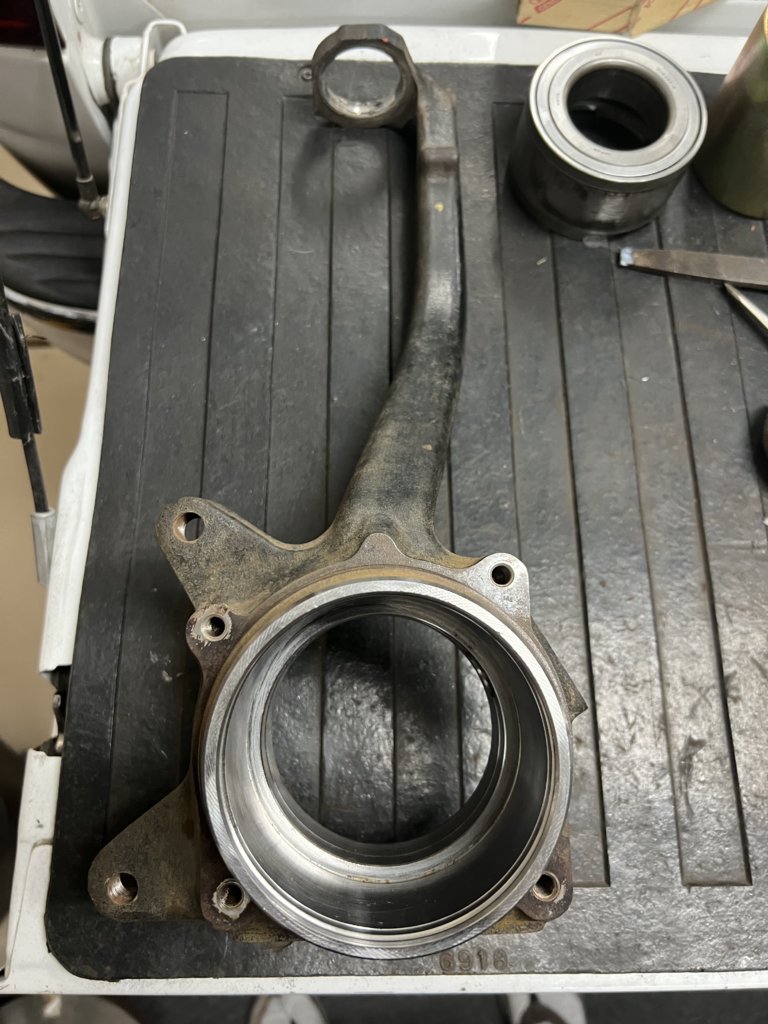

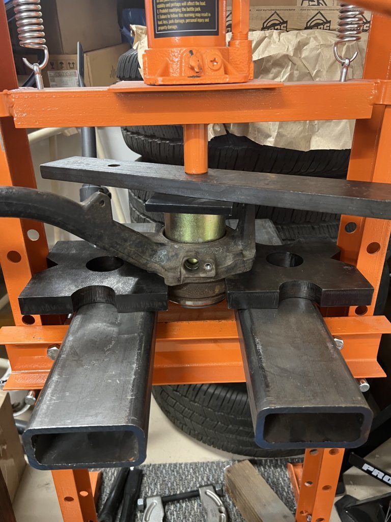

    12 ton press along with the bushing install set no problem. I just used the sleeves with the press, didn’t try the threaded rods. This is a Sequoia spindle pictured but same part numbers for bearing, hub, and inner/outer seals.IMG_2819.jpg IMG_2785.jpg IMG_2788.jpg IMG_2803.jpg
