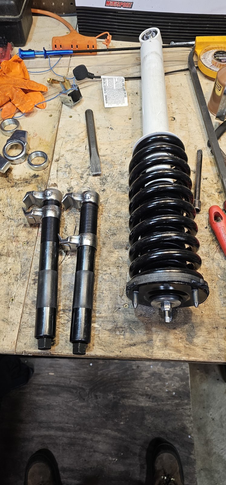

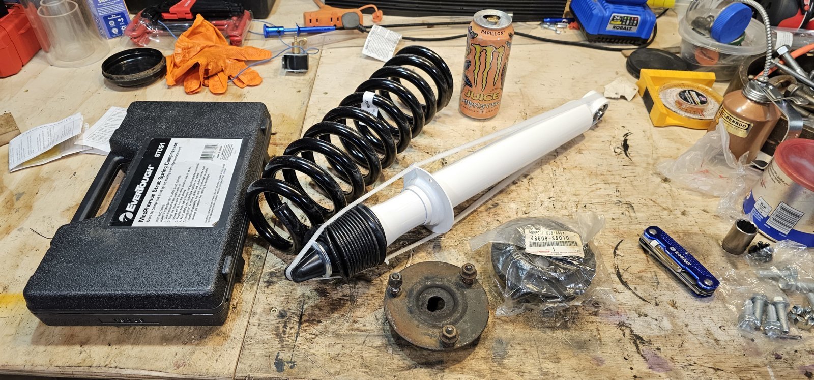

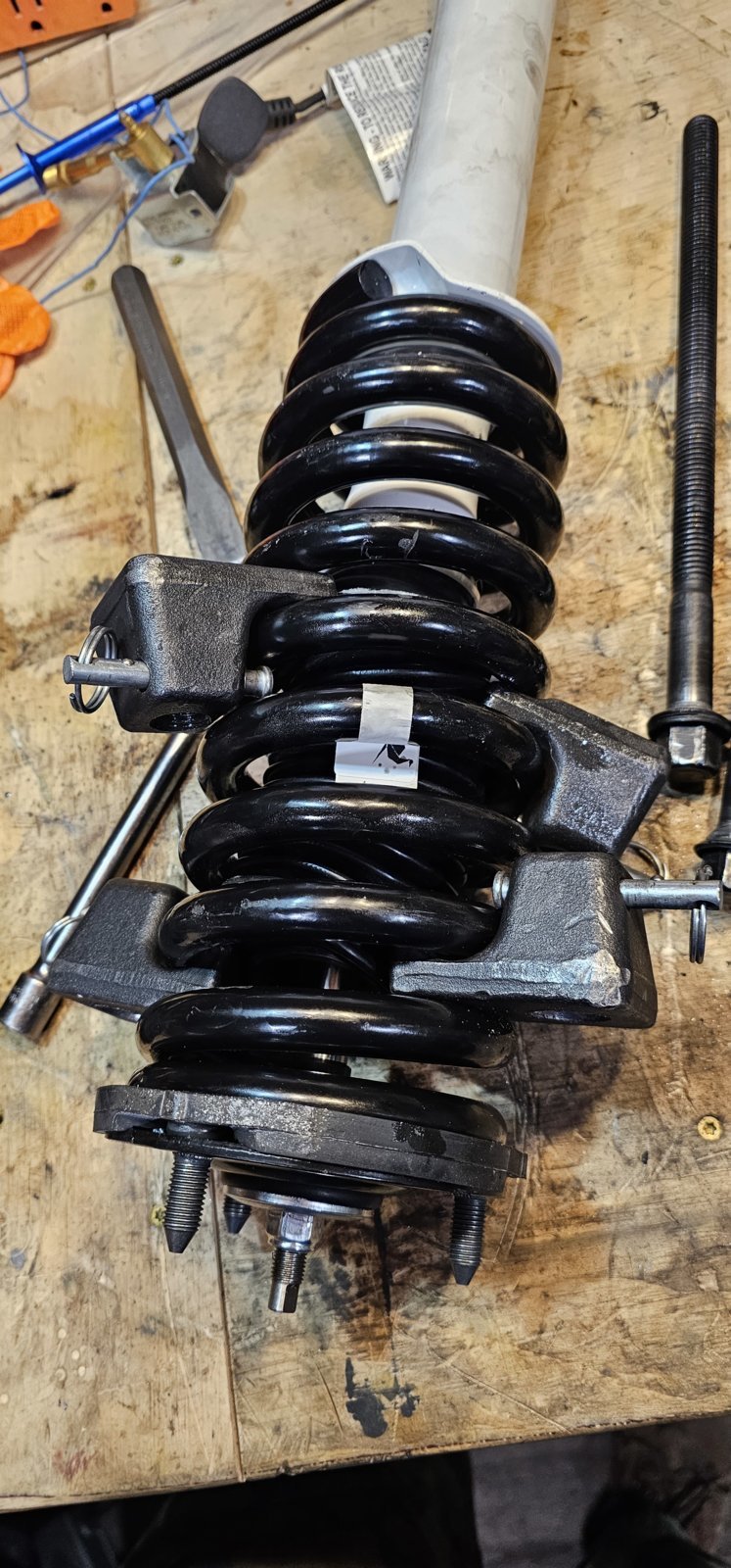

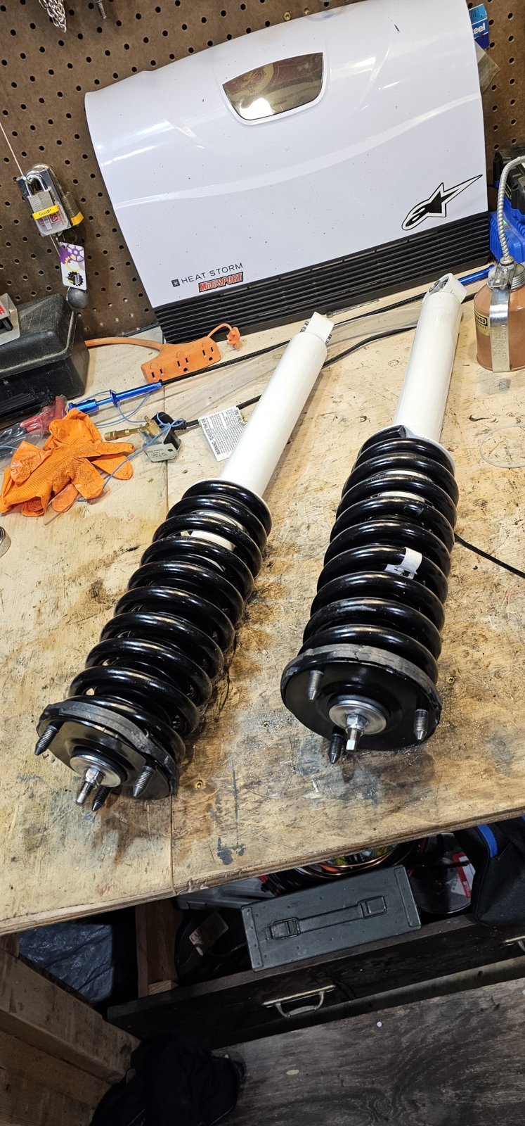

    These $40 Amazon spring compressors are significantly better than the O'Rileys lone a tool. Seems like a pretty solid tool once you remove all of the "safety" crap and grease it up a bit. I'm not certain It would have worked with all of the built-in safety "features". Anyway, got the job done and saved me $60.

    2000 TRD Offroad MT

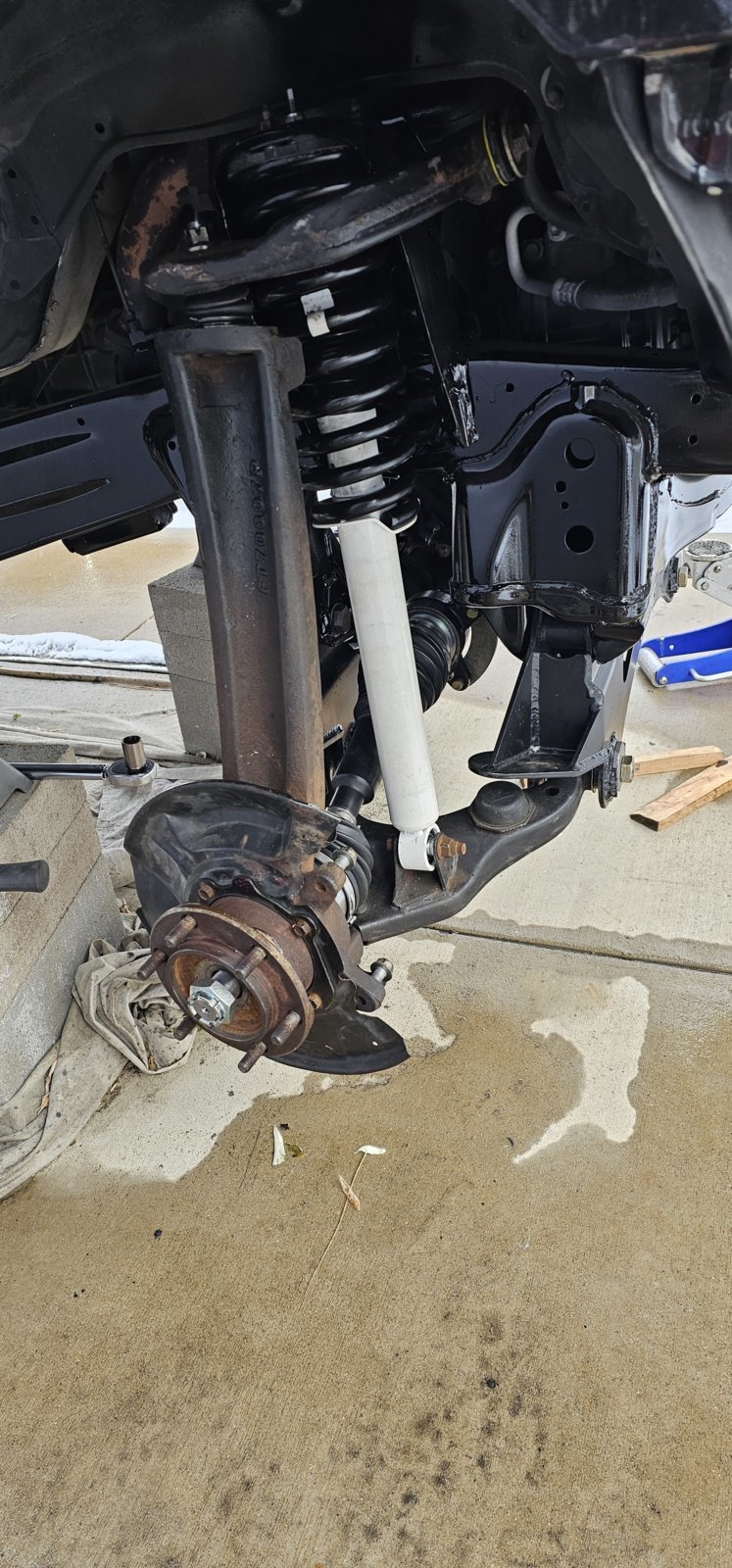

    We have dampers. Assembly wasn't too bad. I will warn potential "do it yourself ers", you have to align one of the tophat screws with the front of the shock. If you don't you'll be getting more use out of your spring compressors. The strut has to be oriented a specific way to bolt into the truck.
    I could officially put 4 wheels on the truck right now... More to do first....

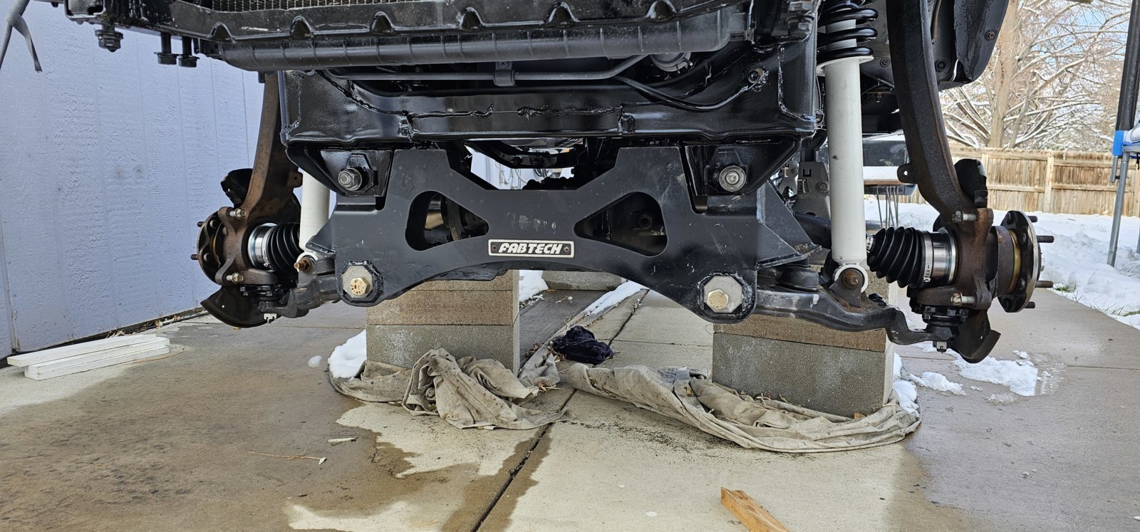

    Front and mid axles inspected and greased. Ready to go.

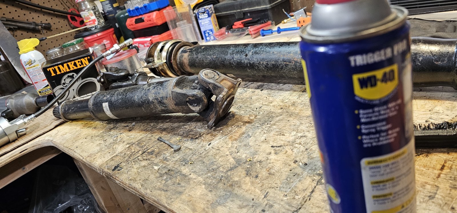

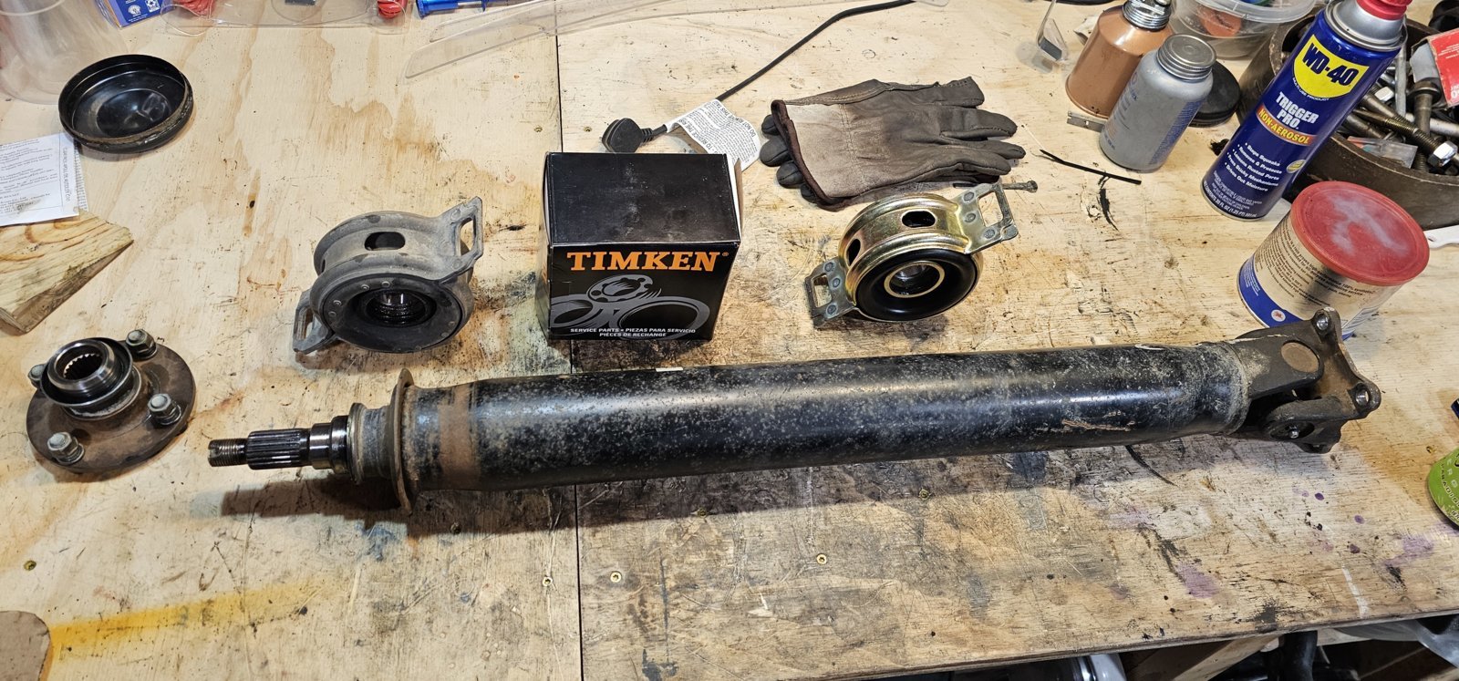

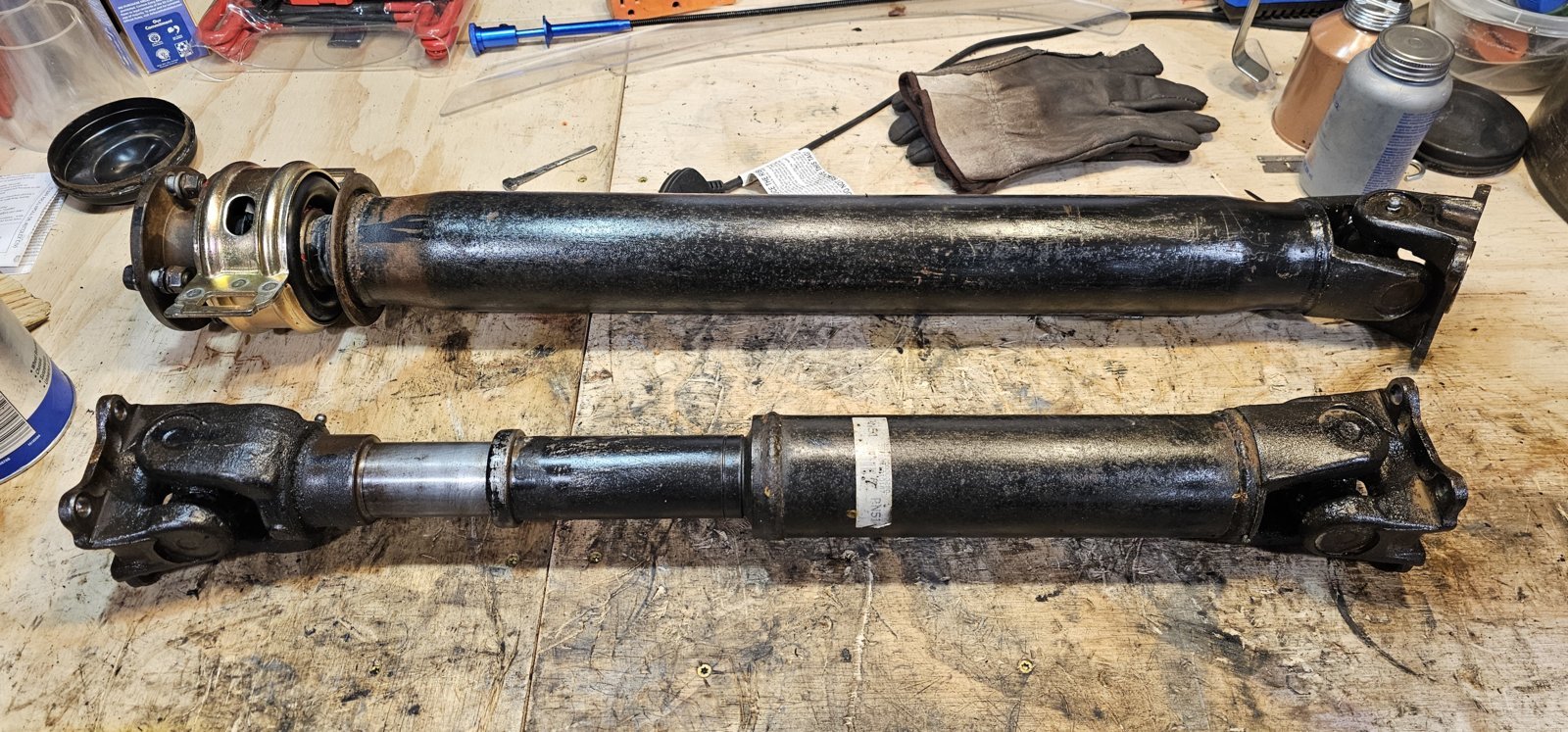

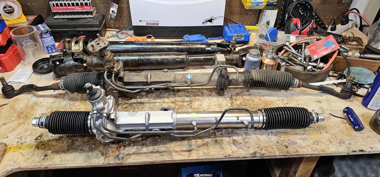

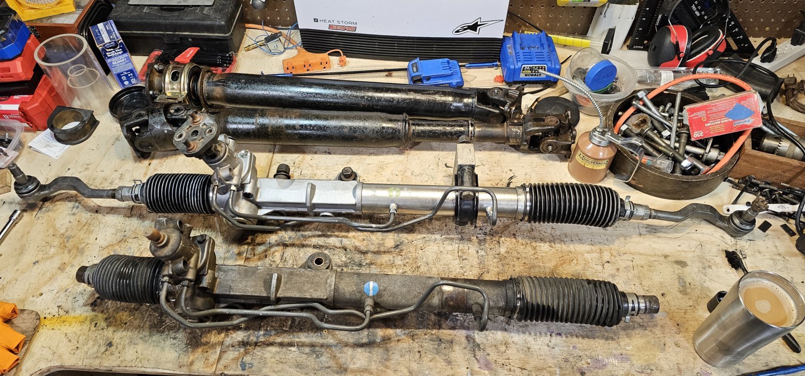

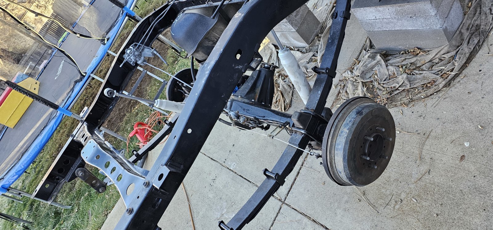

    All driveshafts have been inspected and greased. I installed the front.
    Now on to the steering rack.
  9. Dec 21, 2023 at 10:10 AM
    #209
    Dare Devil Diablo
    Dare Devil Diablo [OP] Well-Known Member
    Aug 2, 2020
    #336417
    404
    2000 TRD Offroad MT

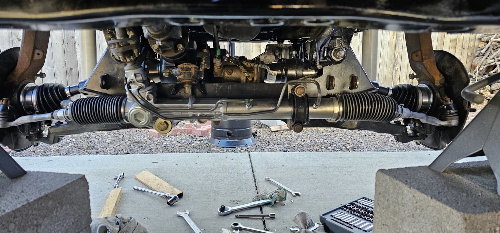

    And Viola!!!
    It was not too difficult to swap everything over. Surprisingly, the most difficult part was the input bushing (the thing the steering wheel shaft bolts to). It was really rusted on there. A 2 jaw puller made quick work of it... After I found the puller.

    This is where I am now. I'm about to install the steering rack into the truck. I will post up my progress as I get things done.

    Installed and torqued. On to the next.

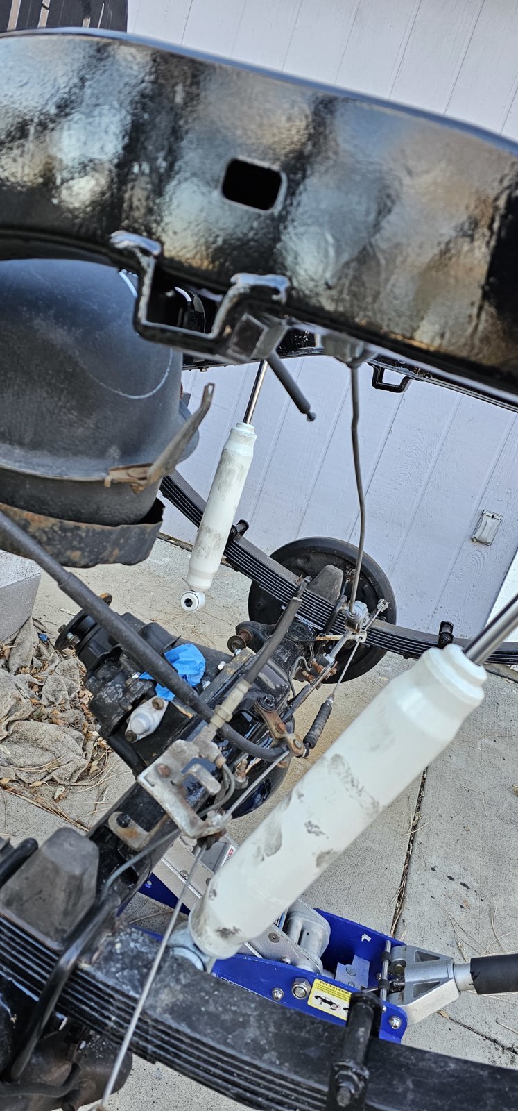

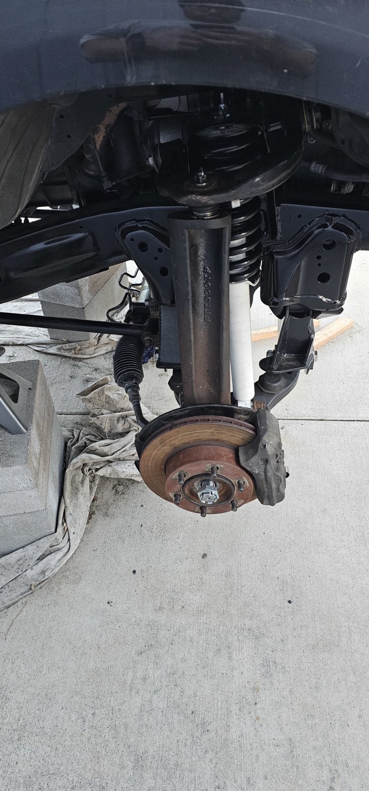

    Rear dampers go on. These are limiting my down travel but about 3" on each side. Need longer shocks.
    I ended up using a ratchet strap to compress the springs enough to connect the dampers.

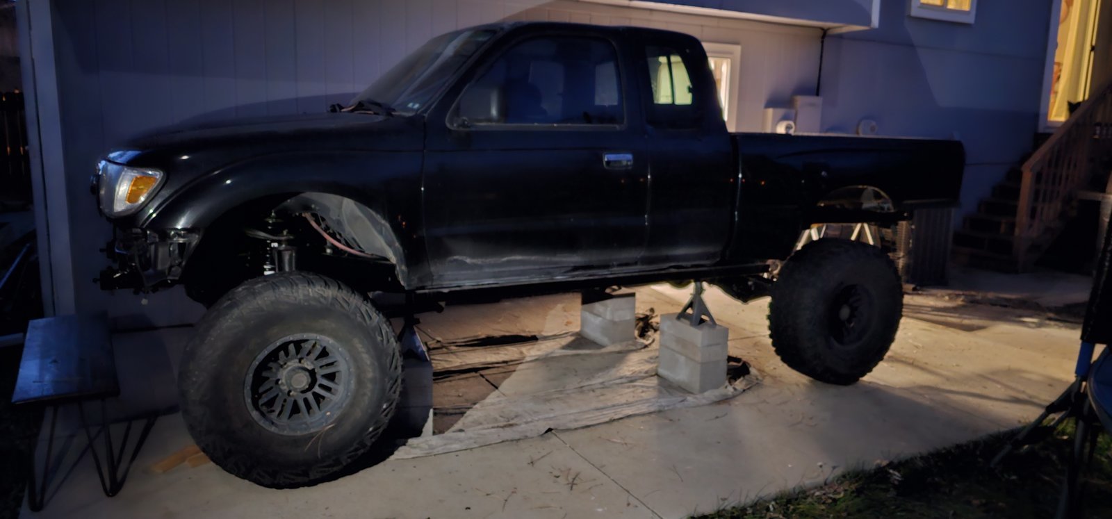

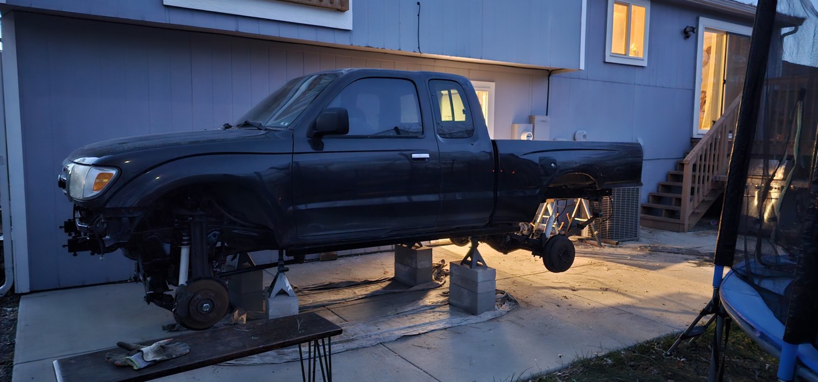

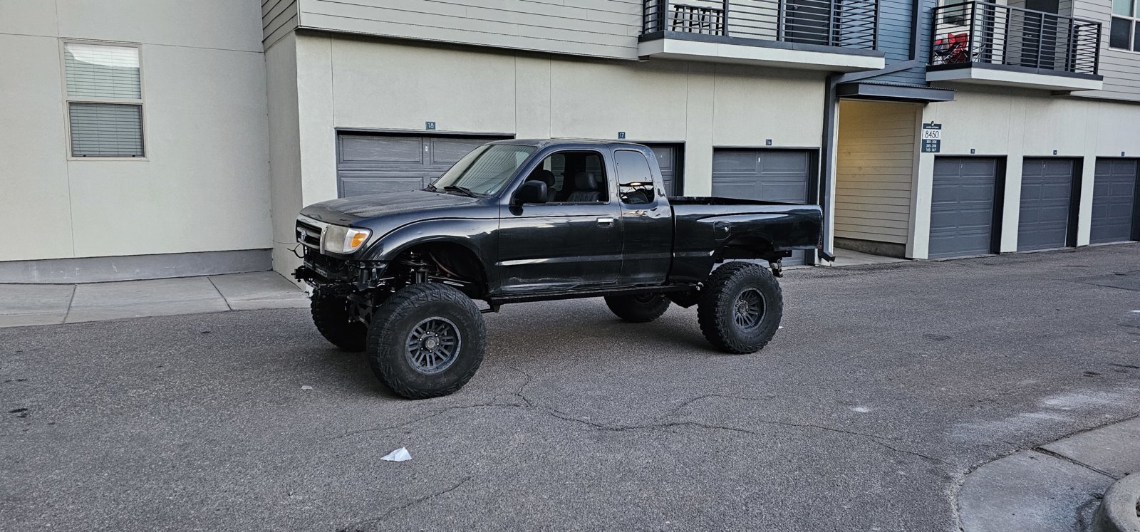

    I put on the old front brakes because I cannot afford the 37s yet and the Tundra big brake conversion will not fit in my existing 15" wheels. 20231221_162348.jpg
    Threw on the bed (it's not bolted on yet).
    Then I had to throw on 2 wheels to get the look. Getting close!!

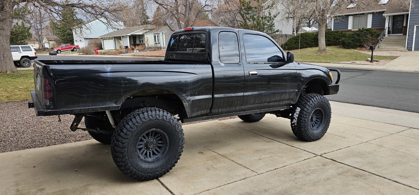

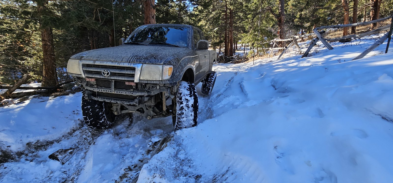

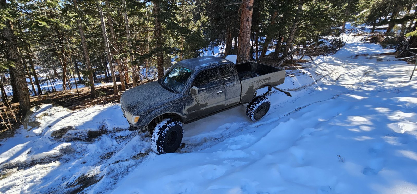

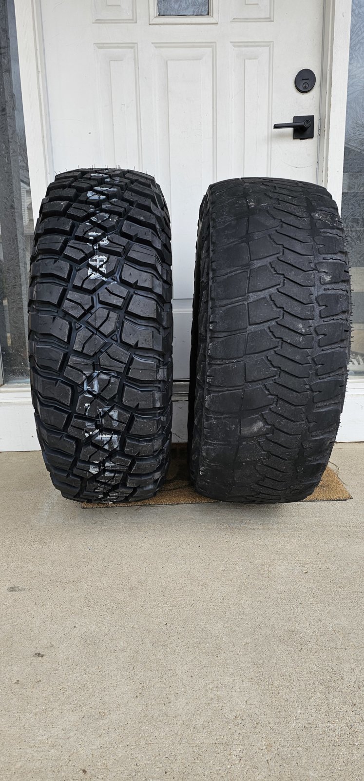

    Finally got some new tires. 35x12.5x15 BFG MT KM3. Not doing 37" yet (Too expensive). I'll stay with 35"s for a bit to see how she does. I put 6oz of balance beads in each one. I was going about 80mph on the interstate and it was smooth as butter. I'll post some pictures of her in her natural habitat once I can get out. Lotsa snow around here lately.

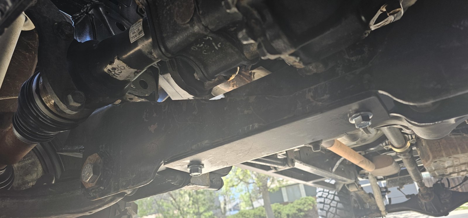

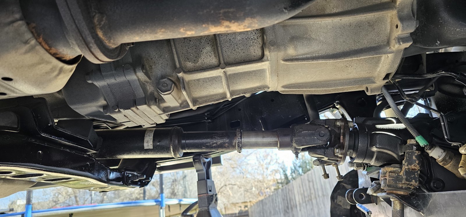

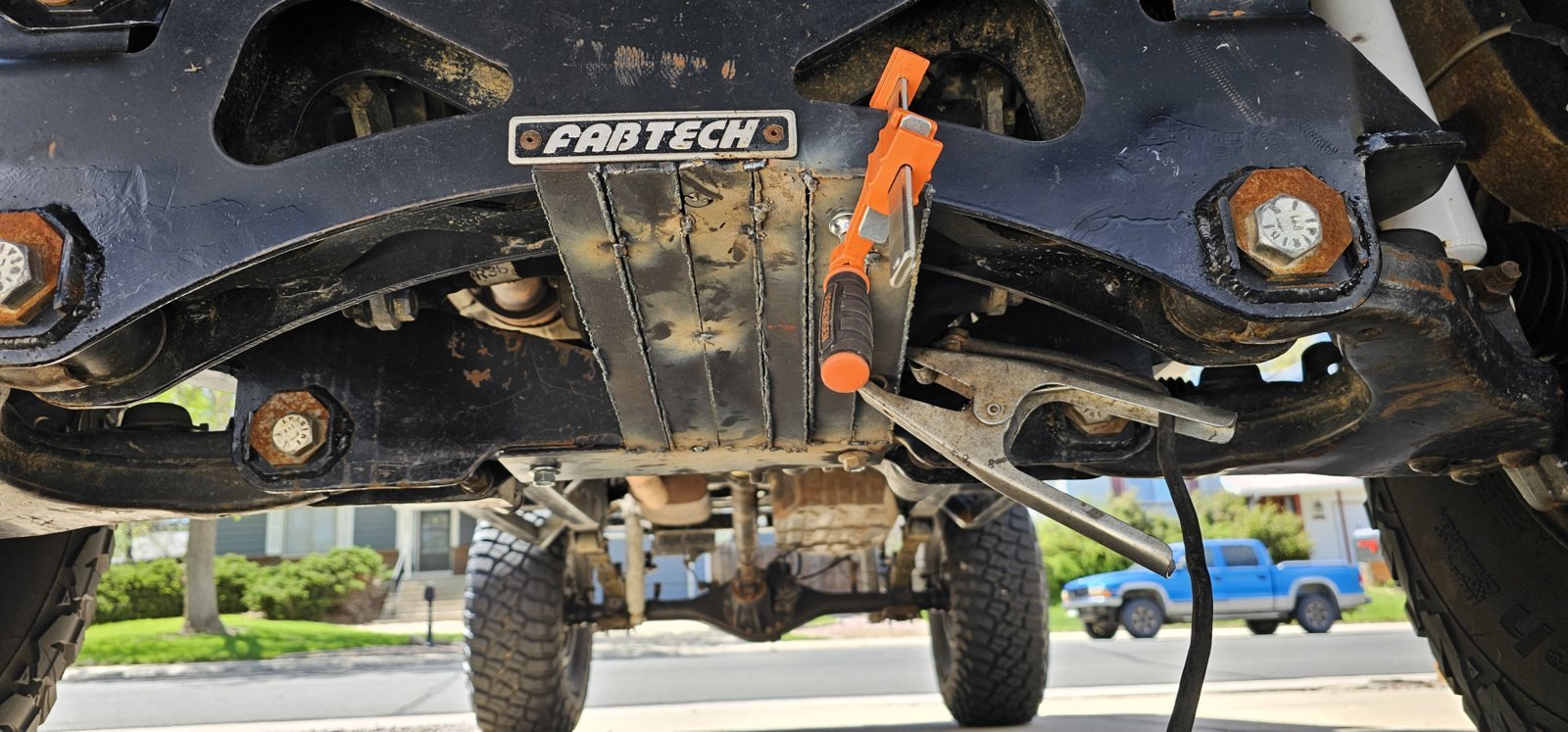

    404
    2000 TRD Offroad MT

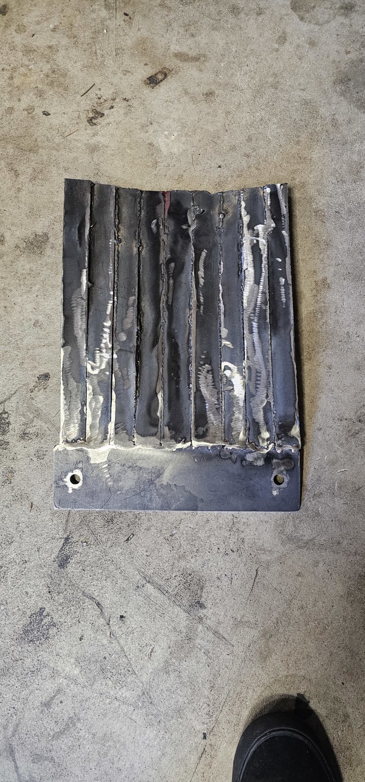

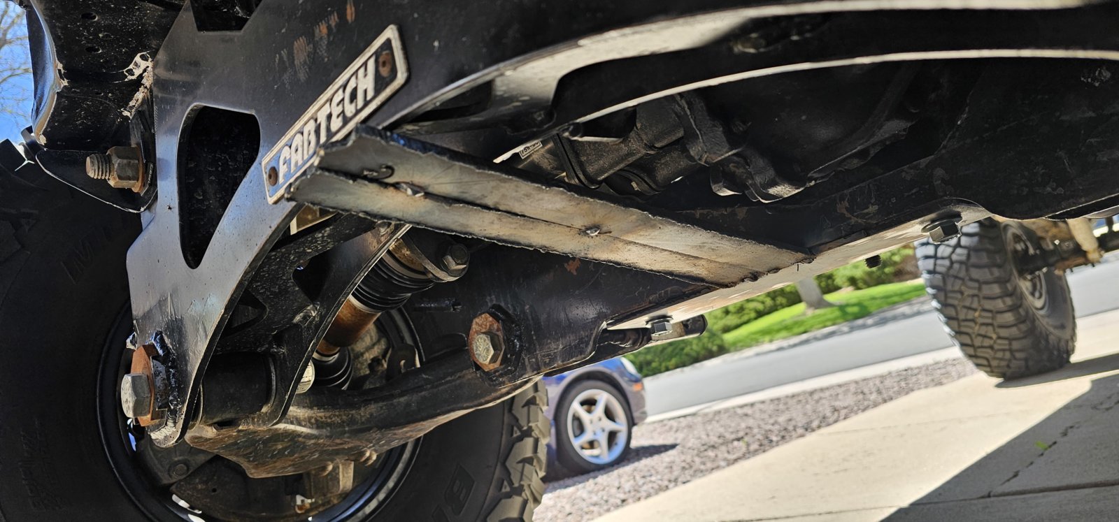

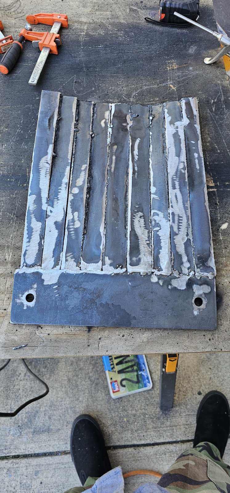

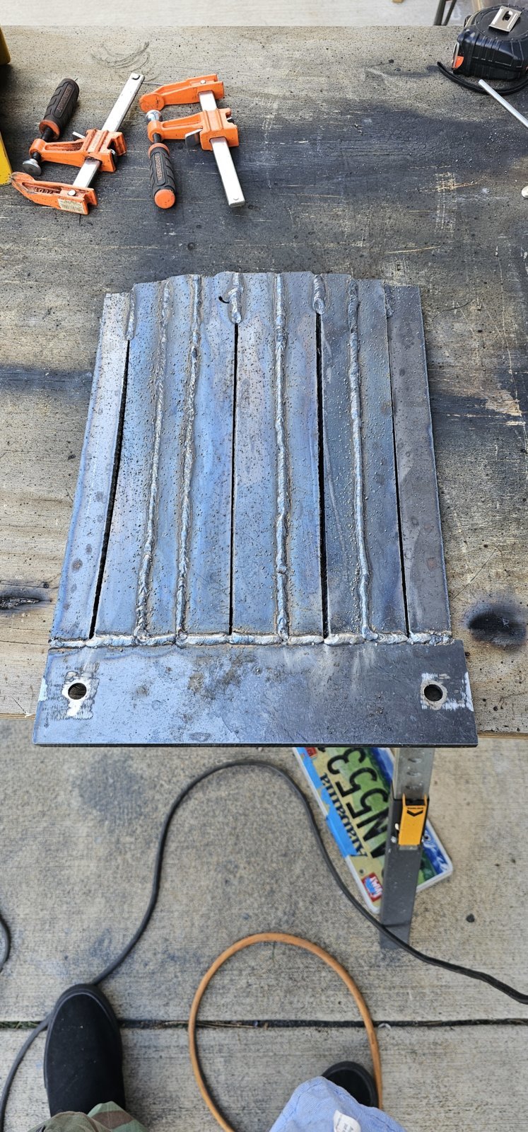

    Started on my skid plate. It's not done yet but here is where things stand. 20240430_130427.jpg 20240430_135127.jpg 20240430_141933.jpg 20240430_155719.jpg 20240430_163855.jpg 20240430_164909.jpg
