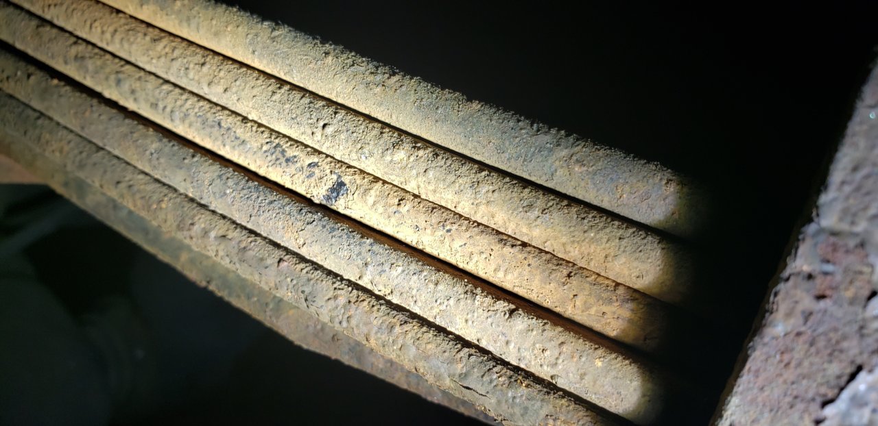

    Looks like you have a broken leaf in the second leaf spring pic. Third leaf down from the main [top] one.

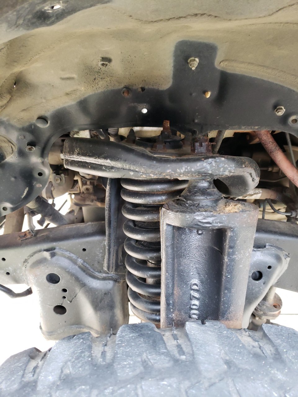

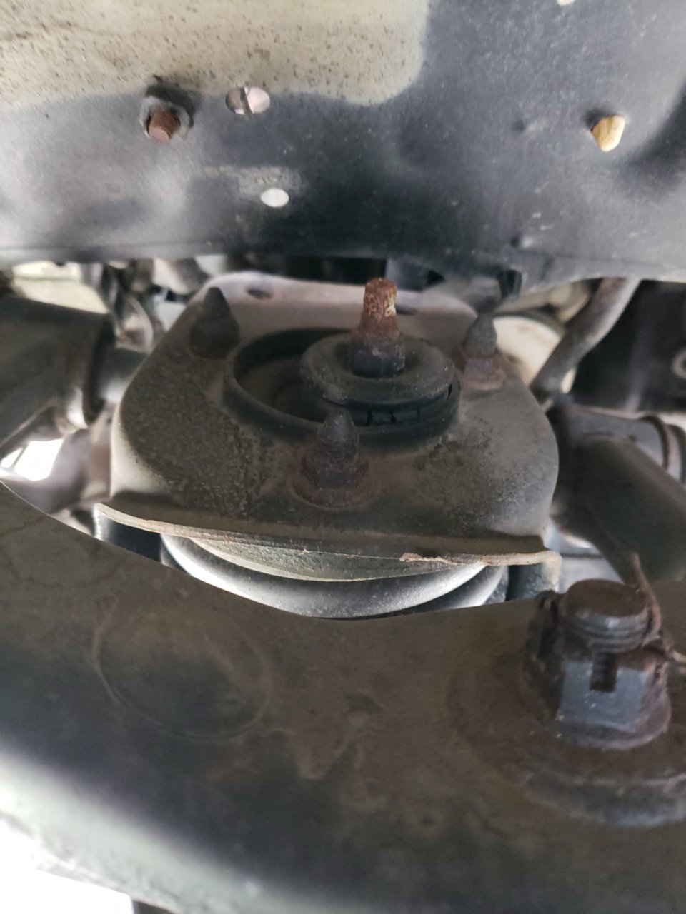

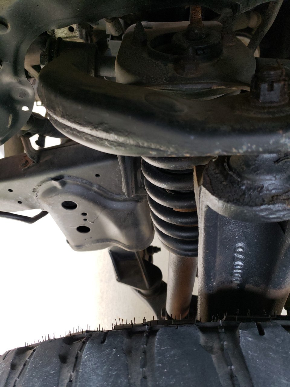

    It is kind of tough to get a good shot of the shaft but here is what I have.
    I was under the impression that the only way to put different shocks on (Besides the Fabtech) was be using some kind of large spacer or custom length stuff. Show me im wrong. I'd love to put some 5100s on here as opposed to the Fabtech stuff.

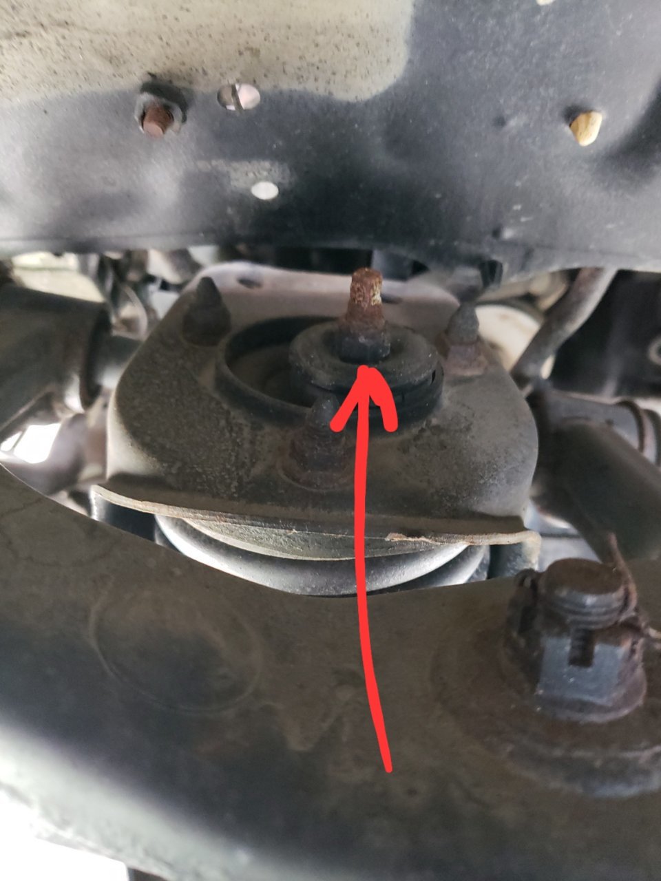

    whoa.... I would be VERY to EXTREMELY careful that front end apart. I don't think you have a bent shock, so much as another part (either the top plate itself, or a locating member) has given up. But you're going to need to dig into that before proceeding.

    So you have some long ass shocks, usually those kits have a large spacer and stocks shocks. Either source some big spacers and regular shocks or get some long ass shocks.
    Edit: i would source some large fabtech spacers and bilsteins.

    Shock isn't bent, it just relocated itself.

    I know the shock relocation mod is popular, but usually there's welding and cutting involved.

    Ensure, the frame is sound. I know you mentioned frame is good...but that rust on that leaf pack even is bad.
    Look into replacing not just your shocks (front and rear) but your front coils as well as your leaf pack.

    Yes, the shock is bent and it looks like at least 2 of the bolts in the top hat have sheared.

    Just a suggestion but, I'd consider getting some reinforcement plates welded on top of those coilover buckets.
    It's not common that they crack, but enough hard wheeling can cause them to fail. I can only imagine what that truck's been through for a shock to get bent and it's for that very reason that I recommend reinforcing it.
