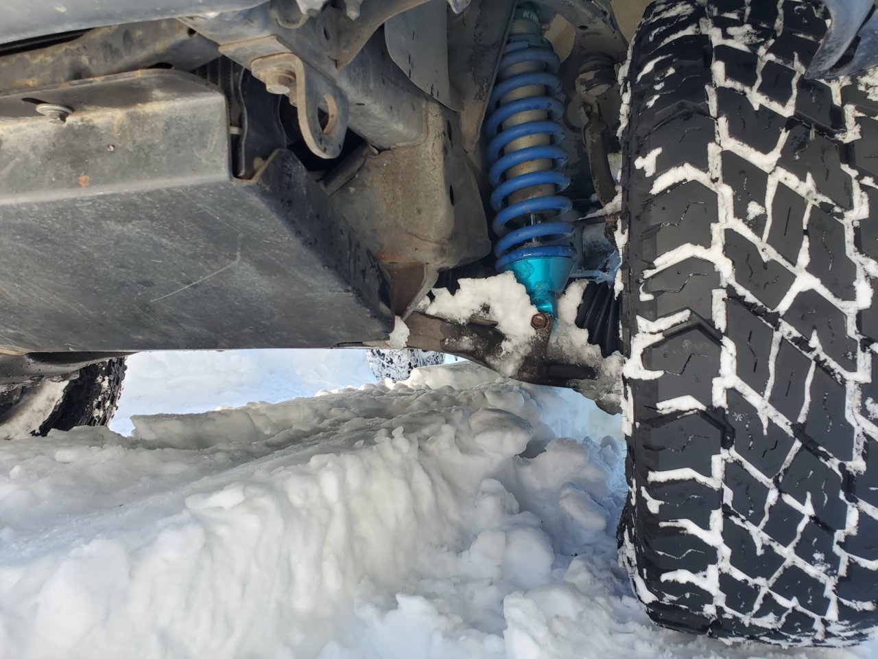

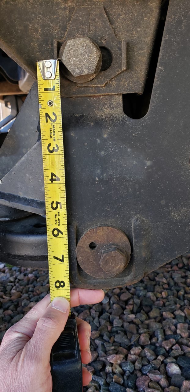

    20220809_102447.jpgCan anyone confirm or deny that their 6" Fabtech drop bracket actually drops the LCA pivots by 7"?
  7. Aug 10, 2022 at 8:40 AM
    #47
    Kwikvette
    Feb 27, 2019
    #284735
    81,638
    Fresno County
    4 run, 2 don't
    Your shocks and coils are simply clapped out (completely) which is why your lower control arms are pretty much parallel to the ground.
    They normally have a bit of an angle.
    It's also why you're resting on your bumpstops.
  8. Aug 10, 2022 at 8:42 AM
