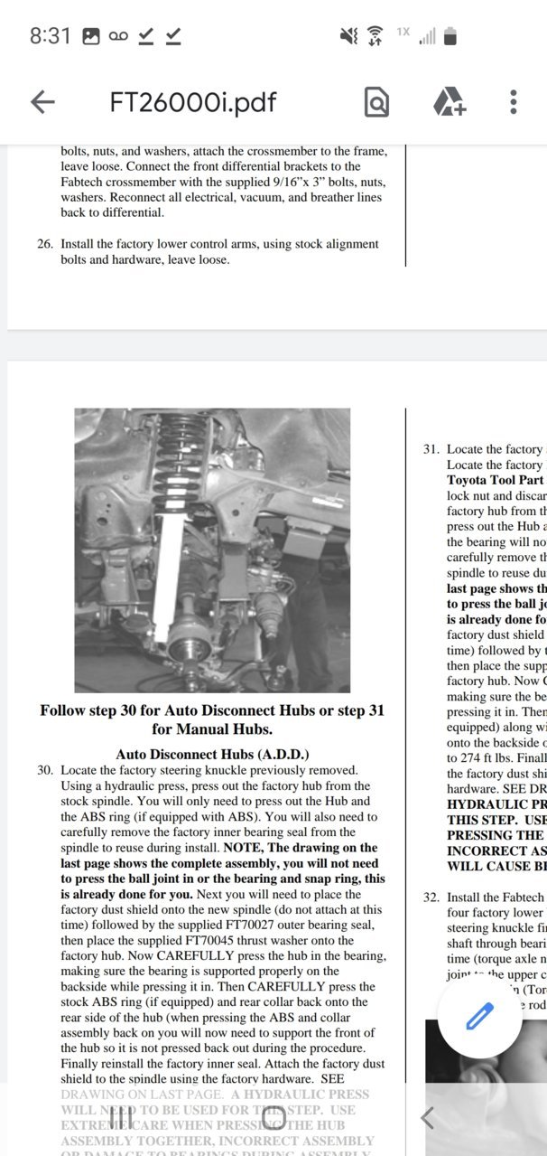

    I screen shoted this from fabtechs website, it looks like a long ass shock with a stock coil spring, no spacer.
    Dare Devil Diablo[OP] likes this.

    Yes the Fabtech kit is designed to be used with stock springs. I am concerned the stock springs will sag due to the weight of the bumper, winch, skids etc.
    I called Fabtech and the were zero help. "Uhhh springs? We only suggest stock springs. You'll have to talk to a spring company..."
