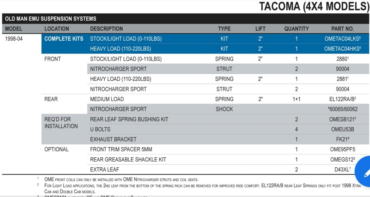

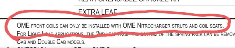

    So this ARB chart specifically calls out the heavy load spring as a 2" lift. I'd guess I have more than 200lb on the front of my truck so I would not see that much lift. It also states;
    So, I'm just assuming... the Nitrocharger struts must give added lift over stock as well...
    Just alot of assumptions here...

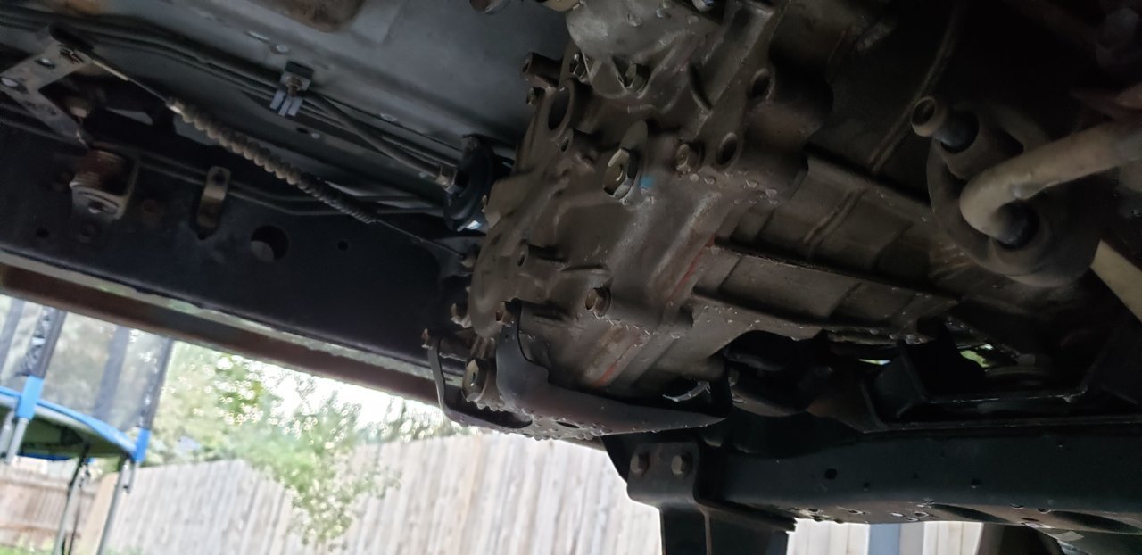

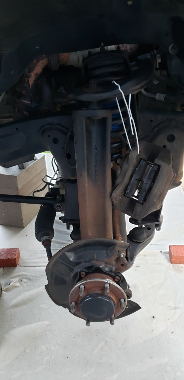

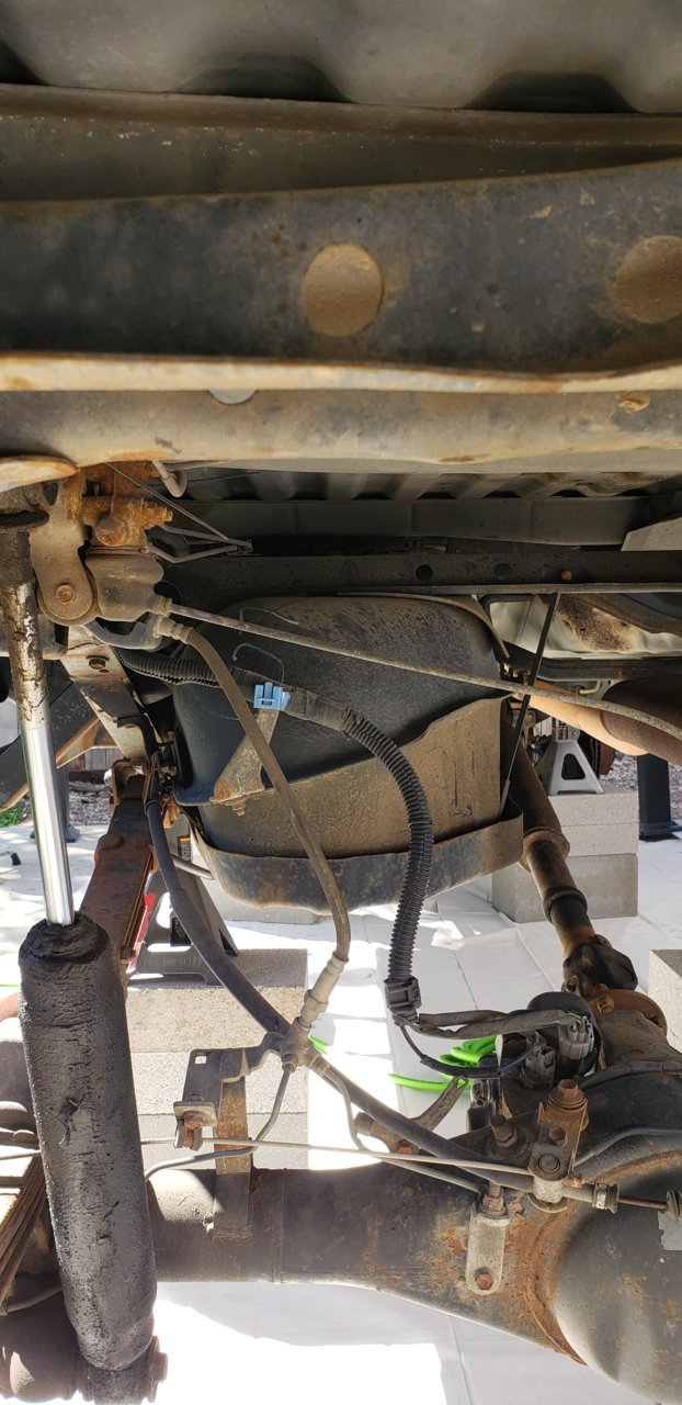

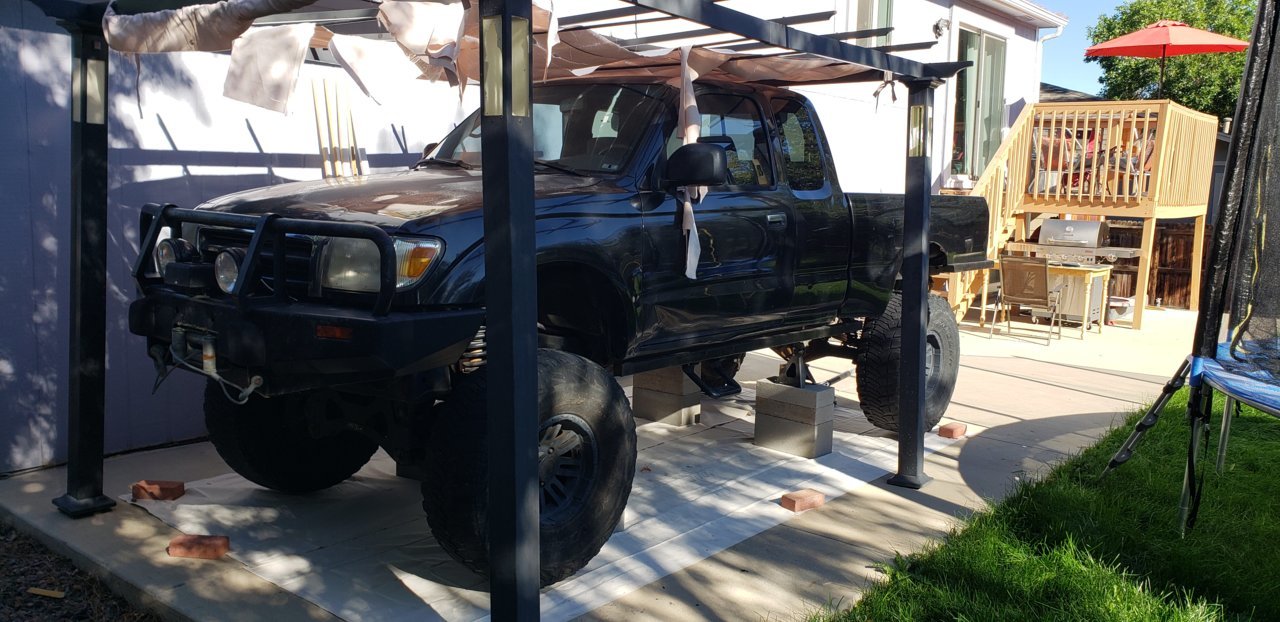

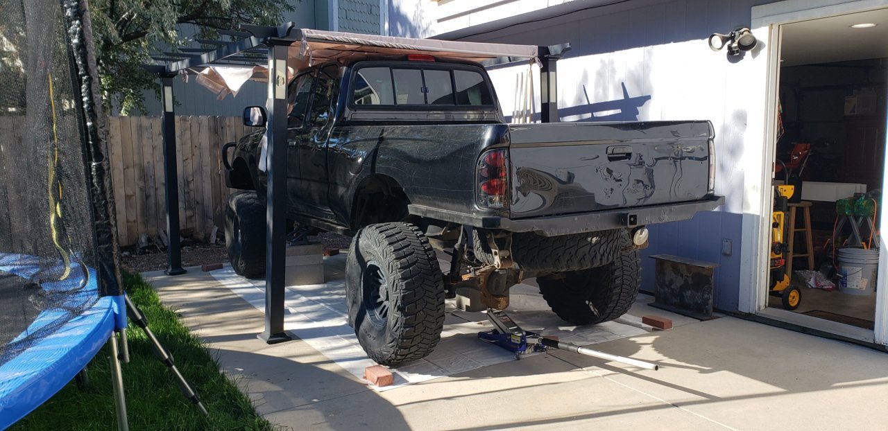

    Whelp, I finally got started today. So many things going on right now its difficult to find time. Put the ol girl up on some concrete blocks and jackstands.
    Wheels came off pretty easy, though some of the lugs (all of the lugs actually jus some more than others) were on there pretty tight. Impact didn't really want to get them off. I had to go up to 125psi on my IR Titanium 1/2" impact.

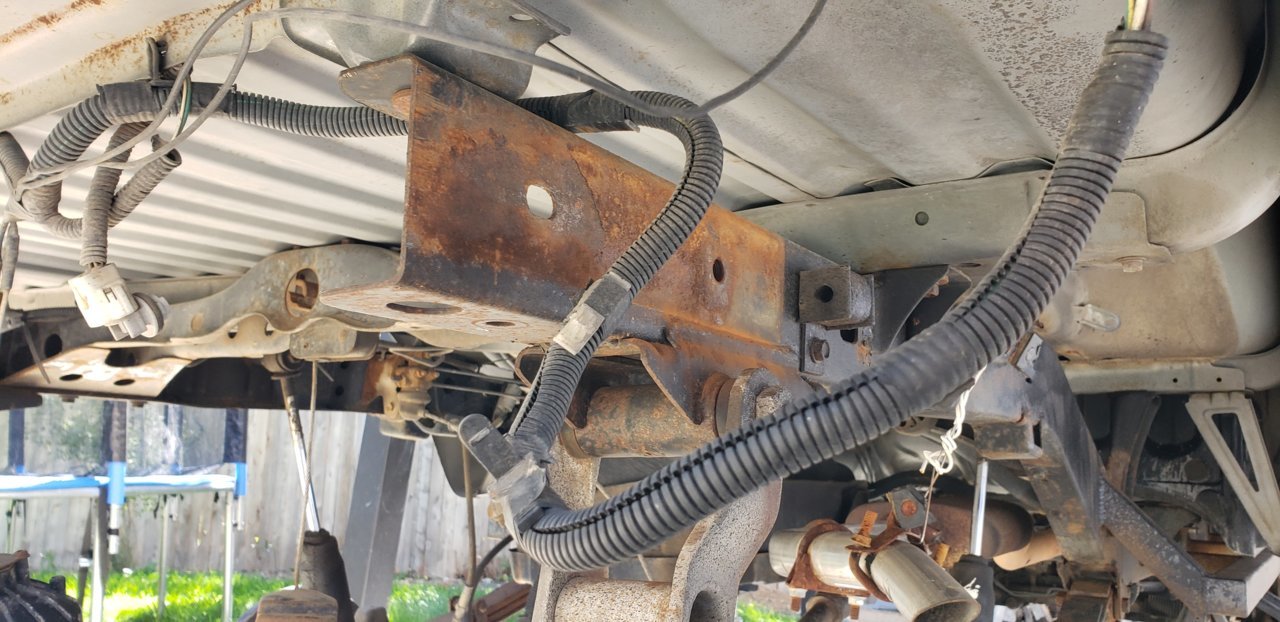

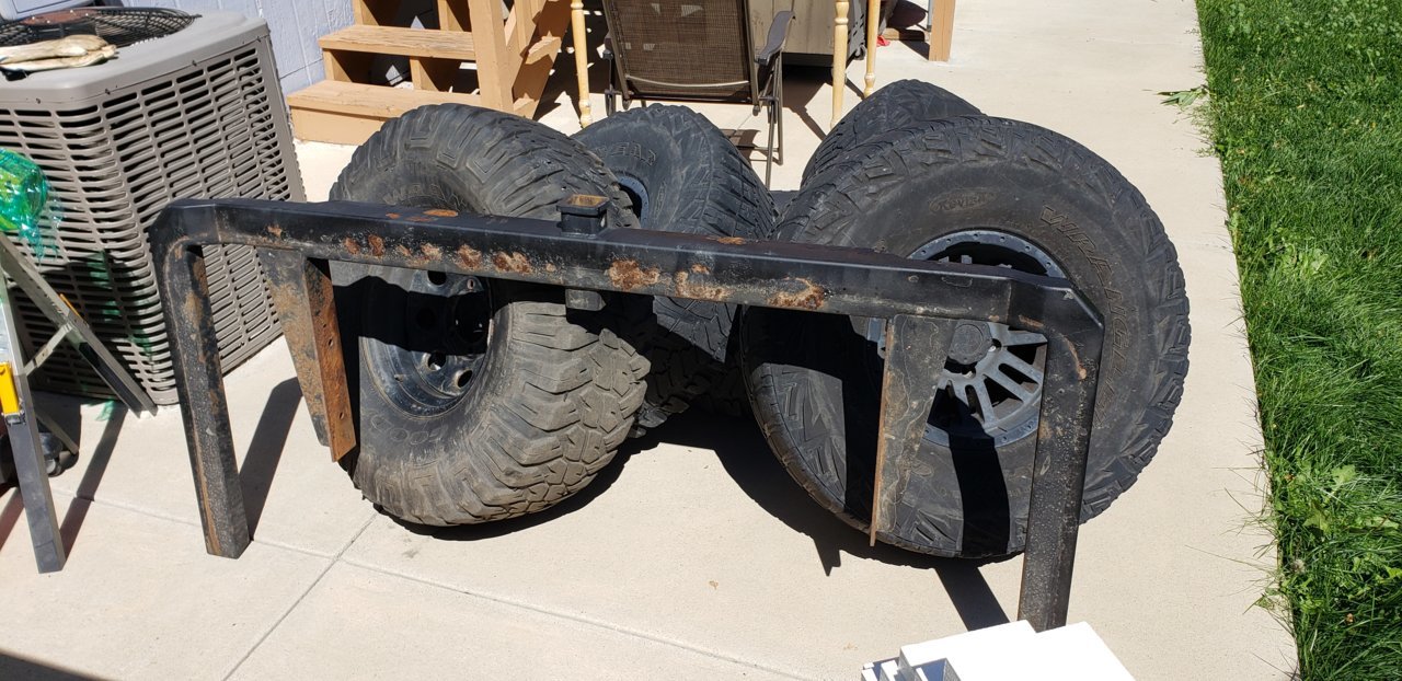

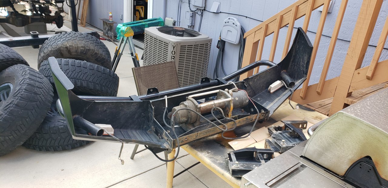

    The rear bumper was a bit worse...

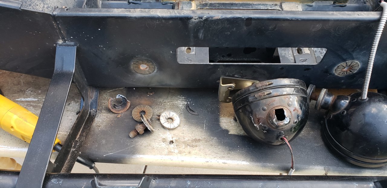

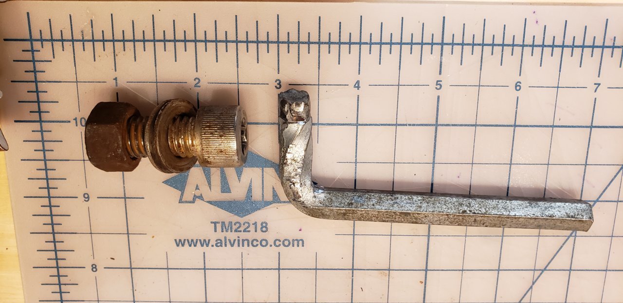

    Impact would not back these out! I had to use a 3' breaker bar and it destroyed this allen. A nicer hex ended up doing the job.
    The rear bumper was tight! Had to use a small sledge and alot of taps on each side to back it off the frame.
    The bumper itself is home made, I believe. It does seem pretty heavy duty. It does not have any weep holes in it. I will punch some holes before I repaint it.

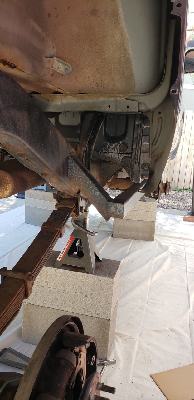

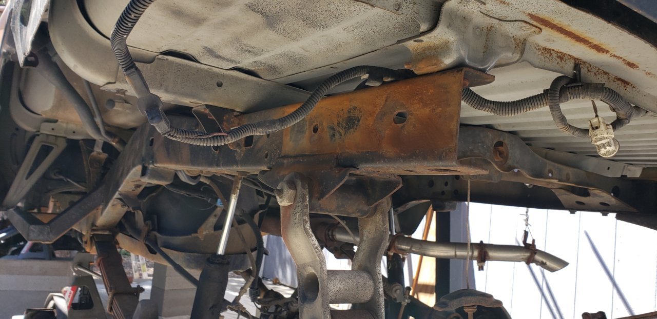

    There definitely is some rust where the bumper tied to the frame. I believe it's all surface though. I'll know better once I clean it up.

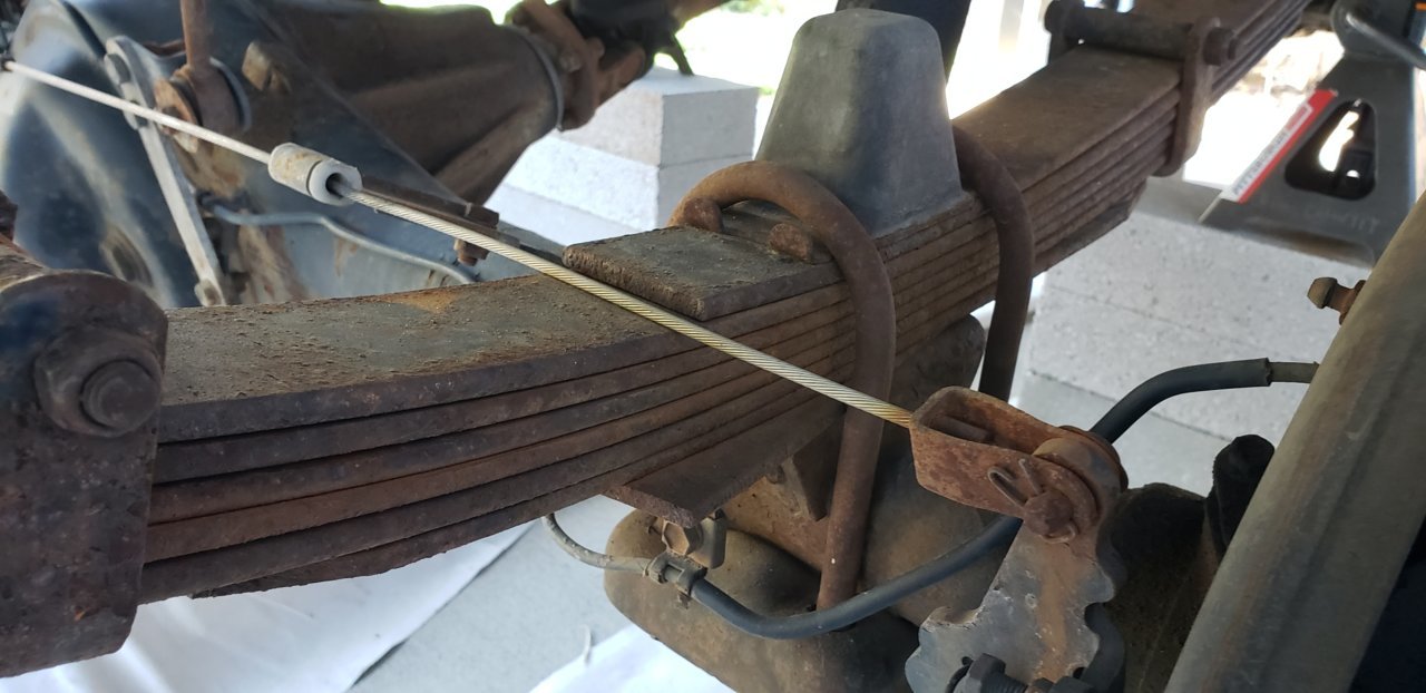

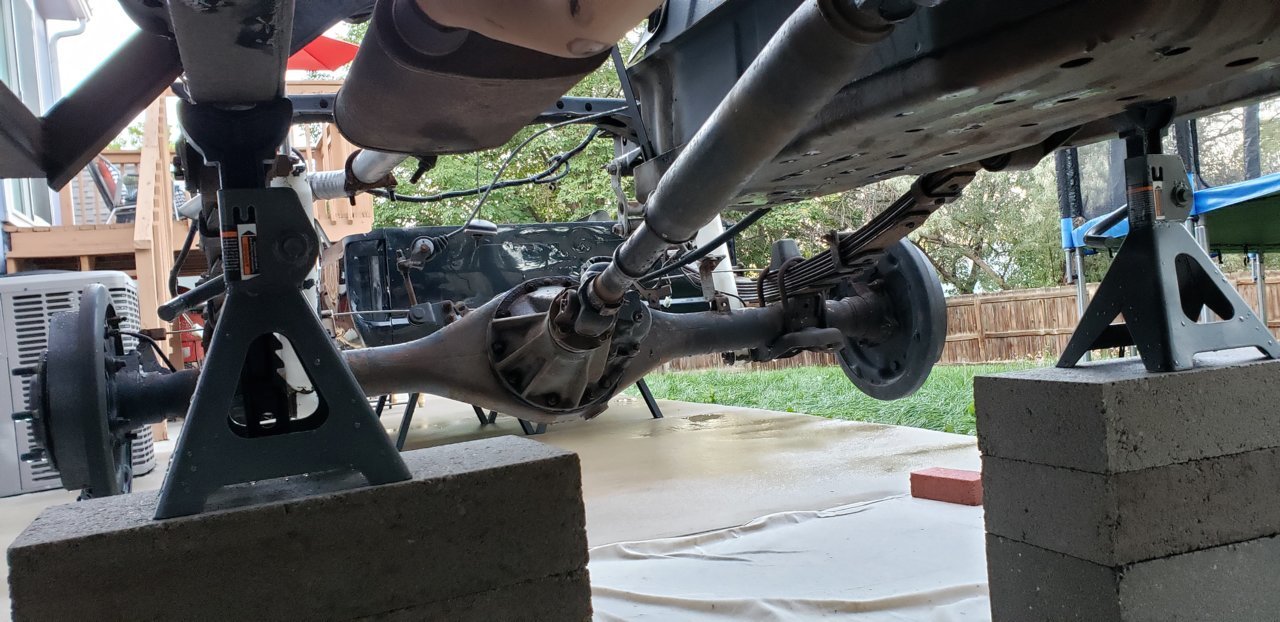

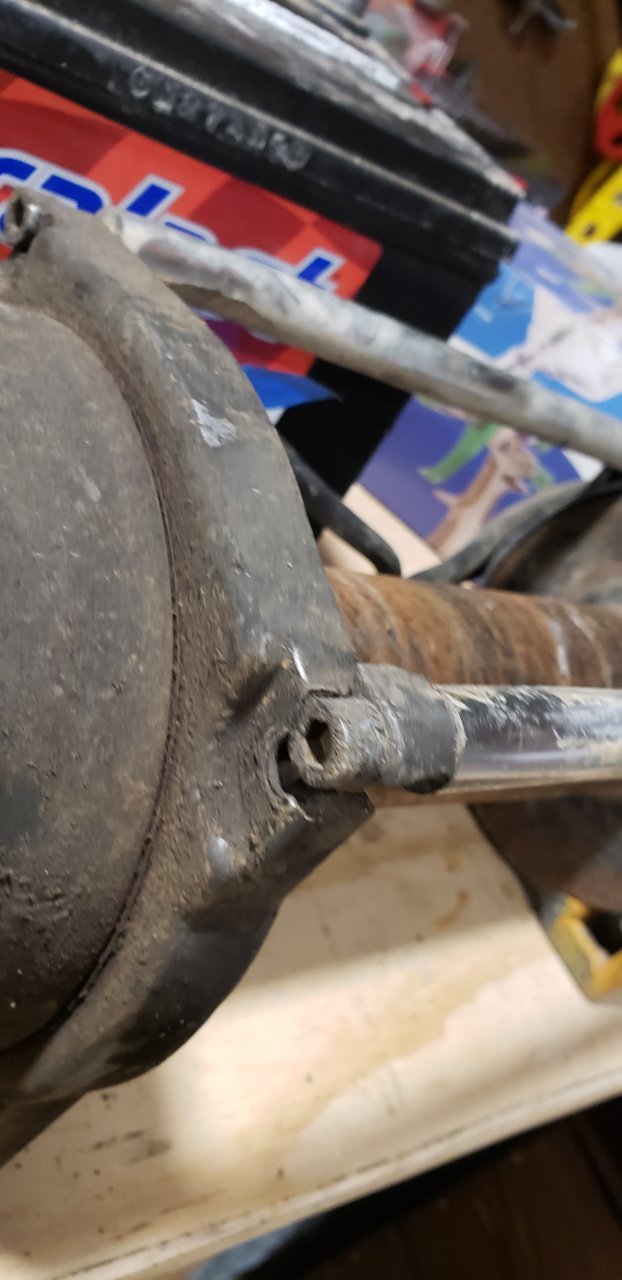

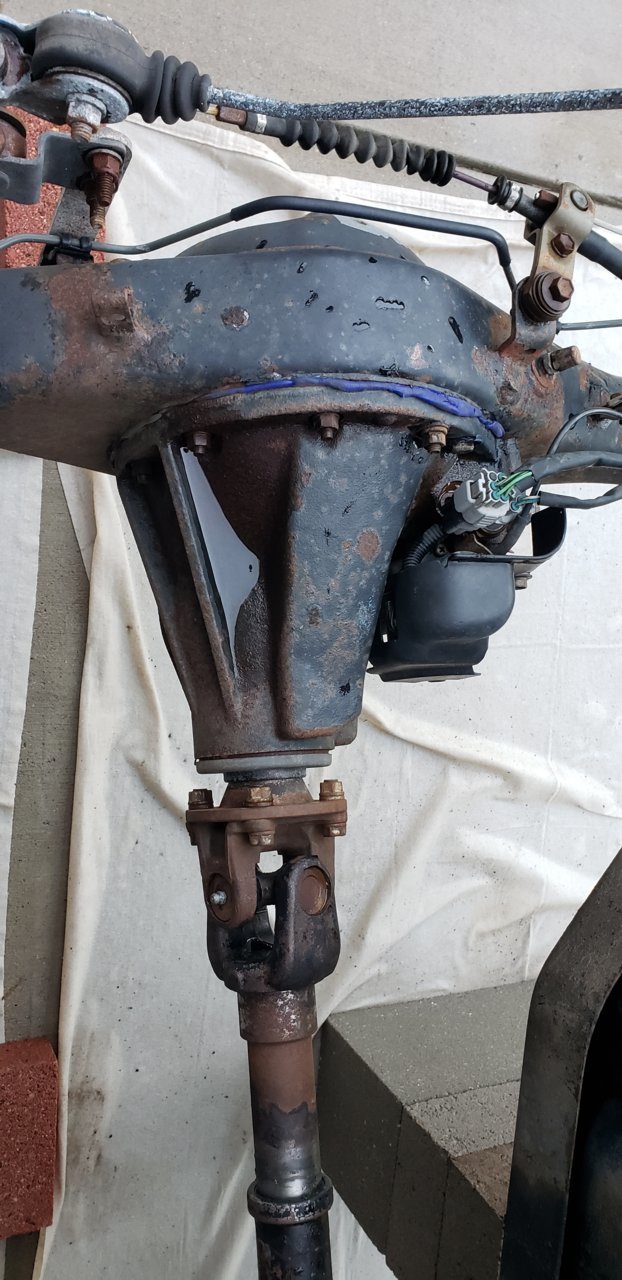

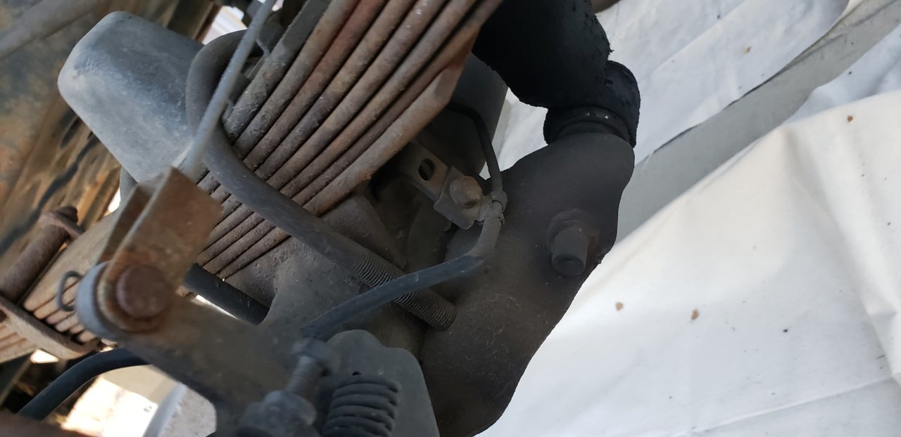

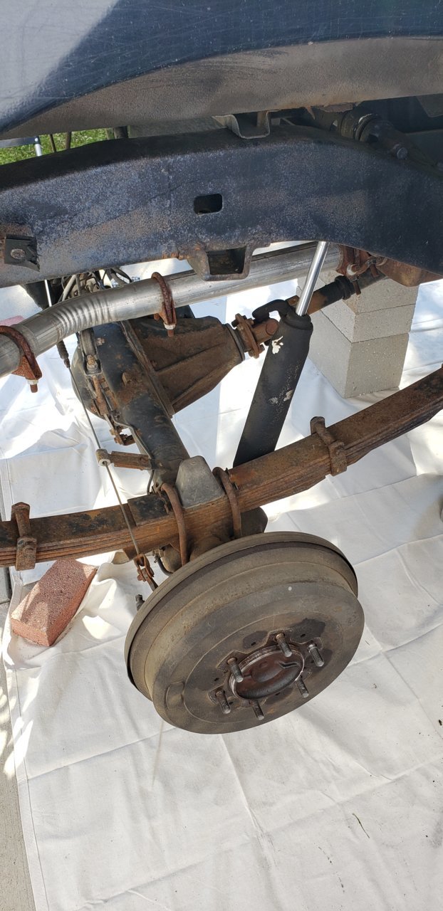

    While I'm on the rear of the truck I noticed the half leaf on top. Is this normal? I can't say I have ever seen a half leaf... May be common and I just haven't seen it. Also, the U bolts holding the leaf pack to the axle, these do not look like the correct bolts for this job. Comments? Last thing on this. You can see some of the leafs are not stacked as well as they could be. Suggestions to remedy this? Bend a couple of retainers? Not sure how I would keep them in place...

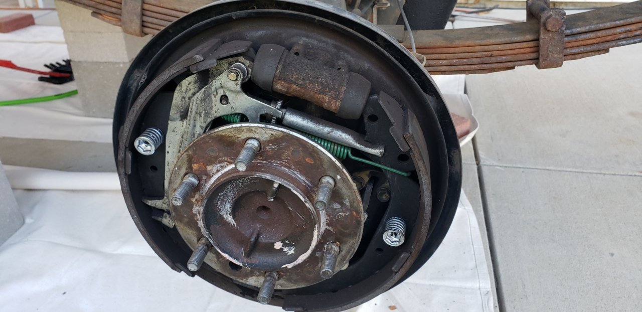

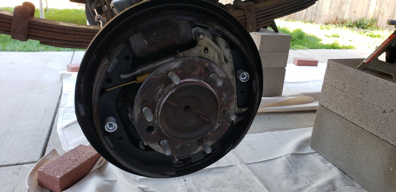

    Rear drums were serviced not too terribly long ago.

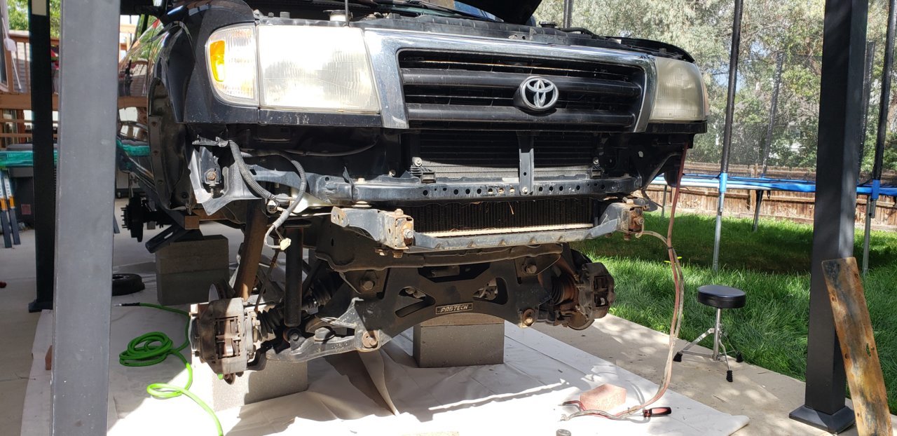

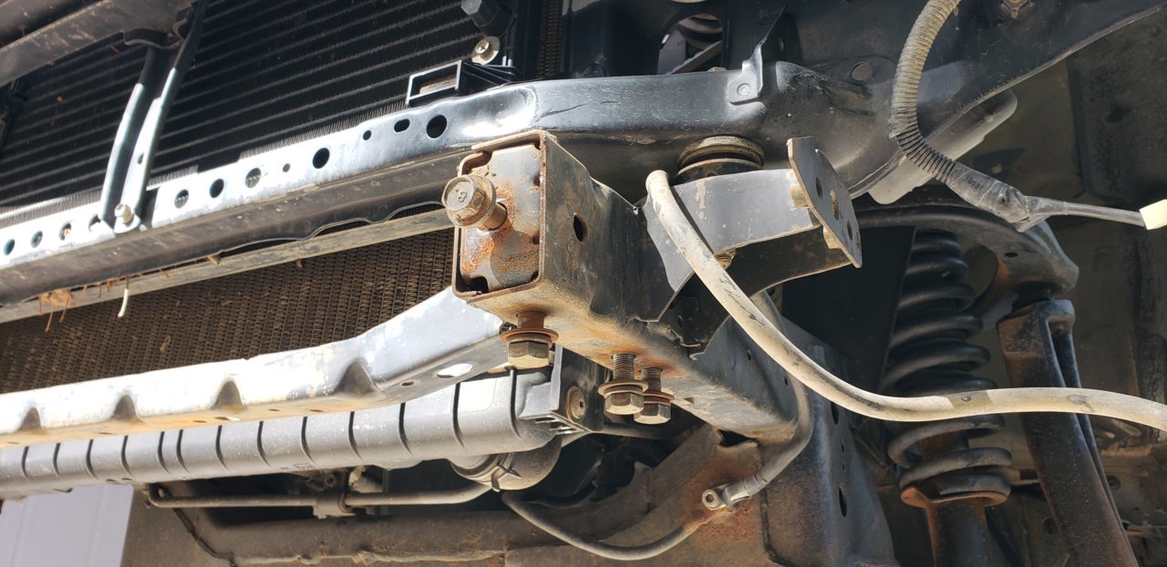

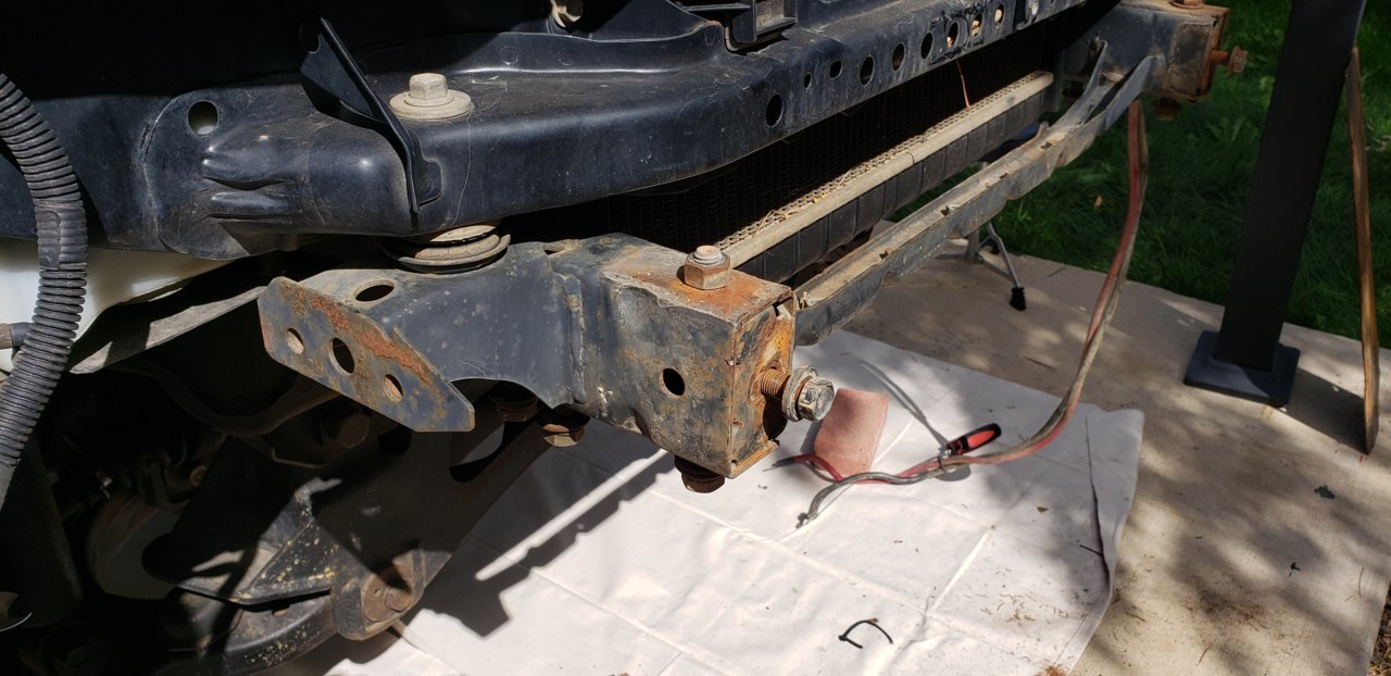

    There was definitely some rust on the front bumper. Thankfully not much of it made its way over to the truck frame. I'm thinking, a quick sand blast and epoxy prime and everything on the truck will clean up nicely. The bumpers themselves have some deeper scars but I'm just going to clean them up real good (wire wheel grind and sandblast) and prime. Not so worried about rust scars as long as they are not a structural issue. I'm not after a new looking truck.
    20220917_144057.jpg20220917_181303.jpg 20220917_181406.jpg 20220917_181421.jpg
    After pulling the bumper, I had to destroy one of the KC lights getting them off. I'll have to find some cheap Amazon replacements. The winch sucks a little more. I think the PO bound the cable up on one side of the winch and cracked the case. I will have to see if I can get replacement parts after I disassemble it further. Hopefully I can get whatever I need since its a Warn.

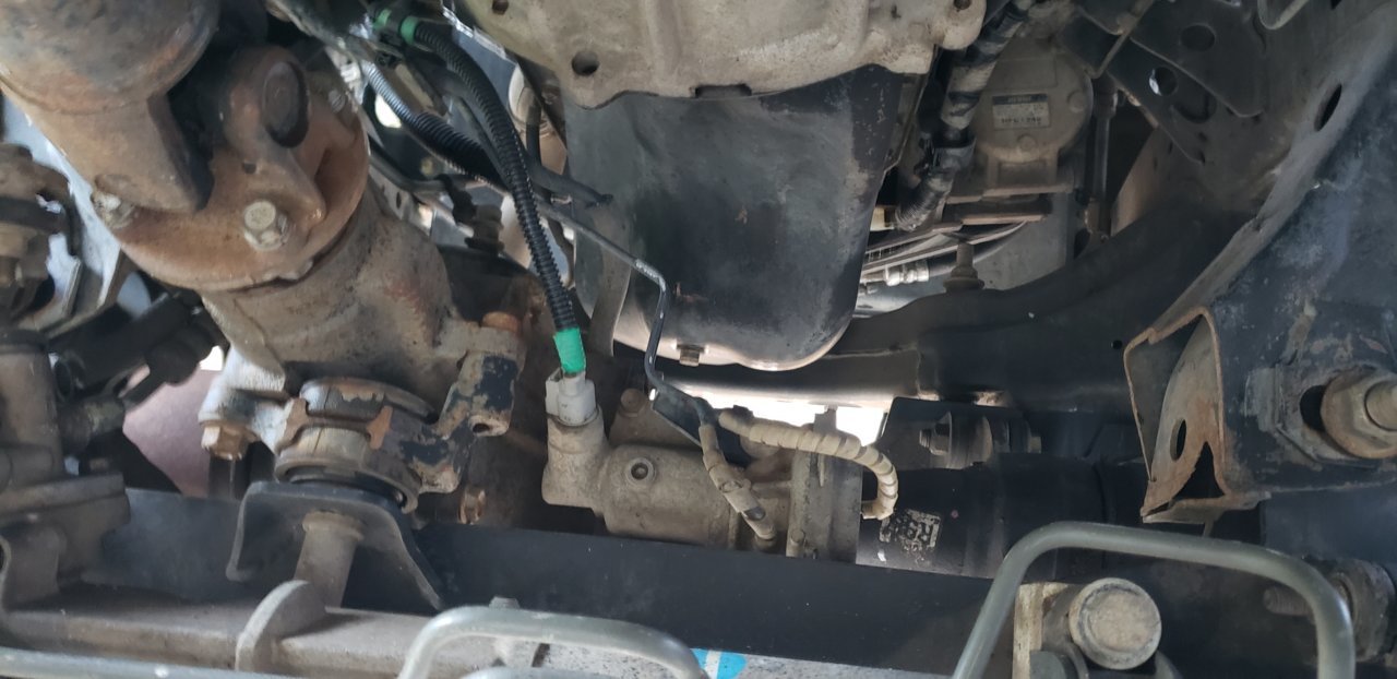

    The brake lines are all too short. I'll get some longer steel braded ones.

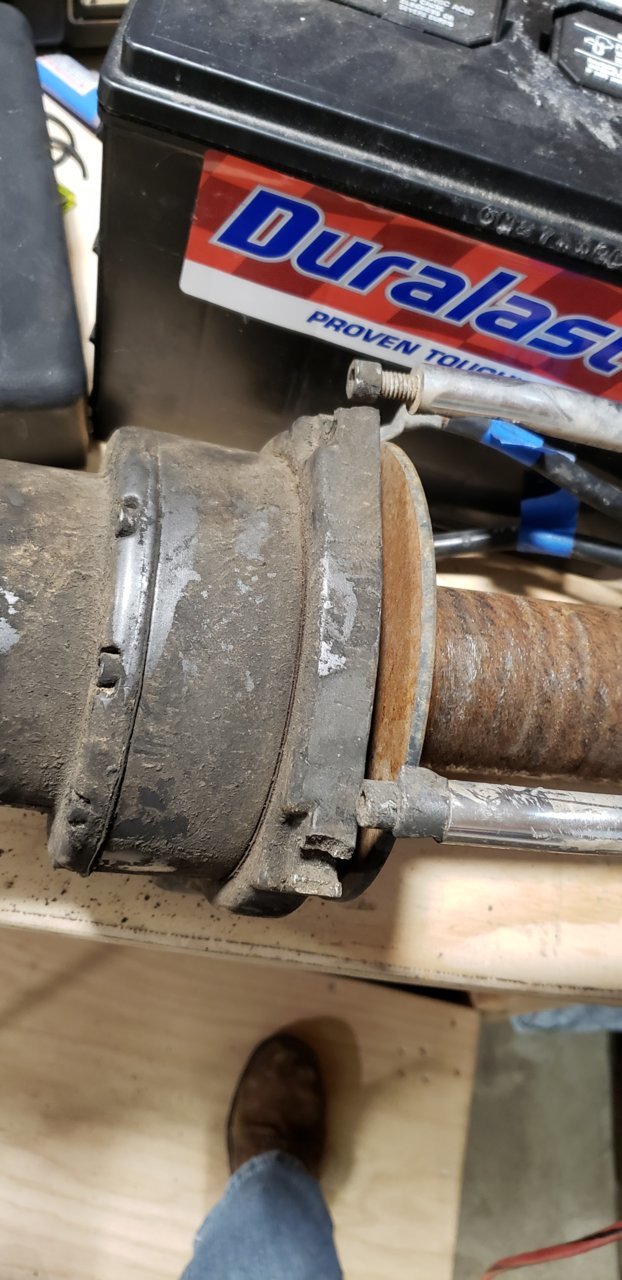

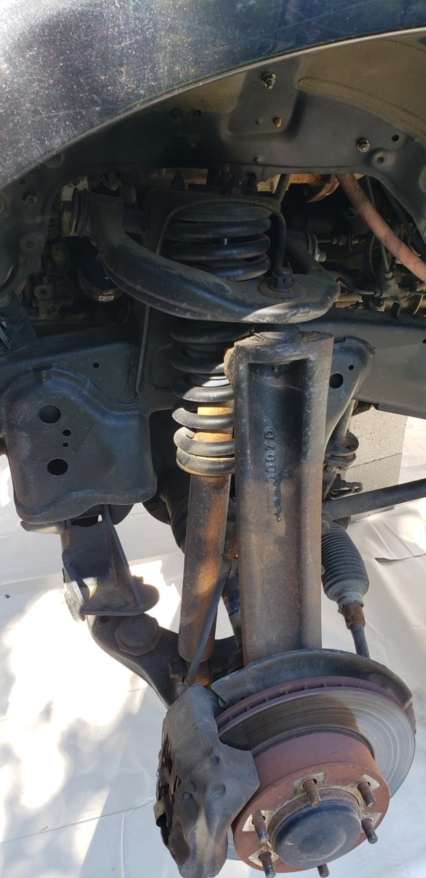

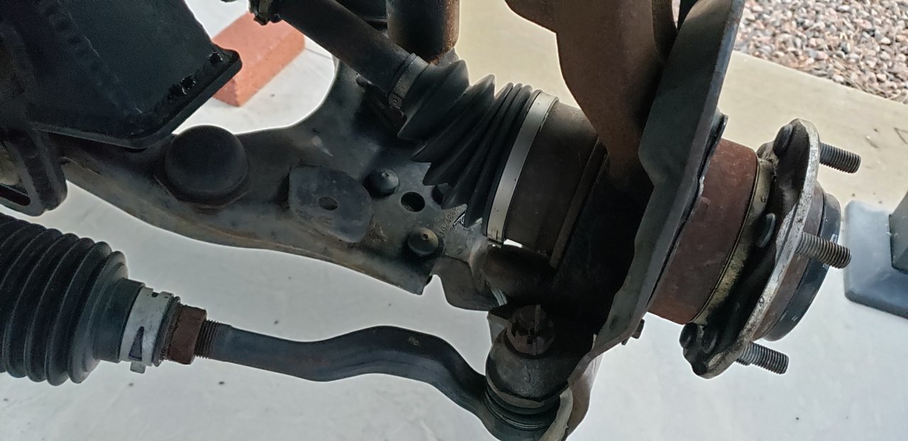

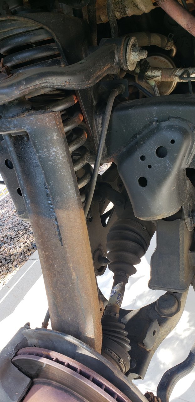

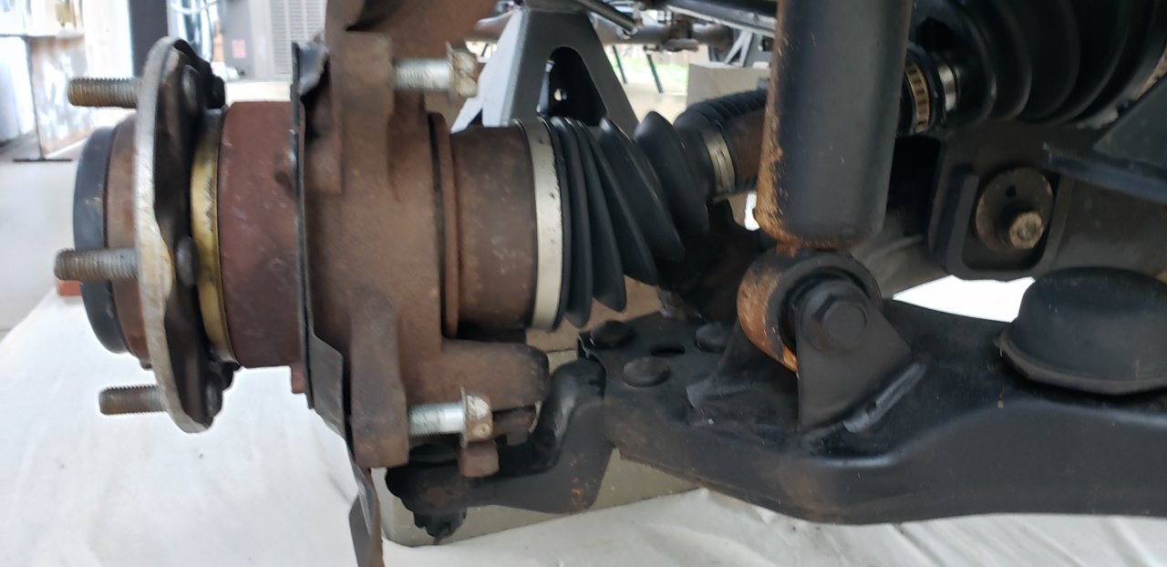

    One last thing of note. The driver side CV axle has alot of play (~1/8") up and down. Passenger side is pretty solid. Not sure if I need a bearing or bushing or what. I'll consult the FSM and see what info it has.
    Should have more updates after tomorrow.

    Pretty sure those u-bolts aught to be the square variety

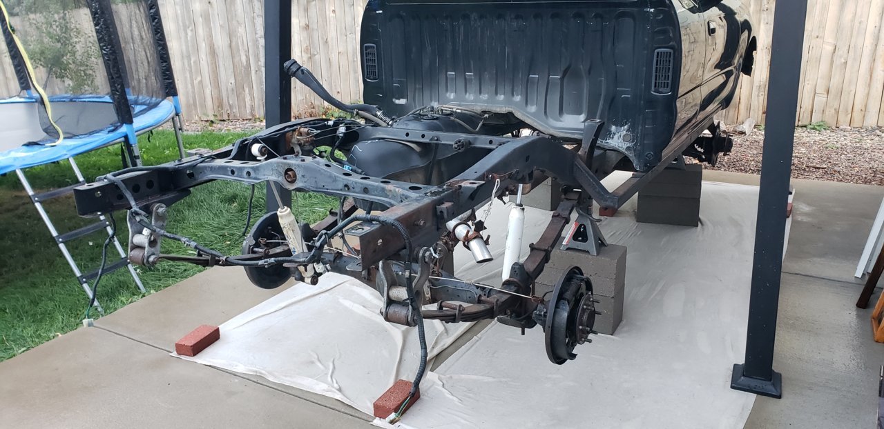

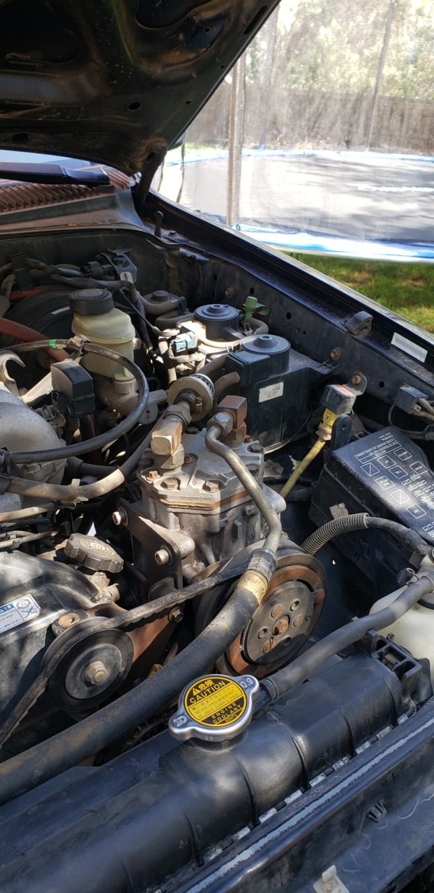

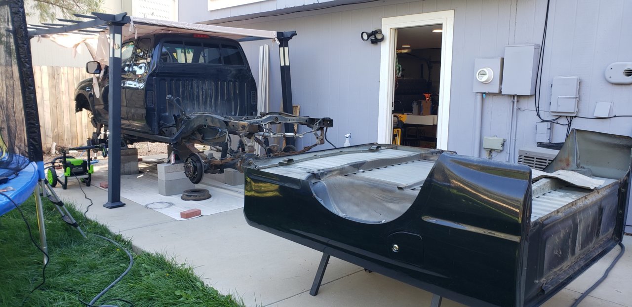

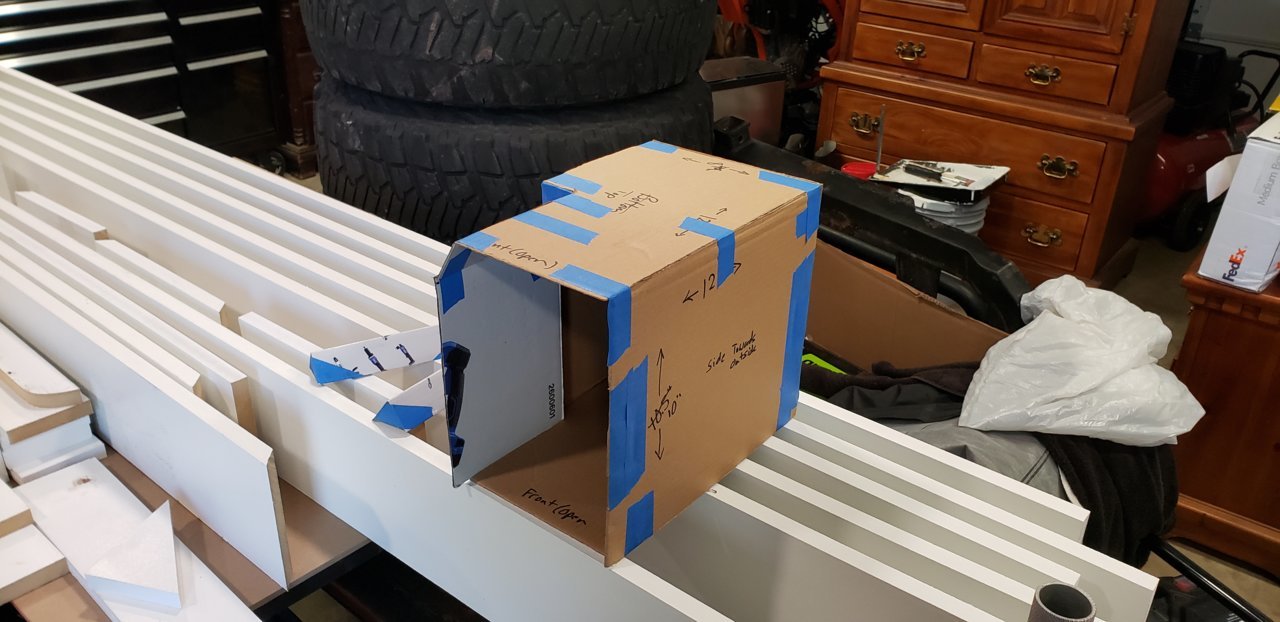

    I did not get as far as I wanted today but I did make some progress. Above is where I am going to put the battery. Right in front of the passenger rear wheel on top of the slider. Space is pretty tight here but I don't have alot of good options. I will need to notch the angled slider support in order to be able to get the battery in and out without removing the bed. I will also need to trim the fender a little at the bottom as well. I think this will end up working out pretty nicely.
    This is a mockup of the box. I'll be making it out of 1/4" aluminum.
    Here is the reason it cannot go under the hood.
    20220918_154741.jpg 20220918_183720.jpg20220918_183655.jpg 20220918_183802.jpg 20220918_184010.jpg 20220918_183950.jpg 20220918_184016.jpg 20220918_184038.jpg 20220918_184035.jpg
    I pulled the bed and pressure washed everything. Thats about where I'm at. I'm planning on starting sand blasting next week.

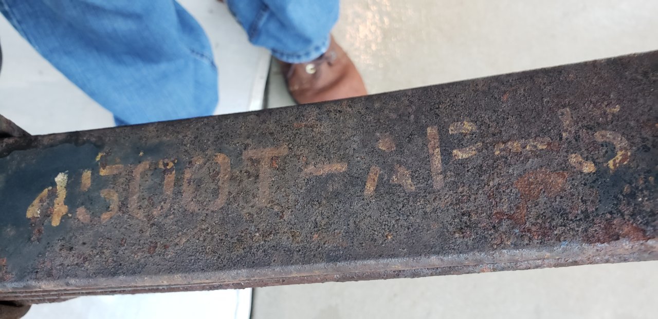

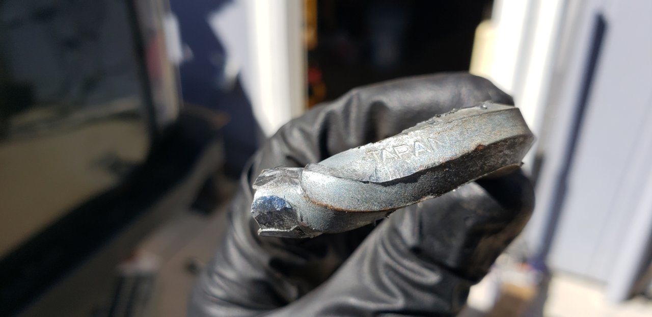

    I also found this printed on the leaf springs. Looks like it is an All-pro Off-Road's 4500T-AP-5. At least now I know the half spring is in fact how it is supposed to be. I might contact them about the twisting leaf pack and see what they think.
    I hope to have another update next weekend.
