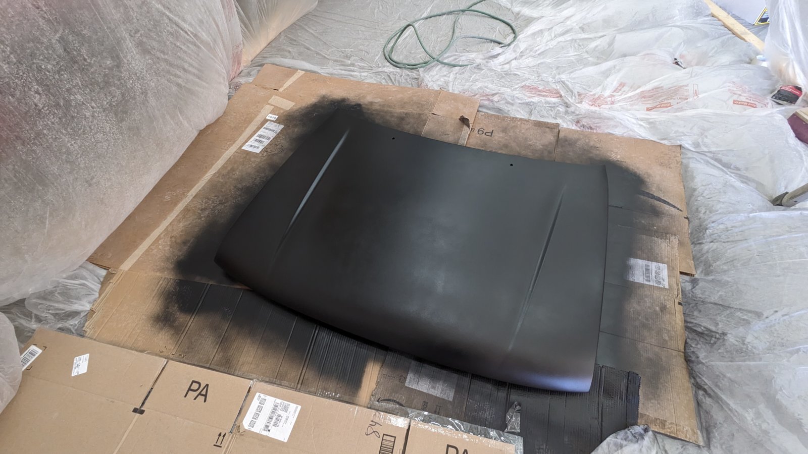

    I ended up hanging some painter's masking film in my shop and making a decent sized paint booth. Laid the first 2 layers on the top of the hood today. I learned today that the paint manufacturer says no more than 2 coats at a time with a full day of air curing before sanding and adding more coats if desired. Otherwise the finish will get glossier with extra coats back to back(like the underside). I'm gunna sand it tomorrow and see how I like the finish before either deciding on more coats or just putting a satin clear over it.

    With that gravity feed gun you really want to hang your panels and spray with the gun upright. You'll have a lot of inconsistencies if you're walking around the part and spraying at the floor. Every time you move the gun or change angles it will change the spray pattern because the paint is swirling around in the cup and possibly tipping far enough to pull air through the paint.
    You can probably get a 3m PPS cup system for that gun which will alleviate a lot of those problems and you'll get much better results with it when you decide to do the whole truck.

    I'll have to look into the cup system you're talking about. Is it the one with the single use plastic liners?

    You have to get the adapter that fits your gun but the system works as a single use lid with a built in filter and cup liner that acts like a vacuum bag. You fill the cup/liner, screw the lid on and attach it to the gun upside-down. Spray the gun upside-down until the paint flows, it syphons all the air out of the cup/liner allowing you to spray at any angle without worrying about air intrusion.

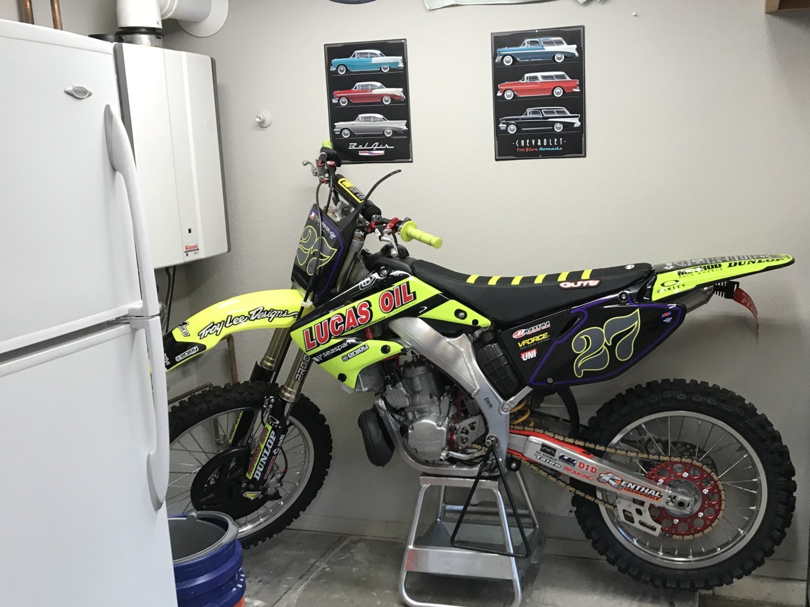

    That CR looks like it's got a newer CRF frame. Maybe just a newer seat/plastics conversion kit? Here's a pic of 03 CR250R that I've had since new. It needs a Lectron carb and a PC pipe to go with the R304 shorty. Although the factory pipe matches pretty good with the Pro Circuit shorty. :bikewhoops:

    You've got a keen eye! It's an 06 CRF250r that I put a CP500 conversion kit on.

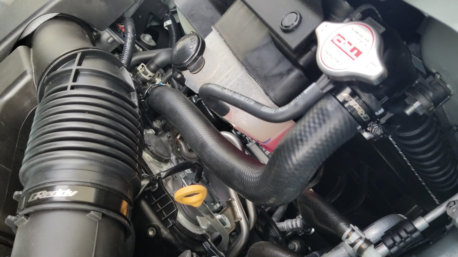

    Key phrase that folks lose sight of...."But also, because I thought it was cool." Words to build by. :thumbsup: Greddy Clamps...cuz they unnecessary but, cool.
