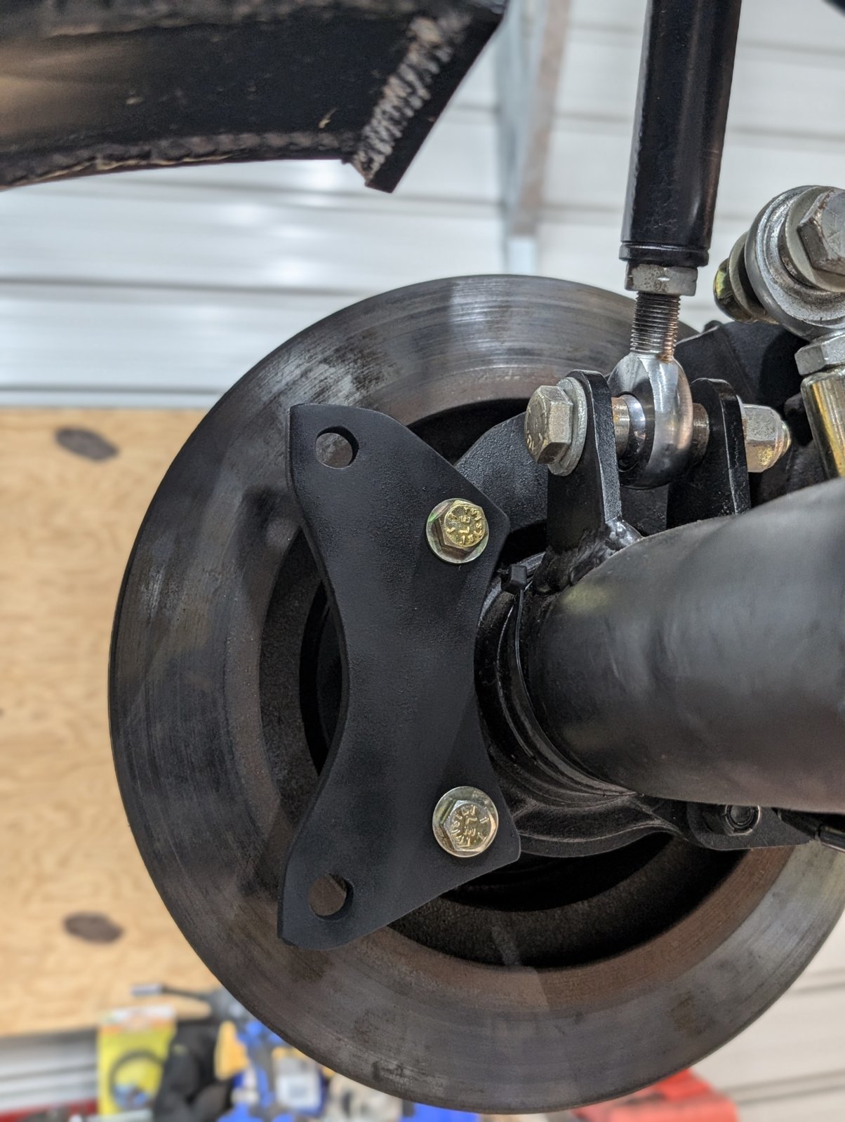

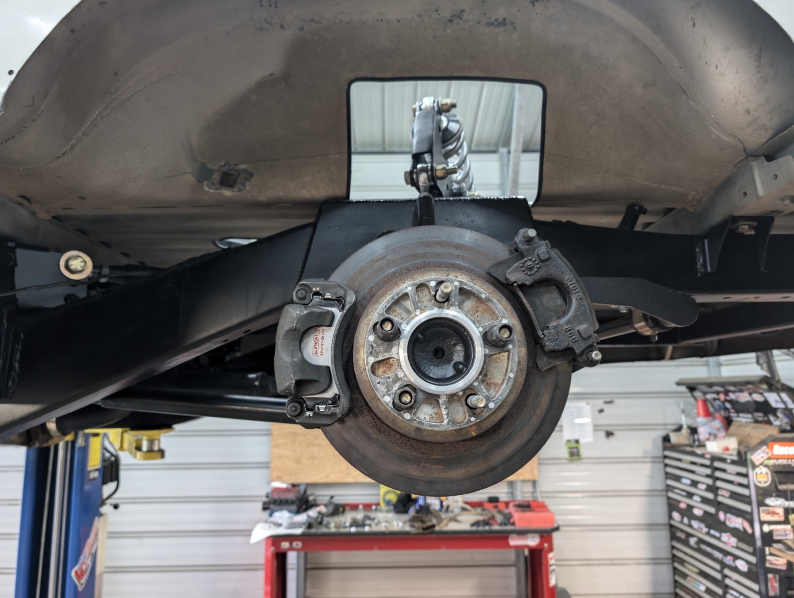

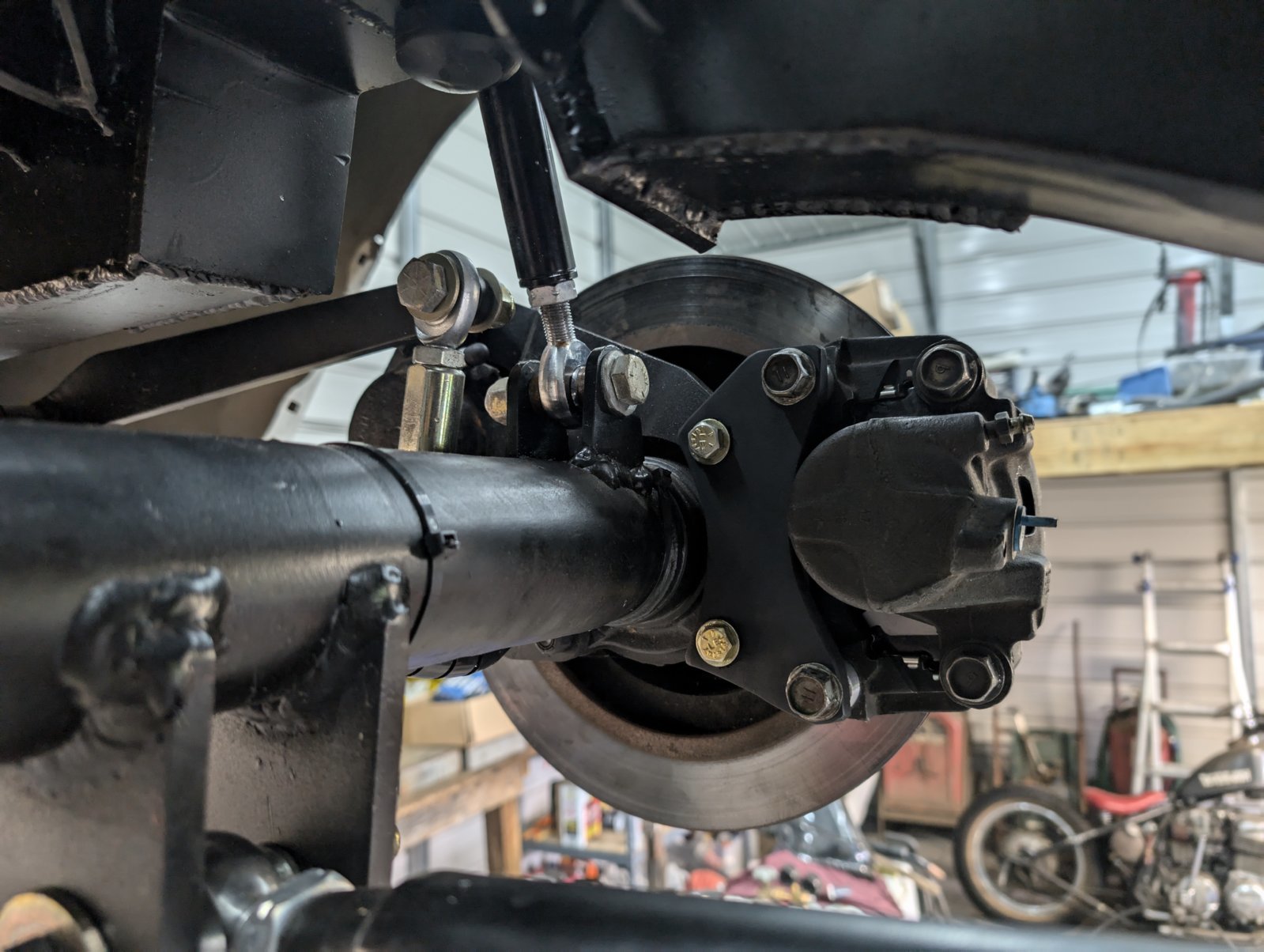

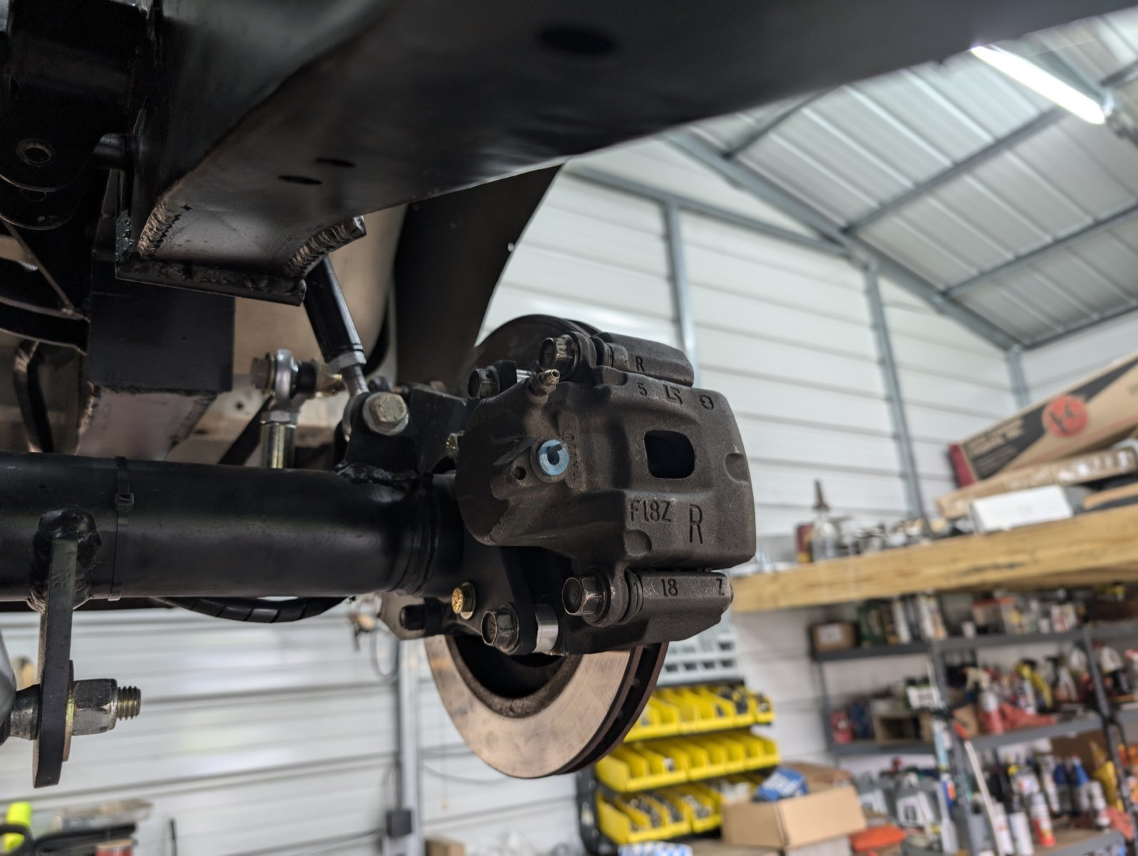

    So I've been chugging away at the truck for a few days now. I'm really trying to make it to the event tomorrow, but I'm not sure I'll make it... Just running out of time it seems.
    I did manage to make some brackets to mount a second set of calipers on the rear wheels for a hand brake. I'm not really a drifter, but it might be fun to play around with it every once in a while.

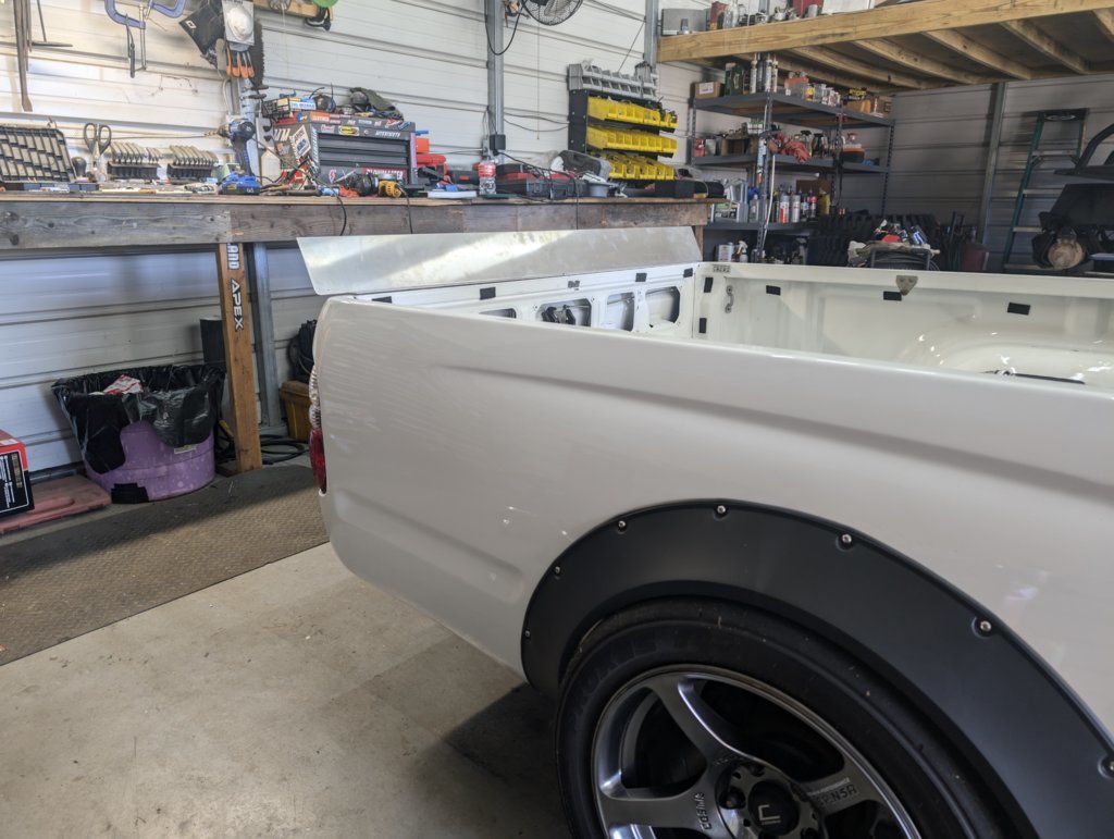

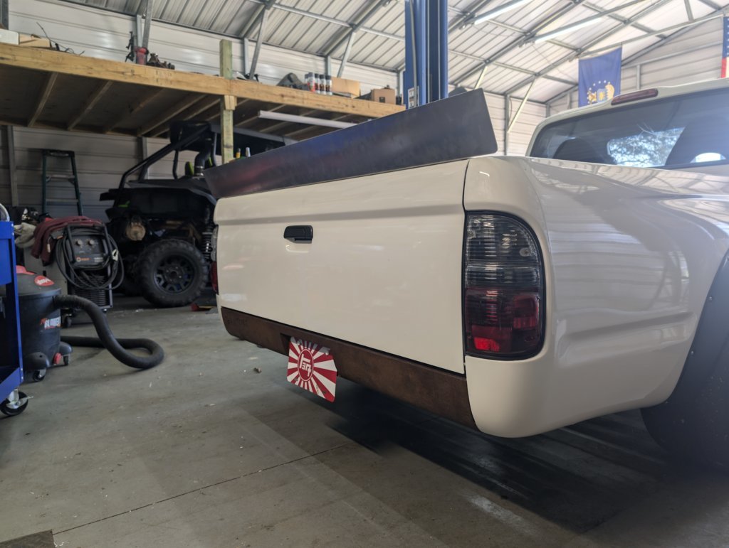

    I need to finish up some trimming on the fenders and bedsides because according to the rules, you can have cut body panels, you just can't have sharp edges, and I have a ton of those, lol.

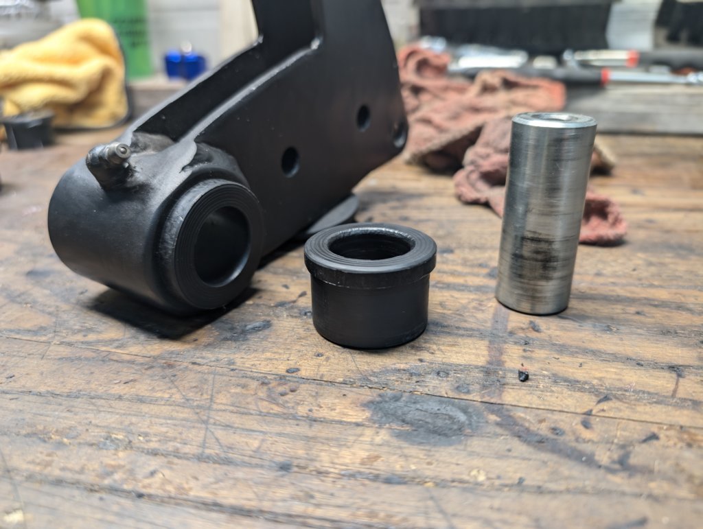

    I've also got a bushing on the left rear cantilever pivot that seems to be crumbling apart. Not really sure how that happened, so if I can find the energy to make one and get it swapped out then I might just make the event tomorrow.
    Btw, those are the factory front calipers from this very truck that I repurposed for the hand brake. It works fantastic!

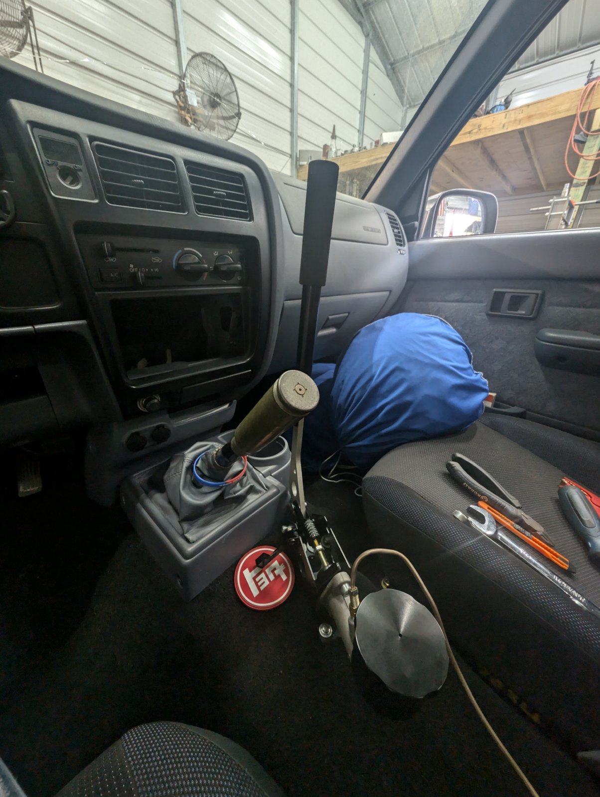

    Small update I got rid of the temporary "remote" reservoir, and installed a master cylinder mounted one. The remote one was originally just supposed to get me through last Sunday so I could race, but actually ended up not making it due to that bushing... I'll get the bushing swapped out and hit the next one for sure.

    I should have taken a picture of the bushing that was worn out but was too in-the-zone on making new ones. I think I really only needed to replace the one side, but I did go ahead and do both while I had everything apart. Here is a pic of the last one before I put it all back together.

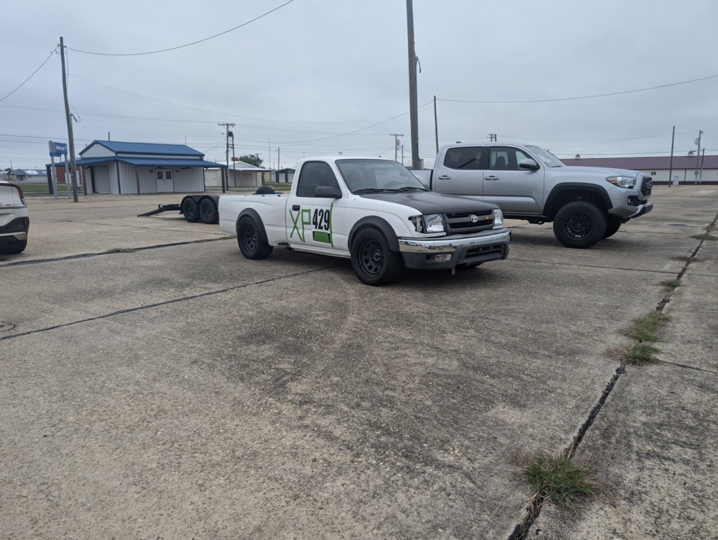

    First event since getting everything suspension wise finished.

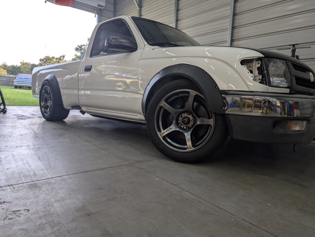

    Finally took the plunge and bought some lighter wheels. I was running steelies before and you can really feel that extra rotating mass. I don't normally like shiny stuff, especially wheels, but this "hyper black" I fell in love with.
