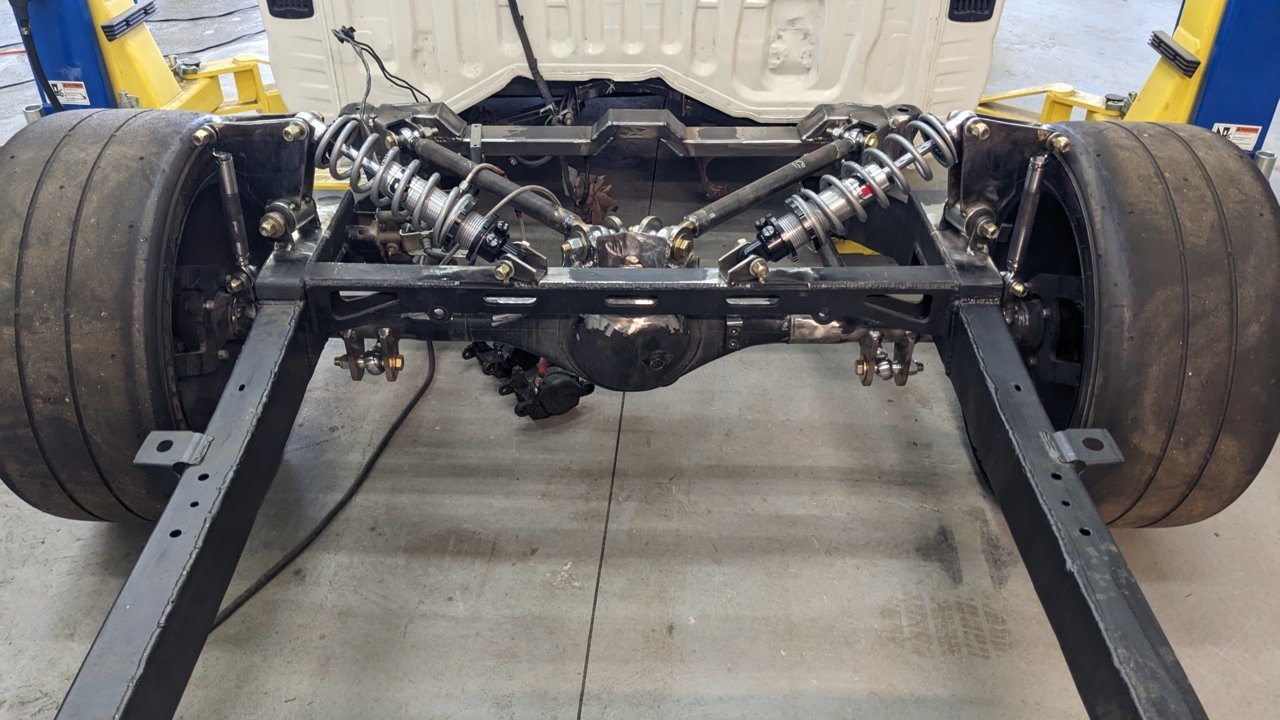

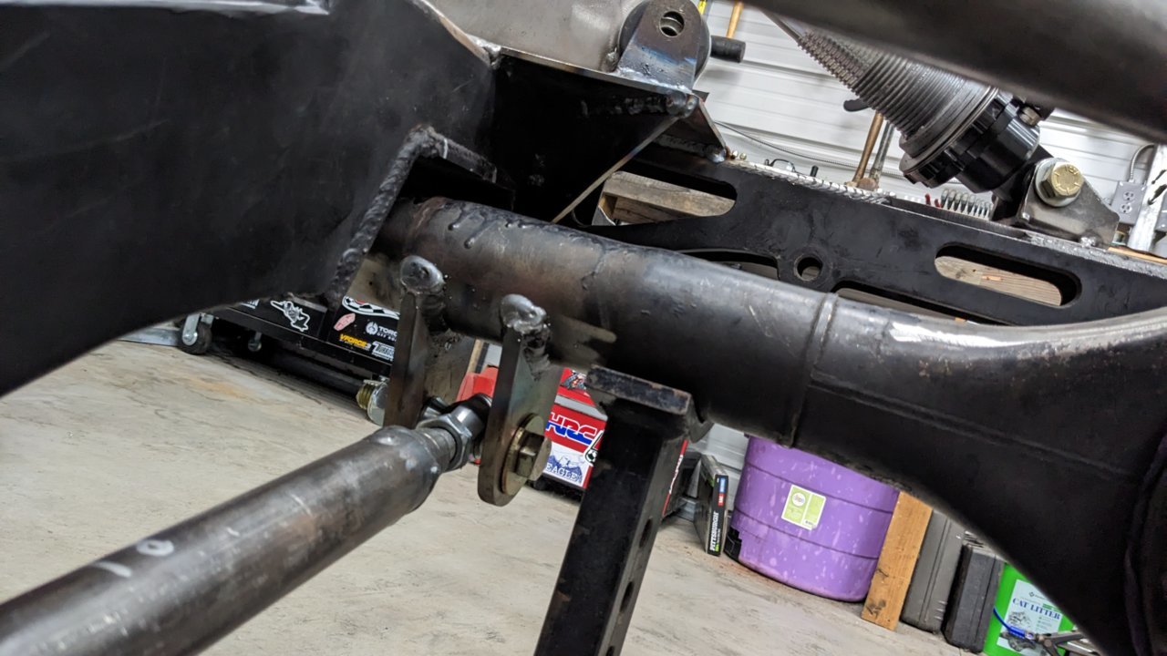

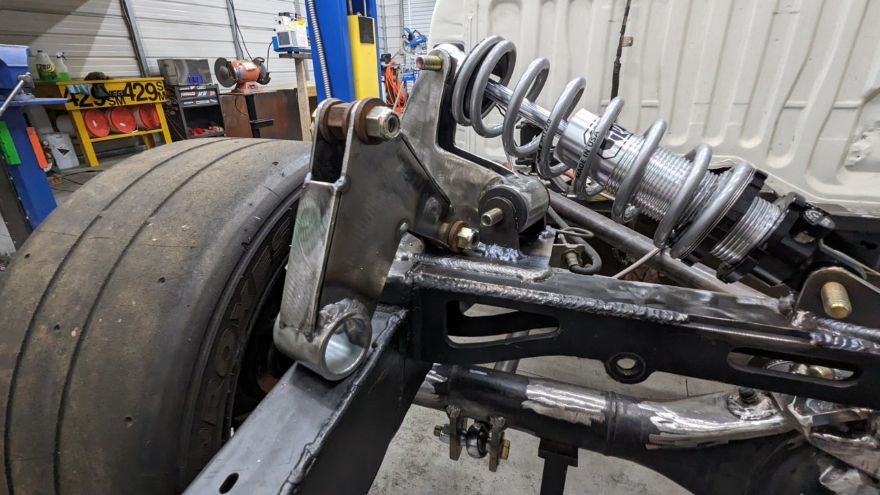

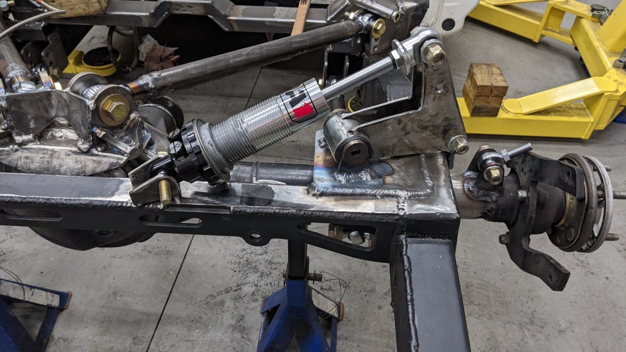

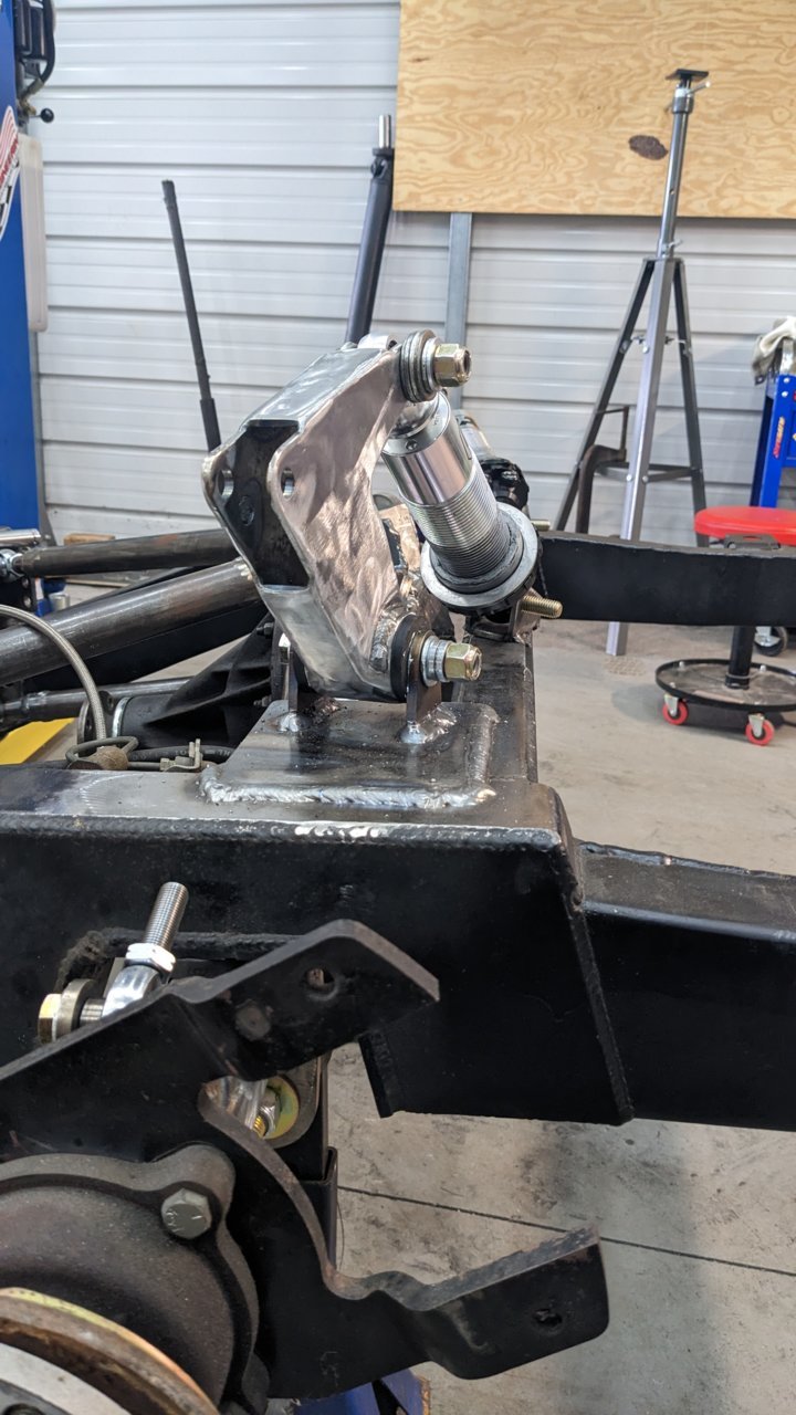

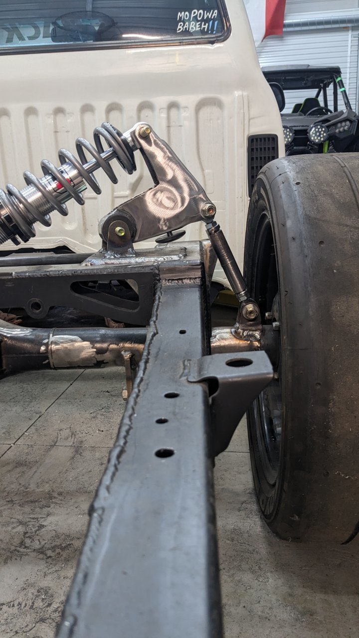

    Rocker version 2.5? I think the angle of the pivot point is a little wide. Glad I fitted the tires up to see if it would clear. It doesn't touch, but boy is it close. Lmao
    I'm realizing that getting the pushrods the right length to set the ride height is going to be very difficult since the bed and fuel tank are not on\in the truck. So there may have to be some changing of pushrod length after getting all the weight back on the truck to see where it sits. I'm wanting about 2 inches between the bump stops and axle with the shocks as close to 12 inches as possible. That means it will hit the bumps before the shocks bottom out. I've also gotta figure out a droop limiter. Thinking an easy fix is a limit strap like the long travel guys use and something I have on my Honda talon. Just wanna keep the shock from hitting full extension and destroying itself over time.

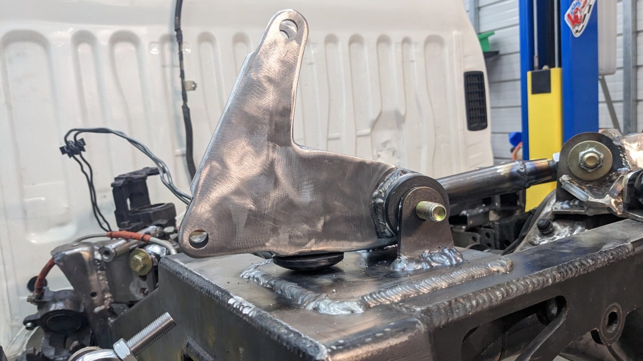

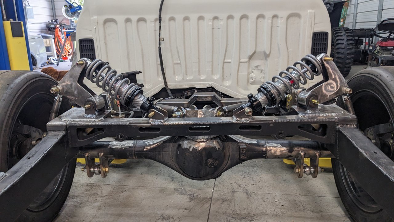

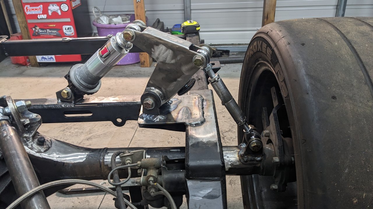

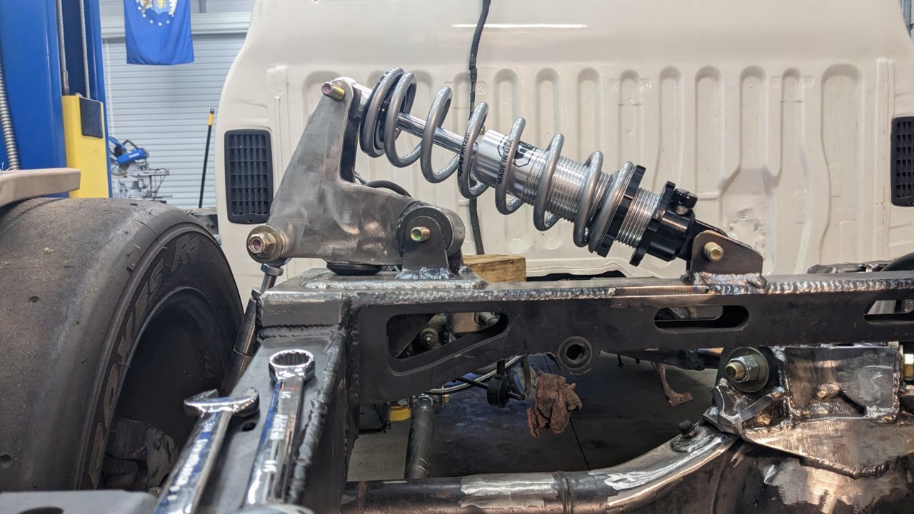

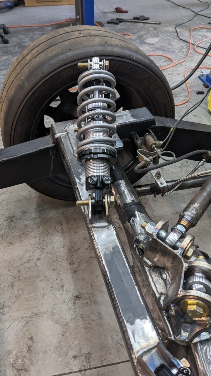

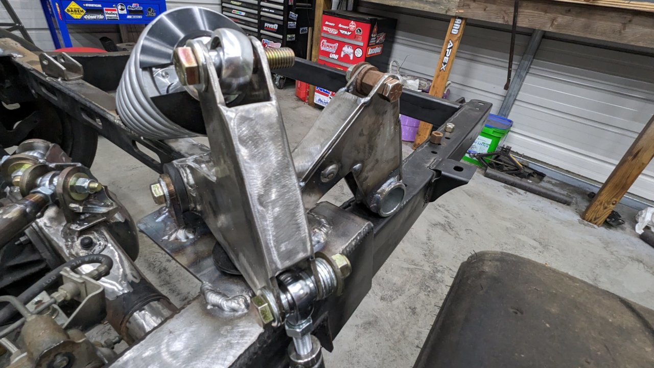

    So I've finally settled on a rocker design and position. I ended up moving the pivot point in towards the middle of the truck around 4 or 5 inches and it kinda just...worked out...EXACTLY like I wanted it to in the beginning. Lol. Axle hits the bump stops on the under side of the frame like a 1\4" (adjustable) before the shock bottoms out and I found some super slim bump stops I can mount to the bottom of the rocker that make contact before the shock reaches full extension, maybe 1\4" - 1\2". I can adjust the preload to exactly what it needs to be once I get all of the bed and fuel cell installed, and then I can adjust height with the pushrods. The pushrods you see right now will not be the final product. They are just gunna be a place holder until I have all the weight back on it, then I'll make the final versions.

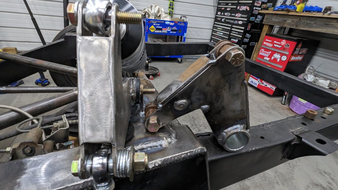

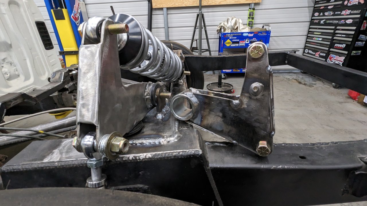

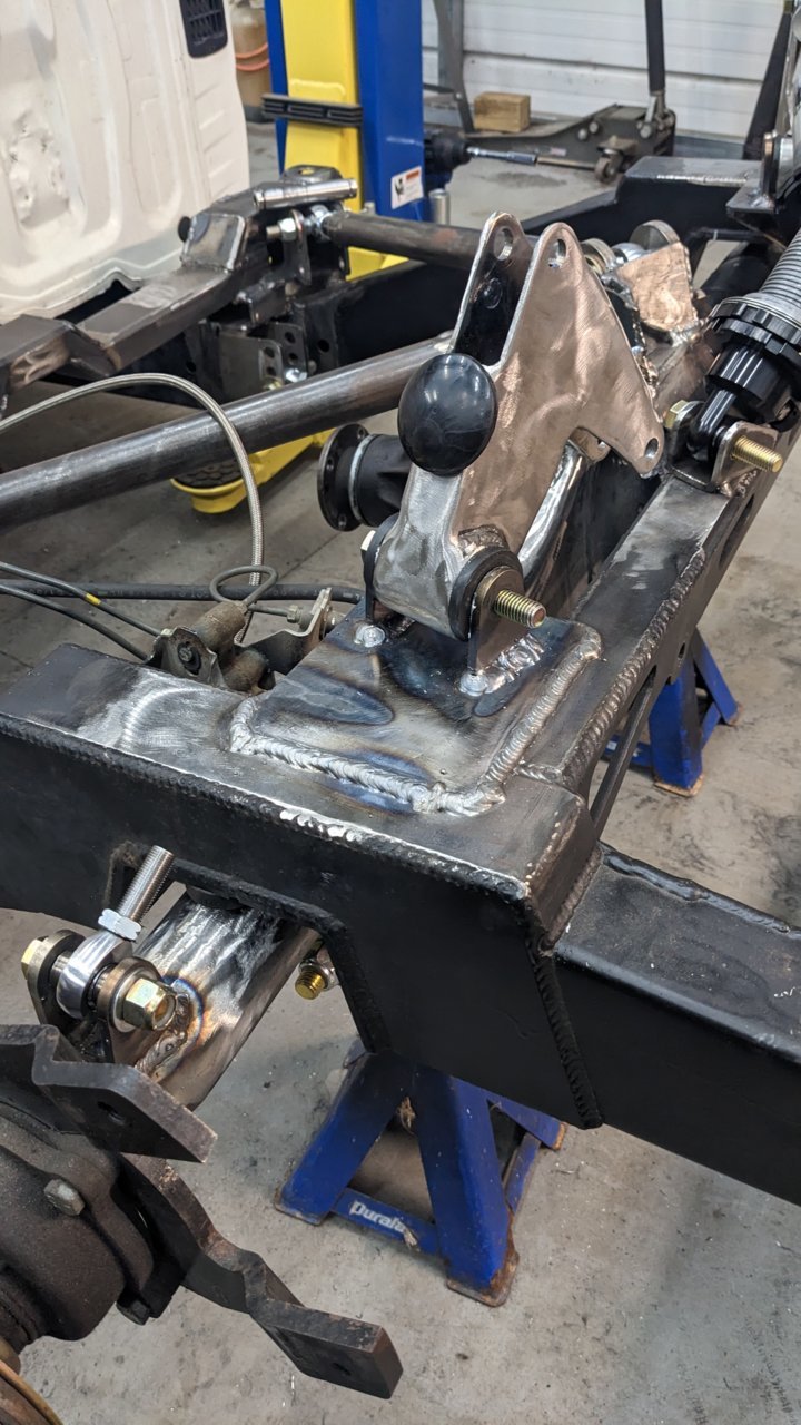

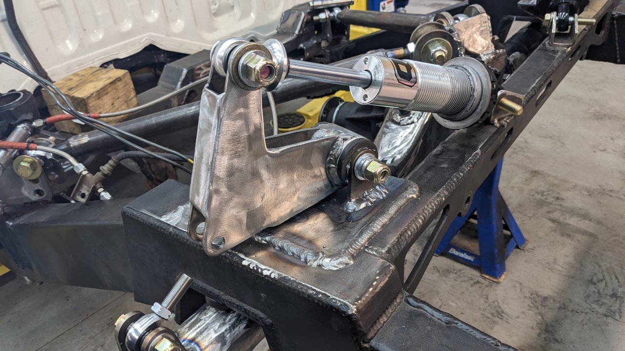

    These are the "mount plates" that I made to relocate the pivot of the rocker, and big gusset underneath. This is all made with 3\16" plate, which is all I have, but would have rather (and may have to in the future if it doesn't hold up) used 1\4" plate. Call it an exercise in my gusseting skills... we'll see :rofl:

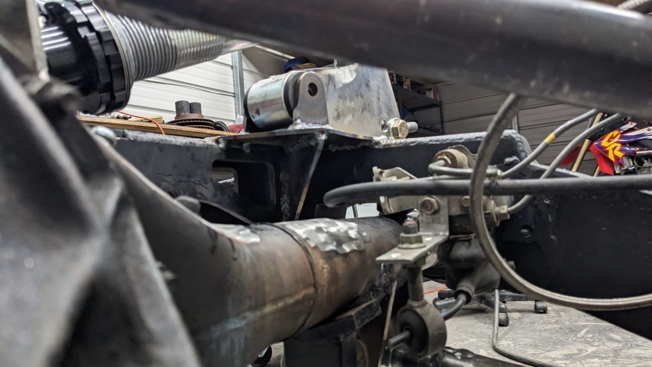

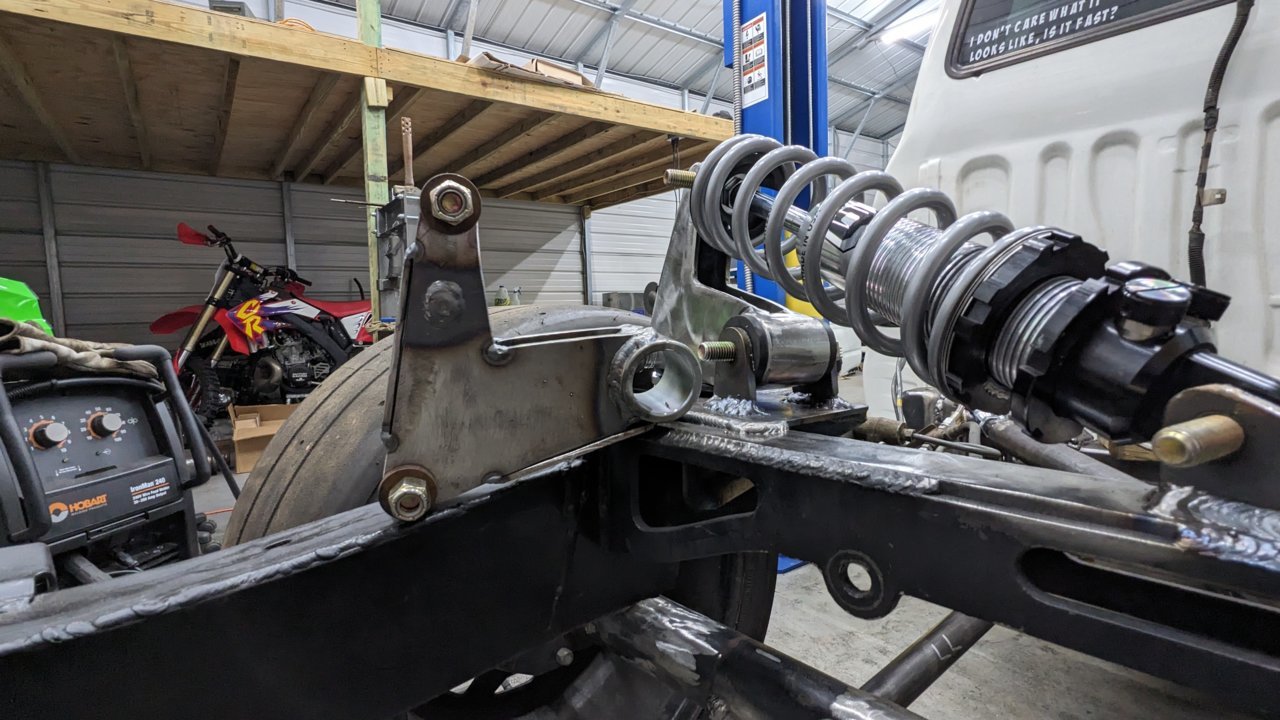

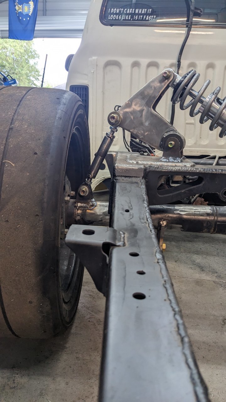

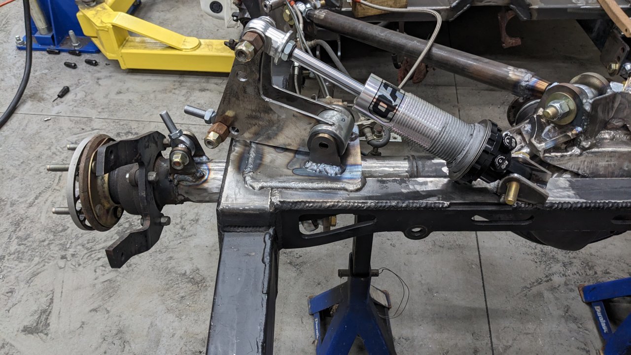

    I really wish I could take the time and slow down and document more of the in-progress of each step, but I just get in a groove sometime and don't like stopping or slowing down. Lol. Wish I had the budget to just hire someone to follow me around the shop with a camera, I'd have a lot more pics of everything involved. Lmao
    Here is where I stopped tonight. Driver's side rocker is basically done, and the passenger side just has its gussets tacked for the most part. You can see how much I used a flap disc to blend that sucker in. Lol. I almost wanna do the whole thing, but it would be super tedious to blend down around the pivot. :anonymous:
    That random weld you see in the flat part is a hole I filled in. There were 2 on the currently unfinished one and I think 4 on the other one. Just some holes I drilled when I was about to make another modification or go a different route, but then changed my mind shortly after dilling the holes.
    A piece of copper clamped to the back of the work, then fill it in and grind it flush. Can't even tell from the outside where it was once it's ground down.

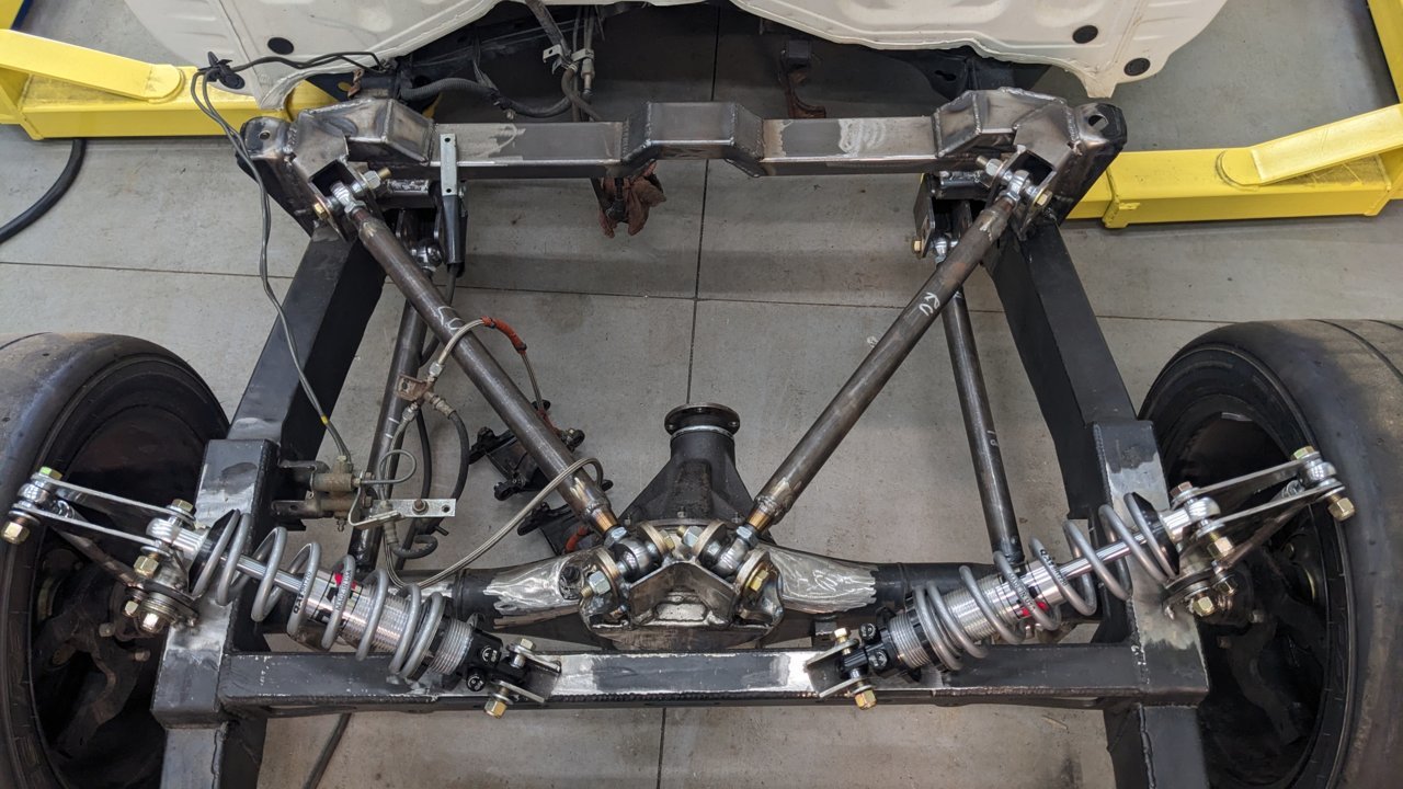

    This is looking better all the time, looks like the geometry is lining up nice, and a bunch more clearance for the rear tires with the revised pivots.. keep it up this is going to be bad ass it seems!!
    Cant wait to hear how it performs on the autox! :thumbsup:

    The new rockers look good and seem to have solved the issues of the last design. As for the mounting plate, I think the 3/16" will hold up fine. If it doesn't you can always add some square tube going from the frame to the cross brace picking up the corner for stronger bracing.

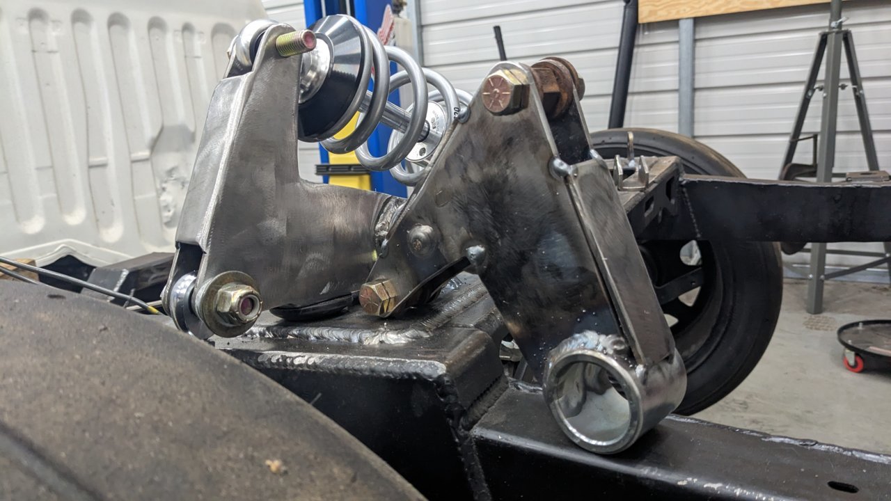

    Finished welding everything together. It might need a few touches here and there. I'm super stoked at how it turned out!
