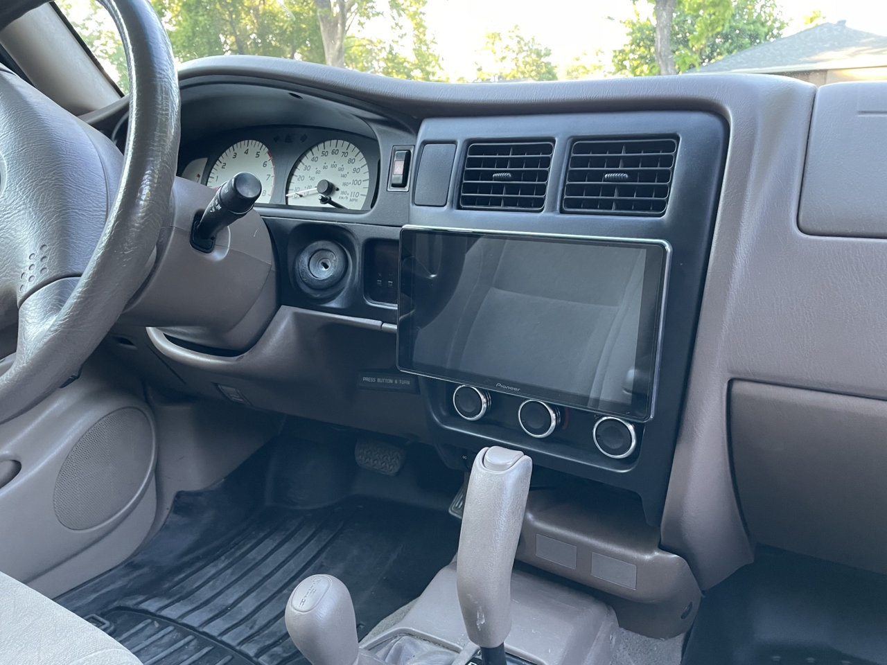

    Pretty much followed the OP but put a single DIN right above the AC controls. There is more room for a single din vs double din which hits the roll bar in the dash. Someone with some skills could probably do a much better job than I did.

    6

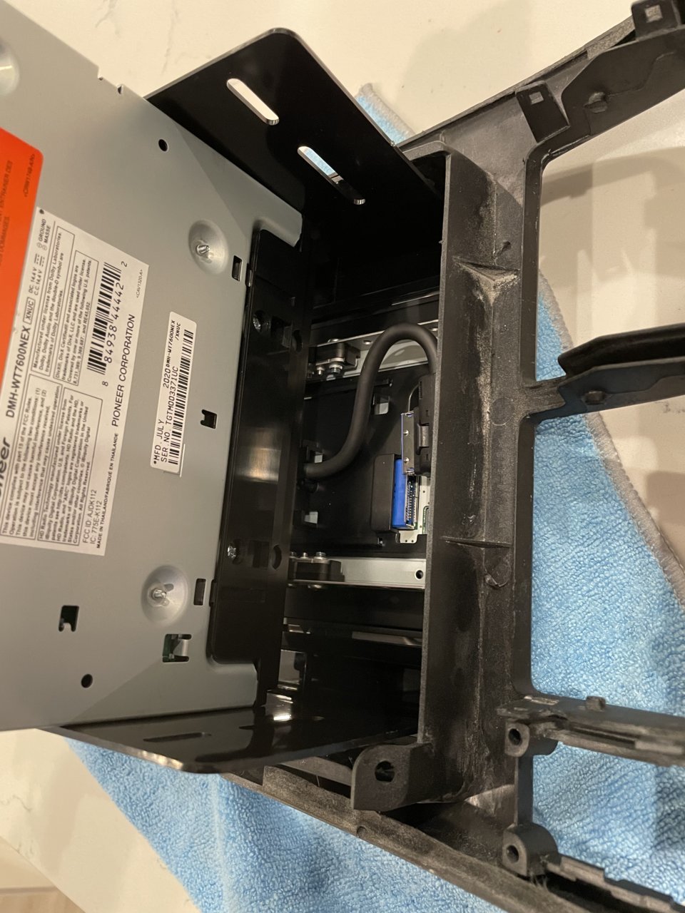

    @MuddyBeaver i want to try this project for my own truck - one thing that I’m confused about is how the double din is supported after the modifications. Presumably it’s not just the trim piece holding up the weight of the stereo, is it? Just want to know that the install will be solid before I start chopping things up. Cheers.

    80
    East bay, ca
    03 tacoma double cab 4wd
    Air filter
    I did it to mine about 2 years ago. The toughest part was making little brackets and securing the stereo in the dash. It will take some patience and fabrication skills but nothing too difficult.
