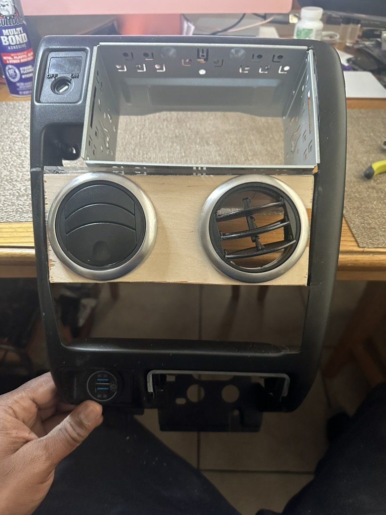

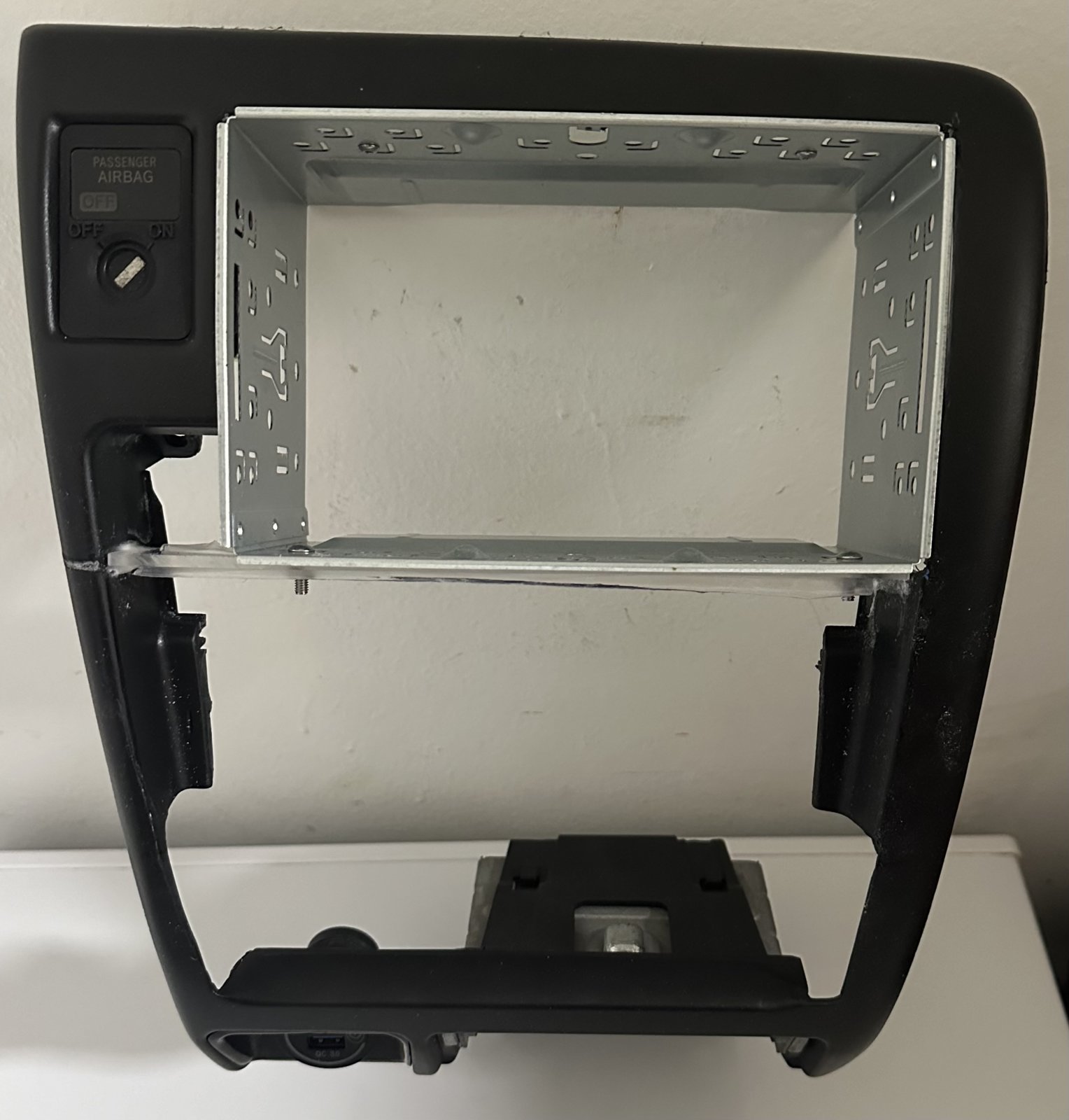

    Going right to the top with my android radio
    Then a/c vents below
    A/c control on the bottom
    Theebrain85 and Bandido like this.

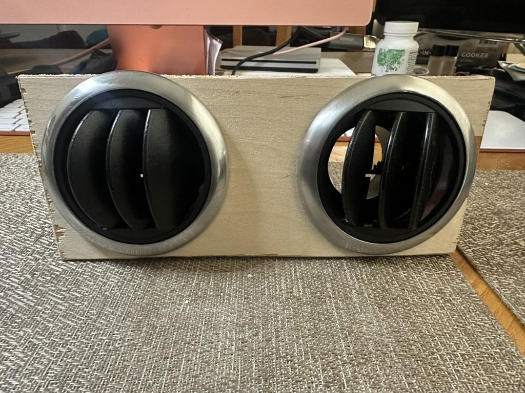

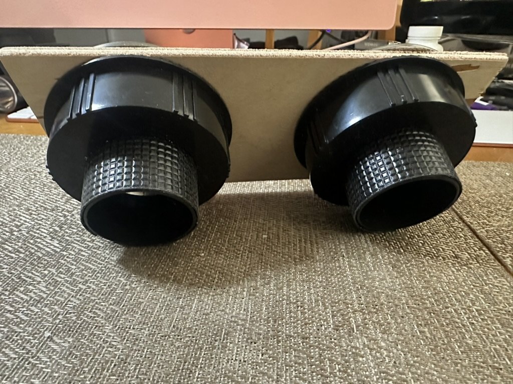

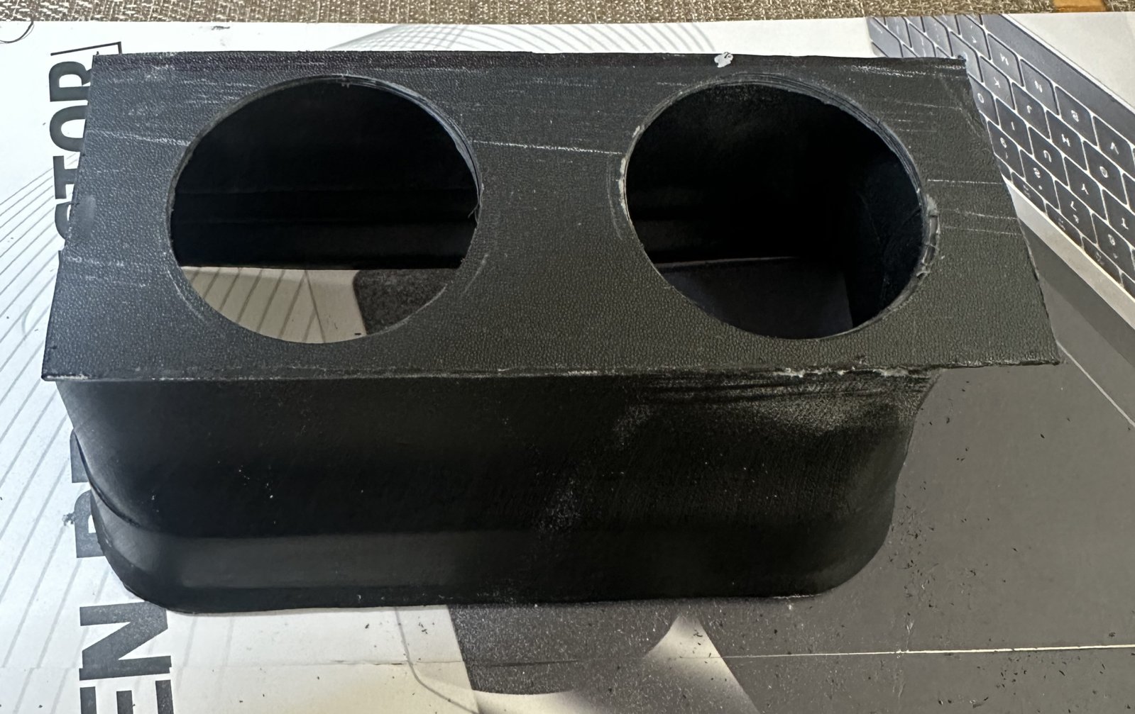

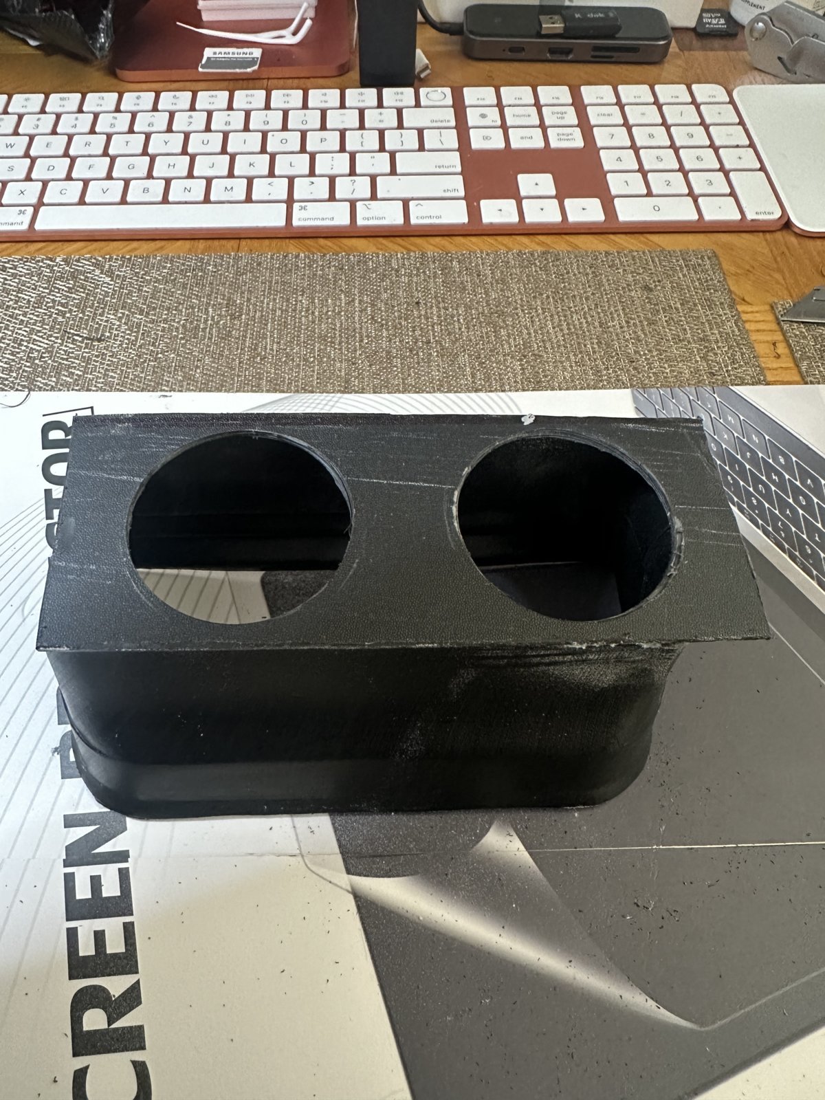

    Ok here is the vent tube that comes from the dash I cut it and made this plate (two Holes)
    Here is with the outlet ports that im going to use a/c hose to connect to the vent
    Here are the vents for the front

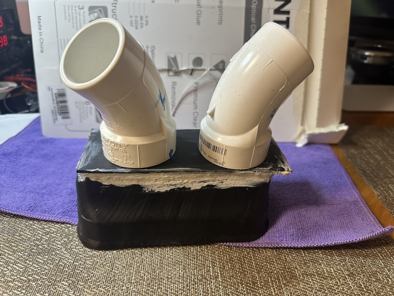

  8. Aug 14, 2024 at 6:51 PM
    #48
    Plkyone
    Plkyone Well-Known Member
    Nov 3, 2018
    #271563
    275
    Here with the plate installed
    Recovering5Lugger likes this.
