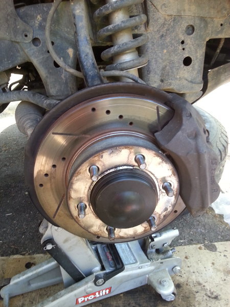

    Just got all the parts in today. It does include a water pump, cam seals, idler pulley tensioner puller and tensioner. I figure 240k on the clock will definitely designate all new parts in there.
    Today, I replace the worn ball joint the ruined a brand new tire in no time. Also got new pads on there. I guess the PO put slotted and drilled rotors on. Interesting for a non sportscar or towing truck.

    Shit if you dont want them ill take them, i smoke my brakes rather quickly coming down mountains

    Haha. I bet. Unfortunately we don't get the the mountains from Raleigh much anymore except holidays. But hey, any improvement in safety/stopping is alright with me.
