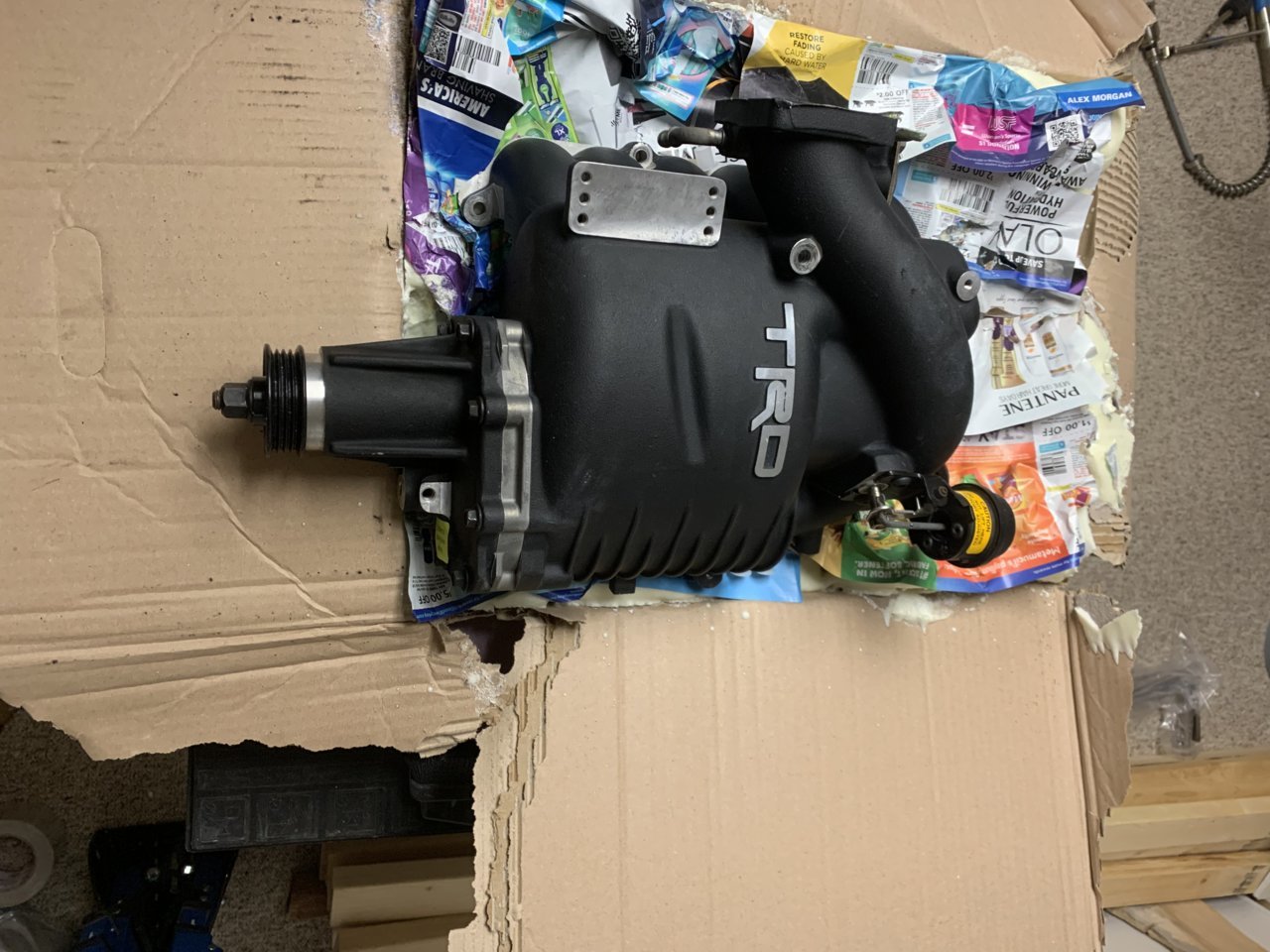

    Well, it’s been a loooong time coming, but I finally have a rebuilt supercharger! Thanks to JonBond! I am installing it back on this weekend. I wish it didn’t take so long but work and life and 8month old baby pushed this down the priority list and I’m crossing my fingers that I have no startup issues. But I’m sure it’ll be fine.
    After SC rebuild, my total cost for this truck is so far is $3006.
    Anyone have any input on towing with a supercharger? Should I avoid towing or what?

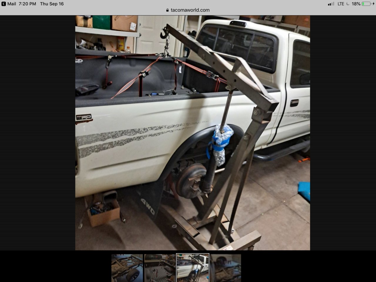

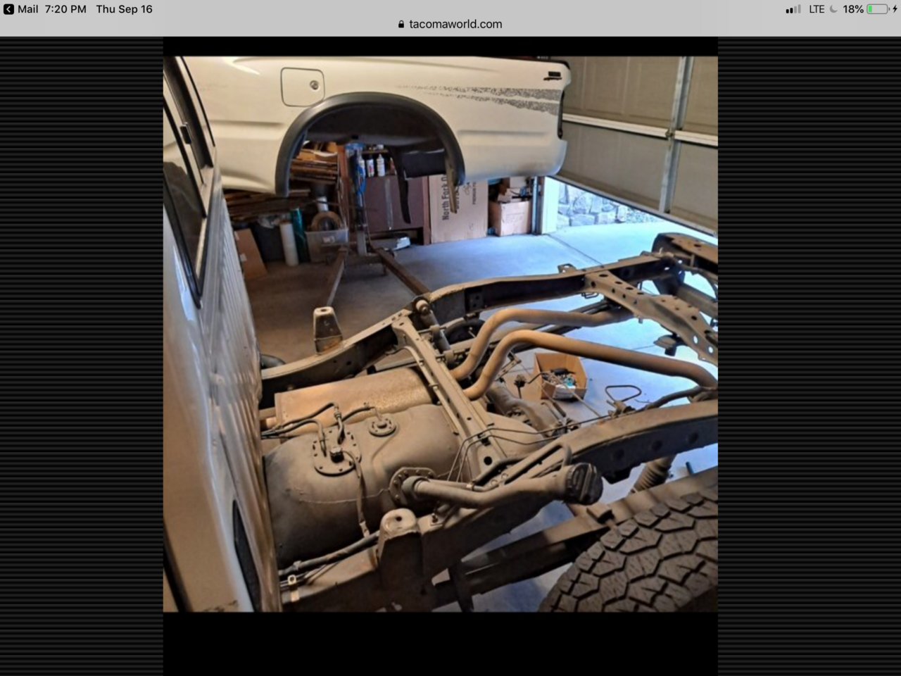

    I would put in an AEM Fuel pump now.
    Just did this today
    https://www.tacomaworld.com/threads...ent-by-removing-the-bed.737363/#post-26249311

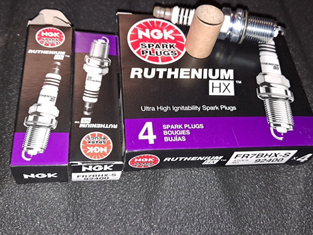

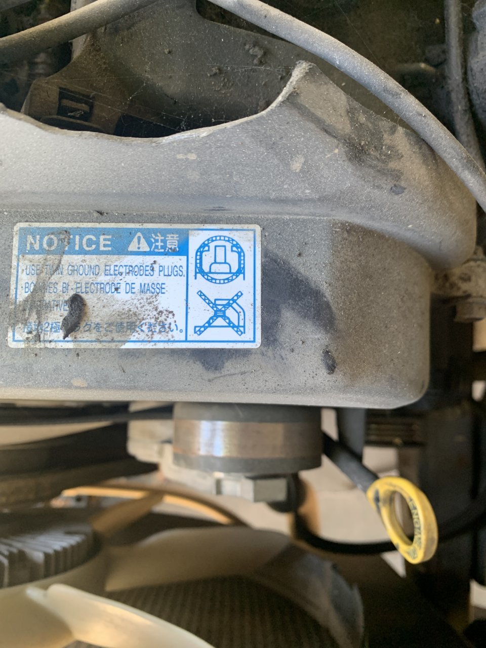

    Did they not put a better fuel pump in when these were an option from the dealer? Just the same as regular 3.4? I’ll have to look into that, I will need to save up to start doing more upgrades
    Also, my 96 says to use the dual prong spark plugs, are those what I should use with this 2001 SC? I remember reading something About particular plugs being best with a supercharger but I don’t know when or where that was

    No option from the dealership for a better fuel pump.
    The AME 50-1220 you can buy online from advanced auto with a discount for 95.00.
    Use these two step cooler plugs from advanced auto too

    Do they have twin ground version? It says pretty clearly on the timing belt cover to only use twin ground plugs….? I’ve only used them on my 96 and they have always done good, also when I first did the plugs years and years ago the PO was using single ground and after changing them the truck seemed much happier. Could’ve just been the fact that they were old anyways though.
    how are the plugs cooler? Different insulation or something? Genuinely curious how the plugs could be cooler
    Edit: is ruthenium a metal that sparks cooler?

    You DON NOT want to use the stock plugs,
    You HAVE To get two step cooler plugs because of the supercharger.
    If you use the stock twin plugs they will crack with the supercharger.
    Spark plugs come in different heat ranges that’s all.
    On a stock motor the twins are fine.
