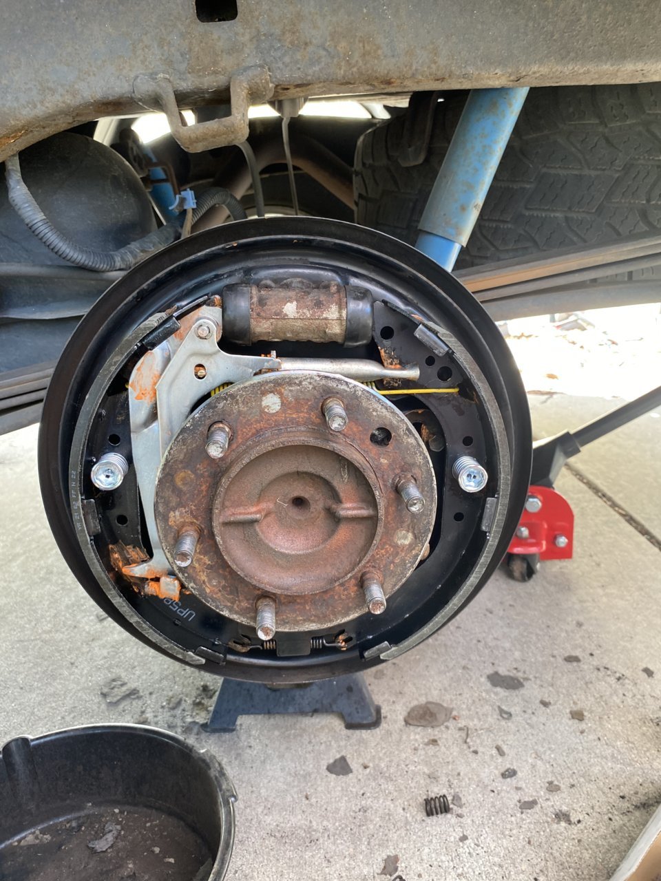

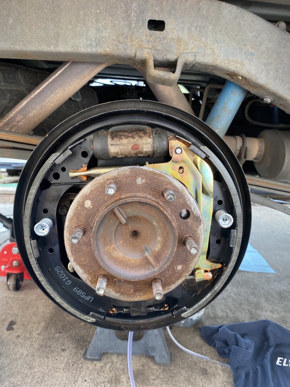

    Finally got a new pair of shoes and bled the brakes, stops on a dime now.
    B887FD27-3300-4946-9E49-A529313A0563.jpg 5AD2B764-0F63-4117-959D-ED964A8ECE54.jpg

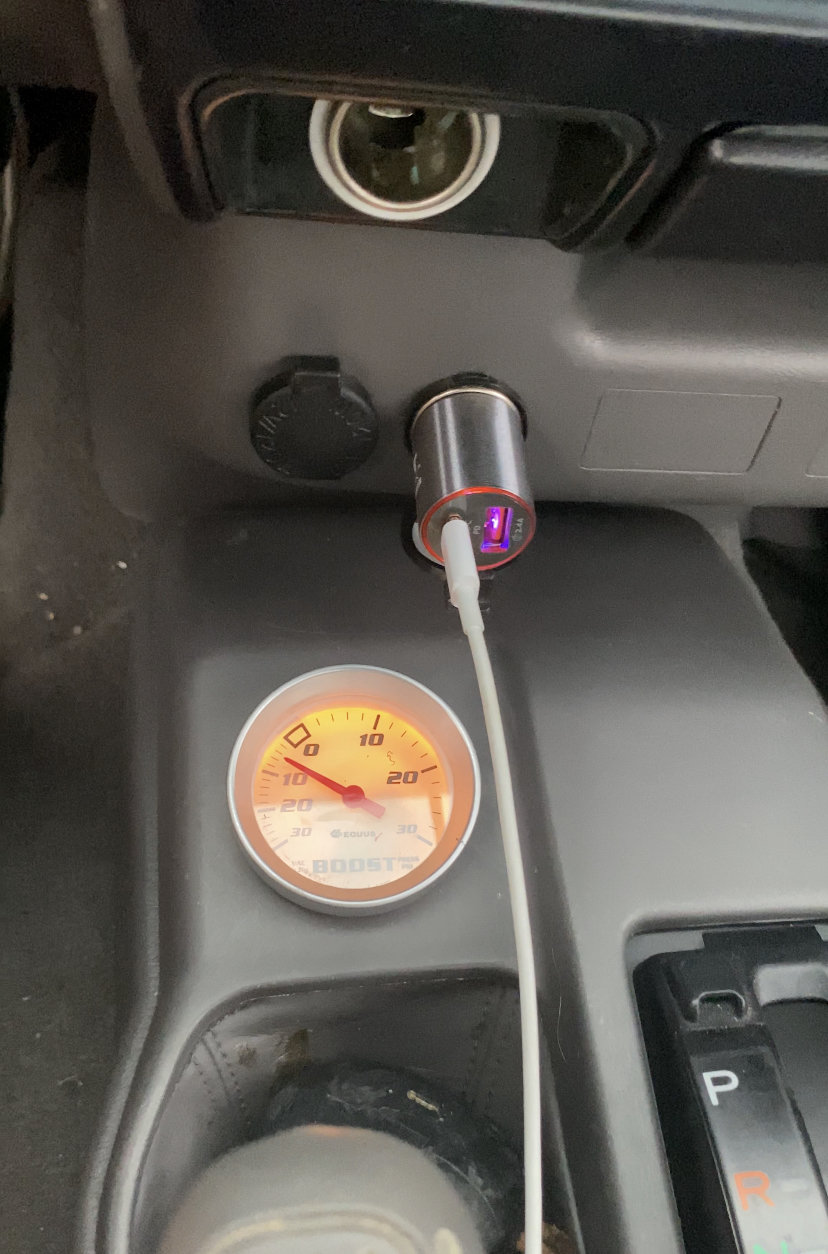

    I also got a (cheap) boost gauge installed today as well, I’ll get a nicer one to replace it one day but mostly just needed some kind of reference for 283BBE04-4128-4D30-BB9E-FA5AABDBA1D4.jpg The water/meth sprayer, FMU(fuel management unit) and 340 pump arriving tomorrow.
    Wanted to show how I did install on the gauge in that location, so I’m doing a little write up.
