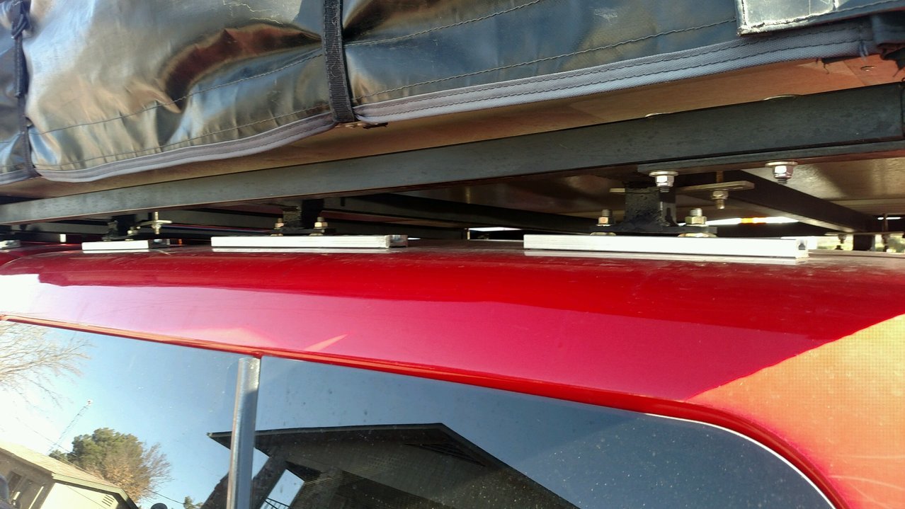

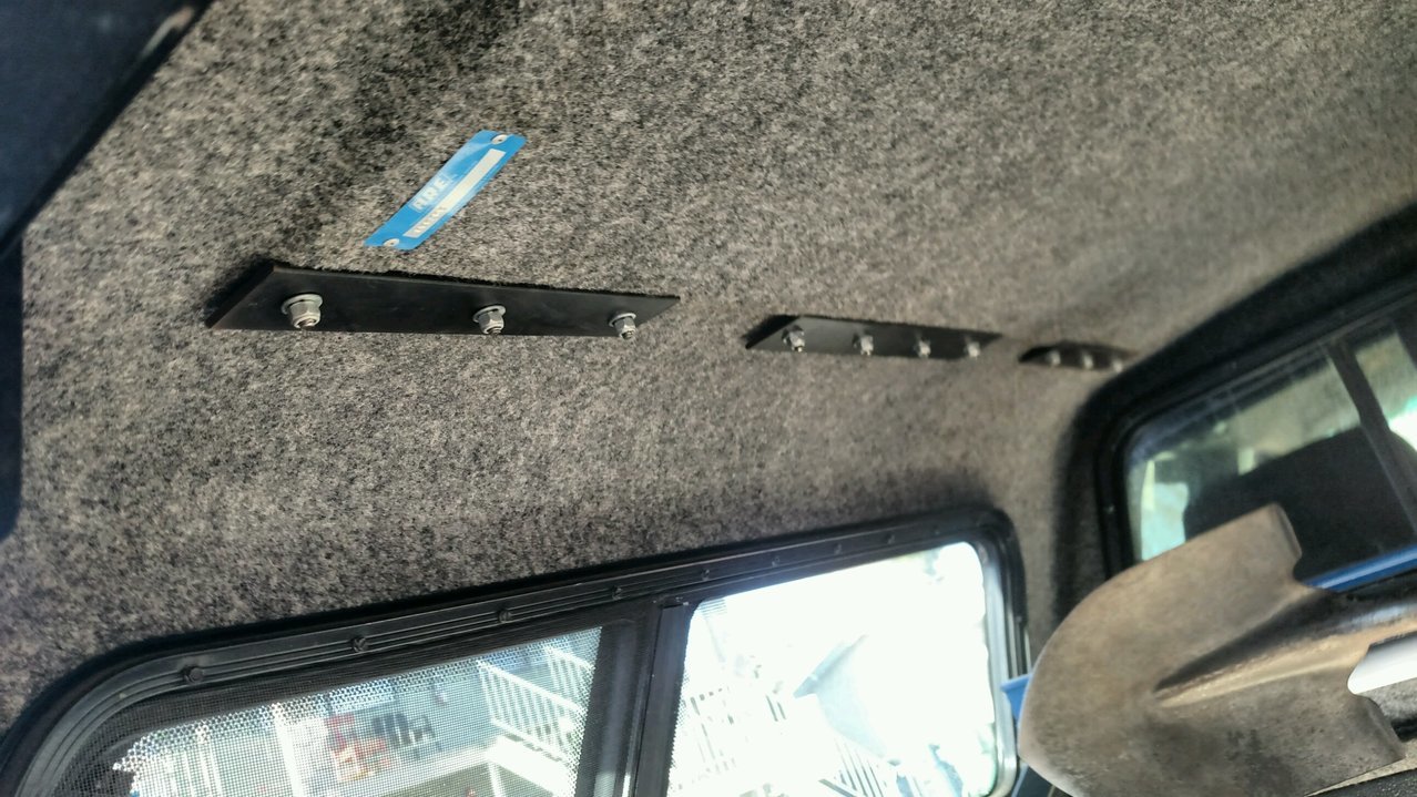

    Here is a picture of the cap mounts for the roofrack. I just used a piece of 2 inch flat steel (I think 3/16 thick) for the backing plate with the L track on the outside. I put nylock nuts on the inside and sealed everything with silicone when I put the bolts through. Using the L track lets me take the roofrack off without having to unbolt through the cap every time. Once the mounts are bolted to the cap they never have to come off.

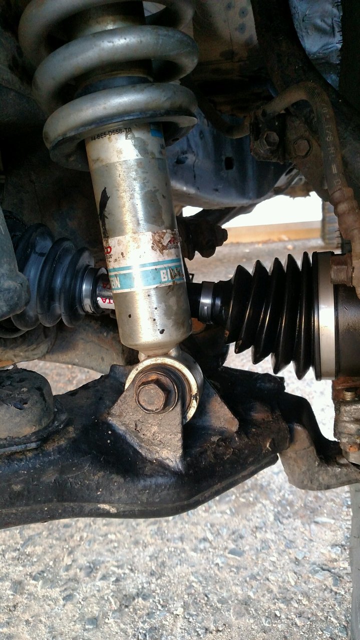

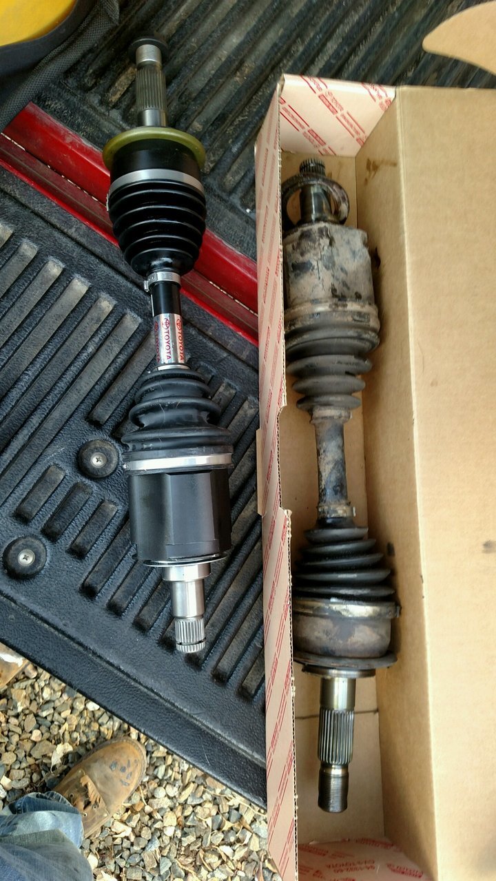

    Also, I replaced the driver side CV Axle with a re-manufactured unit from the Toyota Dealership since the outer boot tore and was slinging grease everywhere. In Toyota's defense it was my fault that the boot ripped. I was trying to drill out a broken bolt on the brake shields up front and the plastic chuck of the drill was rubbing against the boot. I didn't know it at the time but it wore the boot thin in one spot and it eventually split. I was going to just do the boots but they cost $70 and the re-man unit was only $160 once I return the old core so I went with that. A new or re-man unit from an autoparts store was out of the question because I haven't heard anything good about aftermarket CVs for Tacomas. I might replace the other side in the near future since the boots are starting to get small cracks from dry rot in them.
