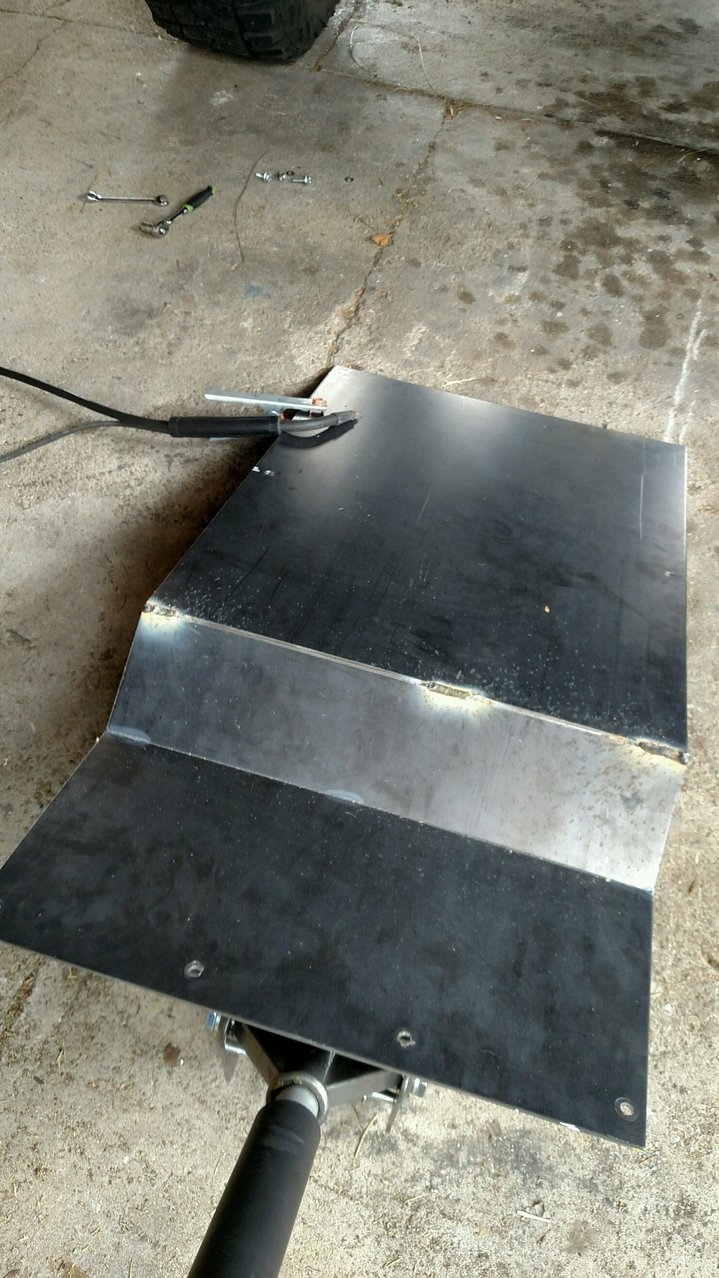

    Called Allpro/Trailgear earlier this week and finally got a straight answer and it looks like it'll be at least a month before they start shipping out skidplates again. So I just went ahead and picked up some 3/16 steel and made the things myself! Theyre ready for paint and should be done later this week. I should have done this months ago :oops:

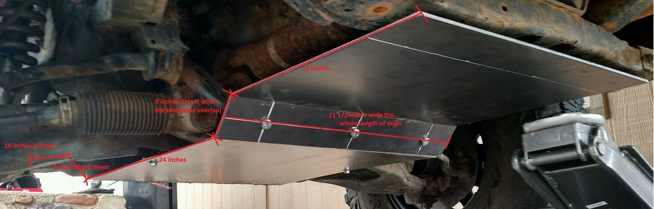

    Thanks! And I ended up using two sheets of 3/16, the front skid was 21 1/2 X 42 inches and the transmission skid was 21 1/2 X 18 inches. The front skid had three bends 1) 10 inches from the front 2) 15 inches from the front and 3) 3 inches from the back of the skid. The Transmission skidplate only had the one bend in it three inches from the front where it connected to the front skidplate.
    Hope this makes sense and helps a little bit. Here's a picture to better explain. The hardest part will be lining up to drill the holes and getting the angles right so everything fits. I definitely recommend a protractor or something.

    Did you bend the sheet metal or cut and weld? Nice job BTW

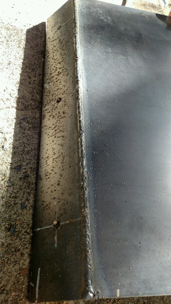

    I think it's called a whiskey bend... cut about 90% of the way through, bend it and then weld.
