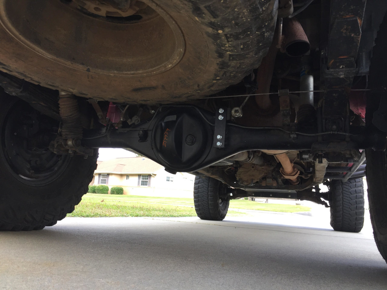

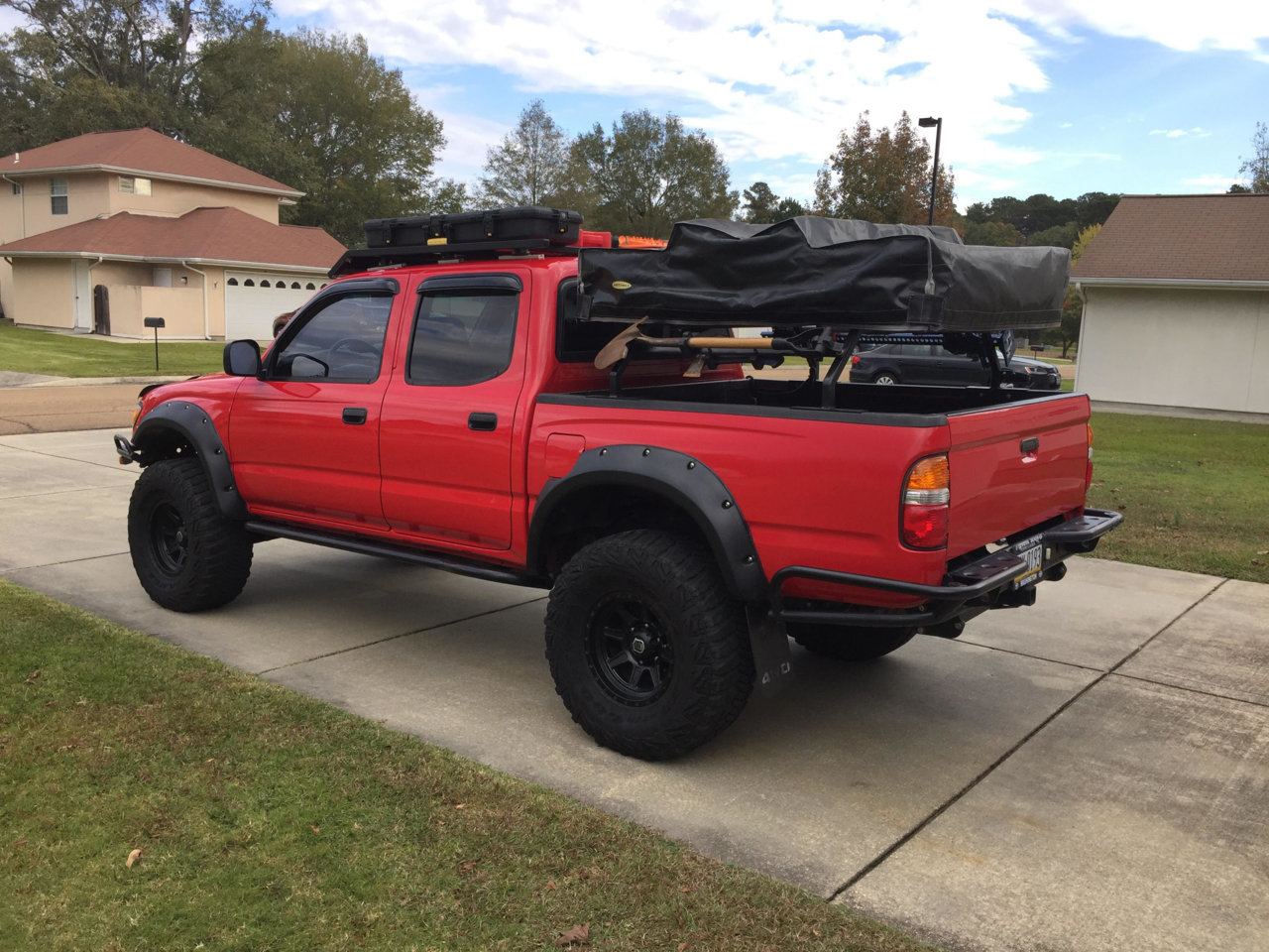

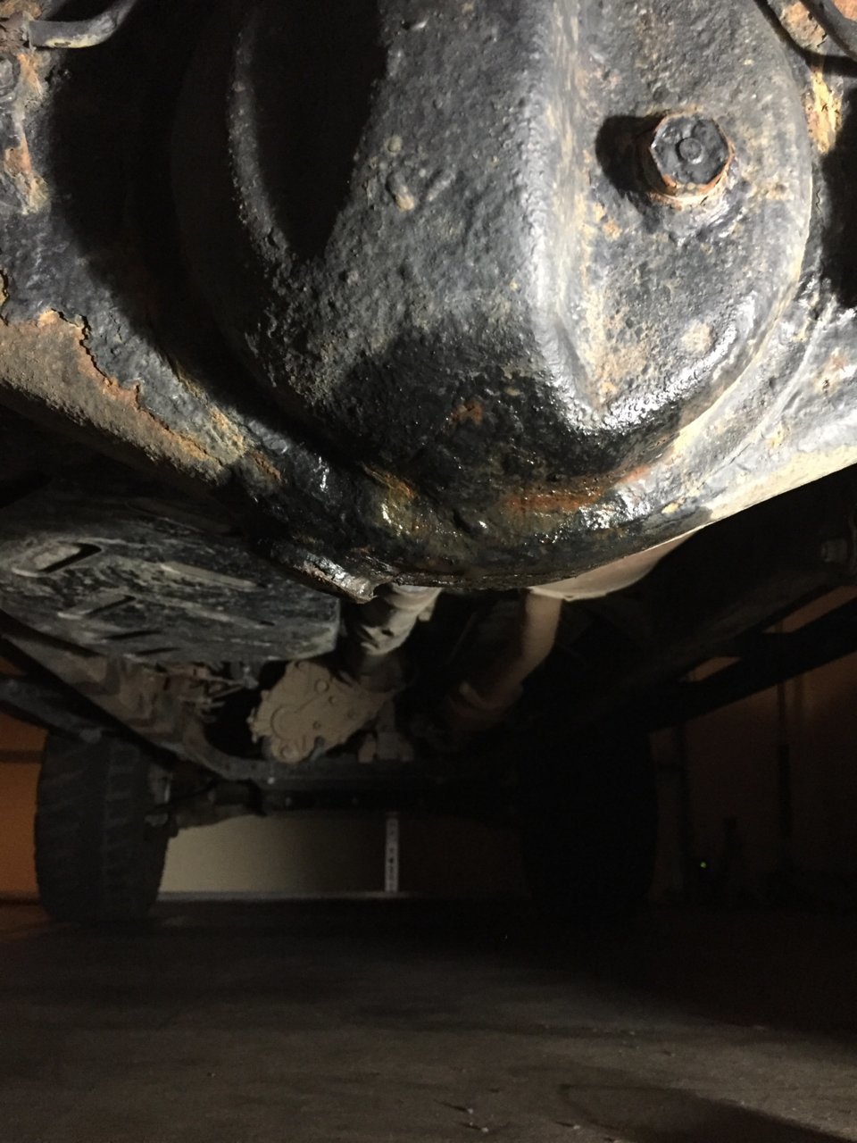

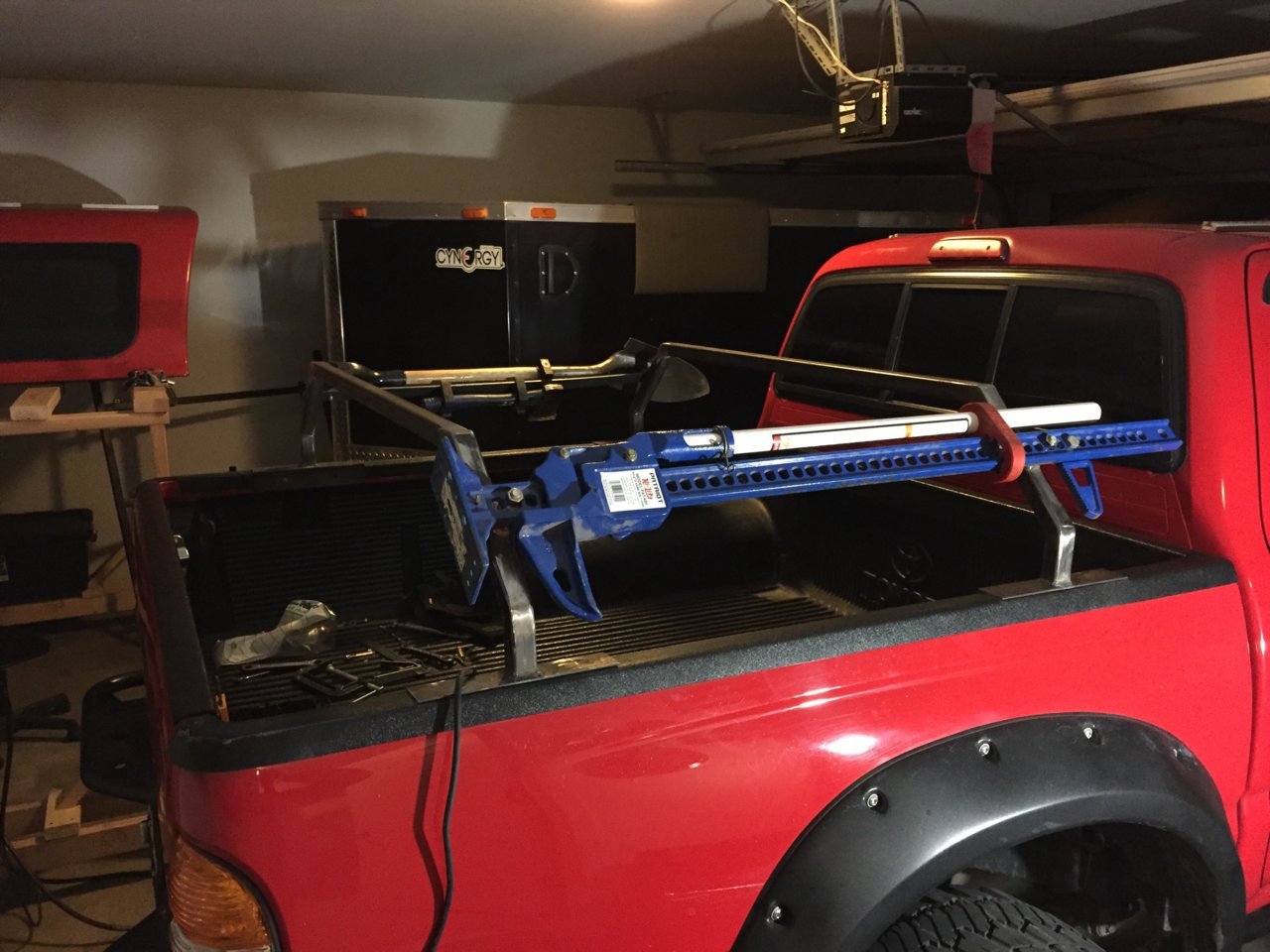

    Recent update... the truck is currently parked for the time being. The rear diff rust finally got too bad and it started leaking through. The brake dust shields and seal around the third member needed changing soon anyways so I just went ahead and ordered a complete junkyard axle off a 137k mile California truck and I'm going to replace the whole unit. Also, threw together a bedrack for the rooftop tent since I have a garage to store my cap in now.
    The old rusty piece...
    The new one coming from CA in a few days...
    And the bedrack pre paint... you can kind of see the rack I made to hold my cap and take it off by myself.

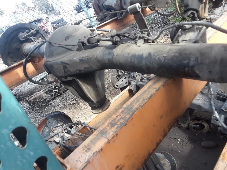

    I got a pretty nice rust free 137K mile axle for $1000 shipped from Rancho Toyota Recycling. I think thats a pretty good deal.

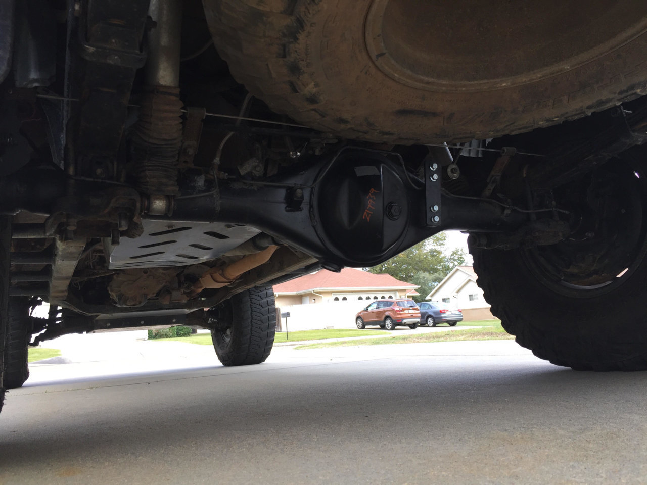

    Well I got the new to me axle swapped in and I was impressed with how smoothly it went. Only one bolt from the ebrake cable put up a fight but eventually came out. The new axle is super clean. While I was at it I changed the diff fluid, new brake hardware, shoes and drums in the rear and made a bracket to extend the Brake LPV for the lift that looks a lot more professional than my last fix on the old axle. The bedrack also turned out great and is really compact when its off the truck which is nice. You can see the dent above the tail light is gone on the driverside as well. I think this is the first photo I have of that after I repaired it even though it was fixed months ago. It didnt turn out perfect but pretty good for my first attempt at bodywork!

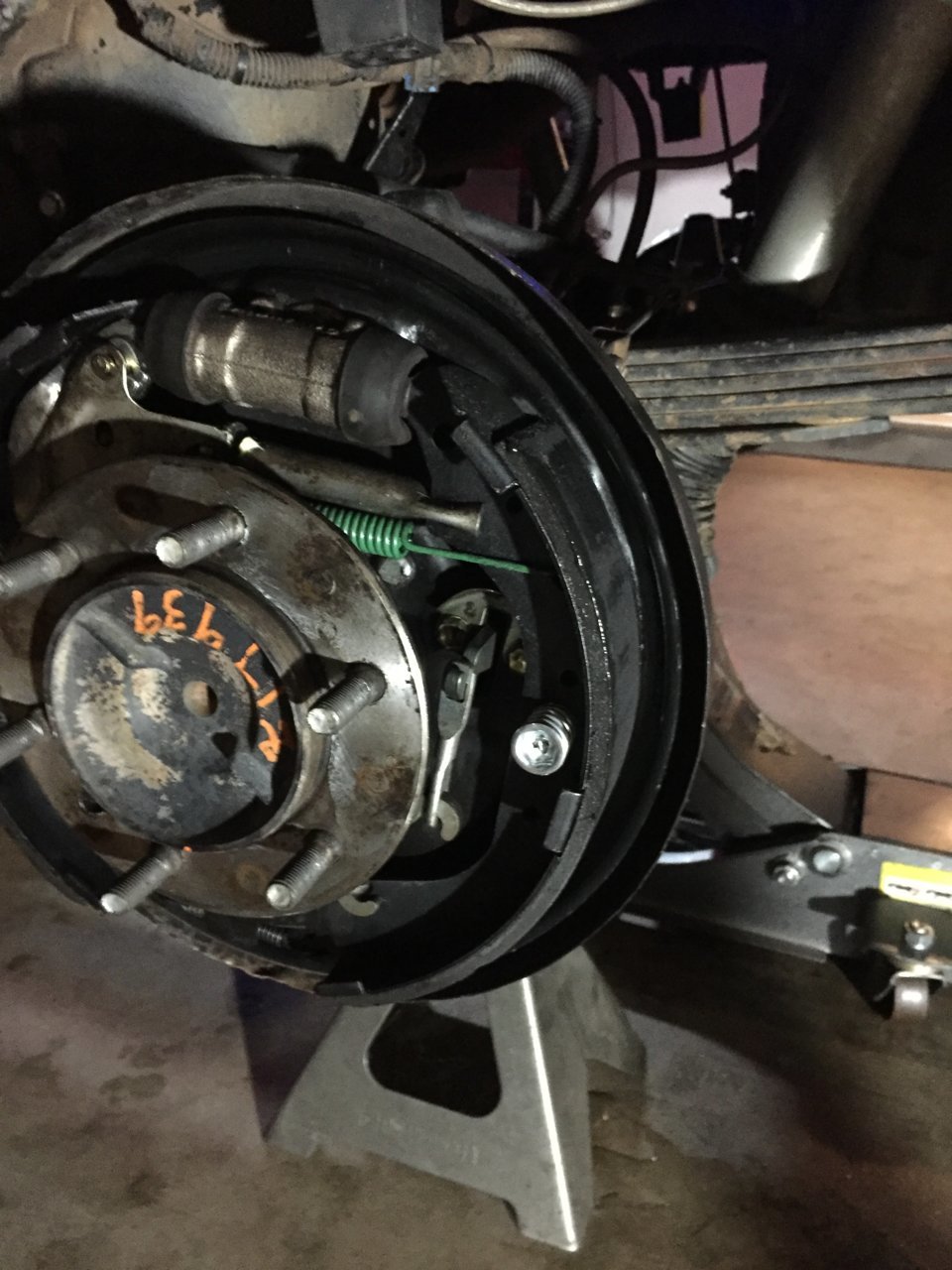

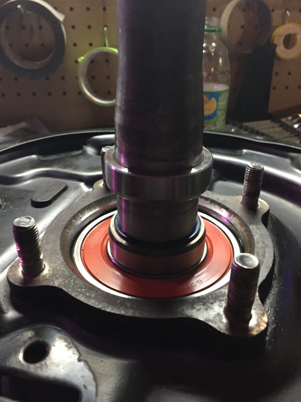

    Turns out the new axle had a bad inner seal on the drivers side. Ended up changing out the wheel bearing, retainers and other seals while it was apart. I eventually figured out the axle I got was from a 1999 Prerunner Tacoma that must have had ABS at one point and was converted to nonABS. This meant the original wheel bearing kit I ordered was a newer design (they changed the wheel bearing design halfway through 2000). I eventually got it sorted out and the local Toyota dealership got the new parts pretty quickly. Got some cool new tools out of the job (Seal driver kit, Harbor Freight 20 ton press and special service tool) and some good experience. Hopefully its good to go now!
    This video was extremely helpful as well as a number of Tacomaworld and T4R threads. The video is for an ABS axle but since mine no longer is ABS I just followed the same steps but left the ABS tone ring off.
    https://youtu.be/AVhSDnw2ugo
    Here is the link to the special service tool I purchased on Ebay from a guy who hand makes them. It worked great for removing the retainers and was a fraction of the cost of others I found. I also ordered the late model adapter plate that he sells in case I ever need the tool on a newer Toyota.
    https://www.ebay.com/itm/Axle-Beari...h=item2ce0764ffd:g:7LgAAOSwkfxb7DLi:rk:2:pf:0

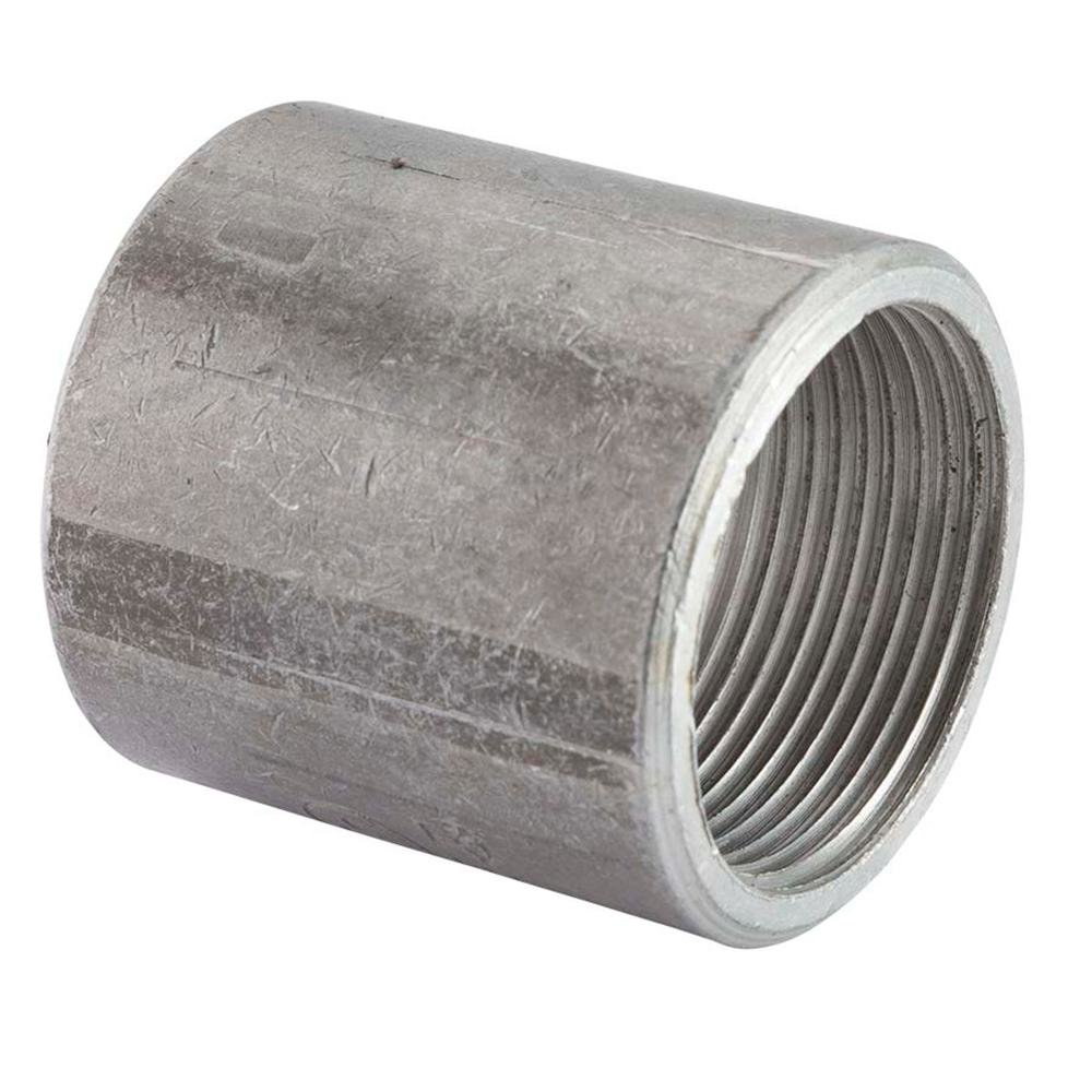

    I used a 1 1/2 inch galvanized pipe fitting as a press sleeve to press the new retainers on.
    https://www.homedepot.com/p/Halex-1-1-2-in-Rigid-Conduit-Coupling-64015/100196848
    Heres the mess of gear oil and brake dust...unfortunately I had to replace the shoes even though they were only a few weeks old.
    New bearing and retainers pressed on...
