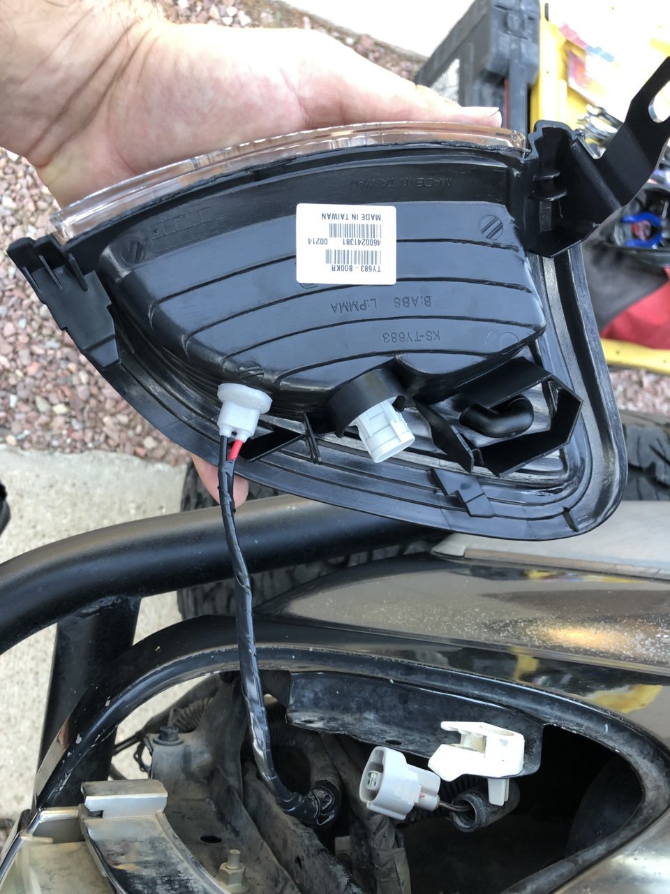

    Yeah, I ended up relocated them to the marker light as well. Just used a small hole saw and the cut some notches to hold the bulb in place with a Dremel. Definitely doesn't looks as nice as yours, but it's functional haha.

    Where did you get that LED socket? Also did you do anything to fix the fast blink from LEDs?

    I got the sockets from Amazon. These were recommended to me by @chrslefty and i know that others have used them too.
    https://www.amazon.com/dp/B01FSY2MVM
    to get rid of the hyper blink i bought and installed an LED friendly flasher relay. I bought it at AutoZone again on recommendation from Chris. The install details are on the last page of my build thread.
