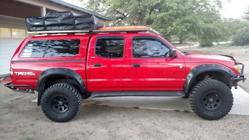

    The latest changes to the truck are underway... Rotopax, Maxtrax, On-board air, new lighting and a new roofrack system are soon to come. Everything is ordered and on its way. Once I get the parts I'll start building the new roofracks to fit everything over the next few weeks. I'm going to make a simplified version similar to the Prinsu racks. Rotopax, Maxtrax and a Plano storage case are going over the cab and the tent is going over the shell. Trail jack and shovel will be moved to a rack inside the shell.

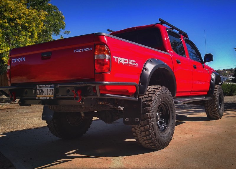

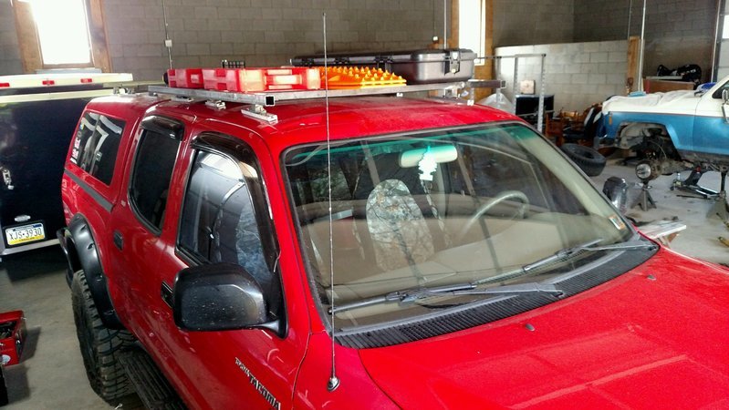

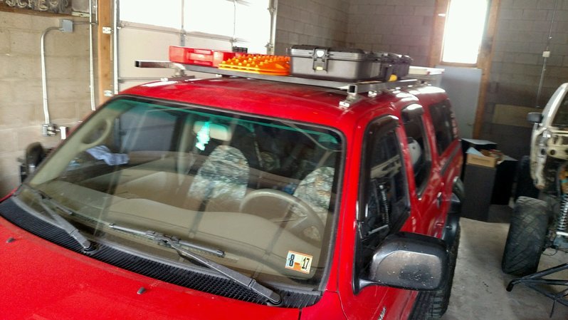

    Got the roofrack sold to a fellow Tacoma owner. He sent me this picture a few days after with the rack installed on the cab of his First Gen DC Prerunner. Same color and everything!

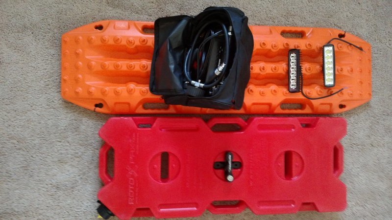

    Ordered some more gear... I can't wait until final exams are over to start making the new roofrack system!

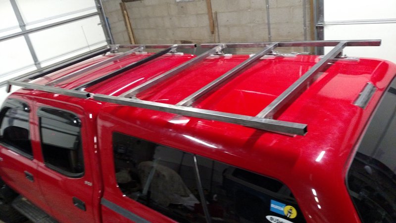

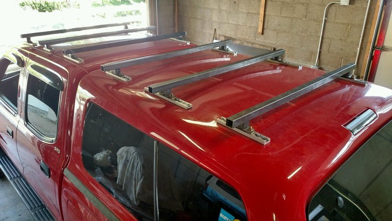

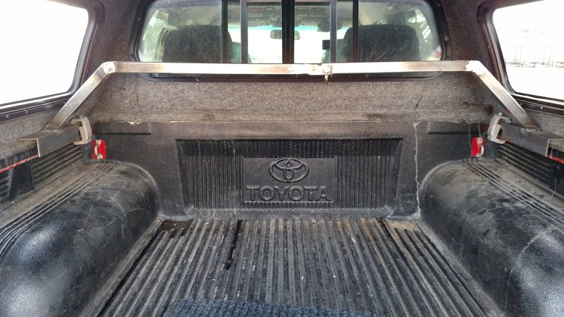

    A little update on the roofrack progress... I don't think I will have everything done for Overland Expo West this weekend so I may be going back to the ground tent for this camping trip... :tumbleweed:
    But the rack is coming along nicely!
    I apologize for the crappy cell pics in advance..

    Slowly but surely...

    Getting closer just need to mount everything and do some more grinding!

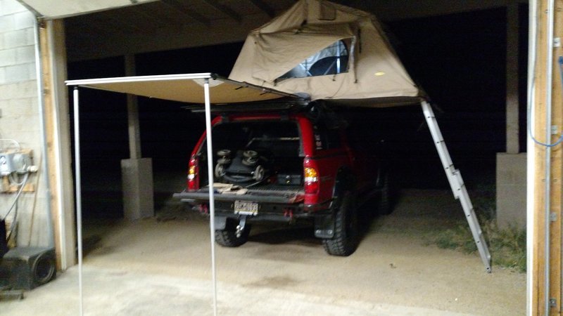

    Awning mounted up...

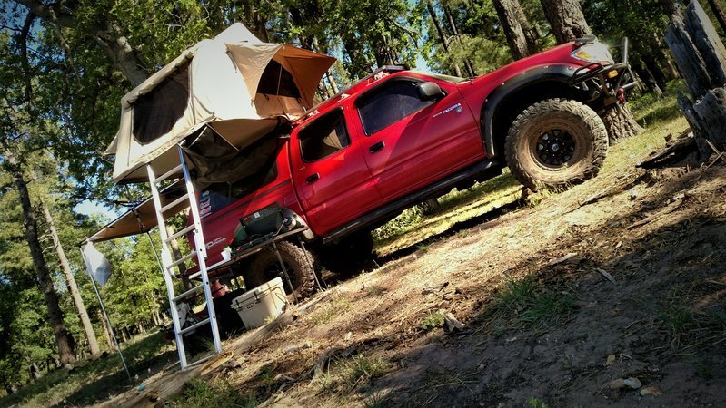

    Another camping trip to Lake Havasu and Parker Arizona. Nice and windy so it was a good time to test the awning out. Also hit some dunes south of Parker on the way home and tried out the Maxtrax. I'm very impressed with them so far. I can already see that I'll need to repair a few teeth soon though. Probably my fault for trying to use them at 35 psi though...

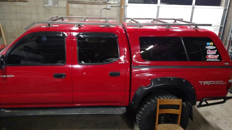

    What did you use for the mounts on the rack? Thinking about doing this same set up, maybe a little more low profile!

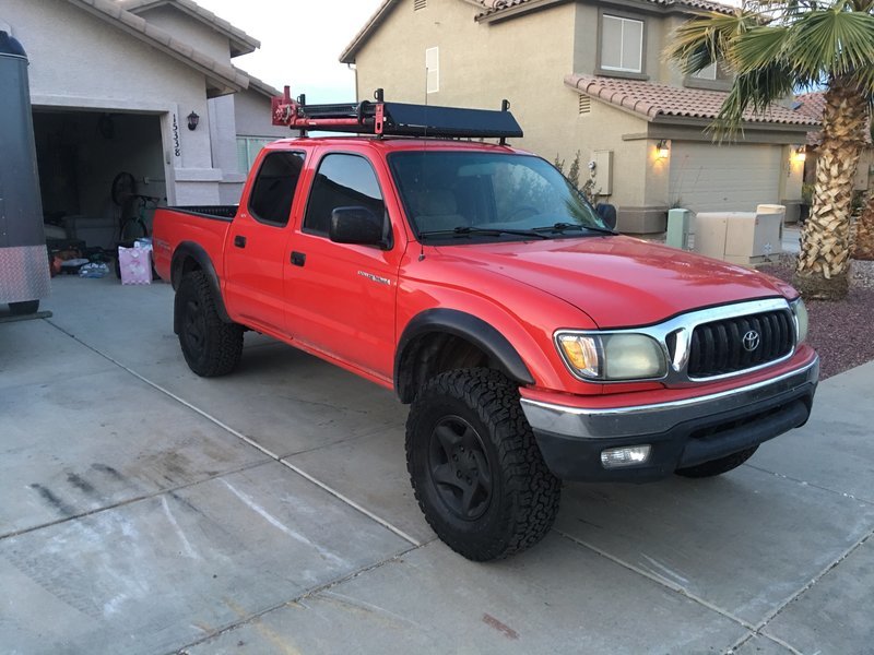

  16. Jun 6, 2017 at 8:52 AM
    #136
    jcott329
    jcott329 [OP] Well-Known Member
    Feb 18, 2014
    #123401
    391
    Jordan
    Northern Mississippi
    2012 DCSB TRD OR

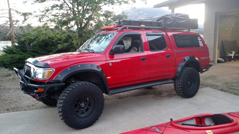

    I used sections of aluminum L track that are connected to the cab with rivnuts and are bolted through the cap. Then the roofrack is bolted to the L track with the studs below. The the L track stays on the roof at all times but the roofrack can be removed.
    Also I don't think it could be much more low profile due to the curvature of the roof. The highest point on the roof is the back of the cab and there is about a half inch of clearance at the highest point on the crossbar there. This is essentially the determining point for the height of the rest of the rack if you want to make it flat accross the whole truck.

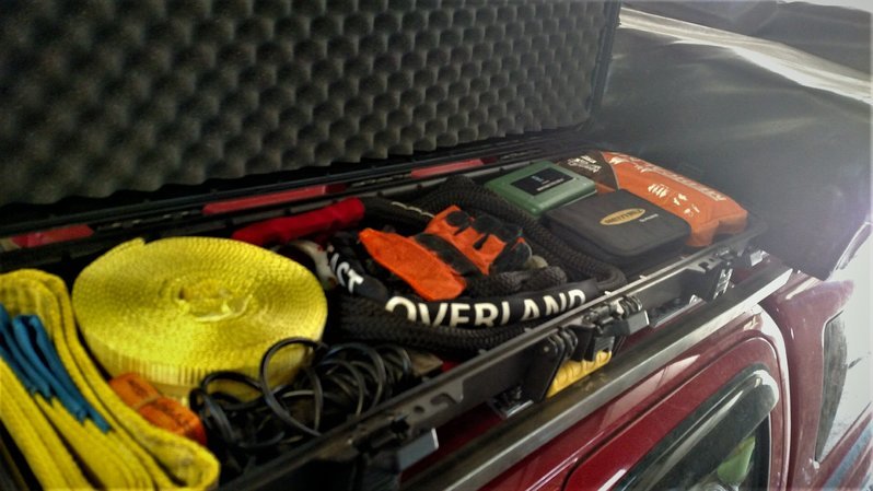

    Some more pictures from last week...
