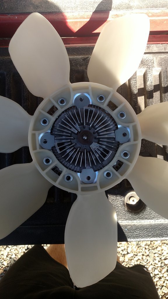

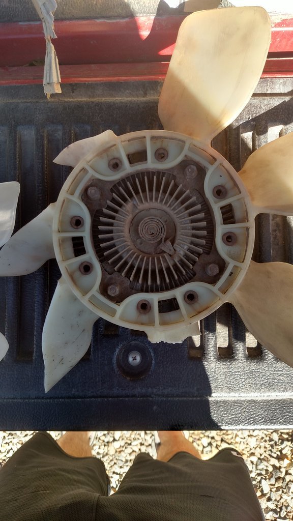

    Productive weekend started when I broke my engine cooling fan when making a small water crossing (you think I would learn to stay away from those). All said and done I ended up replacing the engine fan, fan clutch (which was bad anyways), changed Diff and Transfer Case fluid, and changed the fuel filter which I'm sure were all over due. Here are the links I used to help out if anyone is interested.
    Fuel Filter:
    http://www.customtacos.com/tech.old/index.php?article=175
    Diff/Transfer Case Fluid:
    http://www.toyotanation.com/forum/6...120918-rear-diff-oil-blues-3.html#post1492885

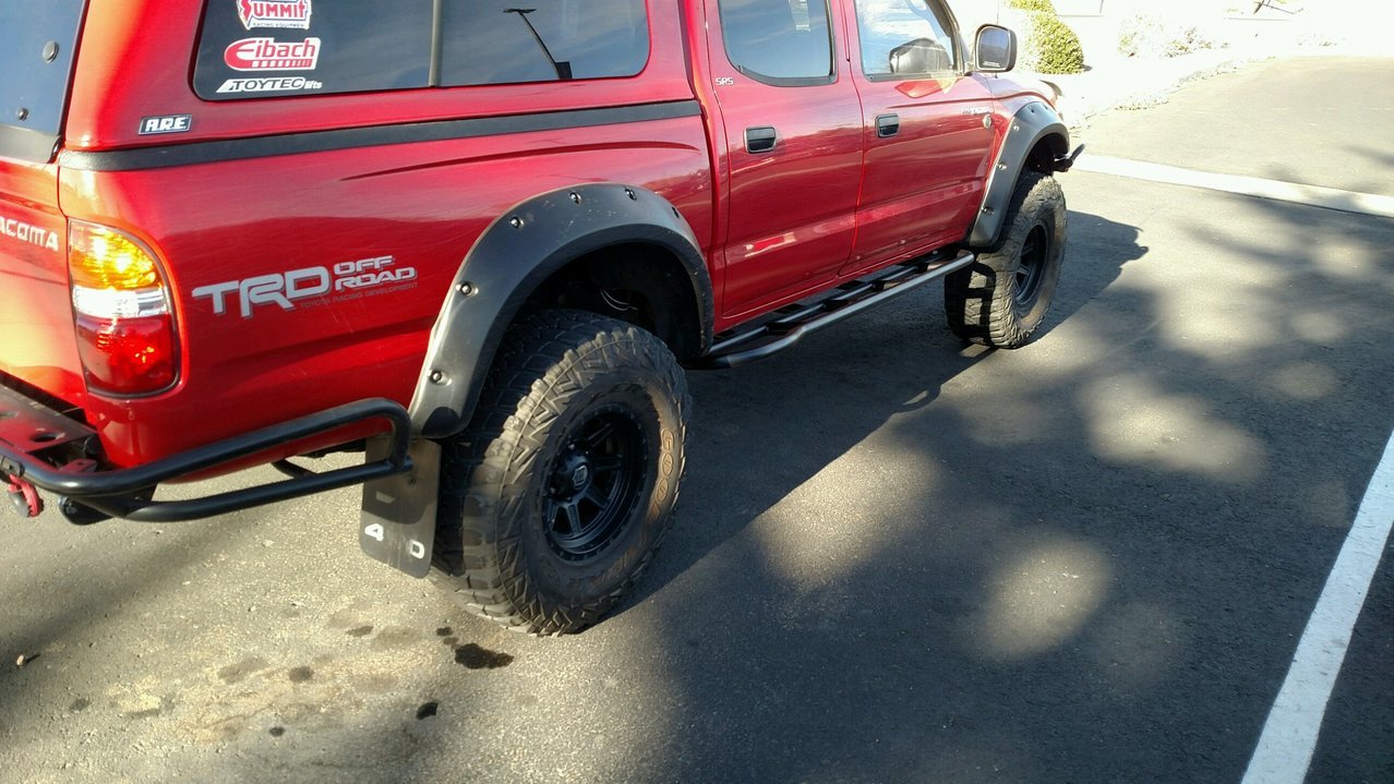

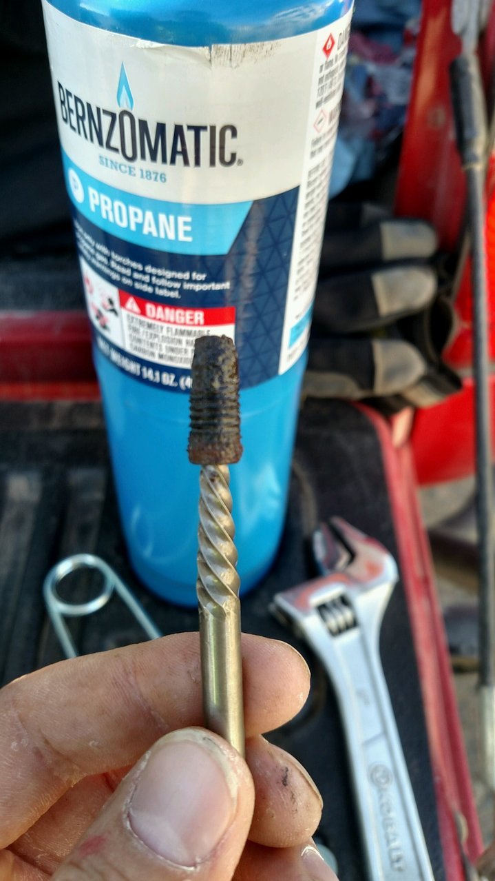

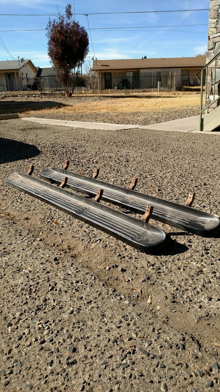

    Quick update because its been a while... Ordered a new gas tank skid from Low Range, CBI frame reinforcements and 4xinnovations sliders! Waiting to hear back from Allpro Offroad about ordering their IFS skids. It's weird that they didnt offer a black friday/cyber monday sale this year and havent returned my calls...
    Also upgraded from the ol Chicago 'lectric welder to a new Lincoln 140. Can't wait for everything to come in to get it installed!
    Of course all the bolts wouldnt just come right out even after a generous amount of PB Blaster. Oh well got to try my skills with the easy outs on two of the bolts. It was a good feeling replacing all of the hardware with some new Stainless Steel bolts from the local ACE hardware. Removed the old gas tank skid and running boards this past weekend to prep for the upgrades. I could break the old gas skid in half by hand... I think it was time for a new one. And the Low Range skid looks a lot heavier duty. Figured this was also a good time to remove the diff drop. I dont think it helps that much so I went ahead and ordered some 1/2inx20 x 7 inch grade 8 bolts for a couple bucks from bolt depot online.
    Out with the old...

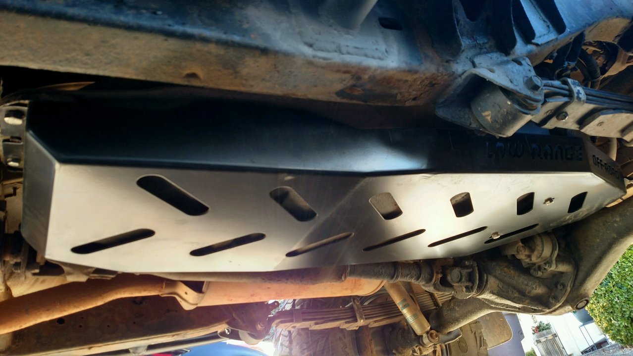

  16. Dec 8, 2017 at 11:49 AM
    #176
    jcott329
    jcott329 [OP] Well-Known Member
    Feb 18, 2014

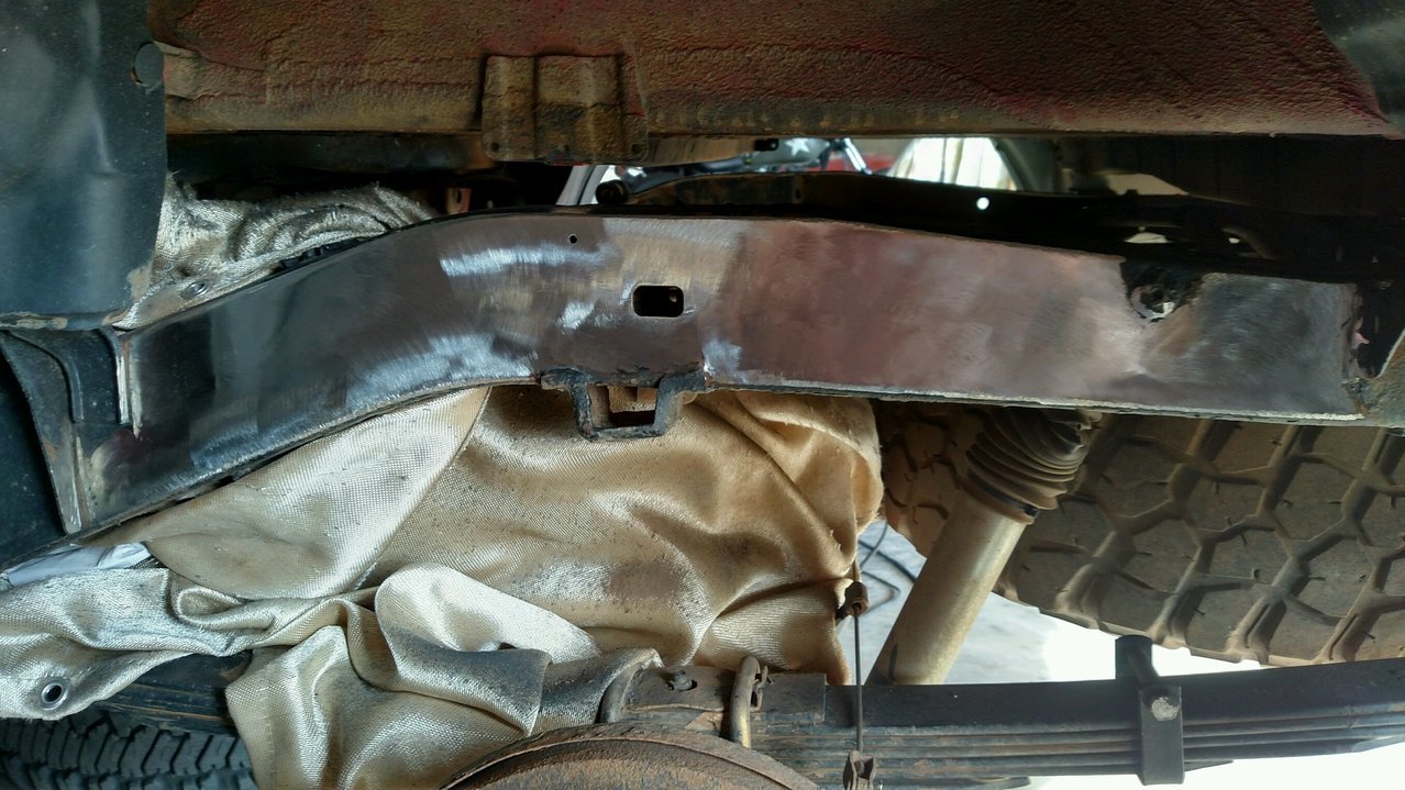

    #123401
    390
    Jordan
    Northern Mississippi
    2012 DCSB TRD OR
    Got the sliders and gas tank skid installed so far... still waiting to order IFS Skids from Allpro Offroad as they are currently moving their shop. Hoping to get the frame reinforcements welded on next week. I'm very impressed with the Lincoln 140 I picked up. As you can see below I was able to get pretty good penetration on the 1/4 inch frame plates and for Flux core and my very limited ability, I was able to lay some half decent beads. Also removed the front diff drop and put in some grade 8 bolts that were stock length.

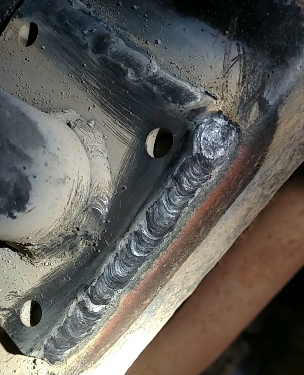

  17. Dec 11, 2017 at 8:38 PM
    #177
    jcott329
    Feb 18, 2014

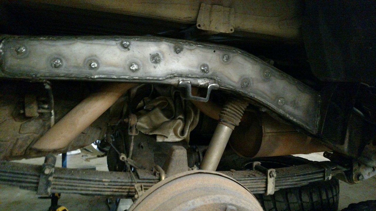

    #123401
    390
    Jordan
    2012 DCSB TRD OR
    CBI frame reinforcements installed :welder:
    And yes I also noticed the missing rear bump stop on the driver side... time to upgrade those in the near future now :rolleyes:
