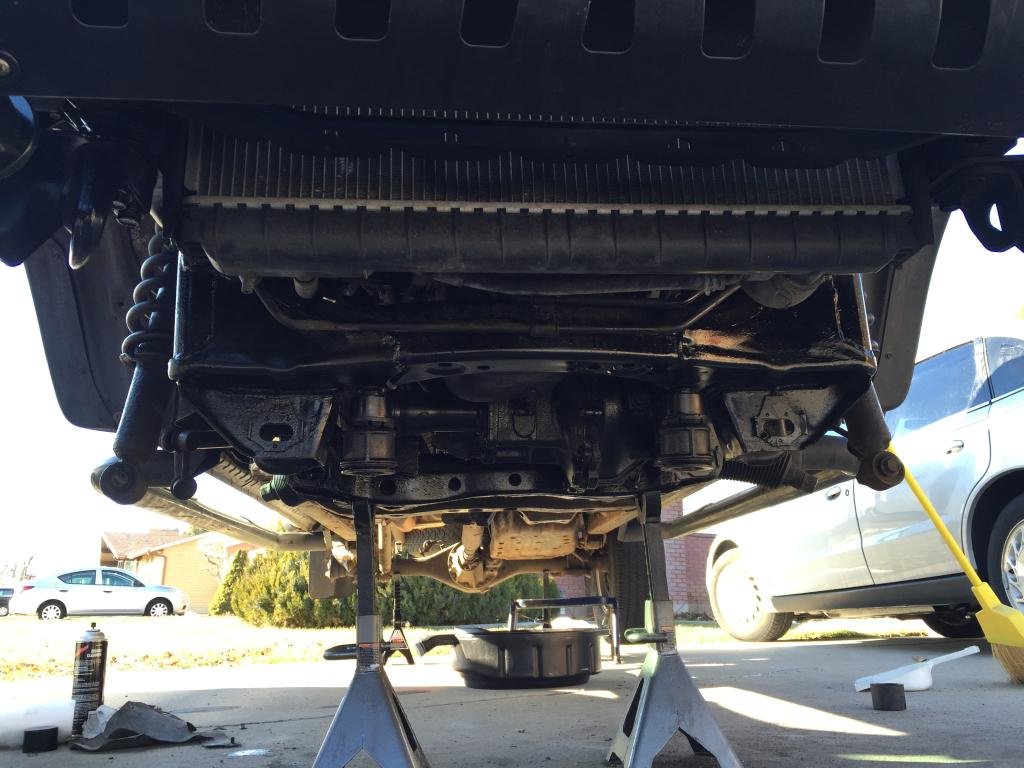

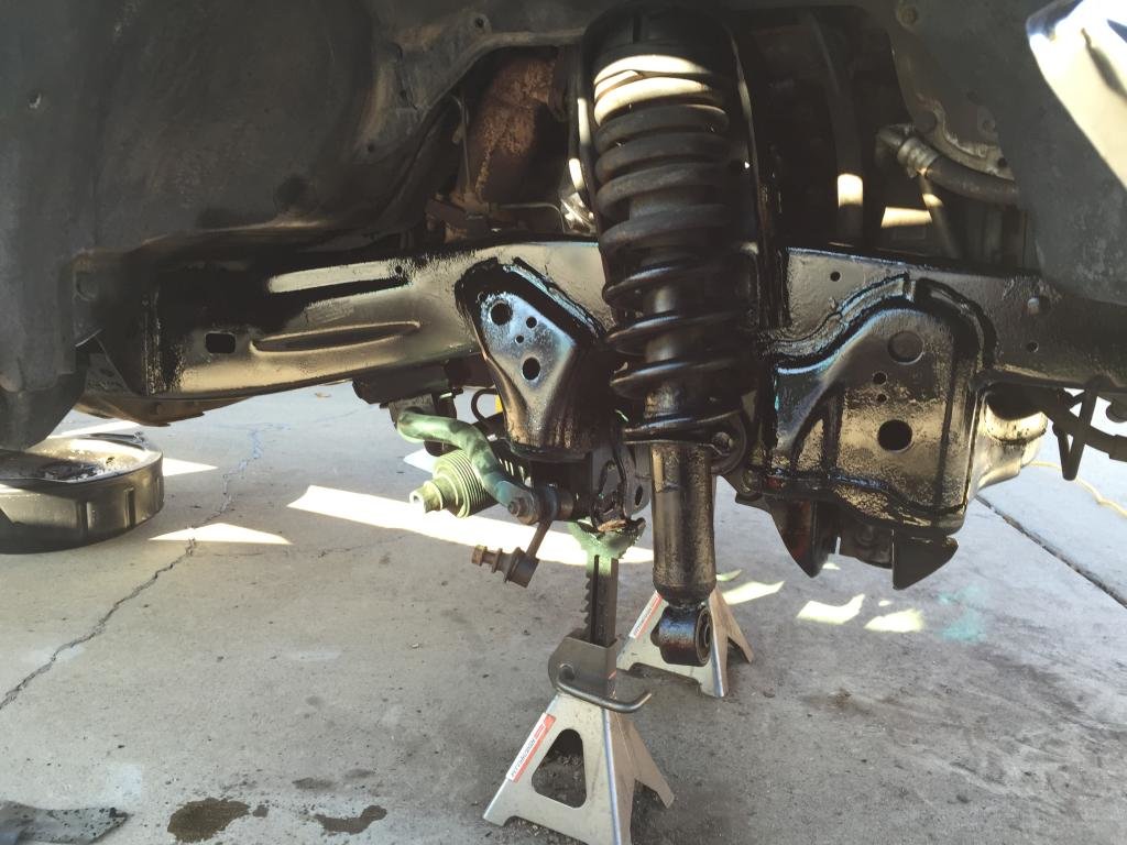

    '01 Tacoma Double Cab
    Got to work on the front end today. I have just about everything torn out. There were a lot of rusty bolts. I spent the better part of a couple hours on one.
    The wind was taken out of my sails for the day when I realized that I had to move the steering rack to take off the lower control arms. I kept telling myself that the work will be worth it when the truck drives like new in a few days. Assembly will go by much quicker then disassembly. I am going to freshen up the components with a coat of paint as well.
    Here are a couple pictures of the work...
    Passenger front:
    Driver Front:
    Parts Removed:
