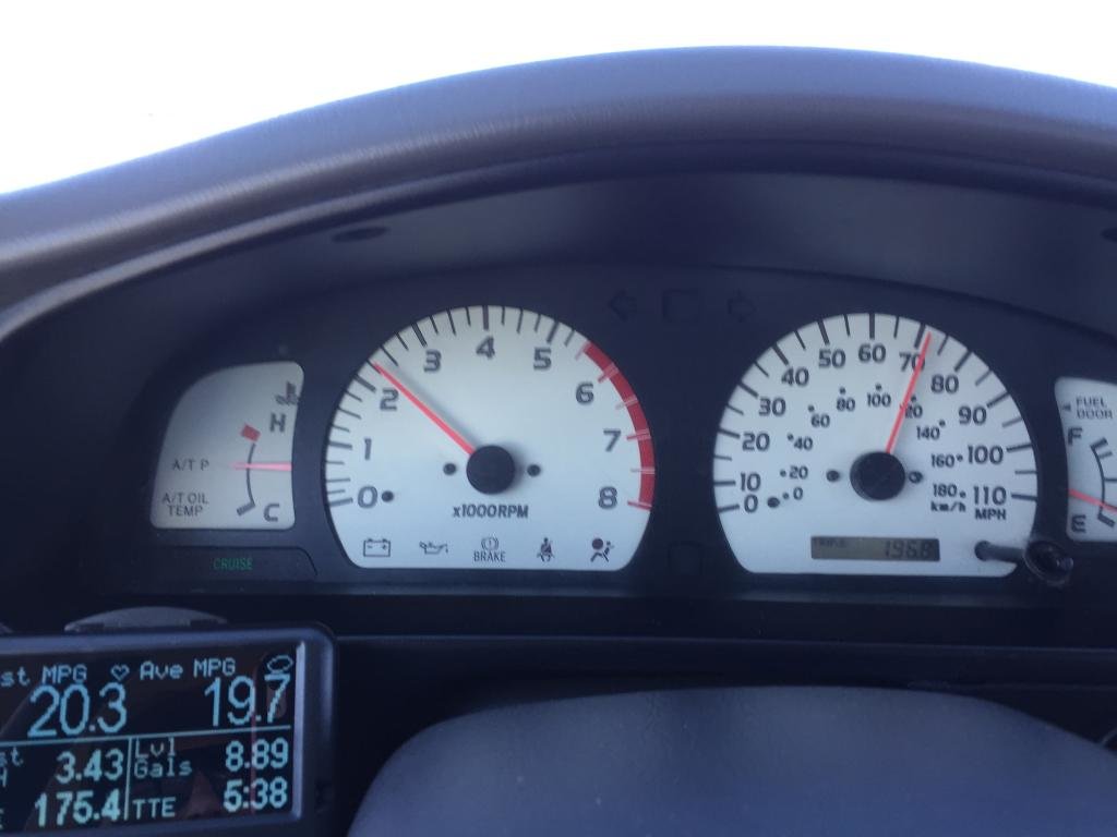

    So I decided to take a picture while driving (I know, not the smartest). Maybe you guys can tell me if this is normal or not? I think I am getting great gas milage and the truck does not seem to be running high rpm's. I'm pretty sure that the speedo is off since the bigger tires. I guess that I am doing about 75mph.

    Seams fine, mines a little higher rpms. In 5th gear but I'm a manual :)

    Awesome! I really wasn't worried about it. I was curious of what other people were getting. I love this truck more and more. My wife has a Lexus suv (the RX) and I get better mpg then she does. Maybe it helps that I drive 100 miles a day on the freeway.

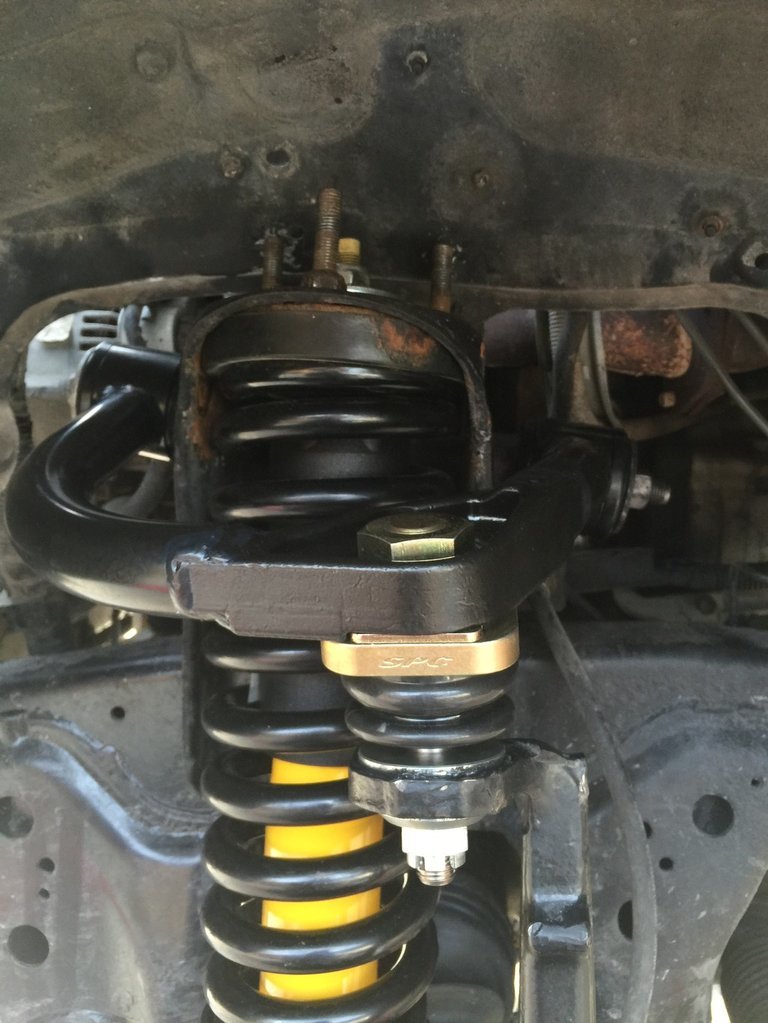

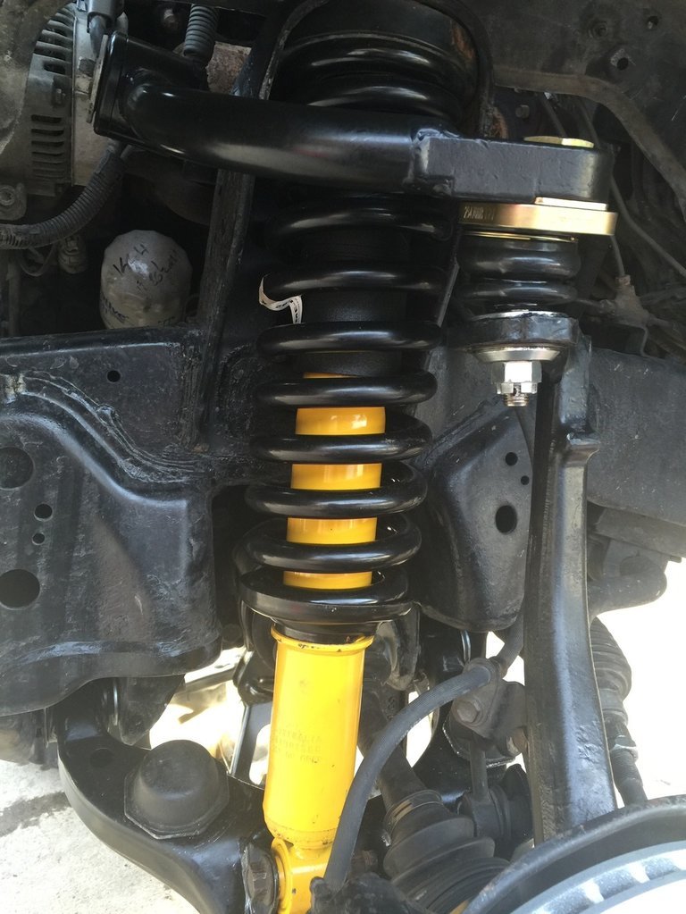

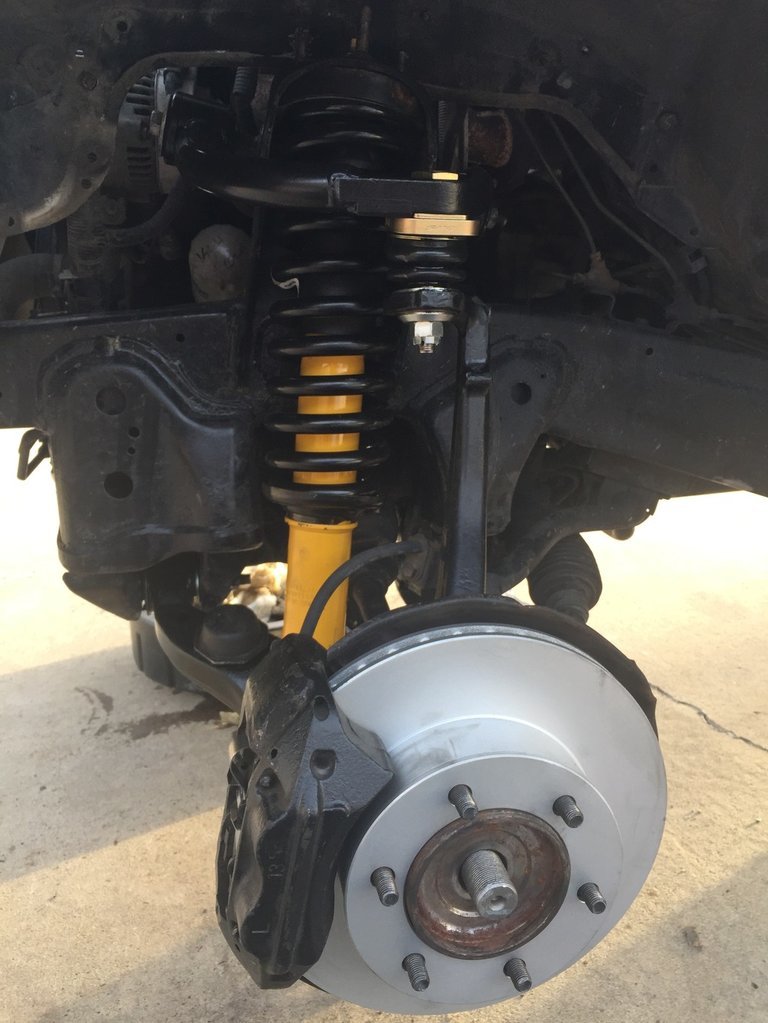

    Finally got some work done on the truck today. I've start the new suspension instal. Well, it's a little more than just suspension. Here's the list:
    OME 882 coils
    OME Dakar Leaf springs
    OME Add-a-leaf
    OME Nitro Sport Shocks
    OME Greasable Shackles
    Trail Gear 1.5" Extended Greasable Shackles (for when I put on a bed rack and tent)
    U-bolt flip kit
    OME 10mm Jeep Jk trim pack - I was sent the wrong ones. Once the new ones show up I will pull the front suspension and put this in.
    1" body lift
    SPC Upper control arms
    New lower control arms
    New front brakes
    I did one side this afternoon and will do the other side tomorrow. Next weekend I'll swap out the rear suspension.

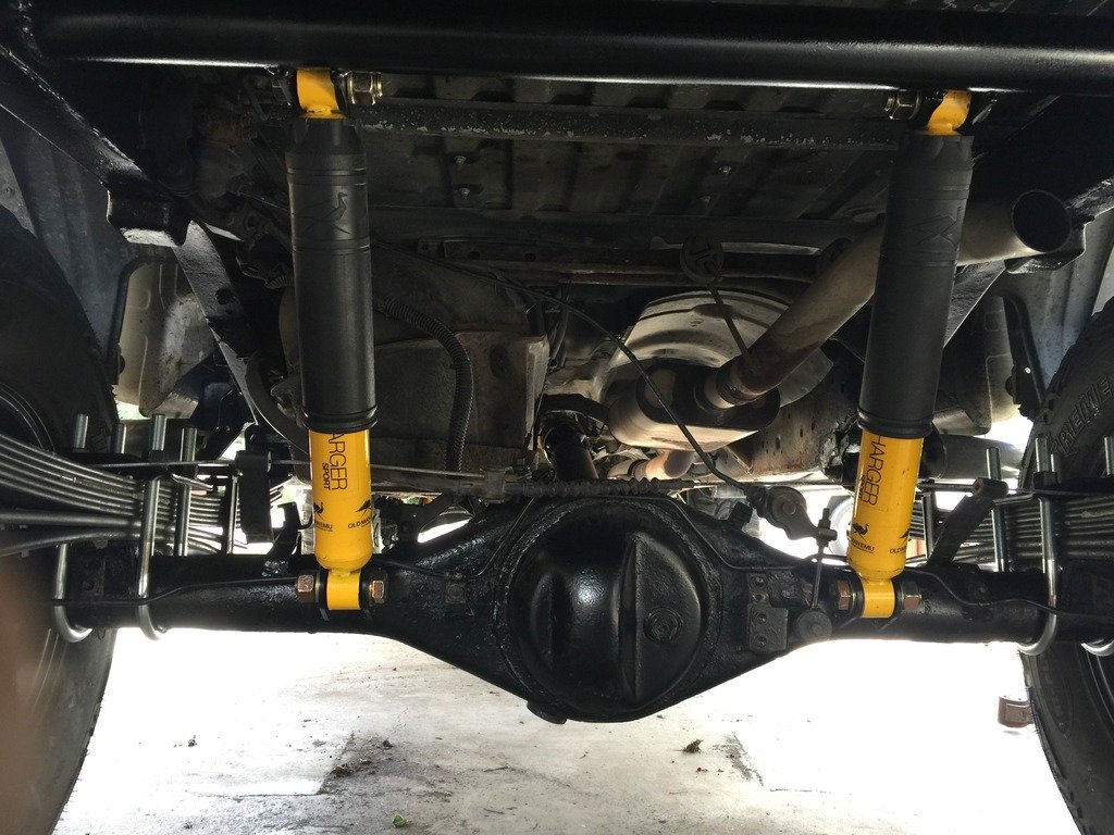

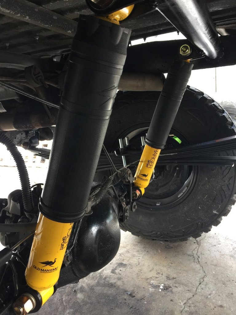

    Got the rear finished up this past week. Everything went well. I copied BoxRockets design on his shock relocation. I'm pretty happy the the finished result. I'll post some pictures of how the truck currently sits tomorrow. The shocks don't look evenly spaced in the first photo, but it's equal. I took the picture from an angle.
