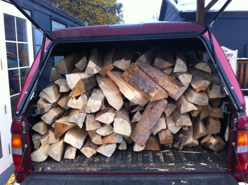

    This is two faces (16" logs) in my bed with a topper obviously. So the equivalent of 32" x 96" x 48"
    There was some left over logs from the previous season in the second picture.

    Thanks for both these replies. I now know there's a difference between square and cubic feet, and the visuals of the wood in the truck is also very helpful.
