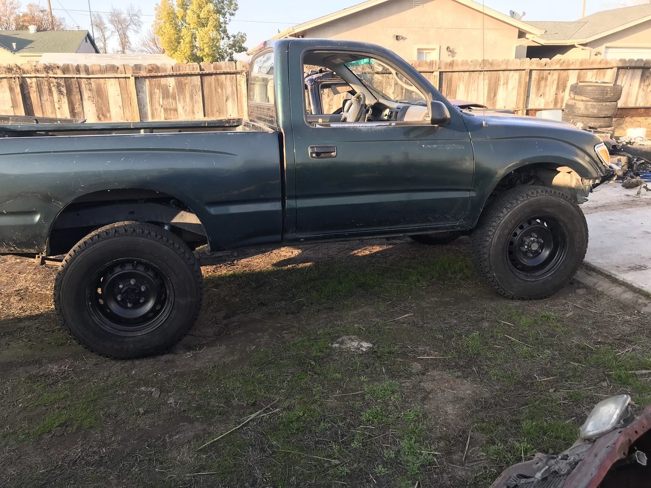

    Swapped the wheels that came on my 05 onto it so I would have tires with some tread

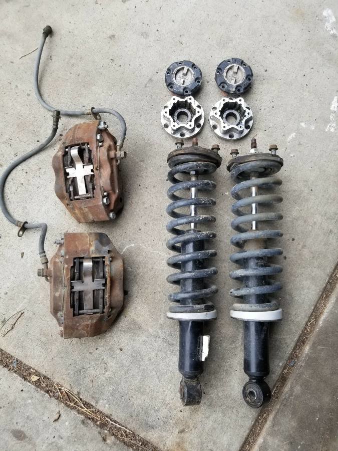

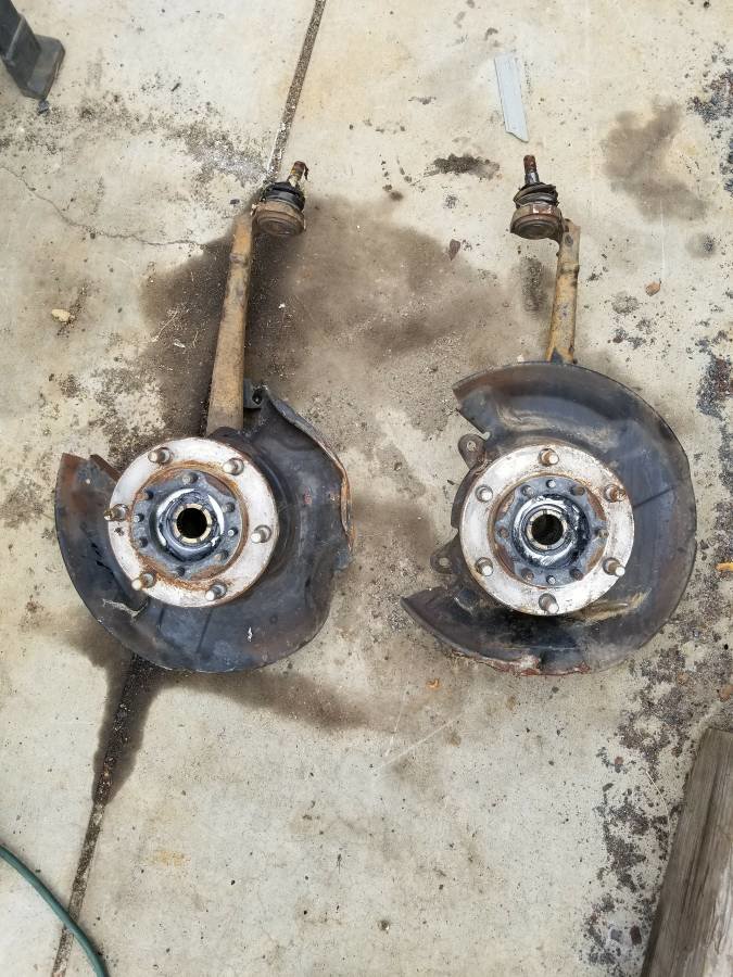

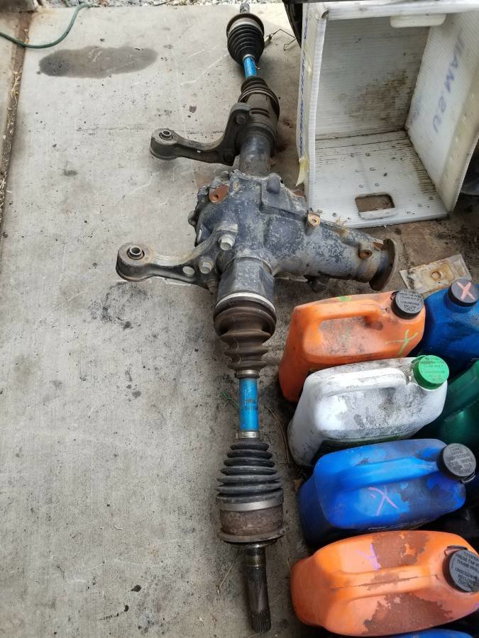

    And today I got manual locking hubs, CVs, knuckles, struts, a set of spare calipers a front diff and some 5100’s
    @BartMaster1234 what am I missing to go to manual locking hubs?
    Need to pull the AAL from my other leaf pack for this truck

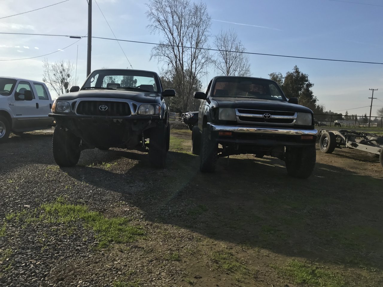

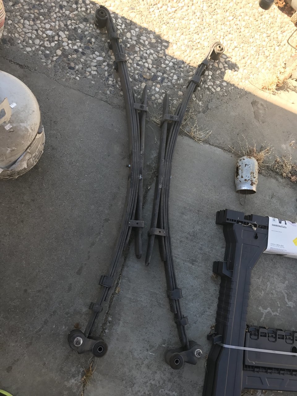

    Put 5100’s and 881 on it and pieced together a 4leaf (no overload) pack using the original pack and a leaf from a 5lug truck (I’ll get pictures tomorrow of how that turned out)
    But before I settled on that I did the 5 leafs with an AAL it was too much

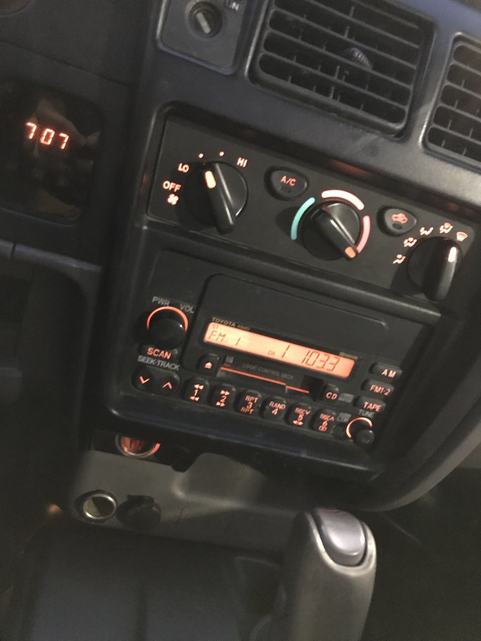

    And finally swapped the rest of the harness and now the radio works :bananadance:

    I was just casually browsing the first gen build section and came across your thread. I can't believe I missed this tag.
    Your front diff is non ADD, right? You look like you have everything. Make sure your transfer case is j shift.
    Slashaar and ChadsPride like this.

    I have the j shift and I got the other diff so I could swap the add part out with the solid jack shaft

    That's what I did. It really sucks to do that, you have to basically open the clamshell, pry the ring and pinion from the beating, and hammer the ADD stub out of the ring and pinion. Stupid design by Toyota.

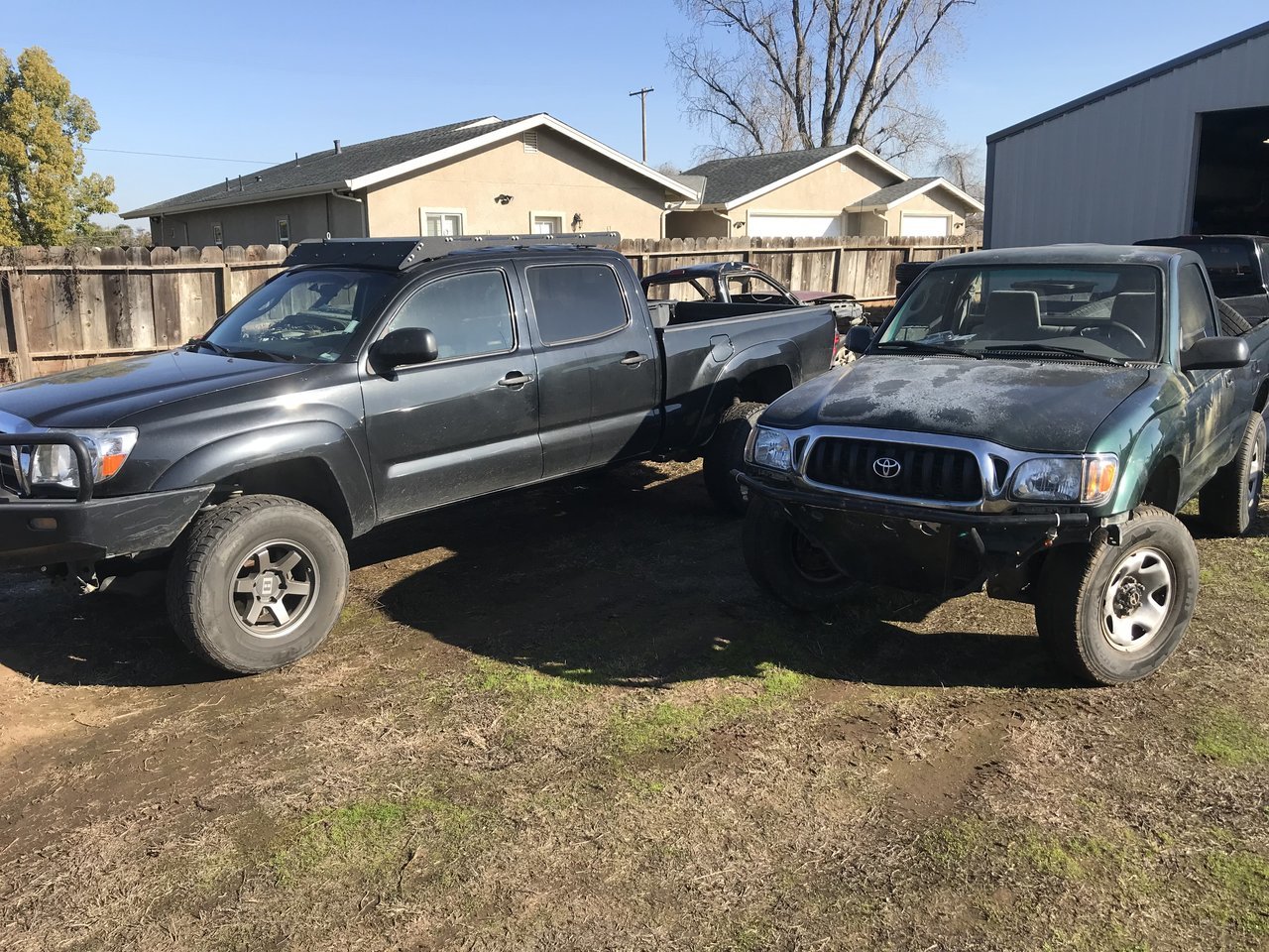

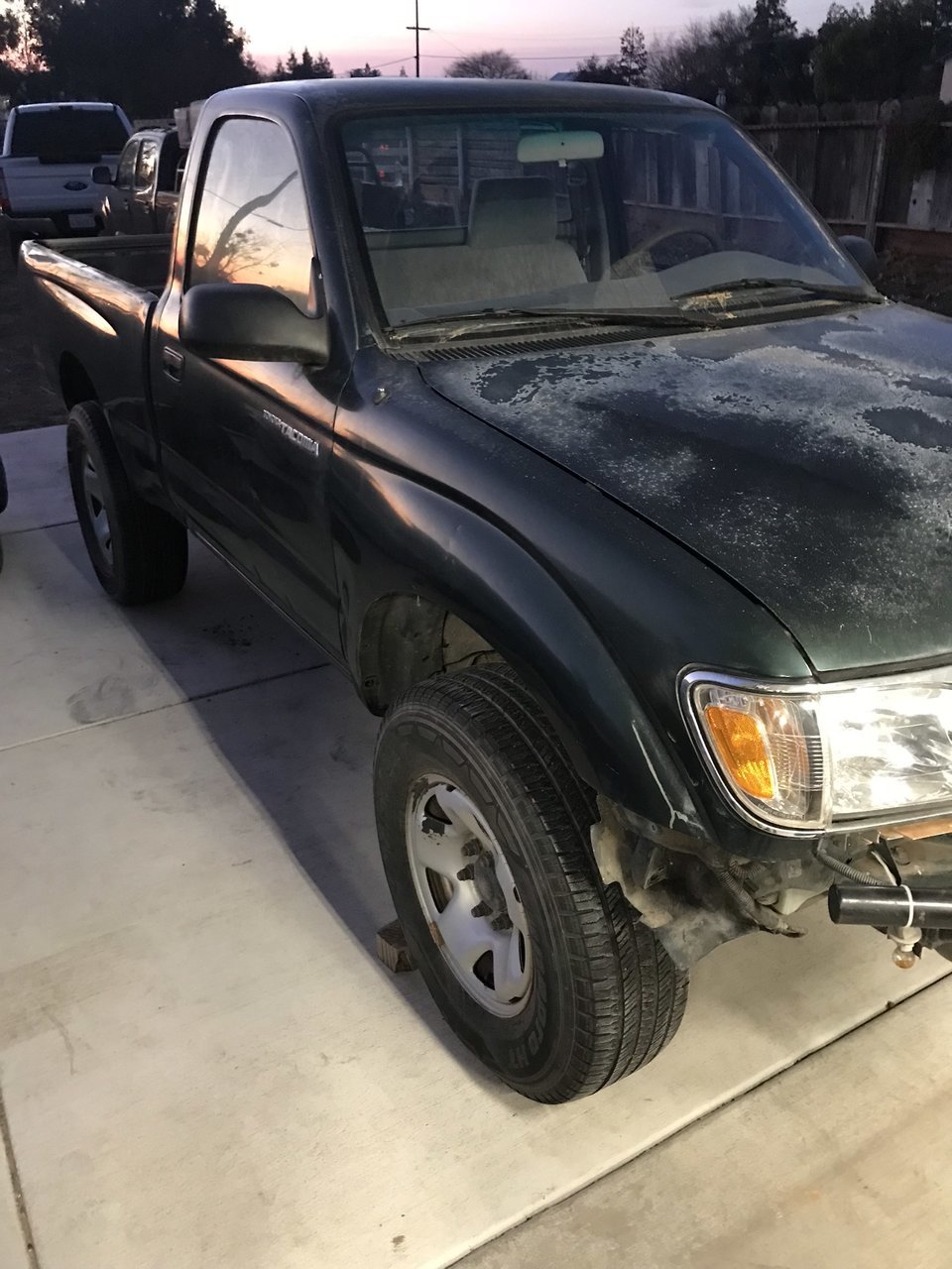

    Finished the manual hub conversion today, and started on the cab swap for my brothers truck @carst he bought a rolled 96 and a cab to swap onto it
    It’s not a junk yard we just have extra parts

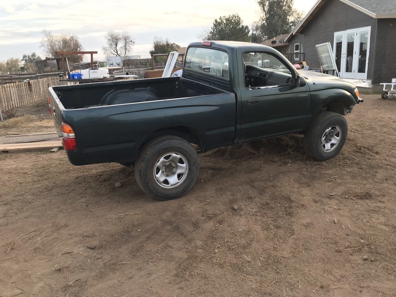

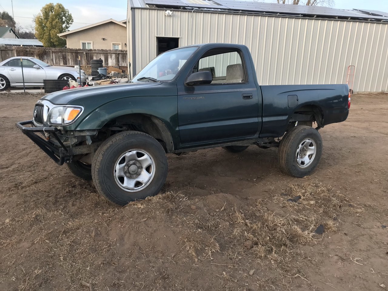

  19. Feb 3, 2018 at 8:49 PM
    #39
    foxrcing07
    foxrcing07 KO7FOX
    Aug 12, 2016
    #194389
    4,024
    Morgan
    Modesto, CA
    2019 Raptard 2001 TJ
    Dirt

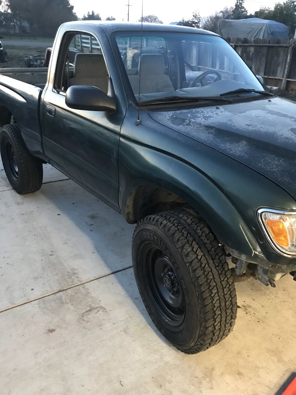

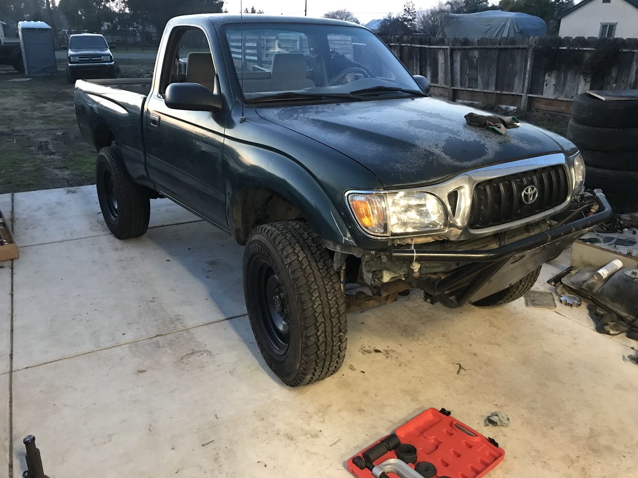

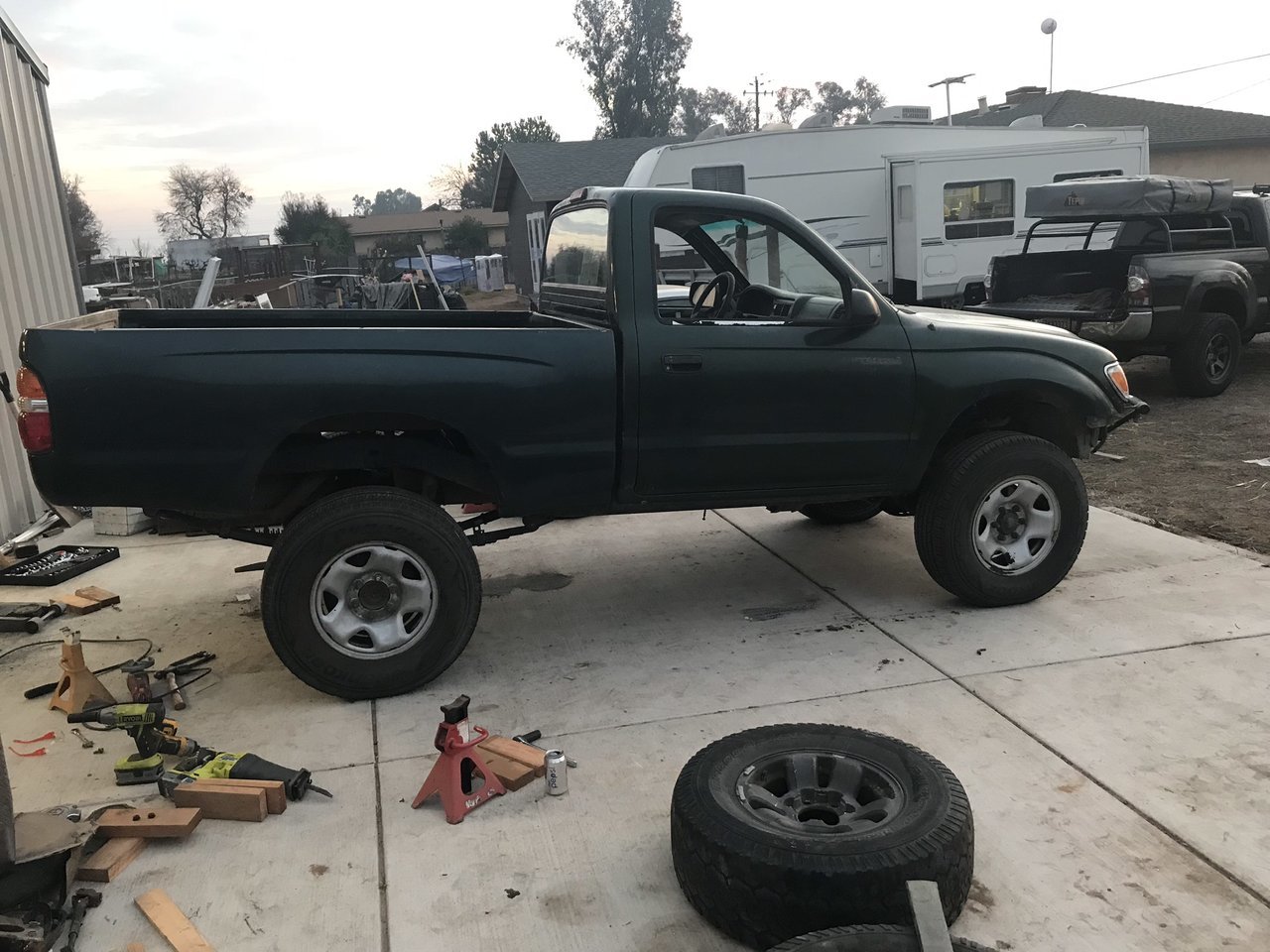

    Put FJ steelies and 255/75/17 on today

    Where did you get the Steelies?
