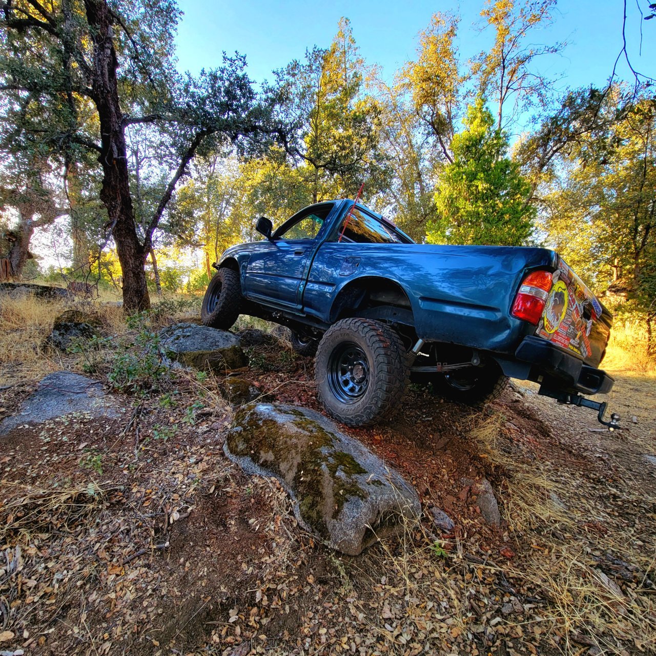

    Dragging er home

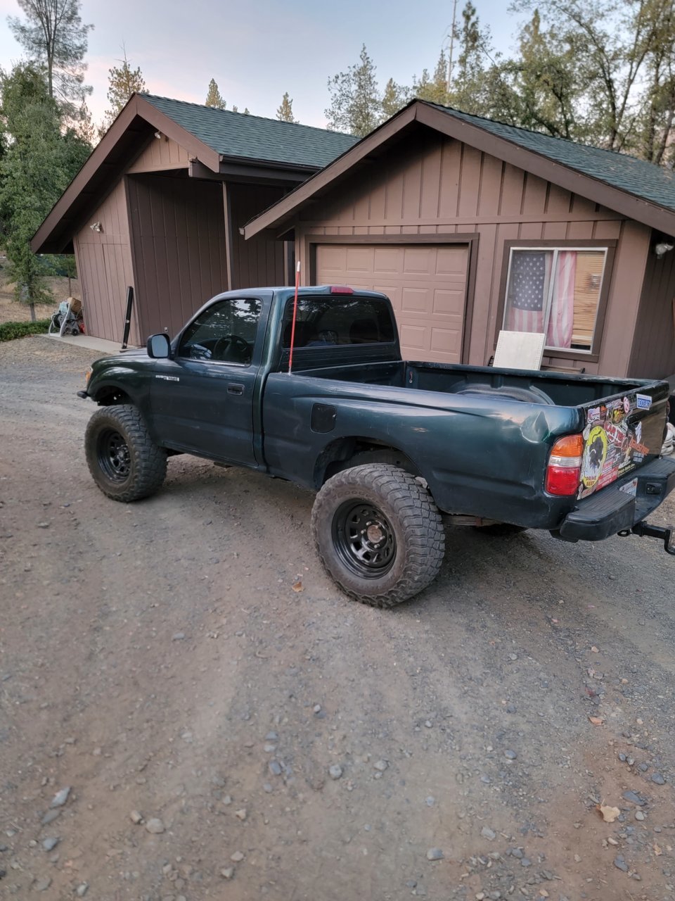

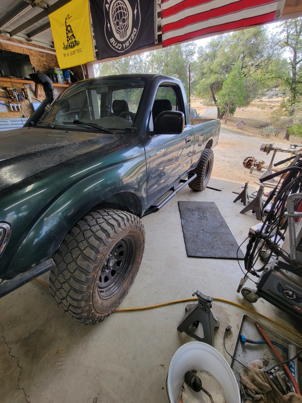

    Windows tinted and some temporary steelies till I swap the one tons in.
    Crawling around in my yard lol

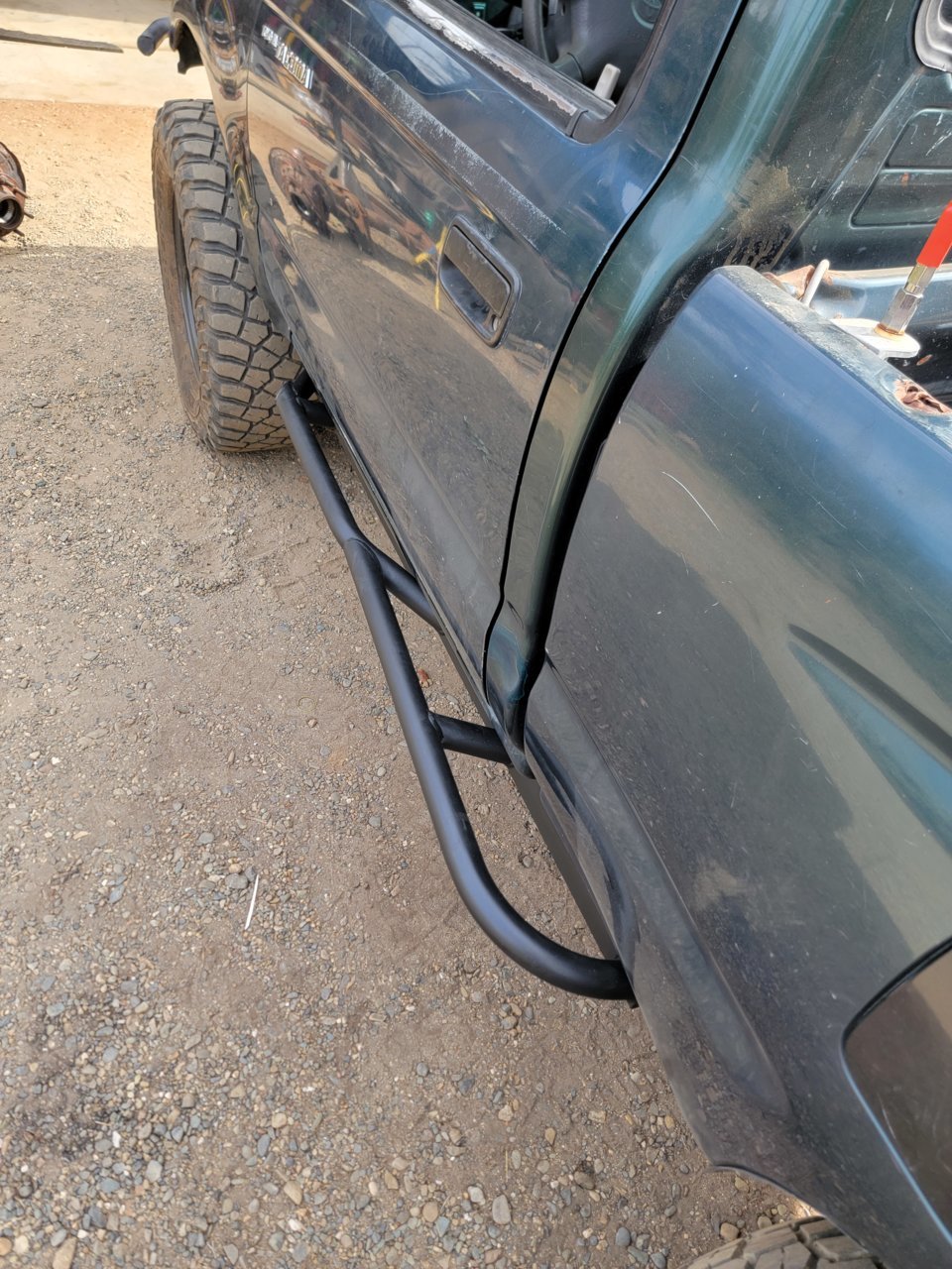

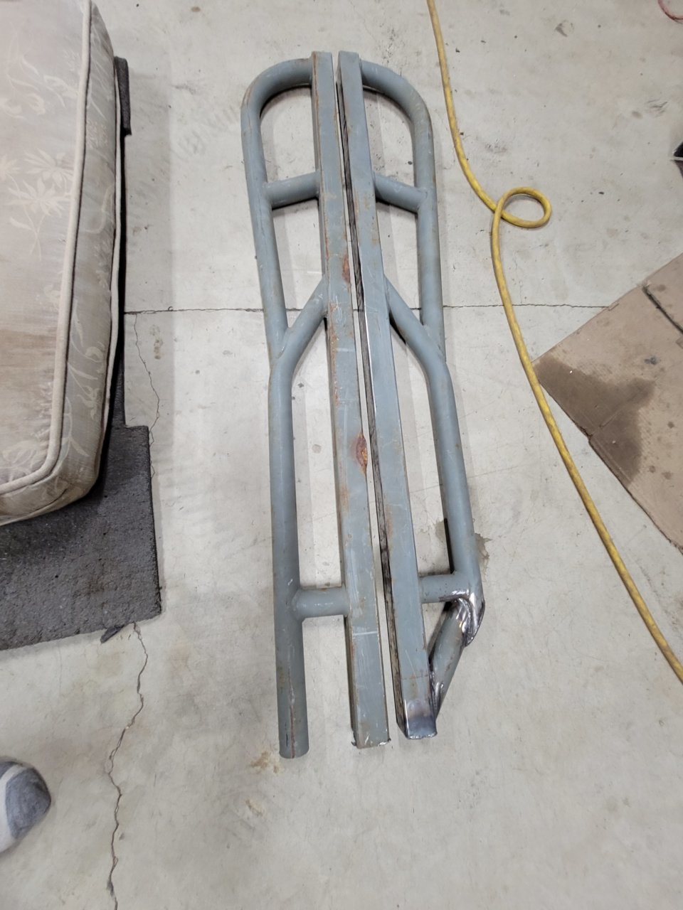

    Workin on the sliders
    Broke Okie Ty and foxrcing07 like this.
  5. Oct 28, 2022 at 1:52 PM
    #125
    Basikbiker
    Basikbiker [OP] Well-Known Member
    Sep 21, 2013
    #112968
    3,987
    Trav
    09 AccCab 4x4 spaceship
    My doors are the only stock things left besides the headlights
    One slider done

    Did you repurpose those?
  7. Oct 28, 2022 at 7:03 PM
    #127
    Basikbiker
    Sep 21, 2013
    #112968
    3,987
    Trav
    Yea they were some really long old BAMF sliders that were cut off a different truck
    shakerhood likes this.

    That's awesome, they came out good.

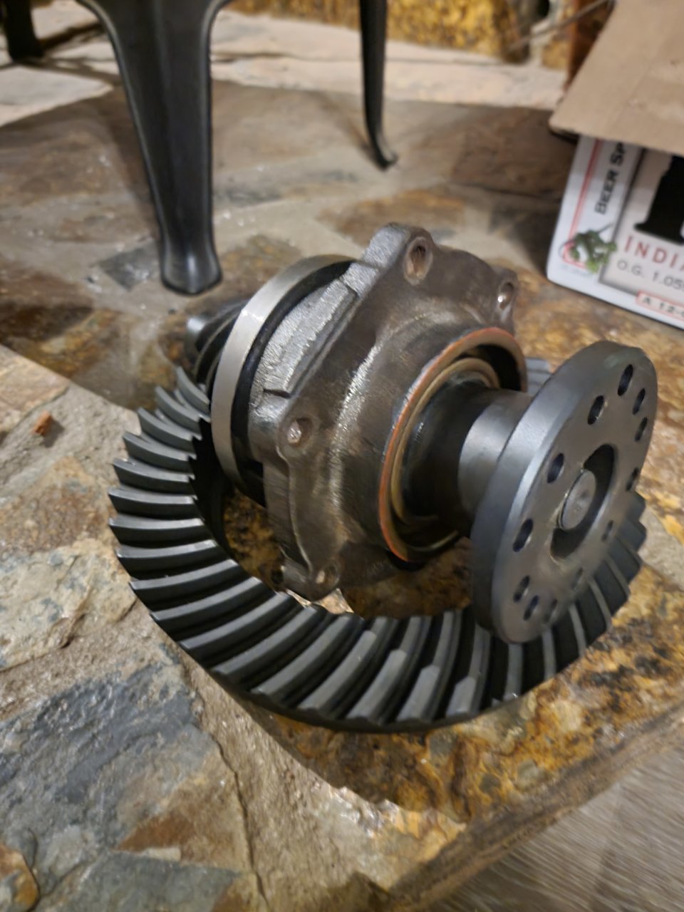

    Pin support, new bearings races, solid spacer, toyota adapter flange.
    So the 14bolt diff is half done

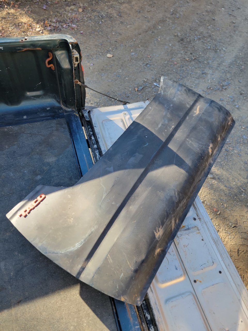

    Friend hooked me up with a set of half doors for summertime wheelin

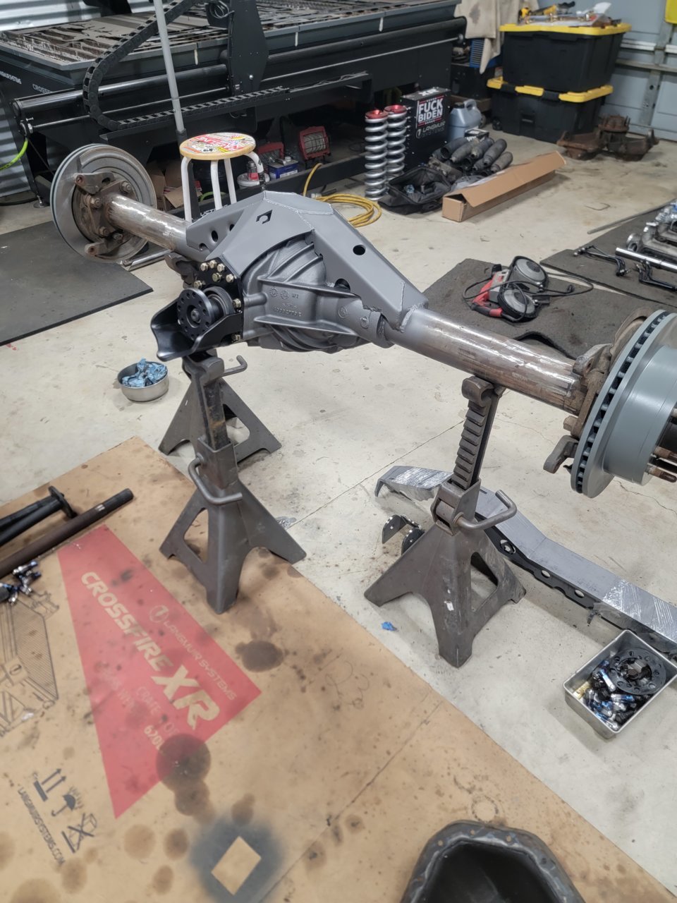

    Got the rear Axle trusted, pinion bridge and guard, 5.38 gears, Yukon grizzly locker all installed...now to work on the front axle
