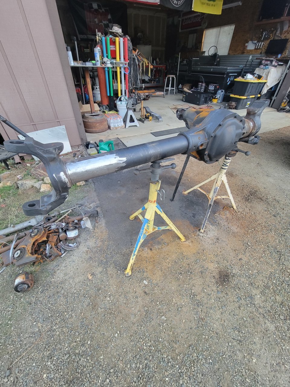

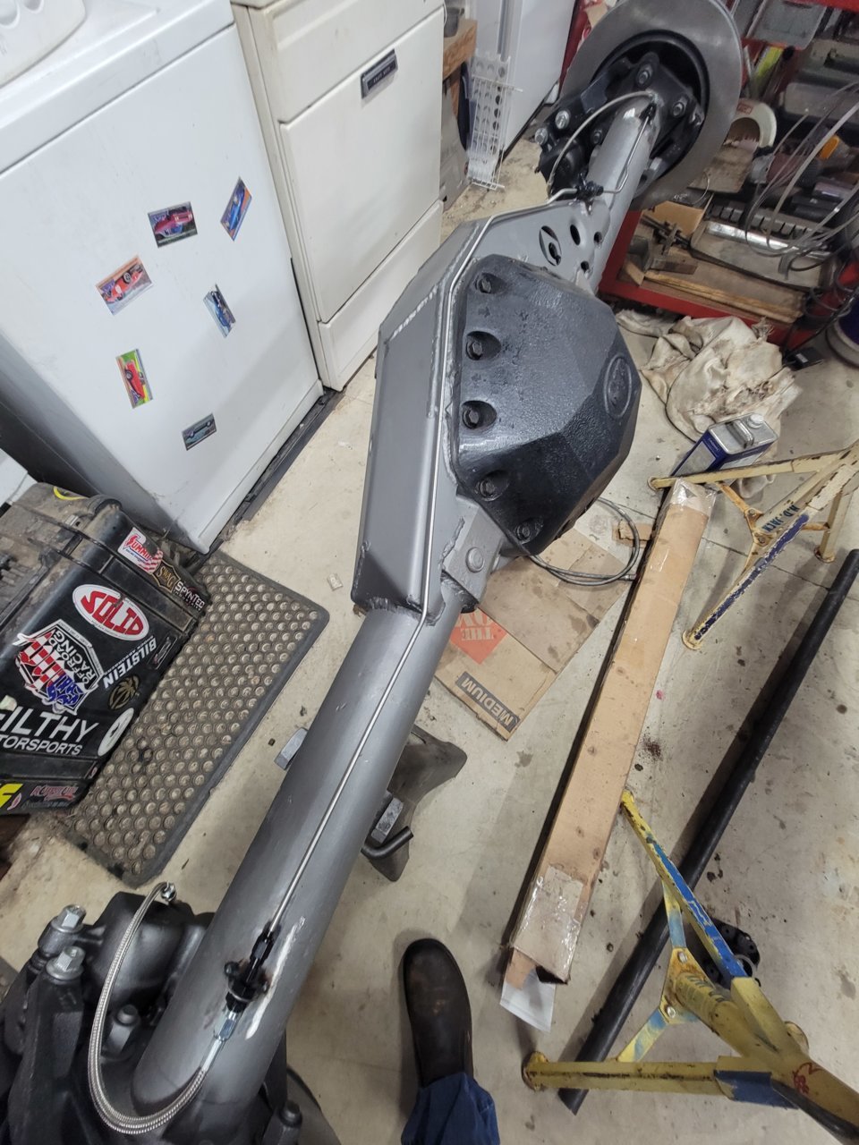

    Got a set of 40" BFG projects off a friends racecar...still compiling parts at the moment, have all the stuff for hydro assist and better pump, locker, shafts, hubs for the front axle ordered, wheels ordered, have all the hiems and tubing for linking the front as well.
    Hi steer arms welded on, and balljoint eliminator kit installed.

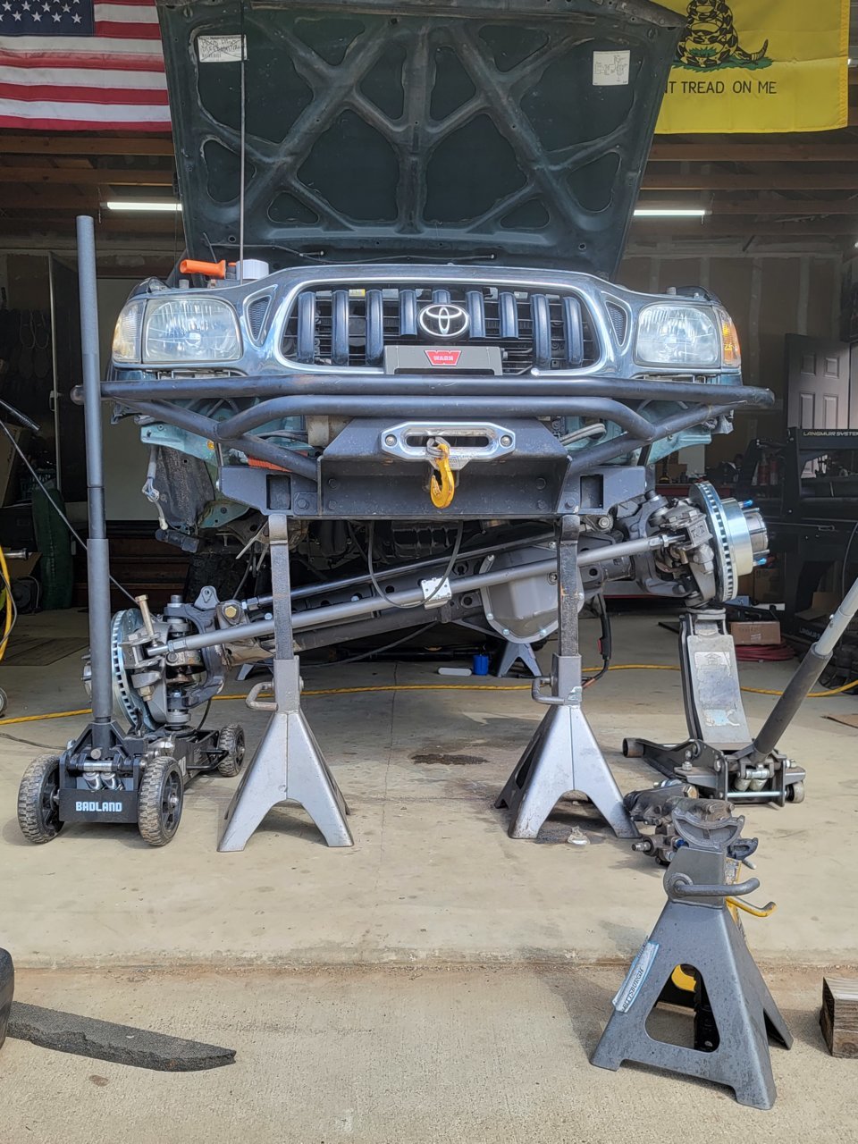

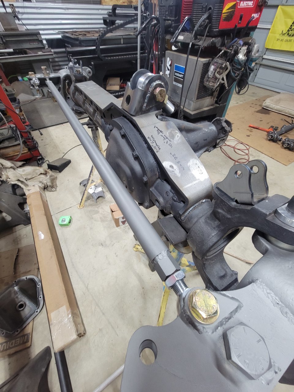

    Made some progress... ball joint eliminators installed(top and bottom), TMR hi steer arms, I added in the teardrop hole reinforcements, made the tierod, upper link bracket ready to go,
    Then to start pullin the gears and guts to put the new stuff in. And gunna start putting in the hardlines for the brakes next as well
    Hope by end of January to be chopping the ifs stuff off

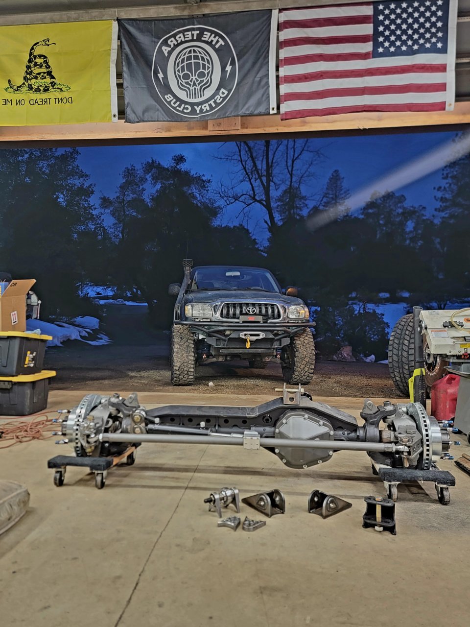

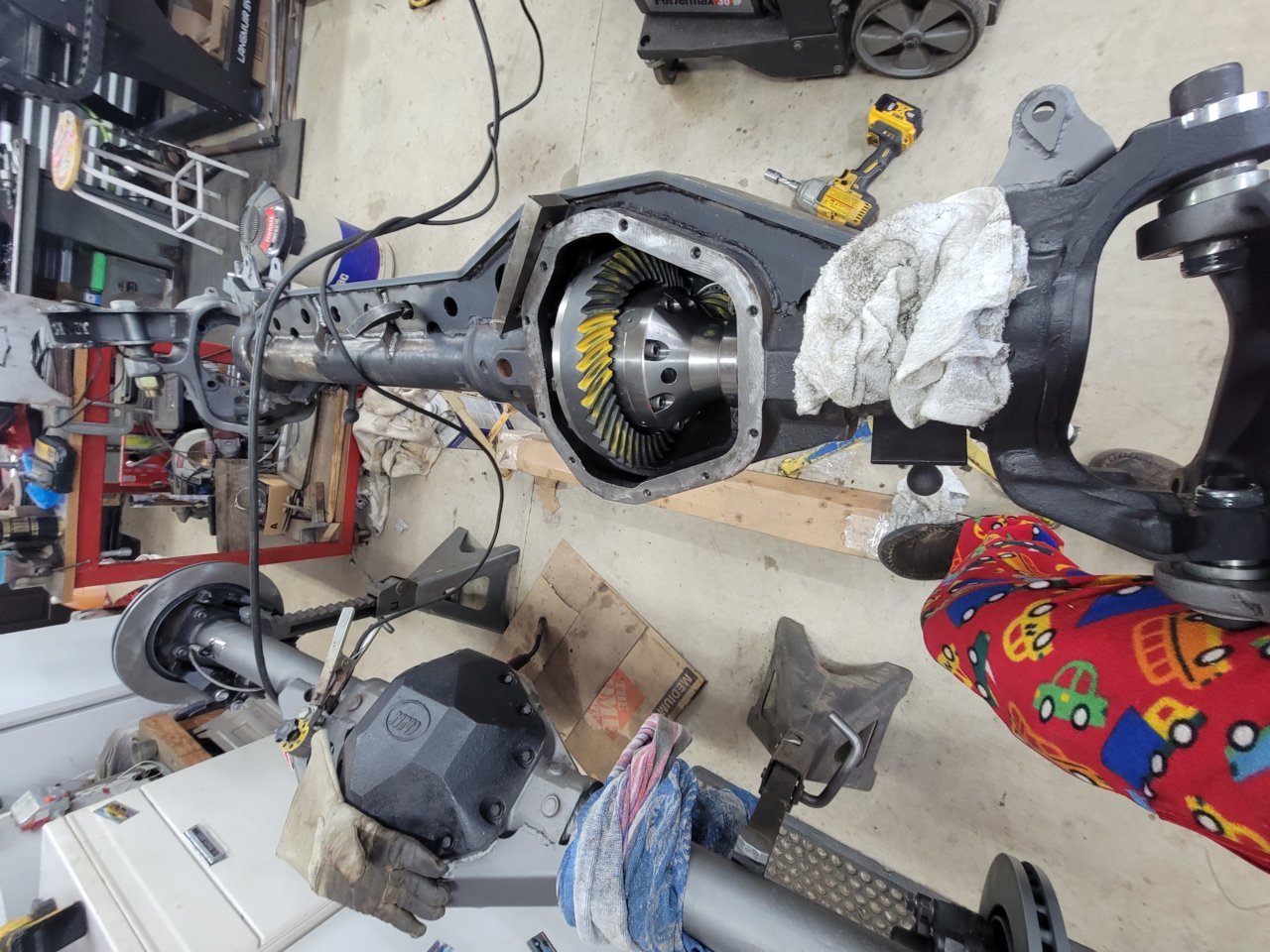

    Small update...finishing up putting the gears, and locker in the front axle
    And starting on the rear Brake lines

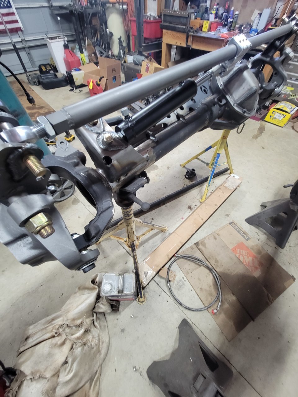

    Rear brake lines made.
    Panhard/ hydro assist bracket made and tacked on.
    Next will be mocking up the rear link tabs on the axle. and getting the shocks built for the front

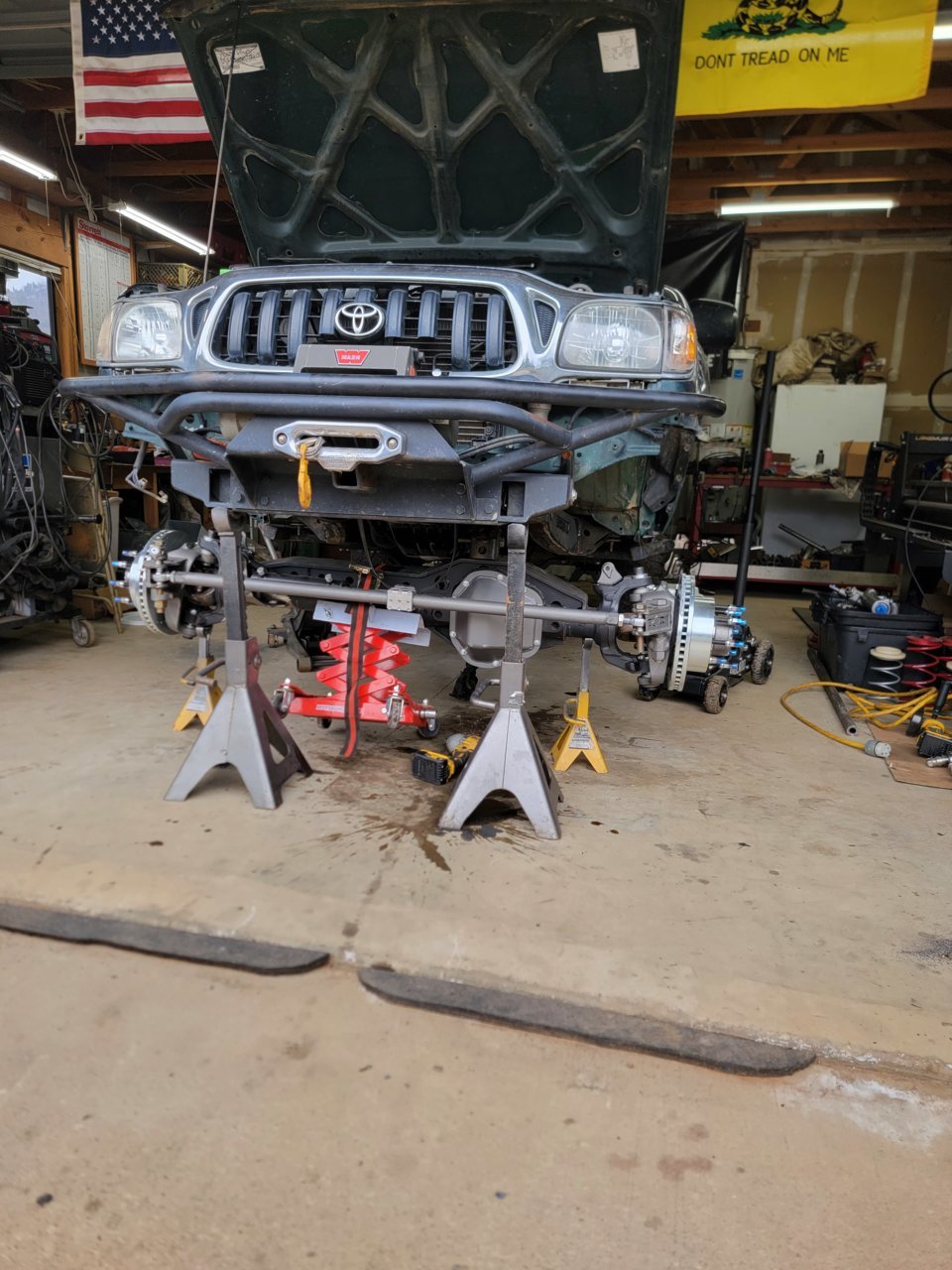

    My doors are the only stock things left besides the headlights

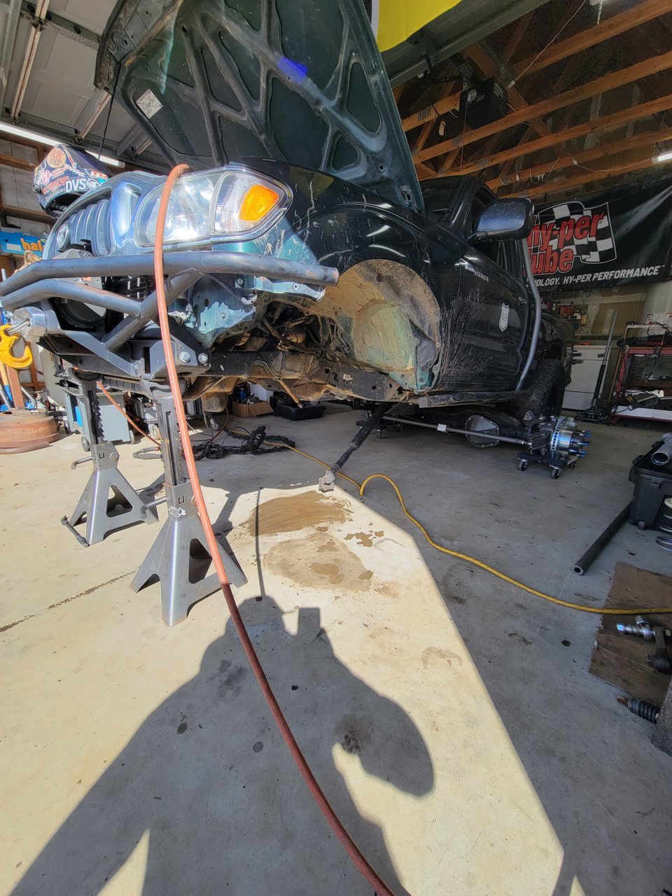

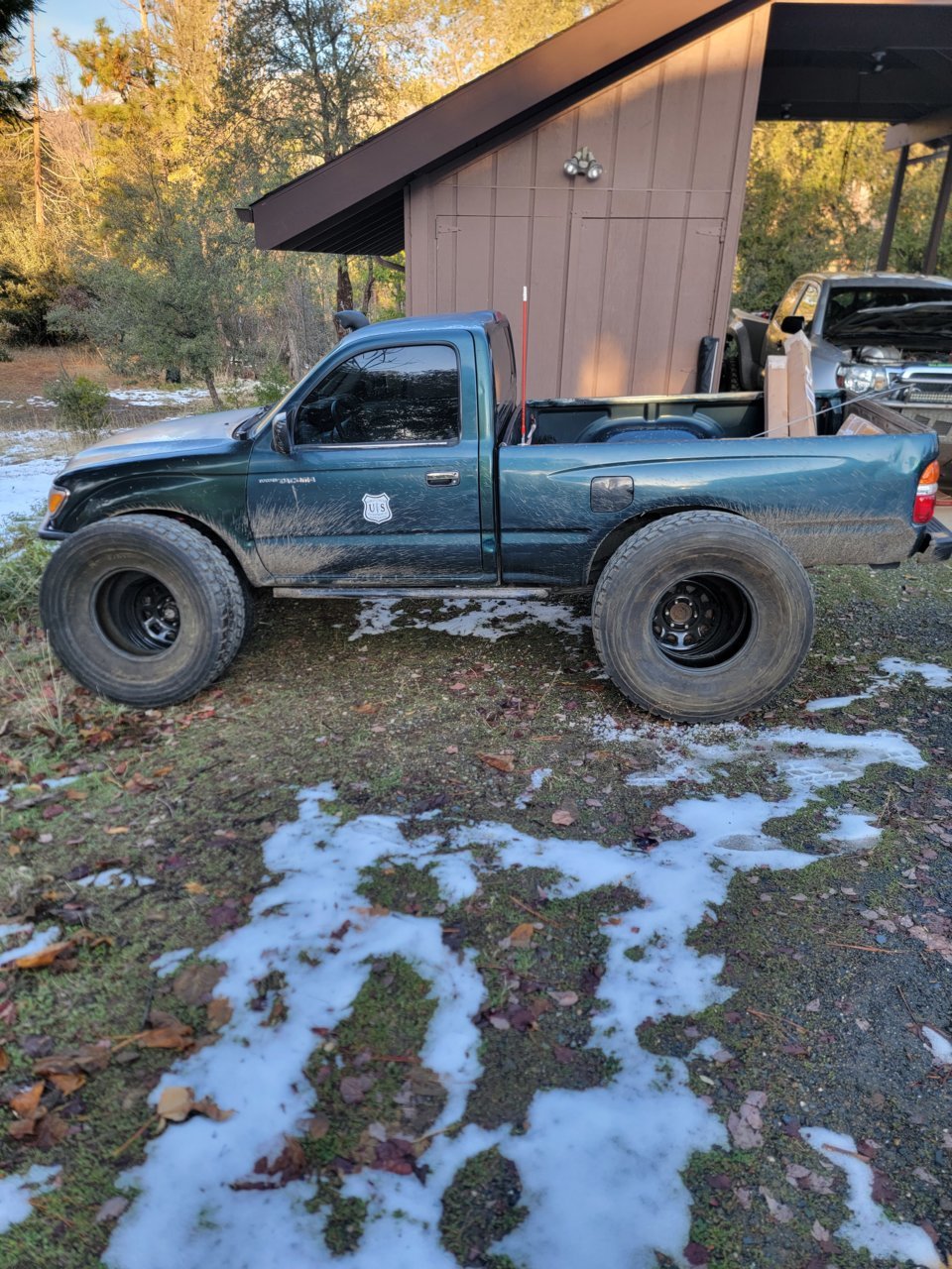

    Oops...
    Broke Okie Ty and foxrcing07 like this.

    Sweet, :sawzall:
    Also who painted that bumper that thing looks like shit!

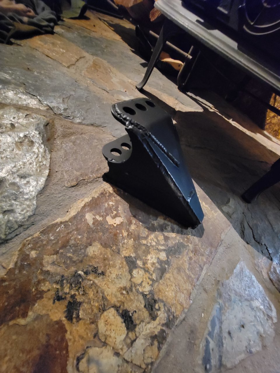

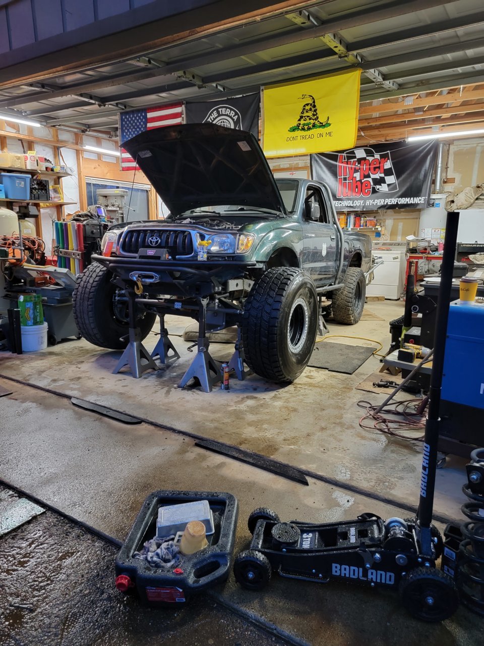

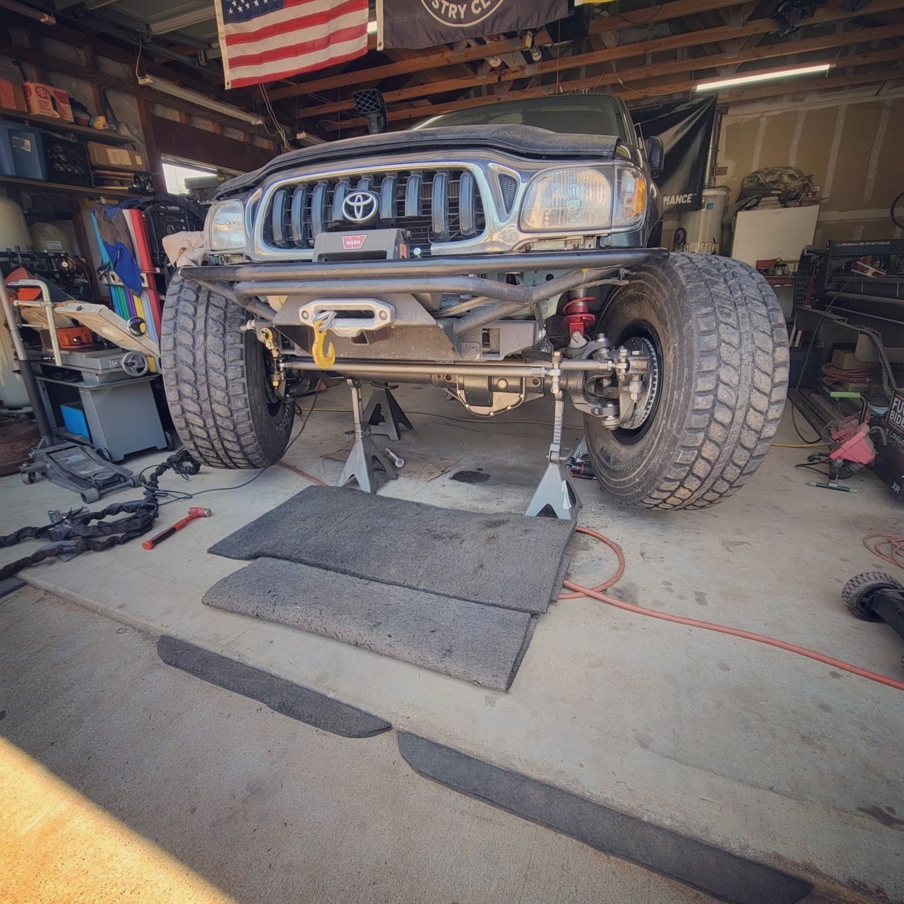

    Built the panhard bracket and got the upper link in...cycling suspension around, just hacked the motor mounts off the frame and raising the motor about 2" then gunna notch out the framerails to maximize up travel...really pushing for 5" of up

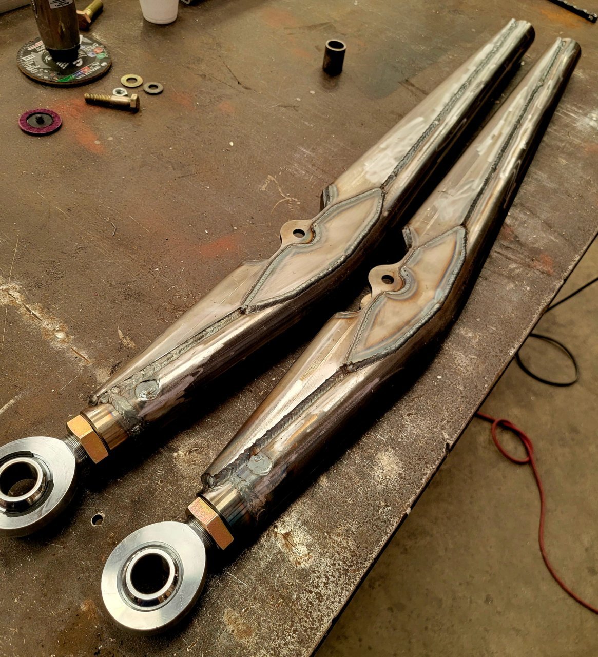

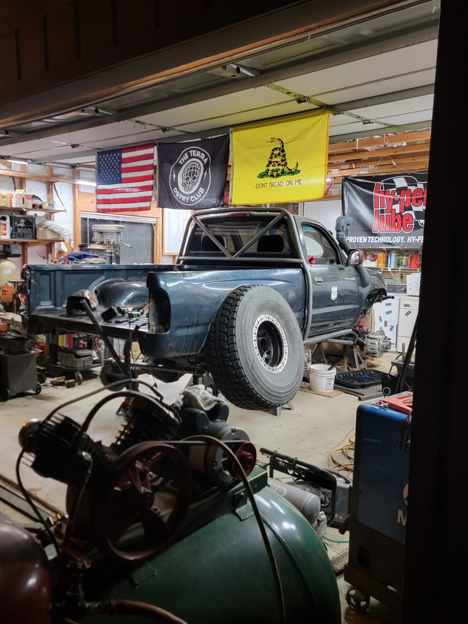

    Been away at work, but got these burned together for the rear, front is almost buttened up minus mounting the coilovers...but hey it's alll progress to gettin this on the trail this summer!!

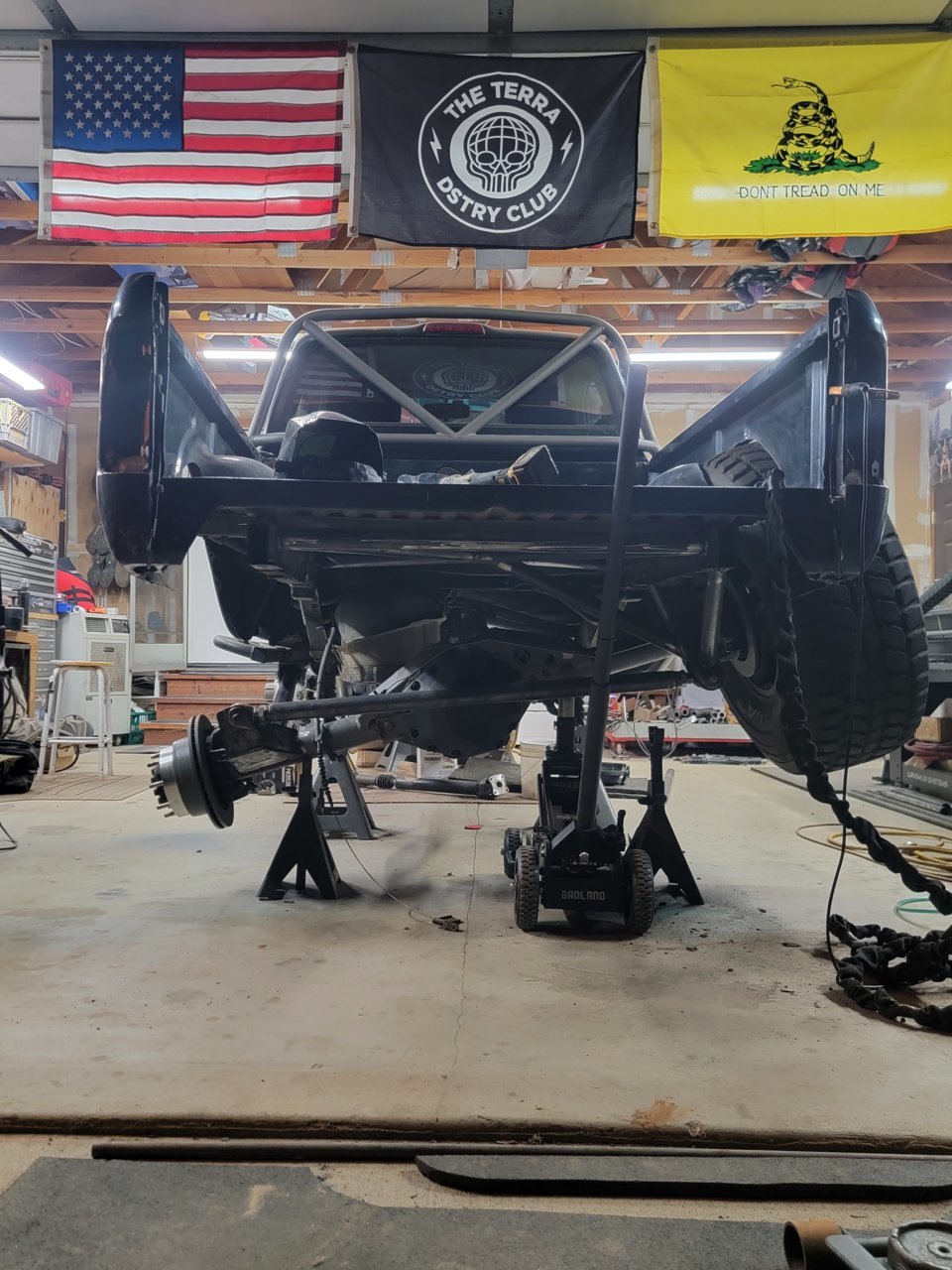

    Haven't had time to work on this lately. But back on the progress train! All the link mounts are burned in, steering box mounted and finished, steering finished, links welded up, front brake lines plumbed, workin on mounting the coikovers and tire clearances now...really hope I can keep my corner lights

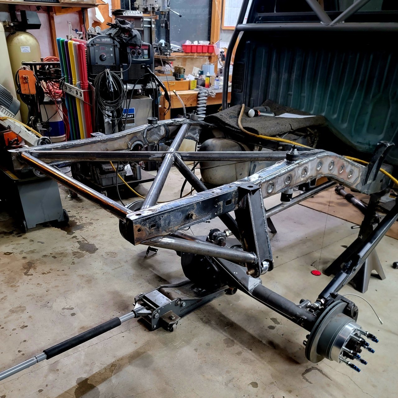

    Progress
    Broke Okie Ty and ToyRyd04 like this.
  19. Sep 18, 2023 at 8:40 PM
    #159
    Basikbiker
    Basikbiker [OP] Well-Known Member
    Sep 21, 2013
    #112968
    3,987
    Trav
    09 AccCab 4x4 spaceship
    Rear 3 link burned in most the way
    Broke Okie Ty, foxrcing07 and Bandido like this.

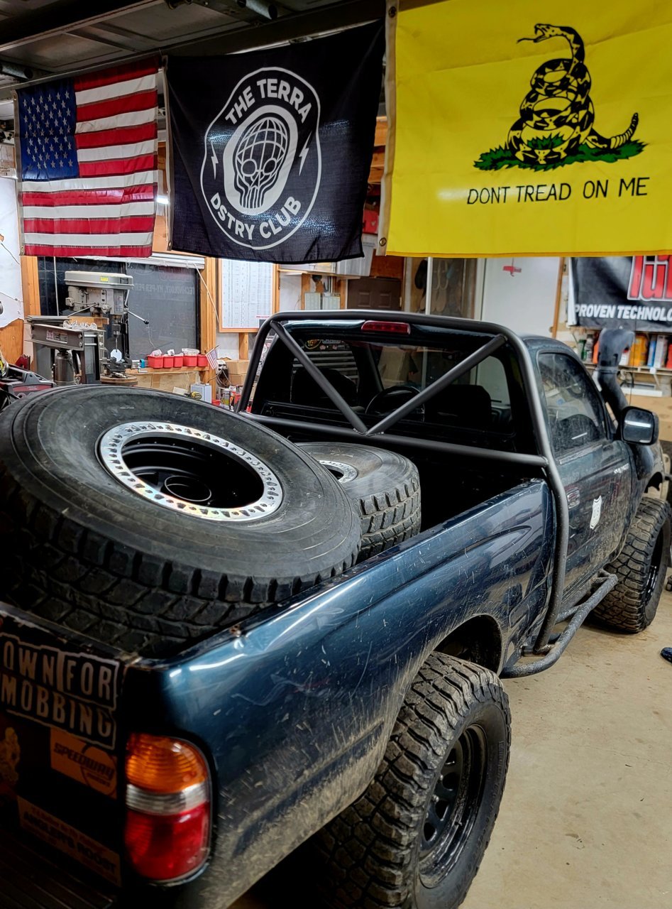

  20. Sep 18, 2023 at 10:33 PM
    #160
    betterbuckleup
    betterbuckleup Well-Known Member
    Jun 26, 2017
    #222483
    4,801
    Ian
    Concord, CA
    2000 Tacoma SC 2.7 4x4 5spd
    this thing is turning out sick. Love the look of some TA bfg's on it too.
