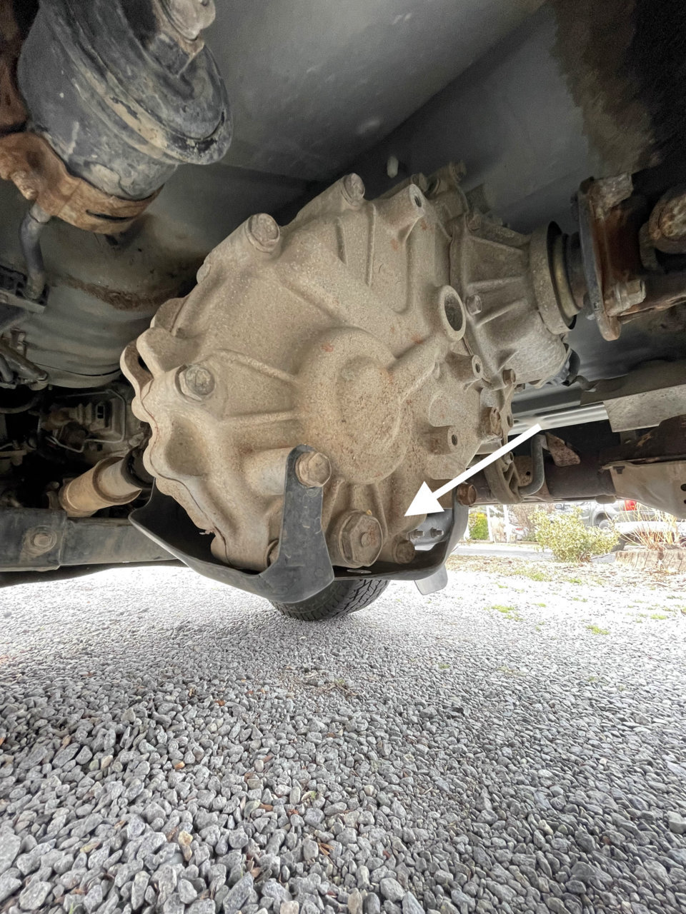

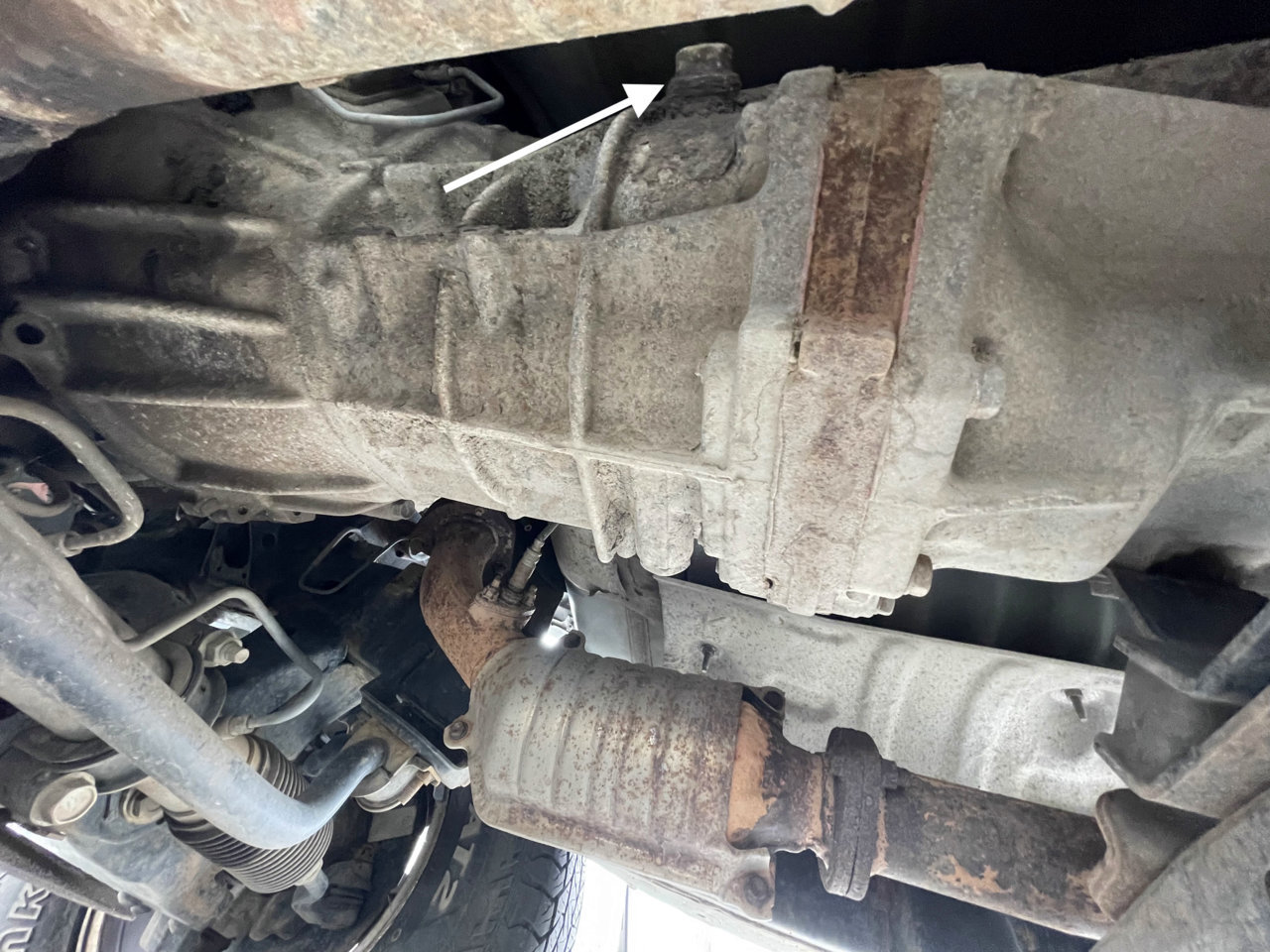

    Hey TW,
    I've followed a couple videos recently trying to understand what should be a very simply fluid change. I'm told that both the filler and drain plug bolts ar 24mm (15/16sae). I'm finding what looks to be the fill plug to be smaller than this. Also, based on the videos I've watched, these plugs should be relatively close to each other, but on mine they are not. I'll post pics below so you can get an idea. Just looking for some guidance here and to make sure I don't screw this up.
    Also, Oreillys pulled up I should be running 75w-90 synthetic gear oil. I've seen some say Toyota recommends conventional, but they didn't have that available. is synthetic fine or is that a hard no?

    First pic is your transfer case, that isn’t your transmission.
    Not sure about that transmission though, maybe one of the v6 guys can chime in. @eon_blue

    Like @0xDEADBEEF said, first pic is your transfer case, second pic is transmission
    Both have their own fill/drain plugs

    Both take 75w90 gear oil, GL4 or GL5 (differentials only take GL5)
    Synthetic is fine
