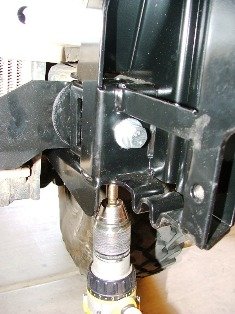

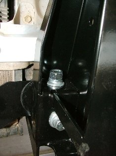

    Reviving this older thread because I'm getting conflicting information on the drilled hole. Seems like 50% of people are drilling that offset hole further back by the hook/tie down and the other 50% are drilling through the blocks that bolt on to the frame. ARB also seems to have 2-3 different sets of instructions that are mostly the same until you get to drilling that hole. I might revisit this when I upgrade my alternator and wiring for a winch. But I'd like to just get all the mounting solved after running this bumper for 4 years incorrectly.
    Below are the instructions that were included with my bumper. It mentions 10.5mm and 13mm drill bits. They also says to drill into the frame at the further back offset hole on the bracket.
    Here are some instructions you can find online. They list a 1/2" drill bit and appear to be drilling out the front hole that's more centered.
    Below is a video where a guy drills straight through the frame at that offset hole.
    https://youtu.be/GD2cjIZ7C6Y?t=915

    ARB had revised their instructions a few times.
  14. Feb 6, 2021 at 1:53 PM
    #34
    04Pre_Runner
    Feb 9, 2017
    #210143
    4,916
    Andrew
    2004 DC Tacoma SR5 4WD V6
    It's just wild. You could technically drill both if you wanted to. But I'd prefer drilling that frame extension block than the actual frame. But drilling the actual frame further back makes more sense.

    Older threads allover the internet kept recommending the expedition west installation write up. Since that page appears to be down I tossed the dead links into the Wayback machine. They drill into the frame extension blocks.

    Yeah, the blocks provided are supposed to be drilled into per the instructions I had (latest revision). That's if you intended to run a winch.

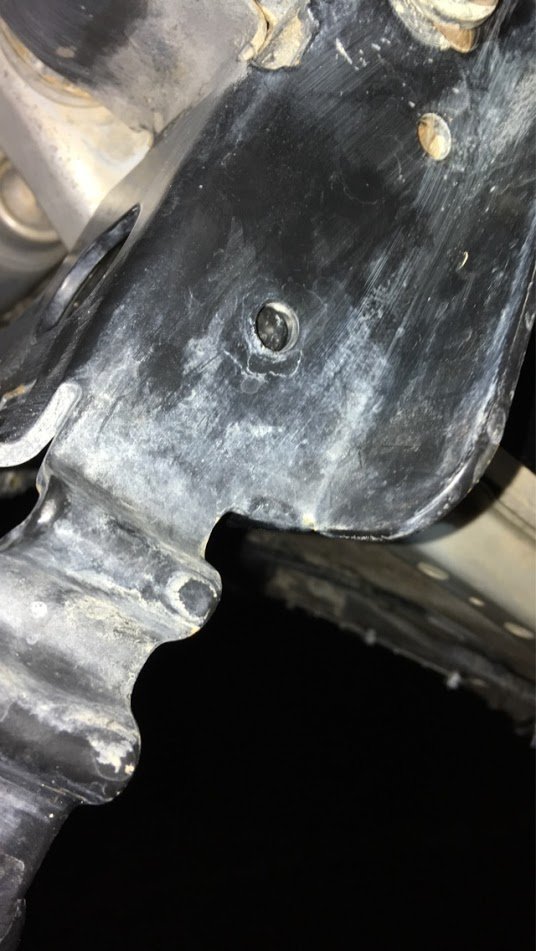

    Well I guess I’m here to revive this one again. I don’t have to use the frame extensions as I have a 99’ but man that smaller hole in the back, I have no idea how they expect you to be able to put a bolt on the top and drill it all the way out. Anyone have any suggestions for this? I really wanna get this bolt in honestly but just don’t know what to do? Maybe I just use the one closer? Anyone done this?
    I just have no idea how anyone would be able to get a nut on the top or tighten it and also why didn’t they just make that upper hole the same size as the bottom one? A very unnecessary drill out.
