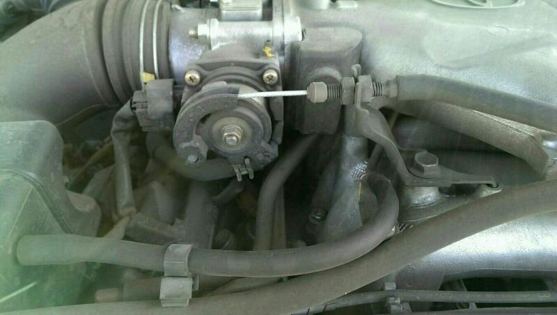

    ok so help a dense guy out here, I don't know if there is a straight yes or no answer to it but I got a 2004 prerunner 3.4L v6 auto 2wd so do I or don't I need an actuator installed under the hood?
    I don't see any unused plugs anywhere under the hood near the side fenders where an actuator might go.
    I have owned this truck for like 36 hours so I have no idea whats under the hood or how this truck works so if you tell me what I am supposed to see if I don't need an actuator then I can see if I have that.
    from what I can see, mine looks nothing like the pictures in the first post. I have a single throttle cable coming from the firewall going to the throttle body wheel and this throttle body wheel is plastic and has a plug connector on the side of it with 4 wires running to it from the engine wiring harness so hopefully that means something so you guys can tell me if im good without an actuator or if I will need to get one and ruin wires for it.

    You should have the electronic throttle body, install the cruise control switch and test, if the cruise control light comes on, your ready for a road test. The electronic throttle body began in 2003.

    I don't know whats involved in the "electronic" throttle body but mine has a single mechanical accelerator cable coming from the gas pedal and it looks very much like the regular throttle body except it has the plastic wheel on it and a 4 wire plug that im guessing is some sort of sensor that connects into it on the wheel side of the throttle body. there doesn't seam to be a lot there that looks like any sort of electronic throttle.
    im not sure if its the electronic one or not but this is what my throttle body looks like:
    http://image.truckinweb.com/f/tech/body/14900501+w799+h499+cr1+ar0/0904tr_09_z+2004_toyota_tacoma_prerunner+intake_tube.jpg

    Here is my throttle body:
