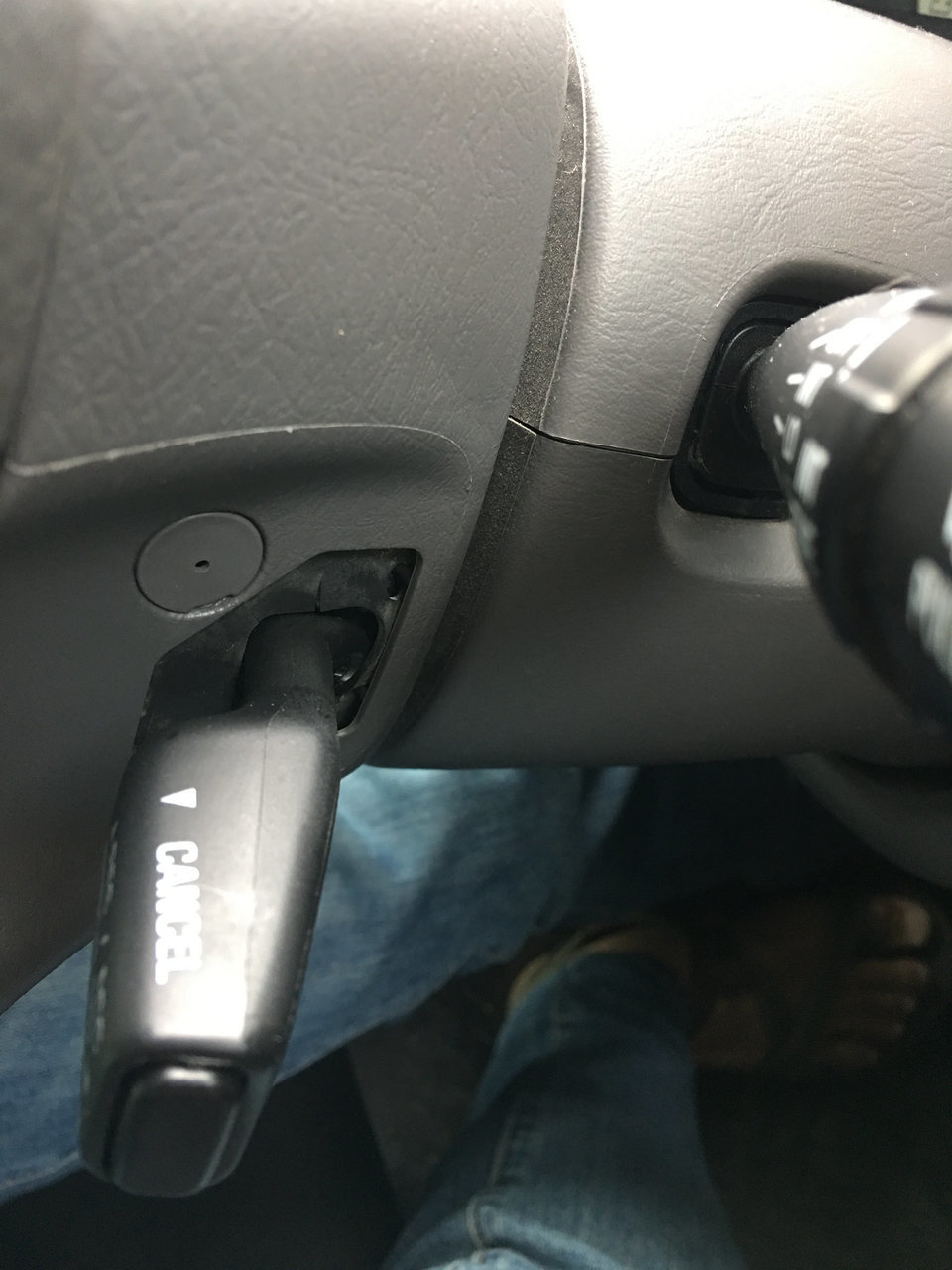

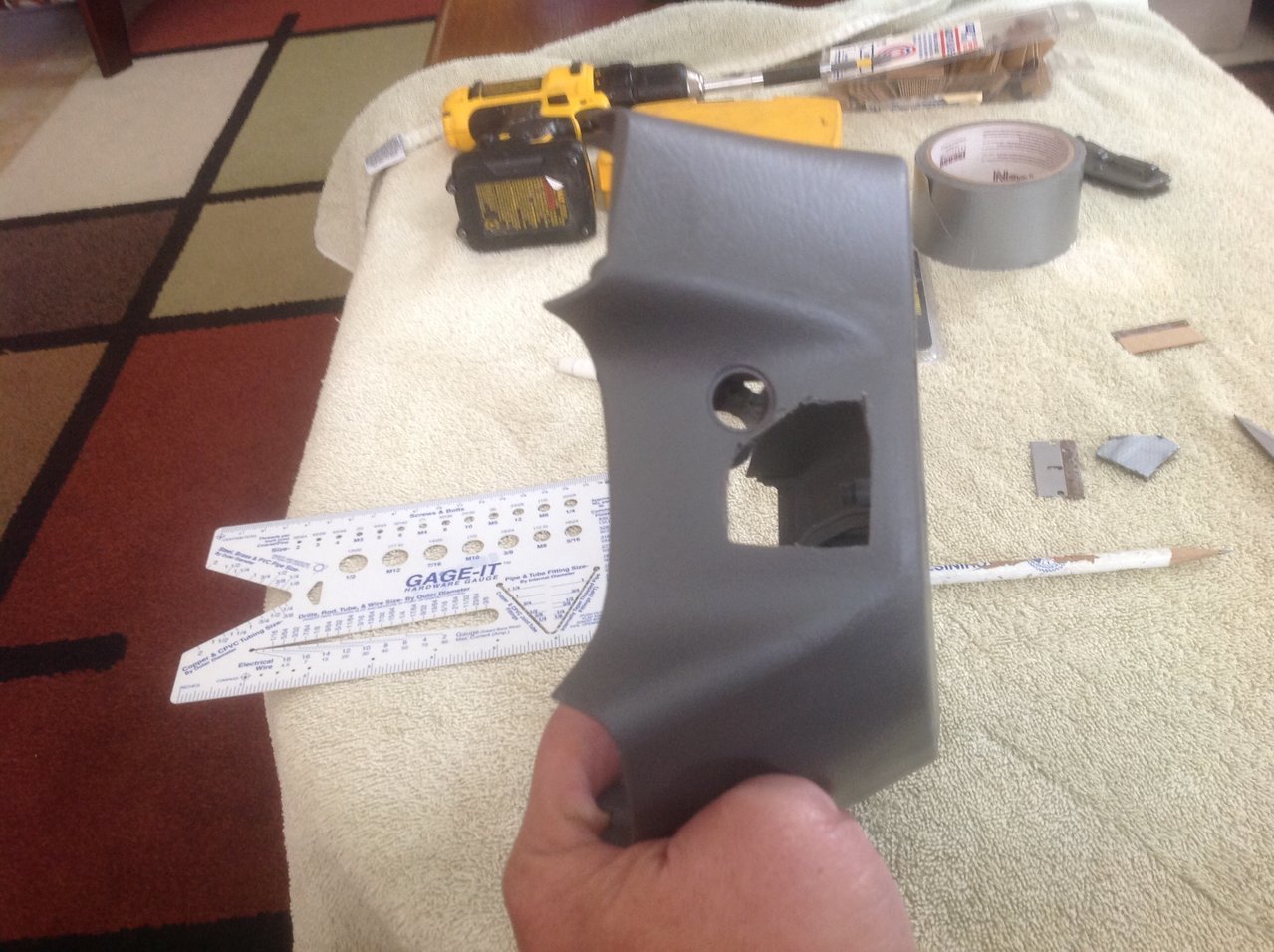

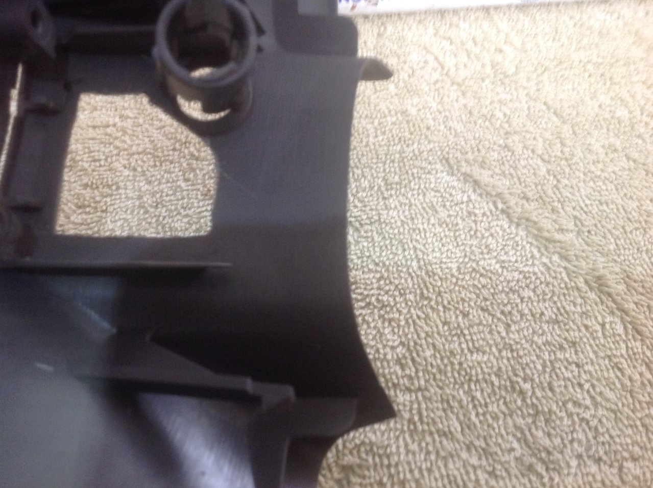

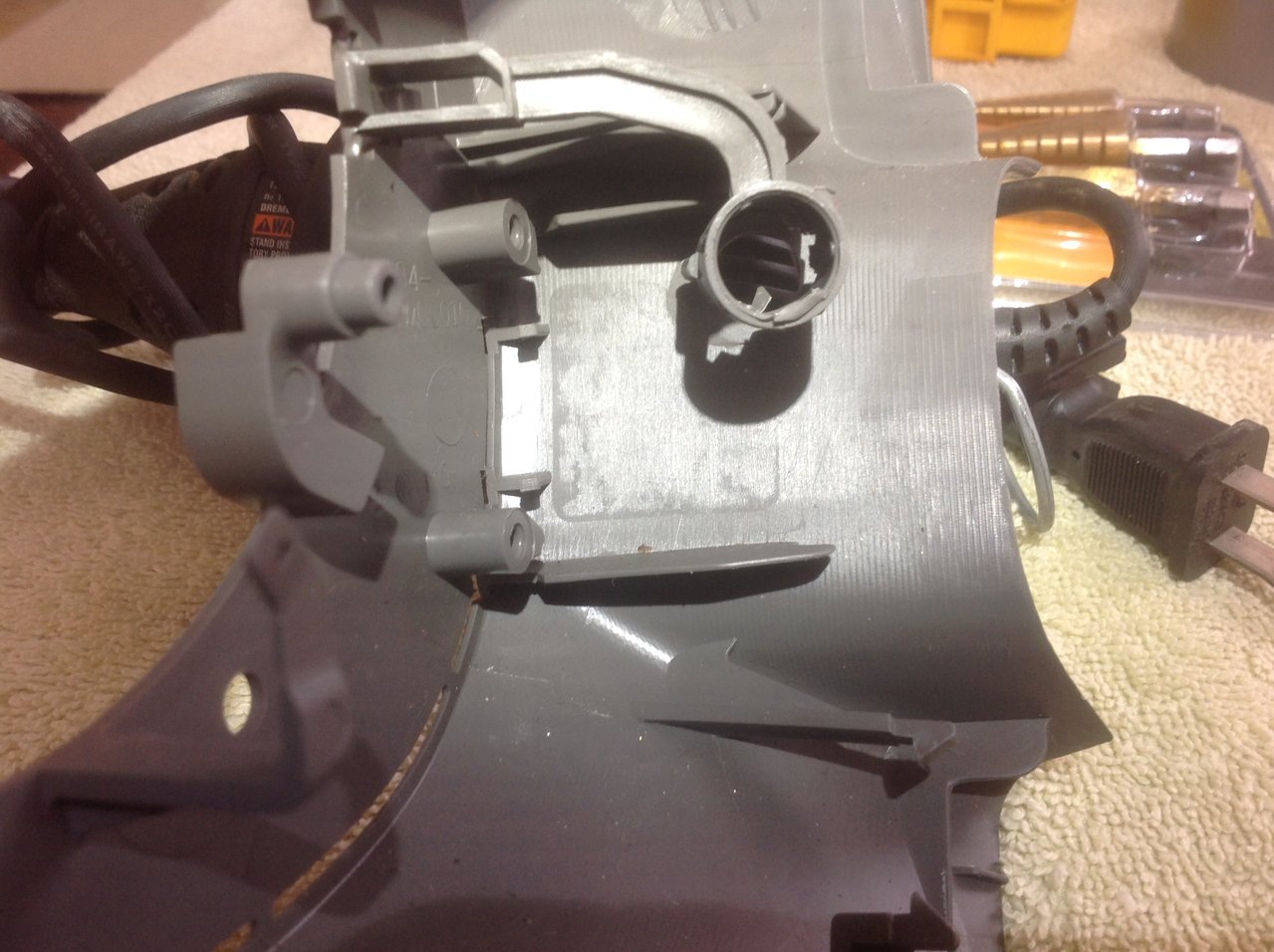

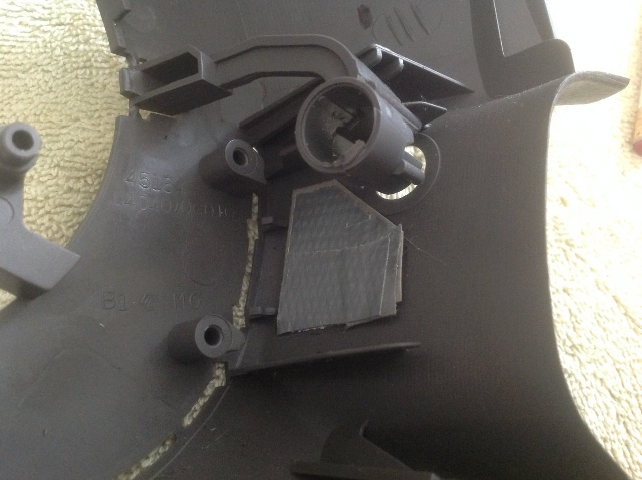

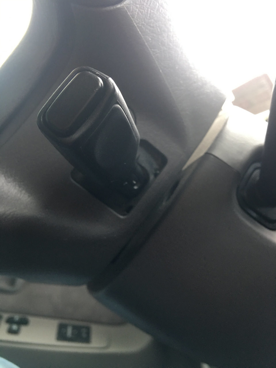

    For those not purchasing the steering wheel with the speed control cutout. Use your current, non cutout steering wheel. The trim has a faint outline of the necessary cutout Inside right side trim. I made a template using tape, reversed flip it to the outside of the trim, traced, razor and demel the cutout. I glued a thin piece of rubber to the inside of the cutout to keep out the dust and surround the speed control switch. Lastly, smoothly blended the cutout lines to give it that OEM look. Very easy to do and saves $$$$$

    @8sm Whoa, how did you smooth blend the edges of the cutout so perfectly? The dremel?
  6. Nov 1, 2019 at 12:34 AM
    #46
    8sm
    8sm Well-Known Member
    May 4, 2010
    #36537
    206
    Southwest
    2002 Impluse Red
    Drexel, fine light sanding and heated razor blade and exacto knife. The plastic is bendable, blend able and mendable but very easily distorted, it took a lite touch and patience. The Drexel can easily distort melt the cut if on to high a speed. I practiced on similar material before I attempted the cut out. Go slow and practice on a piece of plastic. Hope this helps
