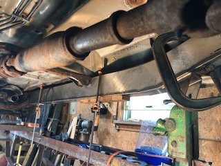

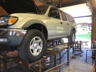

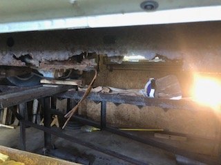

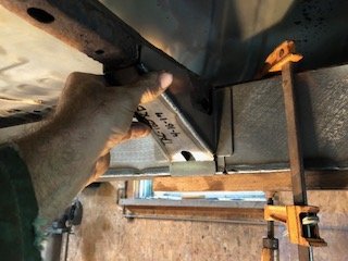

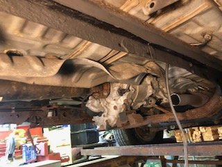

    truck frame 1 IMG_2183.jpg truck frame 2 IMG_2180.jpg truck frame 3 IMG_2184.jpg truck frame 4 IMG_2185.jpg truck frame 5 IMG_2181.jpg Attached are a few photos of Tacoma DC frame repair if anyone is interested. Used a "Poor mans" lift and a stool on wheels which helped out. Also used the frame paint from NAPA which is a good product. Only left about 2 inches of original frame. IT was a ton of work but got the truck cheap and project kept me off the streets LOL!
