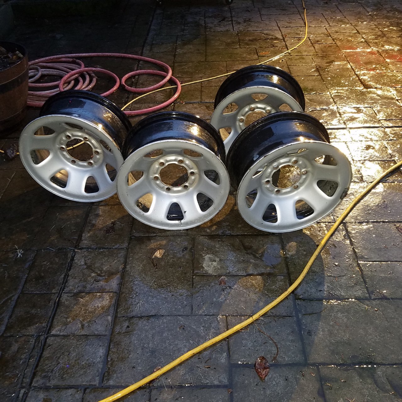

    Definitely because this truck originally came with steel chrome wheels that look awful but what I really like are these 1993 4Runner wheels that I got from my uncle's 4Runner. The only problem is that they are 15 in so I need a taller Tire to meet the original specifications to not throw off the speedometer
