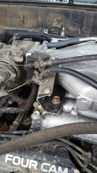

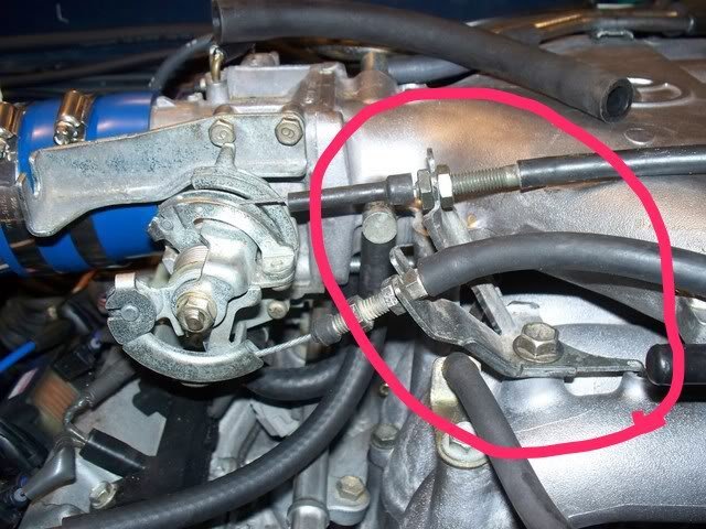

    I was wondering if anyone has an extra stock throttle cable bracket for an automatic 3.4l laying around?
    The stock intake kit I got was missing that part so we had to fabricate a make shift one using the bracket from the supercharger. My solution is temporary and someone from the forum wants to buy the supercharger I took off and it would be nice to give him that bracket I had to use. Any help would be much appreciated! I can't seem to find a place to just buy that bracket.
    Attached is the stock bracket I am looking for, which is circled. (photo credit goes to@SCRunner12)
    The second attachment is the bracket we made.
