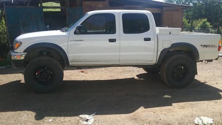

    Could always go with a 1in body lift along with the 3in suspension lift, I have one and it clears my 33s with 3.5 in backspaced wheels just fine.

    Update. I put in new slotted rotors and Hawk pads on front brake and found out that i have 1.5" wheel spacers, uggh! I'm already lost in the sauce when it comes to backspacing/offset/suspension and now spacers. I know we all went over this already but does that mean the previous owner put in 6" lift with 1.5" wheel spacers just to fit 33 x 12.50r15 with no rubbing? If i remove the wheel spacers, would it rub anywhere? Does the rubbing of tires in fender/uca etc. only apply to front tires when turning and people put lift on rear just to level it, am i correct? I'm looking to buy this http://toyteclifts.3dcartstores.com/TTHA-9504--ToyTecEibach-3-lift-kit--955-04-Tacoma_p_1716.html# and if i have to trim the fender then so be it. Someone please educate me.

    Beautiful truck. I was thinking more of a route where it doesn't need body lift just suspension lift and trimming if i have to.
