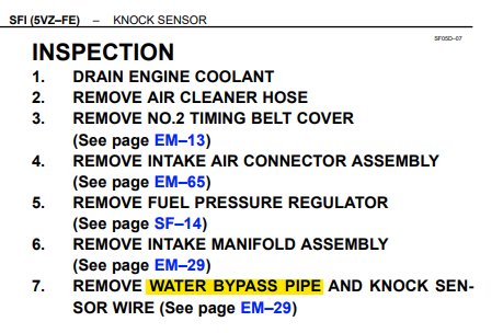

    Did you find a copy of the FSM? It details exactly what you need to remove (and replace) to inspect the knock sensor. Although it does mention that you need to drain the coolant, I think you can get away without that.
    At a minimum, you'll need to remove the throttle body and upper and lower intake manifolds (if you have a v6- you never mentioned what engine you have). So throttle body, and two intake gaskets.
    You really should take your time and use the part diagrams and FSM to understand this job before hoping that someone will just spoon-feed you.

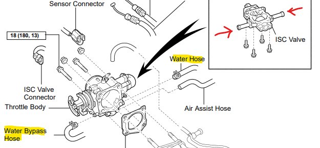

    Through the IAC (when you remove the TB).

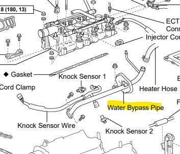

    Very sure. Outside of my personal experience having removed the intake manifolds on a handful of Tacomas, here are the relevant FSM diagrams and call-outs.
    Edit - I'll add, that I don't think that removing them or draining fluid is necessary.

    Knock sensors/harness exposed after all 3 sections of the intake are removed. Note the open coolant passages @CodeSeven mentioned (rectangles) .
    In most cases it's the harness/connectors that have deteriorated from heat. While in there it would be silly to not reseal the "water bypass tube", the two bolt connection to the block. It just uses coolant rated RTV sealant, no gasket or o-ring. Also the perfect time to check valve clearance.
