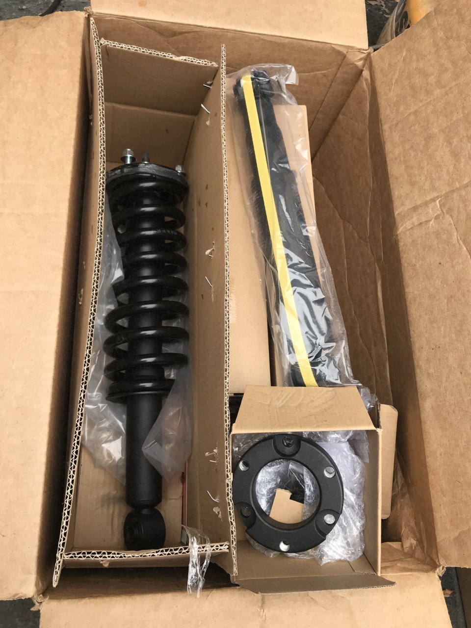

    These will have to do temporarily while I find a deal on Kings, Fox or Icons
    New replacement strut assembly9FAE3F01-3FD3-4FC0-A120-72B8C59B01F8.jpg with a leveling kit and new socks

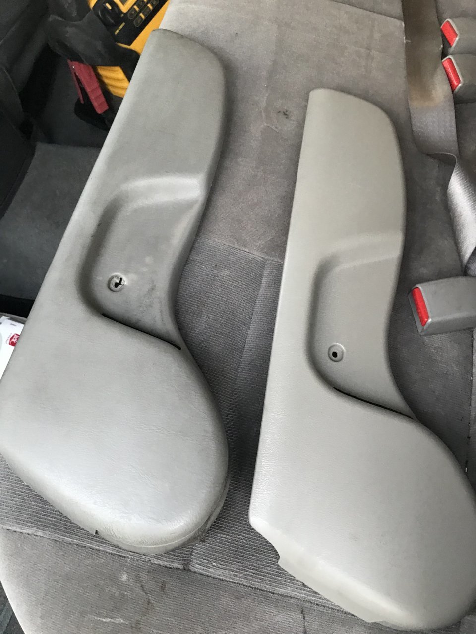

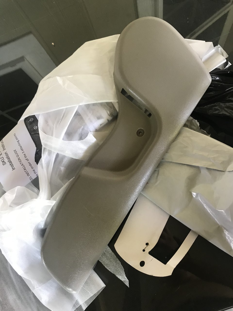

    Seat plastic came in also not bad for $30 new 8FCB66DC-2B39-4401-9314-25A2018BE50E.jpg

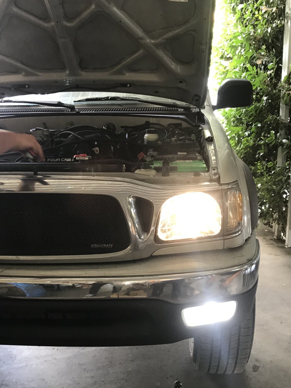

    New Headlights & Valance
    And Fog Light mod

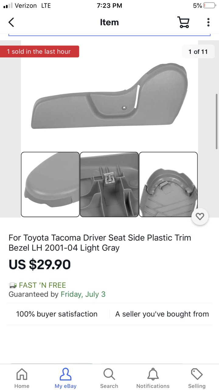

    where'd you get that for $30 new?

    Ebay

    Nice. I wonder if their "light gray" matches the OEM charcoal gray.

    Wow! That’s a sweet deal. Mine was a bit more than $100 iirc.

    Yeah, this is an replica one but it looks good quality like the oem

    For $30 it Matches up pretty good lolACD08AAD-D6CC-4A8A-9E4E-A1B85EC66B40.jpg

    Yeah, file that one under "good enough"
    I might just paint both of them black and call it a day.

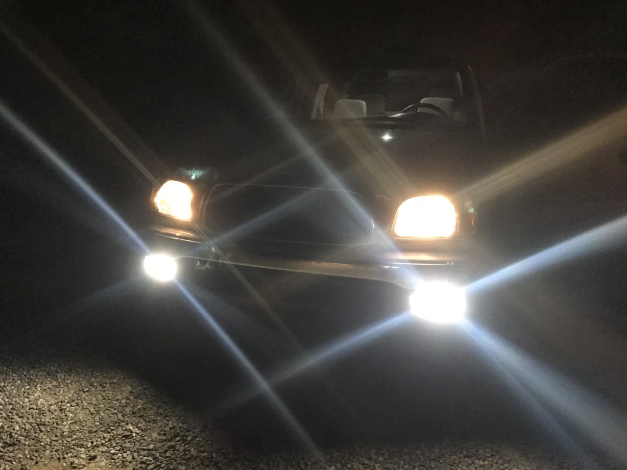

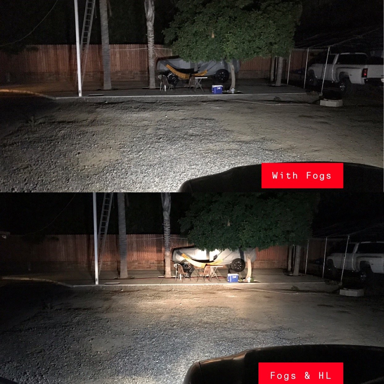

    Highly recommend the Fog light mod to anyone who wants a little extra lighting 7F9D9285-DF71-46EC-94A8-C93B9A4264C4.jpg50E26151-6C74-4C91-8001-B8E7615C0CDD.jpg

    Stock again- rip slug
    Whatd u do for ur fogs? Swap the corner light and turn light wires and use a led bulb? Ive thought of doing it bc i dont dont the need for a switchback. Look good, gj here with it all so far
    TE_Taco[OP] likes this.
  16. Jun 30, 2020 at 9:53 AM
    #36
    TE_Taco
    TE_Taco [OP] An Unknown Member
    Jan 1, 2019
    #277721
    286
    Keven
    Wildomar, CA
    Yes sir, Cut the Positive wire on the turn signal and corner light, Then with some speaker wire I ran the power from the corner light to the Turn signal and from the turn signal to the corner light
    Then tossed in some LEDs

    Thank you! Will be doing myself then, bc it came out great!

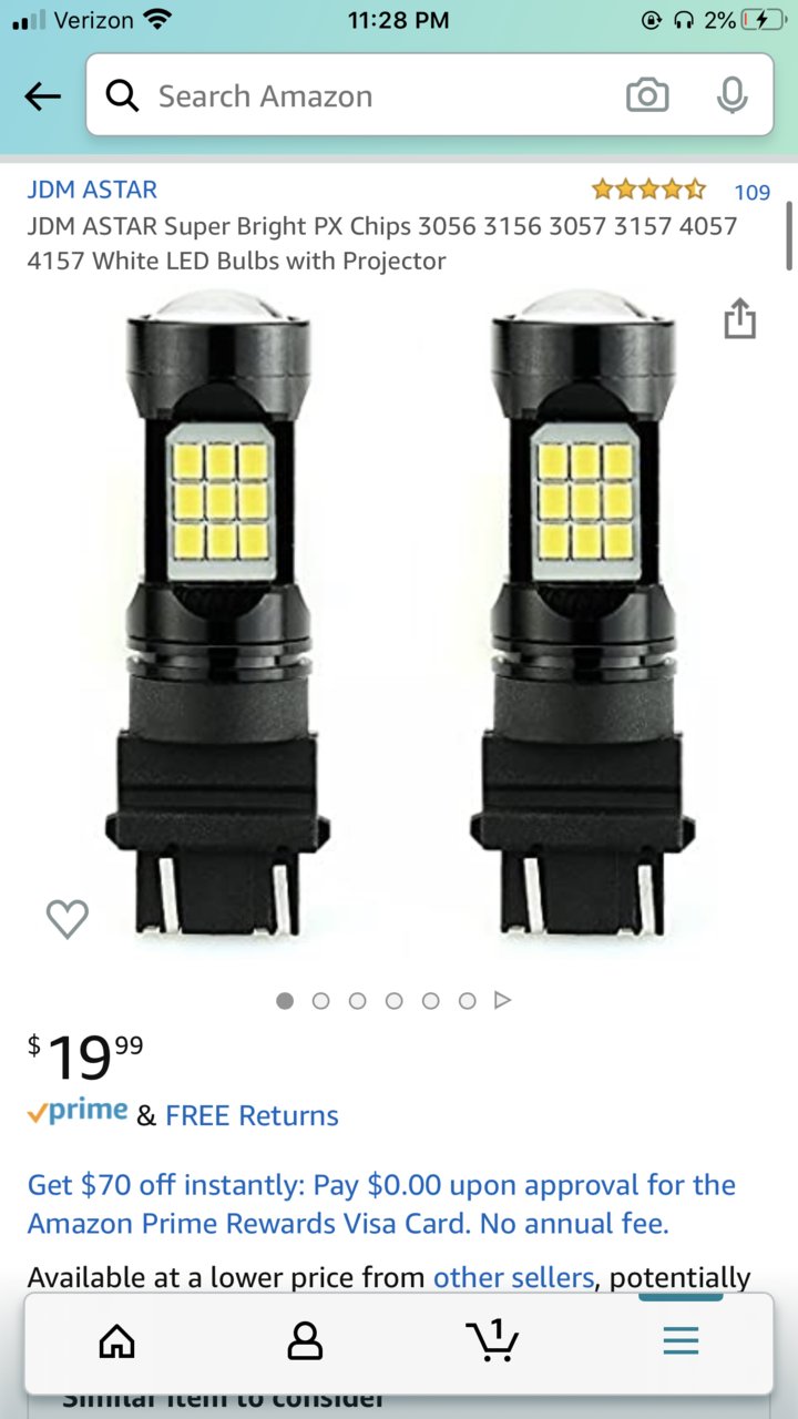

    Heres the bulbs i used, Fit perfectly into the Turnsignal/fog assembly 94B6AC73-5AD4-4651-8EE5-652C6C0A0BDF.jpg

    Super helpful, thanks again! Will be one of the next i do, that output looks great for some running lights

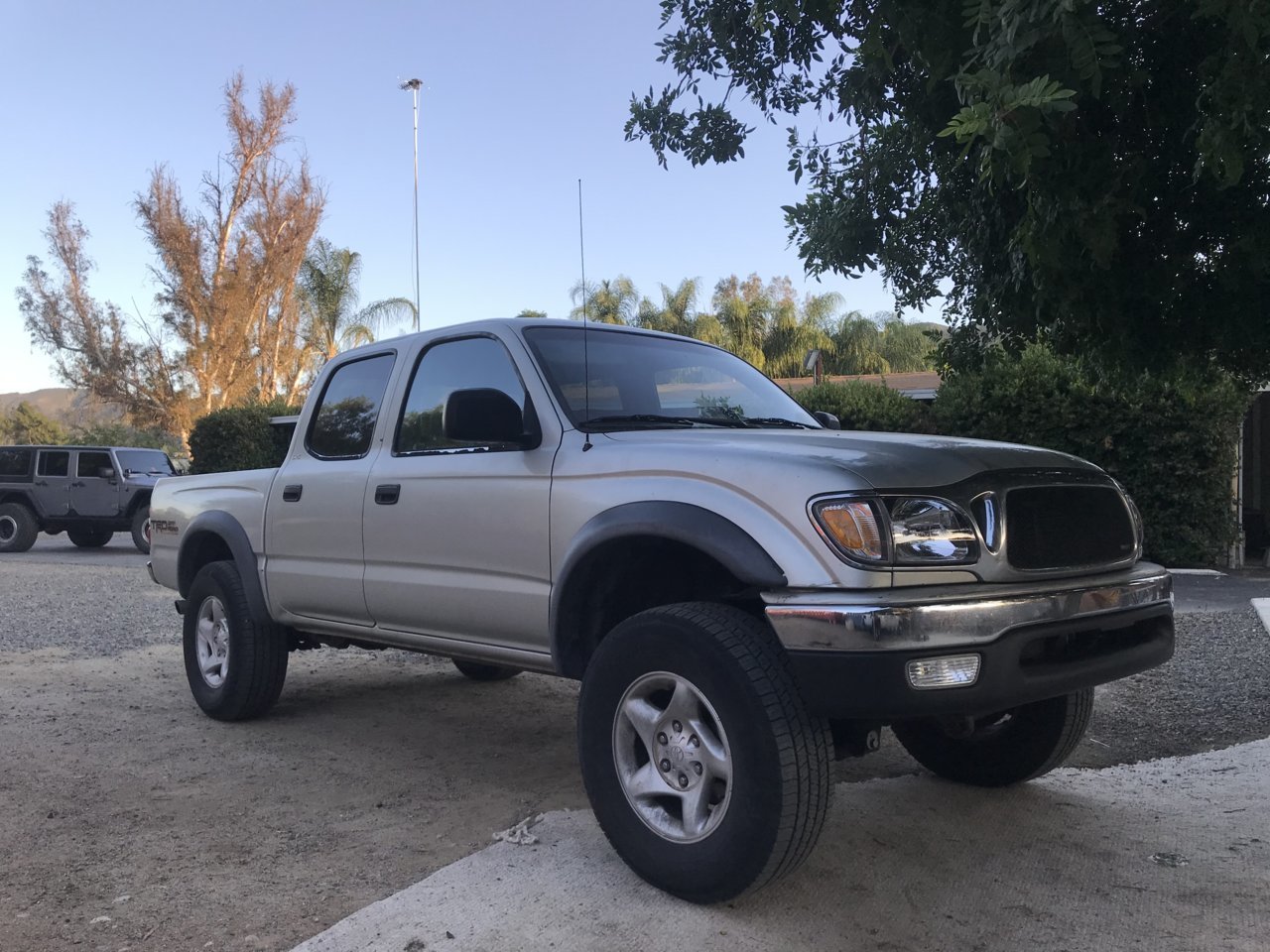

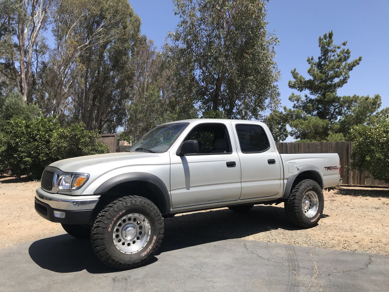

    Got the wheels and tires installed also9E0A9FDA-E566-46E6-941E-2F31F7CD09AF.jpg
