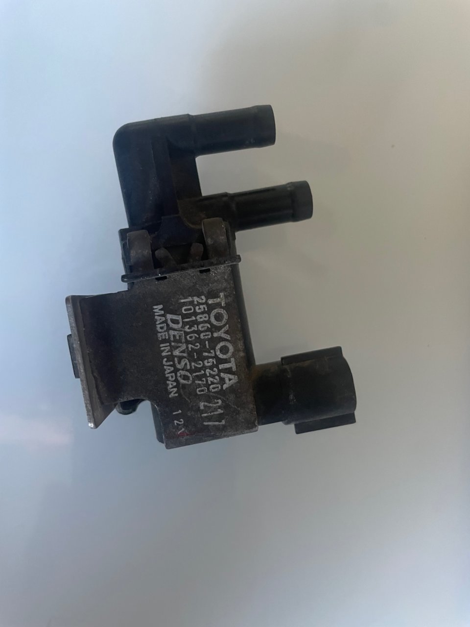

    Hey guys,
    I am looking for this part but for the life of me cannot find any solid information on this. I called a few dealerships around me for info and to see if the part was in stock but they said its discontinued and they have no oem options at all. I am interested in replacing this since this think ticks like crazy. I know they should tick a little but over the past month it has gotten significantly louder and louder to the point where I can hear it over the radio.
    Any information on this would be appreciated. No CEL light at the moment
    Thank you
    edit: This came off a 4wd m/t 2001 x-cab tacoma
    Part: 25860-75220

    Your VSV valve ticking is an indicator that it is working properly. Do you have other symptoms or CEL's that indicate it could be bad?

    881/5100/Dakars 4R wheels / TBU / New frame
    The ticking is normal, but if the rubber isolator piece at the bottom comes off the ticking will be much louder and noticeable. I replaced mine a few years ago because of the noise, mine was part number 25860-75230. Not sure if it's compatible with the one you posted, but it looks very similar. Could try cutting some rubber to fit and see if that helps

    @travis500, did you try testing the valve by jumper'ing 12V to it & blowing/sucking into one of the ports to see if it opens&closes?
    FYI, my VSV also broke at the rubber isolator the way @CrustyTaco's did. I ended up just gluing it back with some rubber cement + a zip tie to hold it all together.

    I believe the correct term for the part Travis500 is looking for is the Vacume Canister Purge Valve, not the Vacume Switching Valve. It gets confusing (or atleast it was for me) trying to tell them apart when ordering parts.
    The first 1 listed above is for a used part. If your original 1 lasted 20 years, I would suggest spending the $92 and hope your good for the next 20 years.
    The second 1 listed above
    Is the vacume switching valve. I don't believe that is what Travis500 needs.
    This is the toyota Vacume Canister Purge Valve and the Asin Vacume switching Valve side by side.
    The toyota part was $92 from Boch Toyota South.
    The Asin part was about $40 from Summit Racing.
    Both parts were available when I purchased them this month.

    @csrf I did not, I can try this tonight after work though. I believe it is working properly but ill confirm, if it ends up being find I may just look for some rubber and do the ol' jerry-rig with some glue and zip ties to see if that eliminates/reduces the noise. If not ill look into using that 230 part number, they look identical but hoping to confirm someone else with an '01 running it. My only hesitation with going used is that this one may last 20 years but I could be buying one that is 19 years old.
    edit: reduces not eliminate
    posting pic of the location to help solidify which part it is
