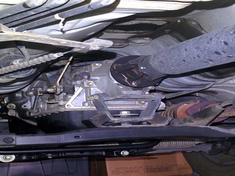

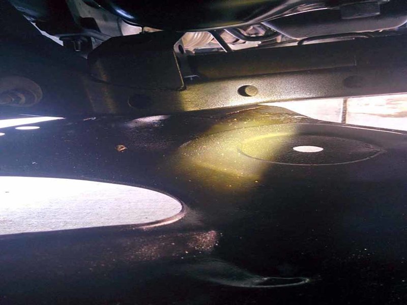

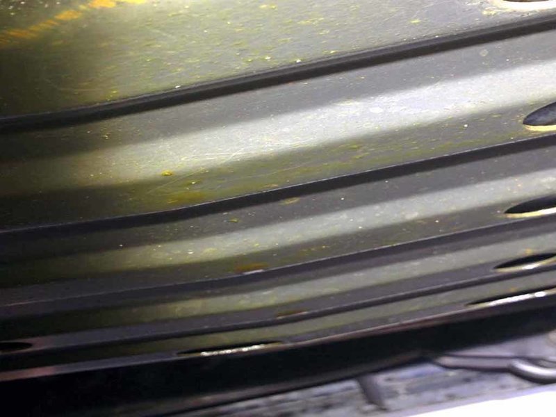

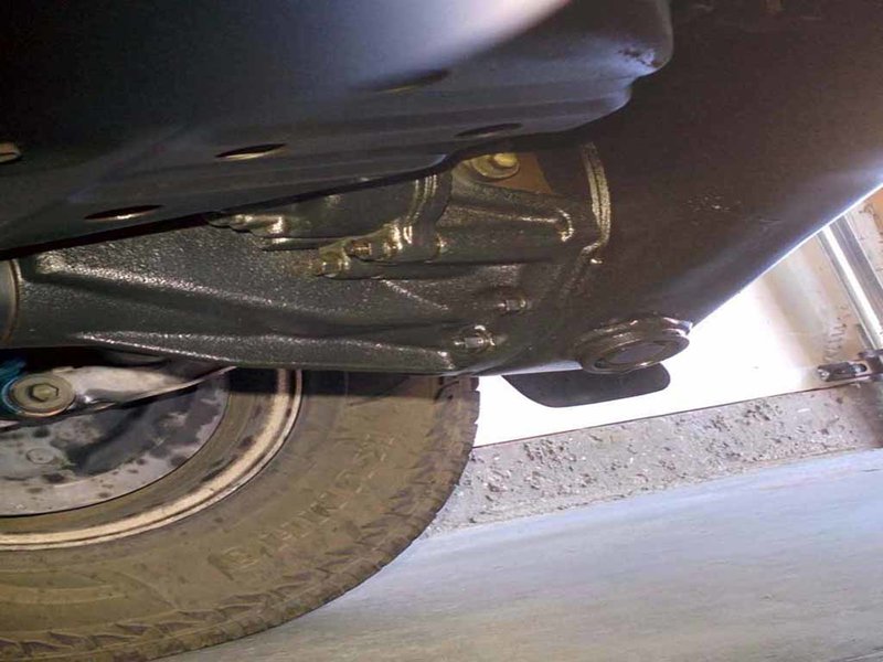

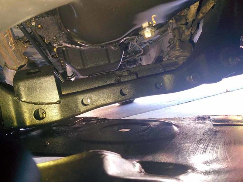

    PROBLEM:
    So, last night I notice a puddle of oil in my driveway and proceed to investigate further. I looked under the hood and VC Gaskets look fine. Started the engine and looked under the vehicle. Steady stream of oil dribbling down from skid plate. Shut off ignition and took a look.
    Dropped the front skid plate and went to remove the rear part of the skid plate and the passenger side bolt will unscrew so far before it just spins and will not drop. Both skid plates were coated in old + quite a bit of fresh oil. Soaked it up with paper towels and wiped em down as best I could.
    I hand checked the oil filter and found I could turn it 3/4 more to the right. Started engine and now no more oil streaming.
    Since I do not have an oil filter band wrench, I could not tighten past hand tight.
    So questions (sorry if they are noob - I need to learn after this mess):
    1. Do I need to tighten the filter further? I have google'd that K&N and found several links on cold temp leaking and problems with tightening. Should I just change the oil again and go with a stock filter? Really leaning toward doing this.
    2. Lots of oil on undercarriage resulting from that streaming leak. Oil sprayed all the way back to the rear axle and was on the diff and everything else. Should I be concerned with oil spray on any bushings, hoses, rubber, etc.
    Next on my list is to look into an engine compartment cleaning at a detail shop. If needed I can inquire about the undercarriage and steam cleaning as well. Especially if the oil spray is going to damage or degrade anything.
    As for the family mechanic, I have always used him for oil changes and routine maintenance. I've changed oil before (not on the tacoma) but always figured for a few bucks more, I could just pay someone else and didn't have to worry about the disposal/drop off of used oil. If the K&N is just crap, then I may give him another chance but I may just start doing oil changes myself/ Anything major, I'll find a shop so that a warranty of work will be there.
    I've attached a few pics. cant really see a lot but you get the idea.

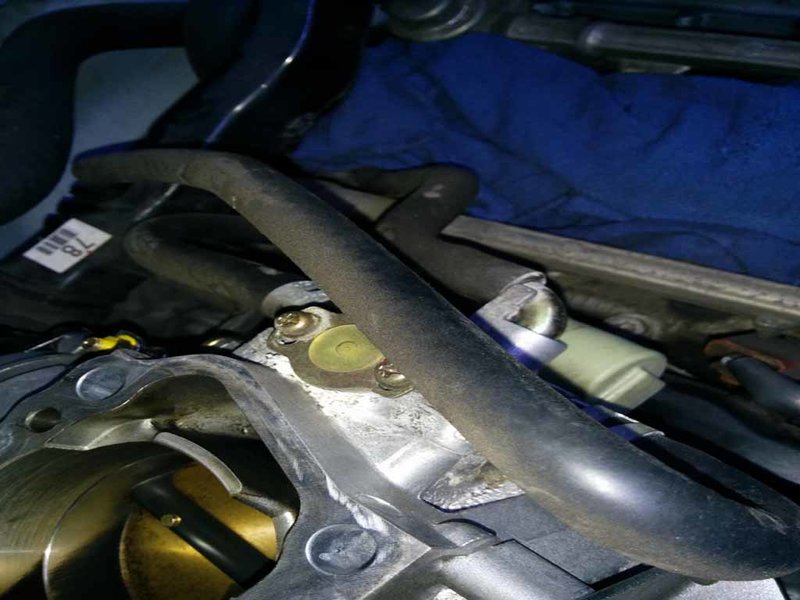

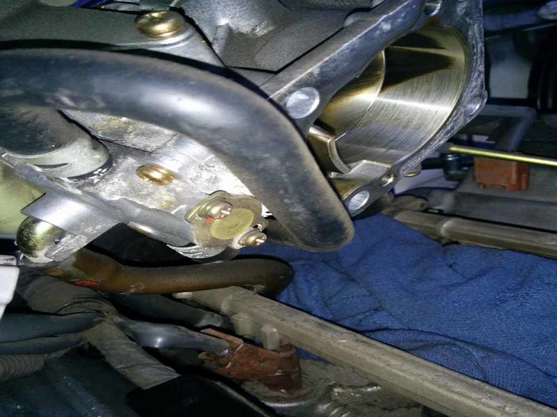

    Also attaching pics of the IAC - mechanic suggested that be replaced next as it has corrosion on it. He also mentioned struts and shocks are overdue. Original so I tend to agree that is next on the list (128k!).
    Input appreciated. Thanks.

    Hand tight on the oil filter is the spec, you will be fine. Leave it til next oil change.
    Ok, you have a mess, but no big bad things will happen. You can let it go, let the rain and wet roads do their job. You can spray it with jungle juice or similar degreaser, spray it with water, rinse, repeat. etc, etc. No harm will be done.
    I just looked at your pictures. Where is the oil? Looks like a new truck. You have some rustproofing now is all.

    Thanks for the feedback. I am a bit worried about the filter and will continue to check it/keep an eye out for leak issues. As long as it stays dry, I guess I'll leave it.
    As for the oil mess/spray, its hard to see in the pics but lets just say that none of the undercarriage was dark black before - yep, I guess it does look new in the pics. As long as its not an issue then I will try not to worry.
    Any thoughts on the Idle Air Control Valve? Its a bit hard to see in those two pics but there definitely is what appears to be corrosion around the hoses. Can those be cleaned or is it best to replace it? Mechanic says replace - I figured I would pose that question to the forum.
    I'll try to take better pics and re-upload.

    Honestly, I can't quite make it out, but if it is working fine, (no idle speed hunting, or engine killing, or overspeed) I would leave it.
    If it works, don't break it.
    If it works, don't fix it.
    I wish my truck was that clean, but it still runs like a swiss watch.
