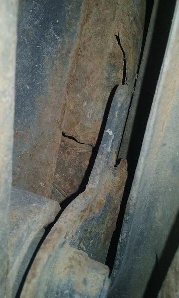

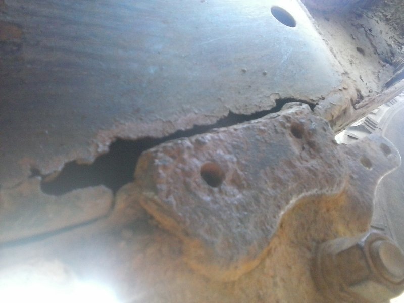

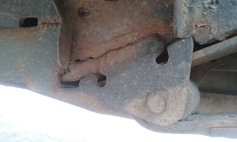

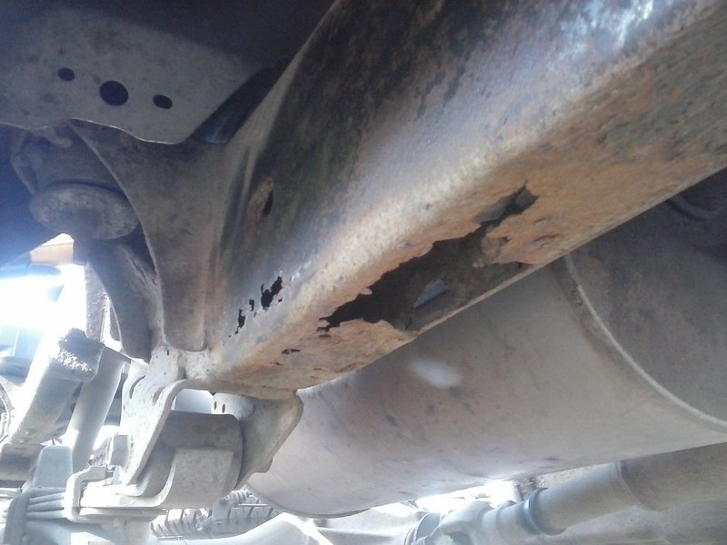

    This is my frame

    It looks like that frame has been repaired in the past, based on the frame hole on the left of the spring mount. I am fixing my frame as we speak and stare at the frame everyday, so I am familiar with what it should look like haha

    Just repaired mine last week. No doubt that one has been repaired. Nevertheless good luck op

    Yes I patched it before winter to reinforce it didn't last long

    What it was last fall

    Holy shit lol you should have taken it in for an inspection then!

    I just patched it thinking plateing it would have done the trick ...but nope mounts still broke and are working way up into frame ...sucks
