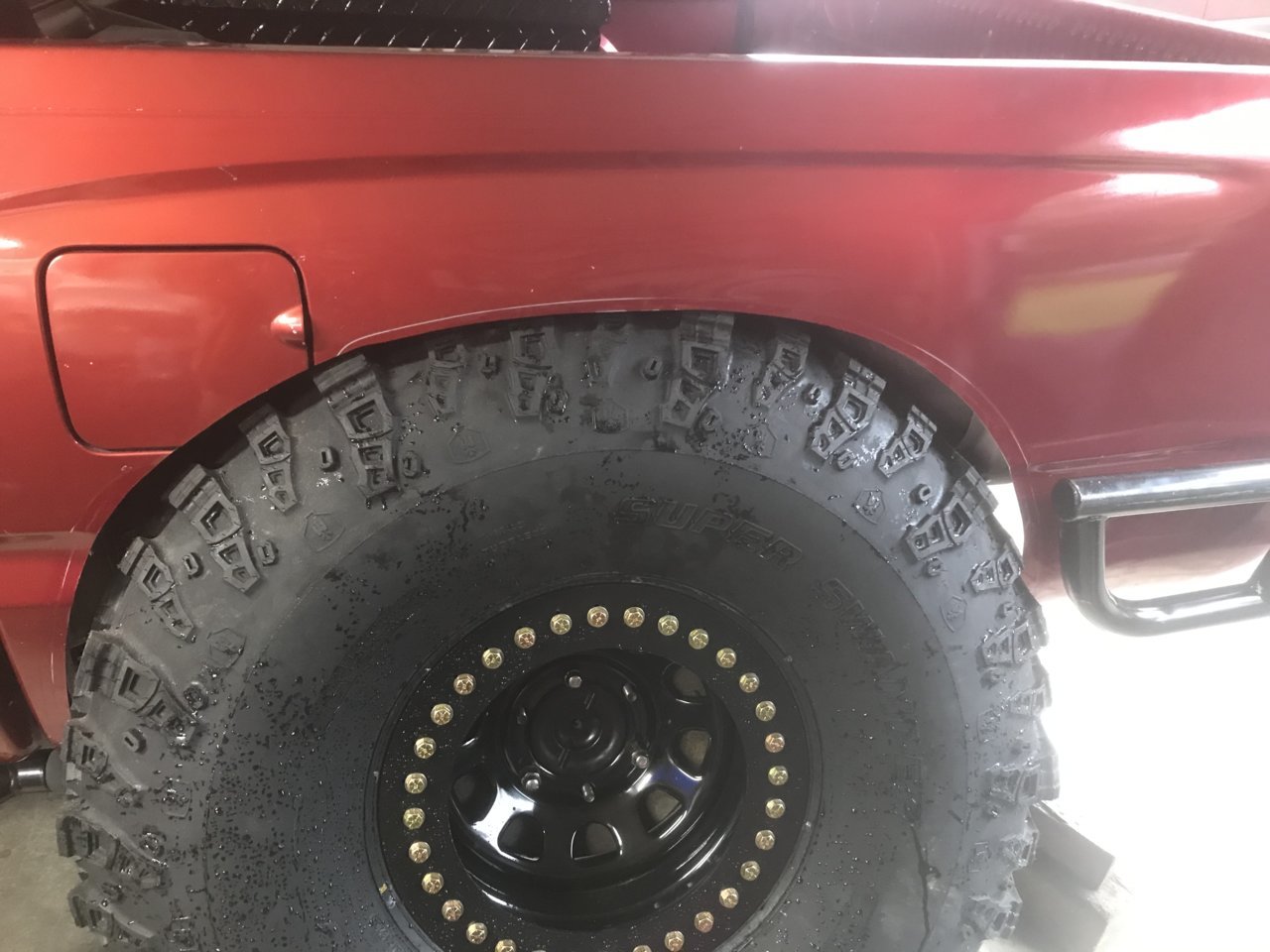

    171
    Kyle
    Tacoma sas

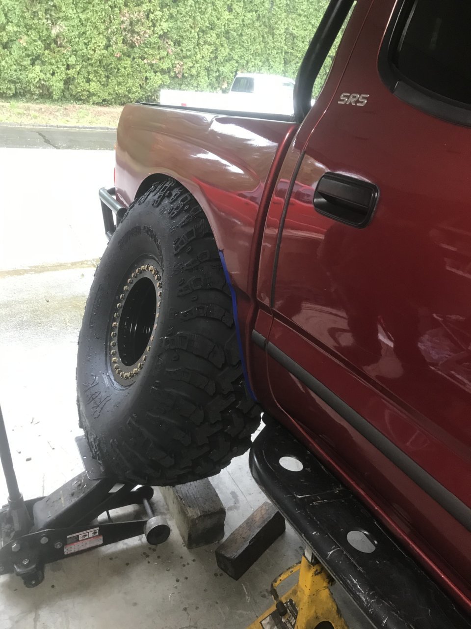

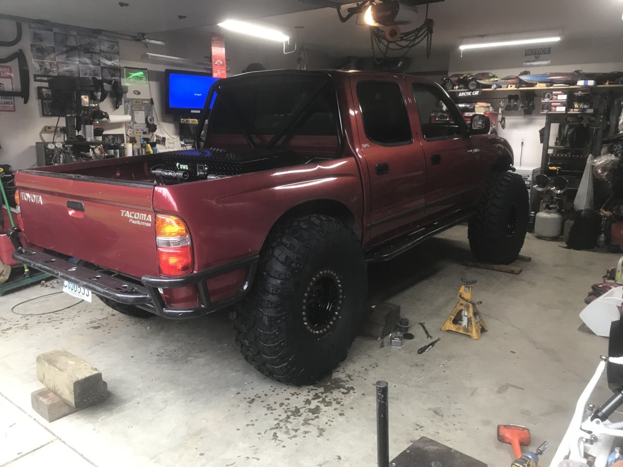

    Tires came in and assembled bead locks time for more✂️ 23” frame height with the 39.5s
  2. Nov 3, 2020 at 2:41 PM
    #182
    02hilux
    02hilux What do you mean there’s no road, I’m here
    Sep 14, 2016
    #197244
    6,315
    Planet: EARTH
    When can I drop mine off??? Lol.
    Rig looking better everytime

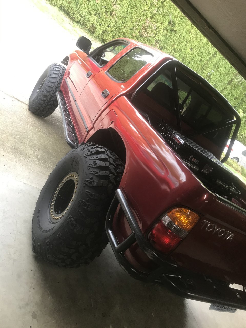

    Kyle
    Tacoma sas
    Full bump rear
    T.Barn, Taco critter, jubei and 4 others like this.

    Kyle
    Tacoma sas
    Full bump front
    Taco critter, jubei, Fernando and 2 others like this.

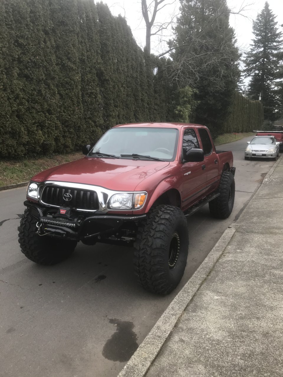

    2013 DCSB
    This is a great build, lots of cool fab work and great ideas here. I was checking out your front axle and wondering about how you set it up. Are you running and IFS hub setup with a spacer to match a Tacoma width rear axle? If you are is the increased scrub radius a problem for you? I am thinking about running this setup on my current build and just wondered if you have any insights on matching the Tacoma width rear.

    2001 Toyota Tacoma TRD
    I ran the exact setup your talking about (83 stock width housing, ifs hubs with fror mount for Tacoma brakes and 1.25 spacers). Mines an extra cab and the trucks are long. Toyota axles have notorious bad turning radius but it’s doable. Driving around town is doable. And I daily’d mine for years like that. With that said there’s nothing wrong with the turning radius and more than manageable.

    Kyle
    Tacoma sas
    Yes ifs hub swap and 1.25 spacers, truck drives stupid good. Pay attention to link geometry and all will fall into place! Thanks for the kind words

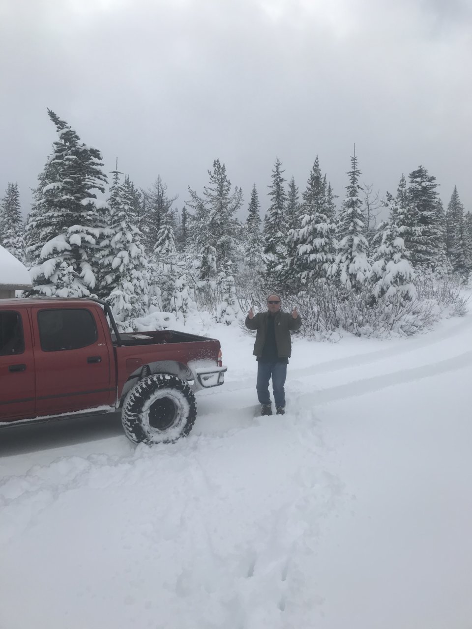

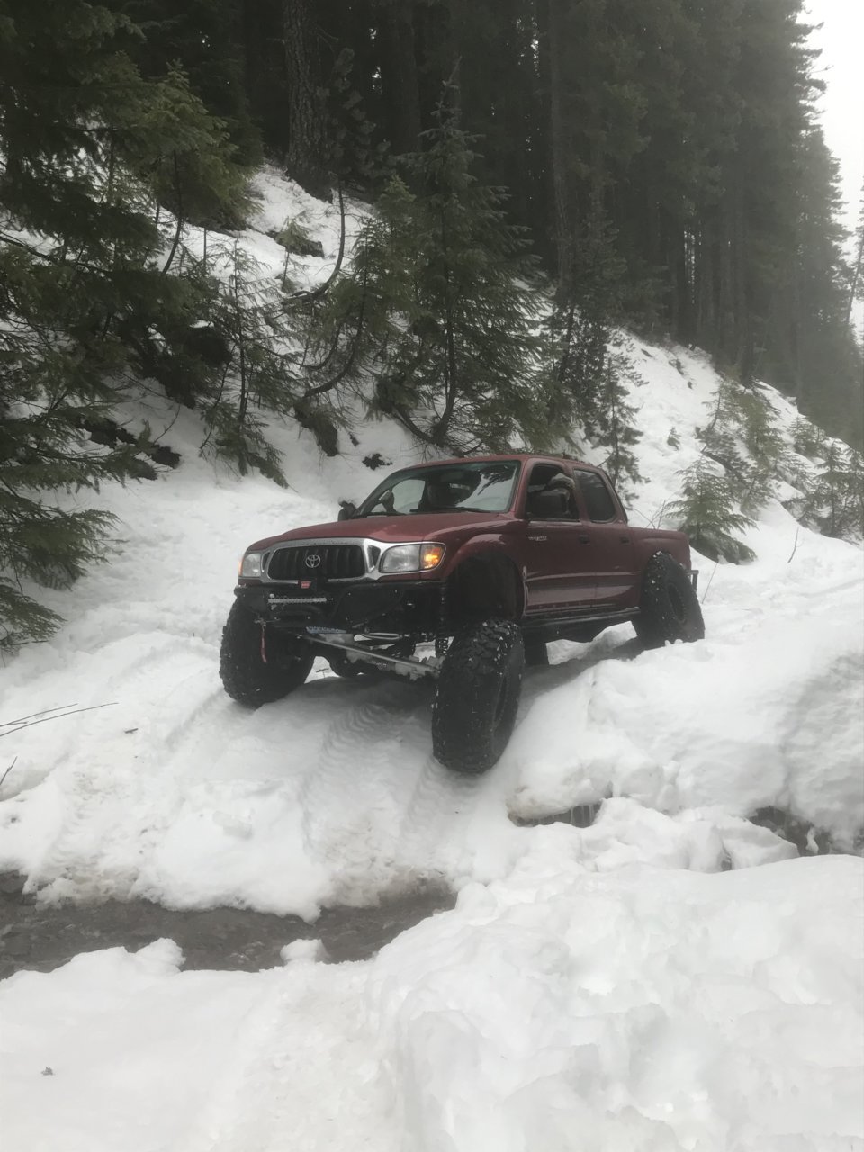

    First snow run of the season and was able to drag my dad along for a quick drive

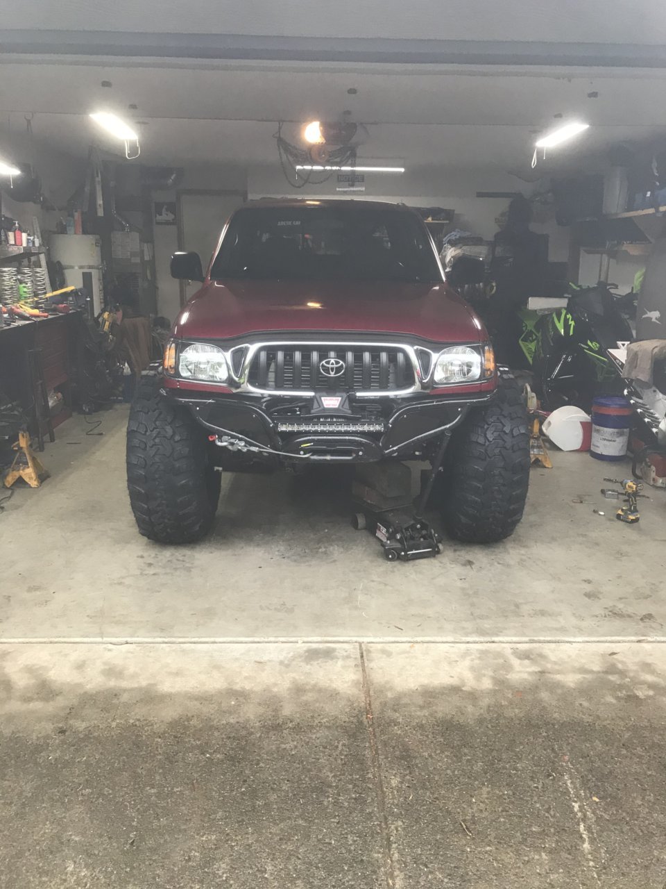

    Tacoma sas

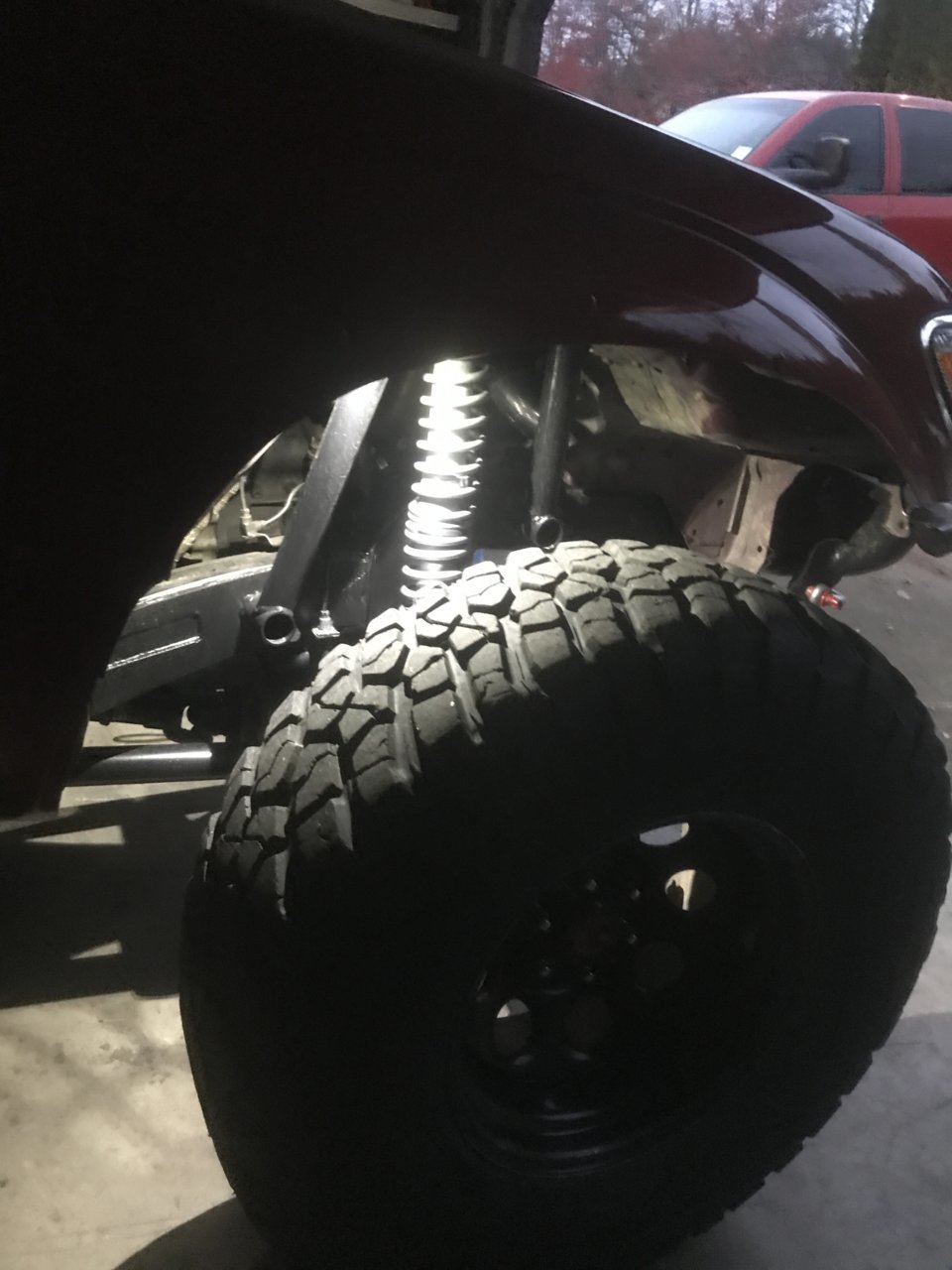

    Wired up Rock lights today just because

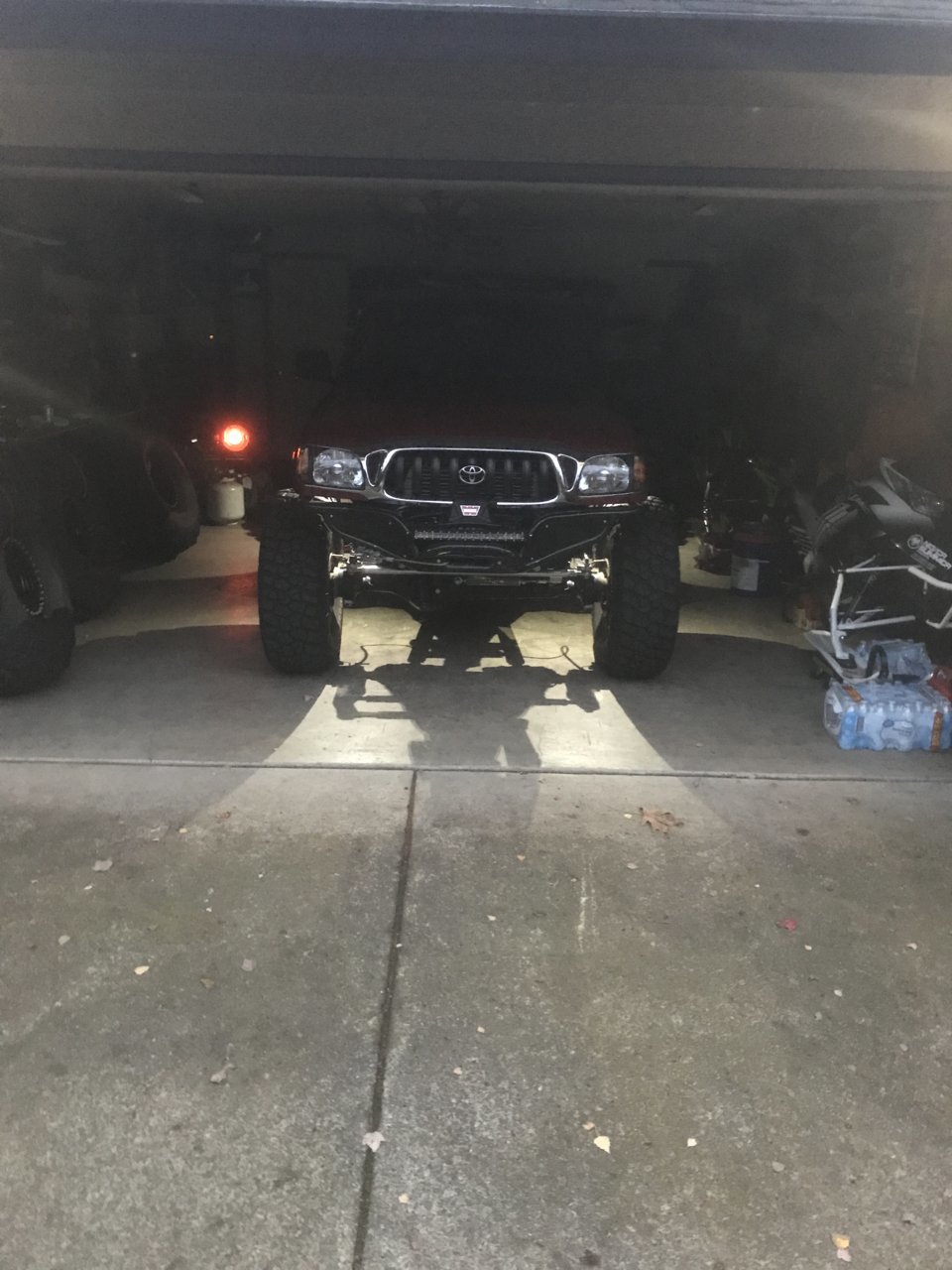

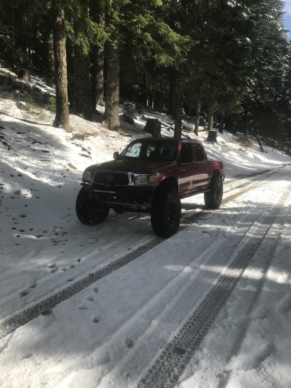

    She’s ready for hangover run, been getting dumped on in the mtns around here so should be a good time

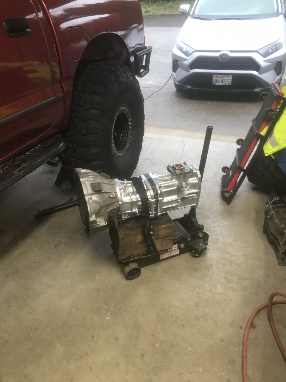

    Tacoma sas

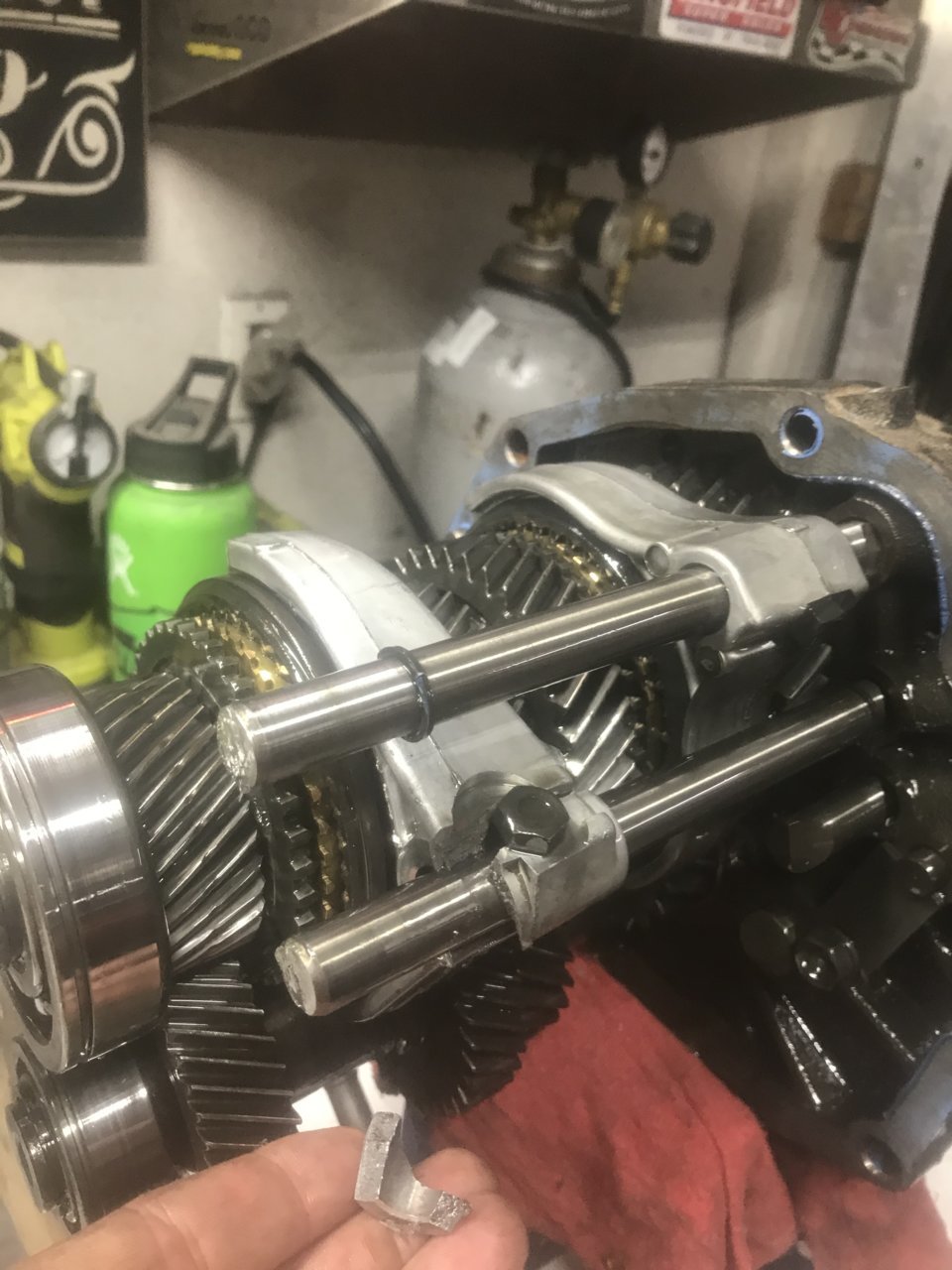

    Truck did so good banging limiter at 10lbs boost!!! So much fun! Problem is I went to grab 3rd gear and it isn’t there, then later on in day I power shift to 4th and it’s gone now? It never did grind and still doesn’t when it in the gear. What would cause this? Shift fork? Never been inside a tranny. W56 b series

    Tacoma sas
    Got the tranny out and decided to split it, wasn’t bad at all. Found the culprit, a broken shift fork! Got one on order

    #197
    Kkrause09
    Kkrause09 [OP] Well-Known Member
    Jan 20, 2020
    #316705
    171
    Kyle
    Tacoma sas
    For shits I welded up broken one just to see if I could
  18. Jan 6, 2021 at 1:56 PM
    #198
    Kkrause09
    Jan 20, 2020
    #316705
    171
    Kyle
    Tacoma sas
    Got her back together, found a donar tranny that I pulled fork off of! Hate waiting on parts and having my truck down! I’ll put my new spare on shelf when it arrives

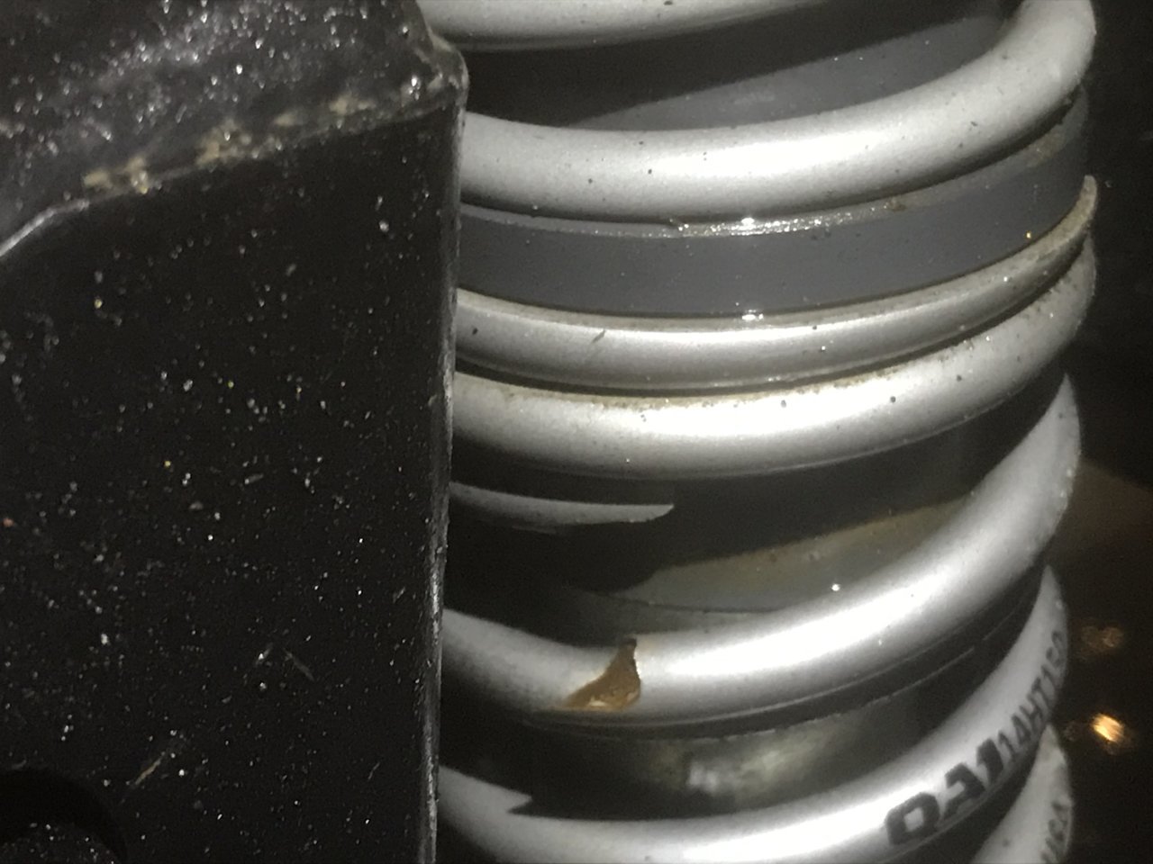

    Kkrause09
    Jan 20, 2020
    #316705
    171
    Kyle
    Tacoma sas

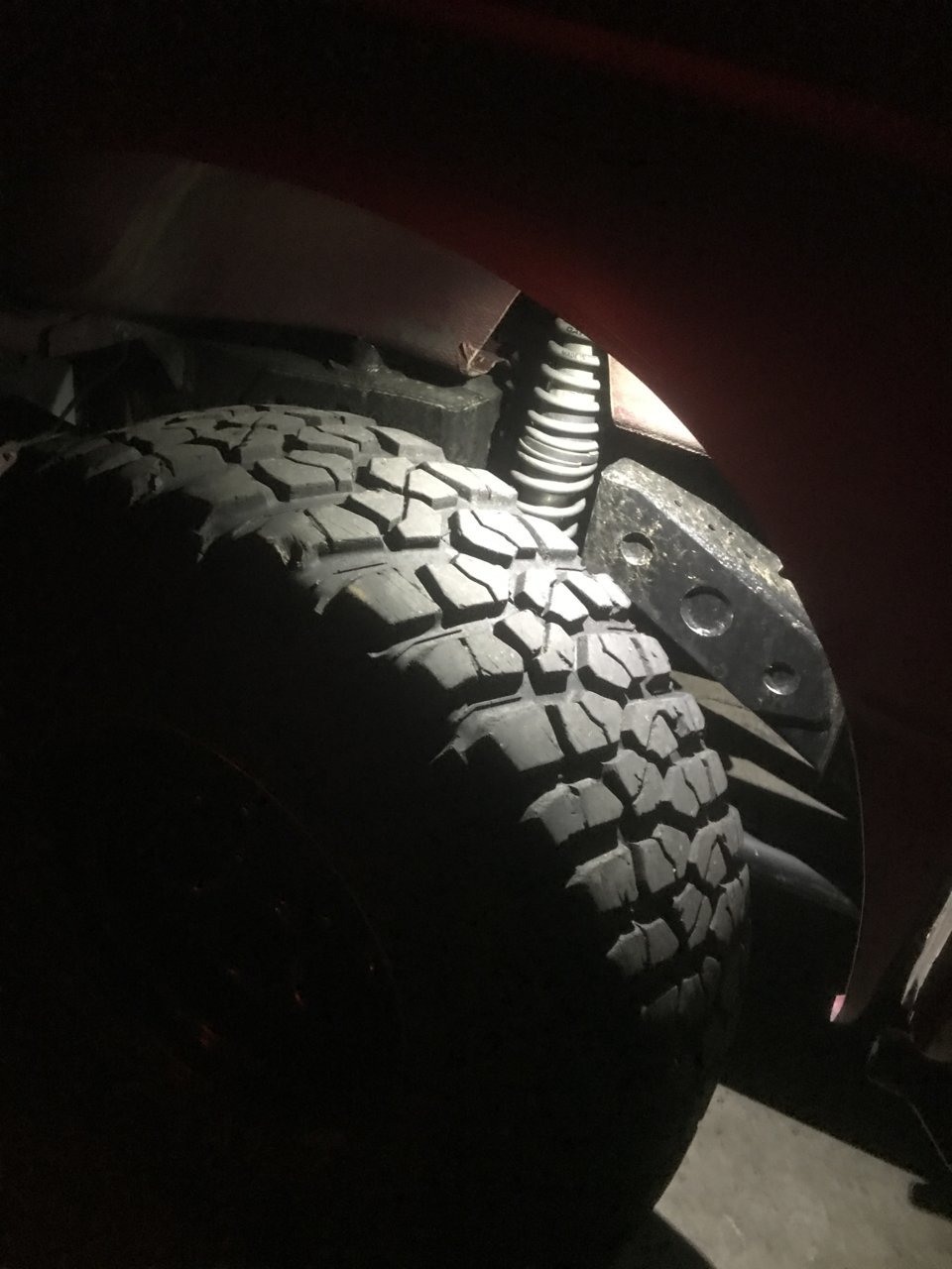

    First time I’ve seen this happen! Not quite sure what woulda caused this, new coils on order and going with a different rate this time. Only thing I can think of is the crossover was causing coil bind. I am going with 150/175 rate which will Allow me to keep the crossover Higher on shock.
    malburg114 likes this.
  20. Jan 14, 2021 at 10:21 AM
    #200
    Broke Okie Ty
    Broke Okie Ty Well-Known Member
    Aug 27, 2014
    #137043
    1,141
    Ty
    California/Oregon/ Now in Montana
    01 trd with some stuff
    Armor, winch, other stuff
    Is it rusted? It looks like a defect that might have finally gave way.
