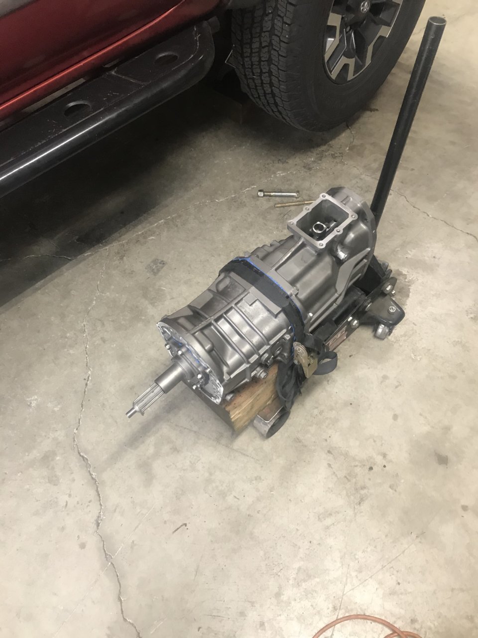

    So I used my core and got a rebuilt w56, she’s butter now

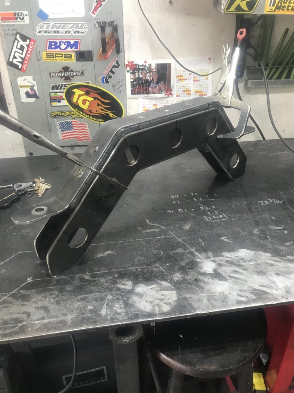

    Tacoma sas

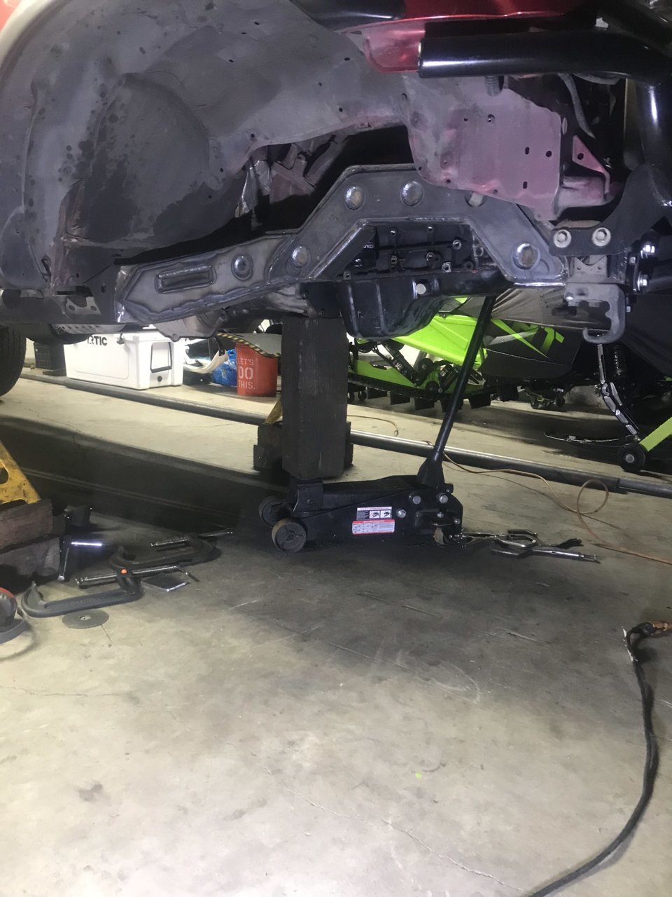

    Got the pass side frame notch ready to splice in, should net factory height w/ sas!

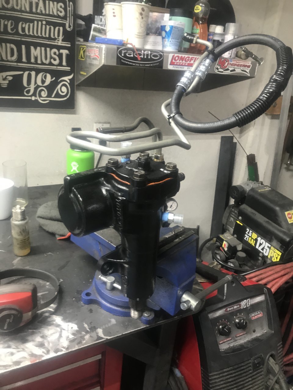

    Rebuilt the steer box which was a piece of cake, then tapped for hydro assist. Getting close ✂️

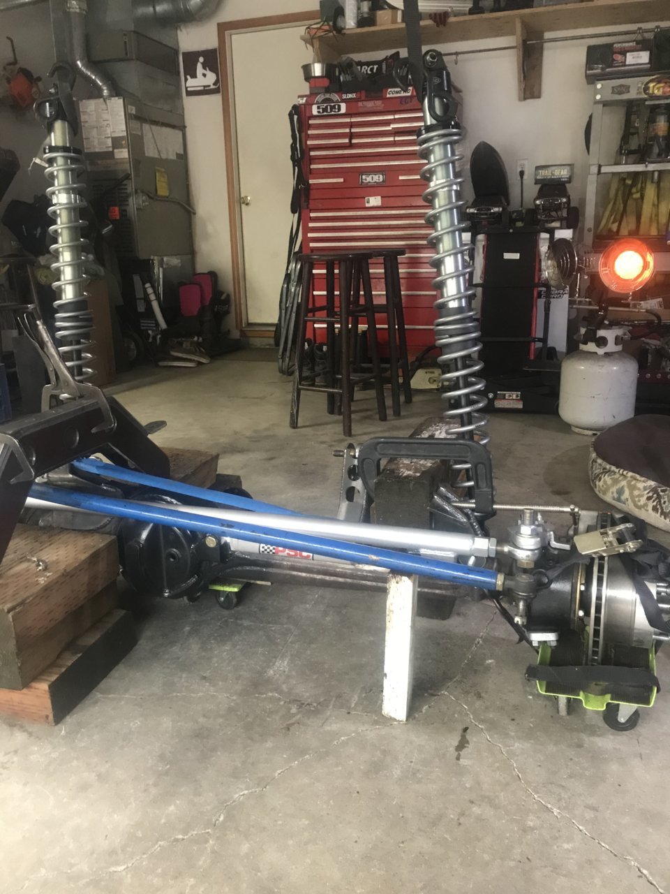

    Tacoma sas

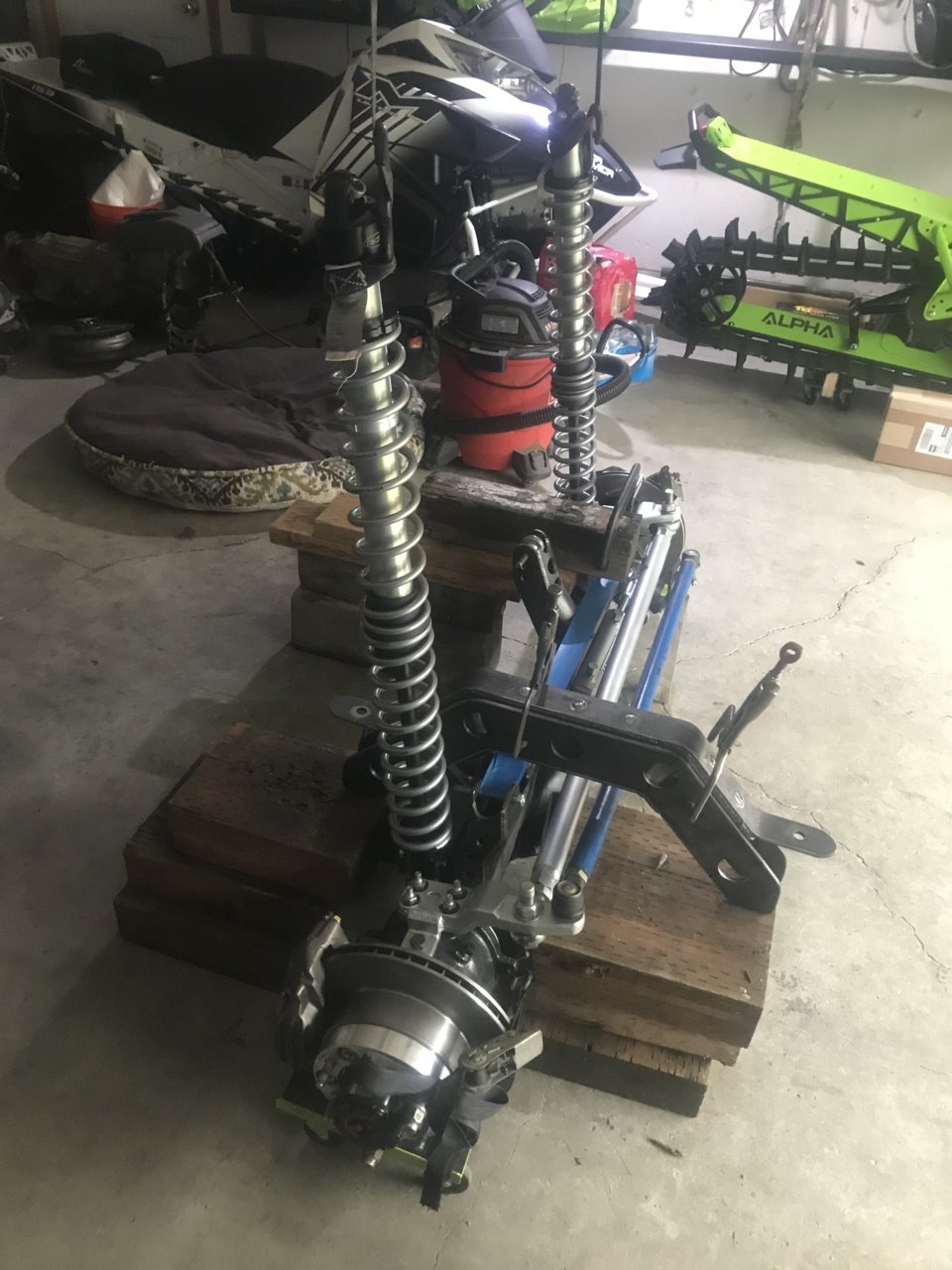

    Some really ruff mock-up on the ground, can see I’m gonna have issues with my shocks in frame at articulation!

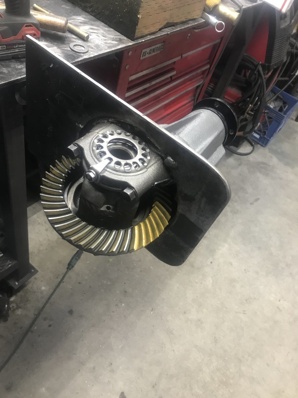

    Tacoma sas
    4.30 Gears I had laying around with a lock right and install kit so I put them back together. These will pretty much just be a filler until trucks far enough along I’ll exchange with what’s in my built 3rd gen 4.56s and Detroit’s!

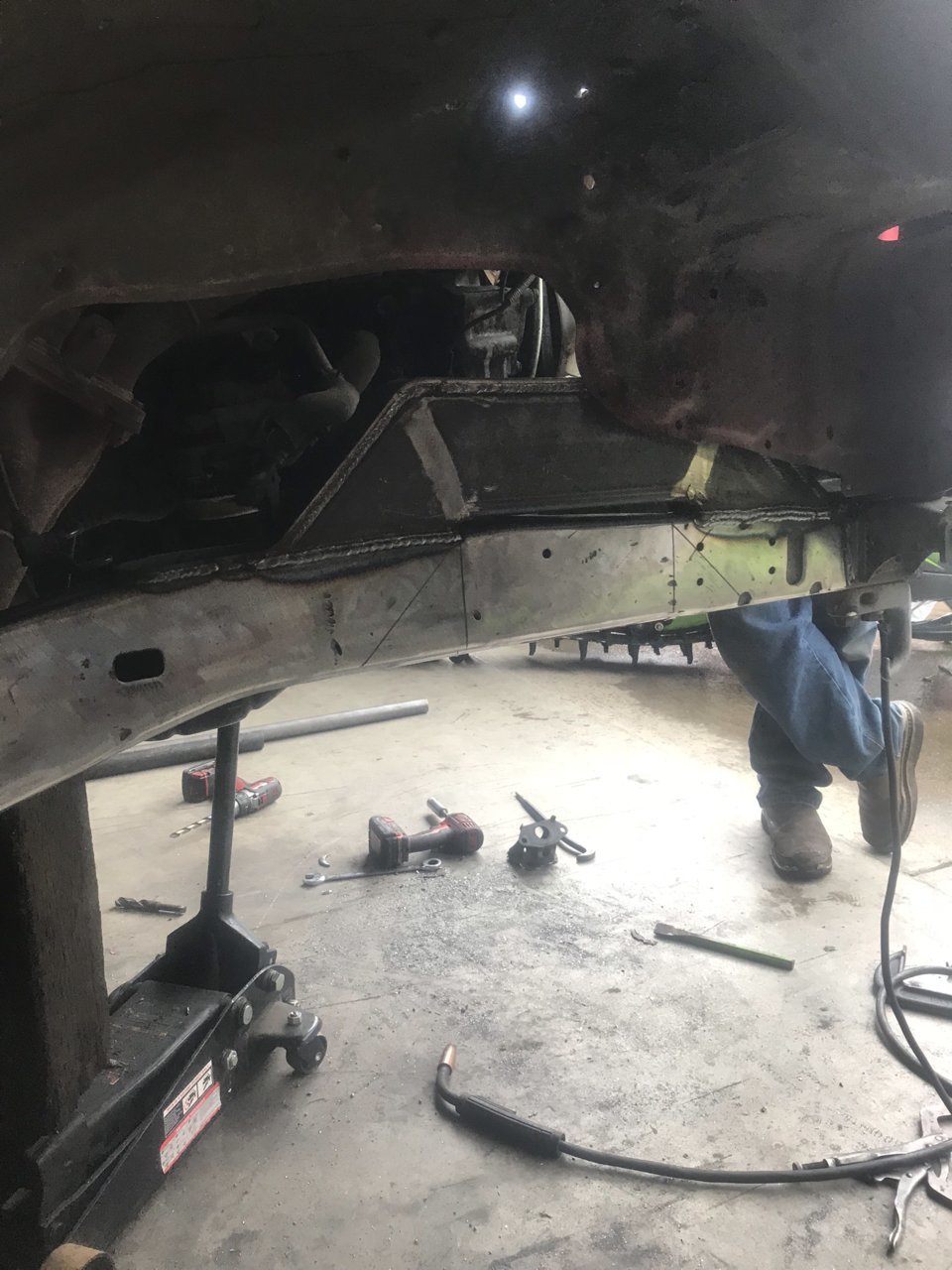

    ✂️✂️✂️ here we go

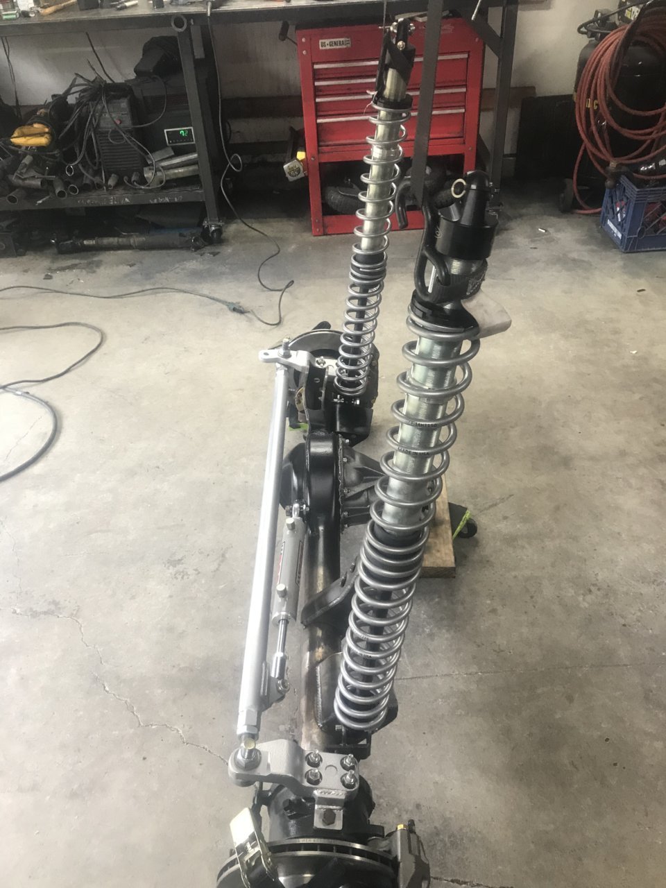

    Tacoma sas

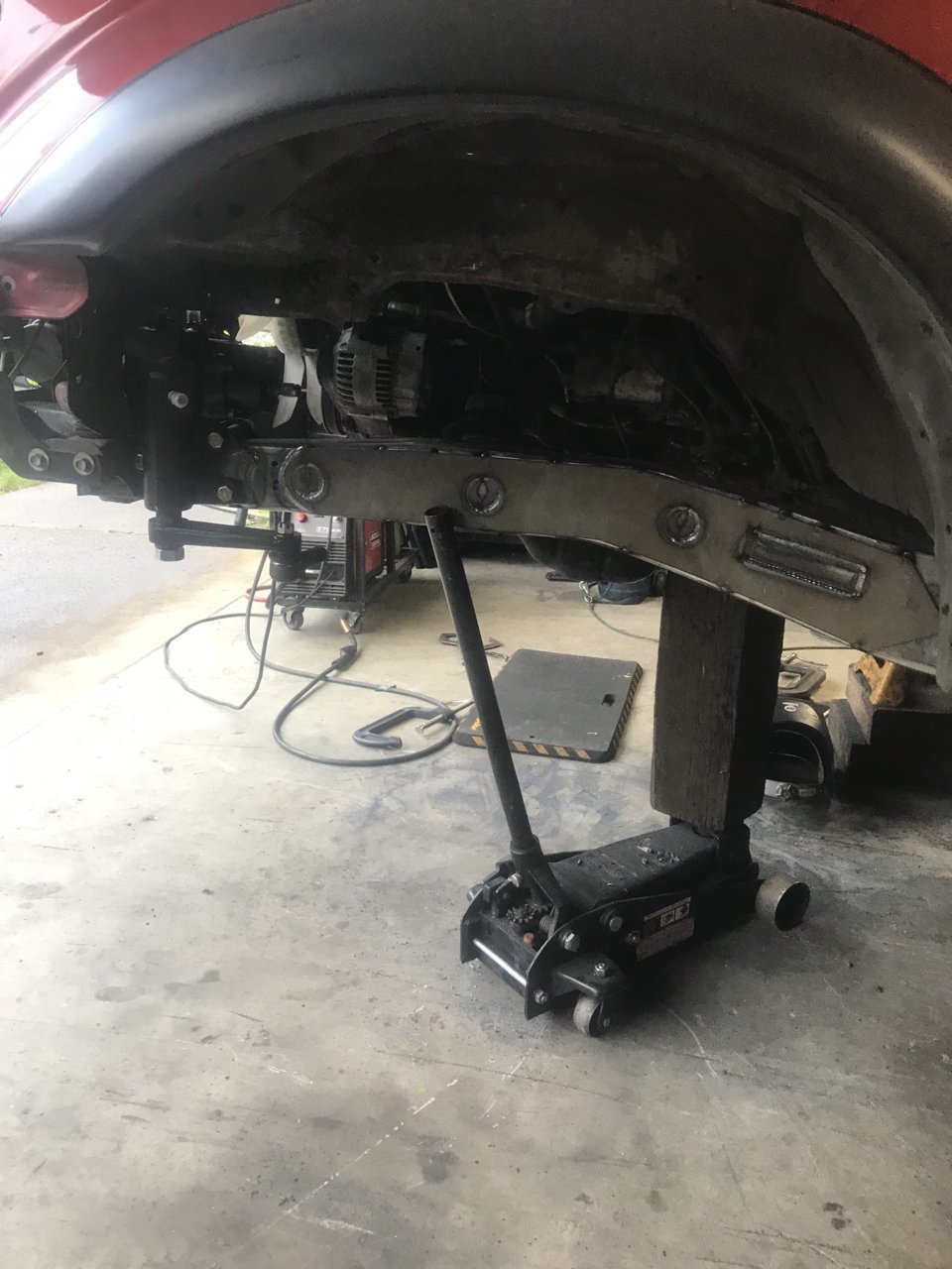

    Here’s more progress pics, some fine tuning for full bump needed. I screwed up my panhard bend and started it to far into pan so back to the tube store in the am! I cut motor mounts off and raised engine 1” so now gotta try for 1.5-2 more with redo of panhard hopefully
